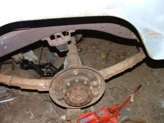

Here is some background I've had my fj40 for about 10 years drove it the first 6 months then parked it. Here is what I’ve done so far or started.
-front disk conversion got most of the parts need a Spindle rebuild Kit.

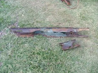

-the center channel was rusted out so replaced with 2x2 square tubing.

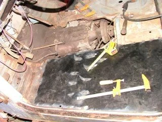

-replaced the drivers side floor.

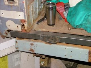

-started the rear sill with some 2x2 square tubing.
once I get the body some what strait I'm going to start the frame.
like to move the rear axle back 3-4 inches and a SOA lift. rear disc brakes.

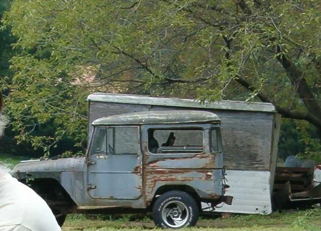

this pic is from 2005 at my parents house just put on the bling rims & tires.

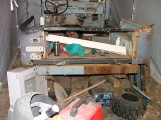

heres some picks of what i'm working with :doh:

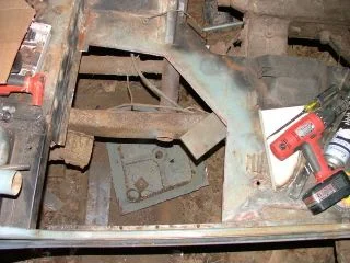

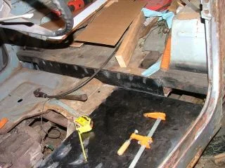

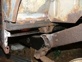

floor and center channel

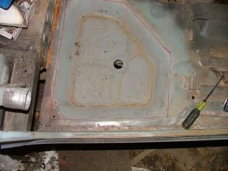

used some old fire alarm backboxes we replased at my work for the floor.
got some 2x2 3/16wall square tubing left over from a trailer I modified for the center channel. and I'm using it for the rear sill. post it when i'm done with it.

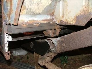

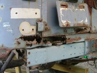

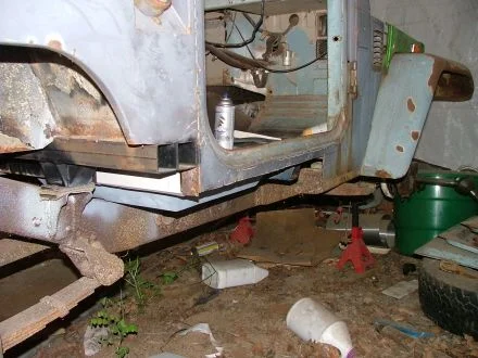

heres some pics of the rear cil so far next is going to be the rear quarters.

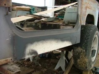

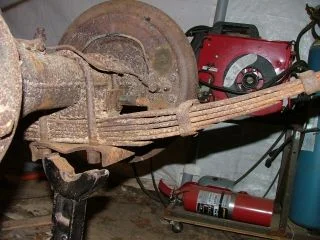

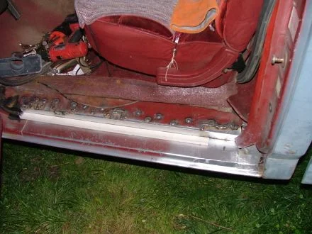

got the heater from santa heres some more pics of the drivers side rocker panel I.m almost out of argon for my welder think I might try some flux core wire. any one have some input on flux core or solid mig wire?
I tried the flux core its good for heaver applications but not for the body work I'm doing.

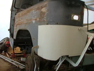

Heres some pics of what I've got done.
Here’s some more with the rear quarter and drivers side welded in its not perfect but for what I’m doing with the cruiser this will work. This ain't no trailer queen!

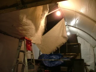

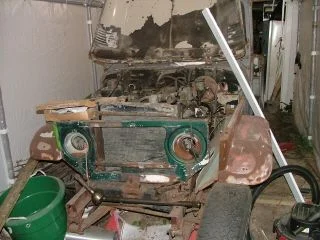

Hade a fallout Tuesday I guess the 6” of snow was too much for my cheap carport. The real problem was the rain that fell after the snow and I was at work so I could not even throw a tarp over the cruiser to stop the tub from filling with water.:crybaby: Got a tarp over the POS carport now so work can resume.:)

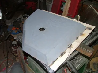

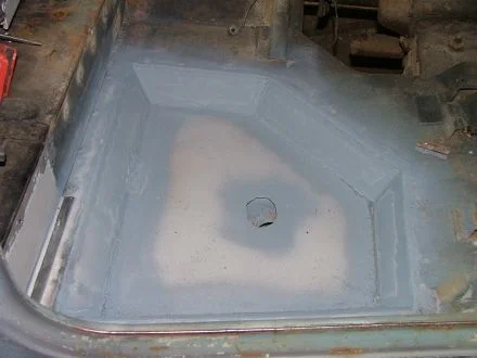

Tacked the gas tank well together hope the tank fits in it.

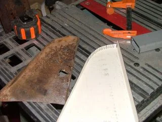

Got this done today made the tank well about 1/8th inch to shallow.
Measure once, cut twice. Or was it Measure twice, cut once I can't keep it strait. I remember measure once; cut once then beat it in with a hammer!

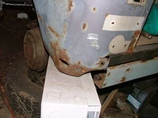

this is the fuel tank well and I've started cuting away the pass. side but I had to patch some on my new/used ford made all the panels then found out the peplacment panels from LMC were only $30.00 plus shiping. O'WELL its only a beeter!
