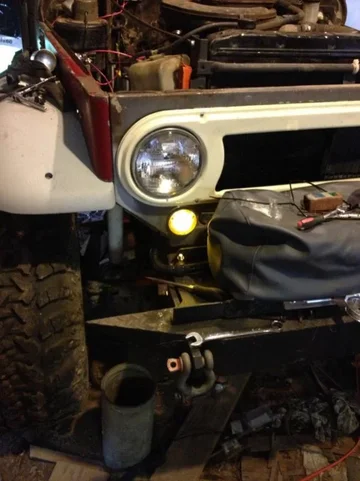

Got the winch and dual batteries installed. Working on led lights in the front bib marker lights.

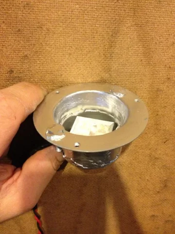

Got my marker lights working. Had to make the bulb housing shorter because of were I put the scout steering box. Used a LED light in the shortens housing.

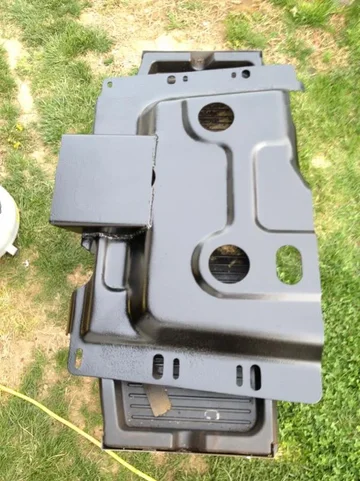

Modified the 3 speed skid plate for the sm465
