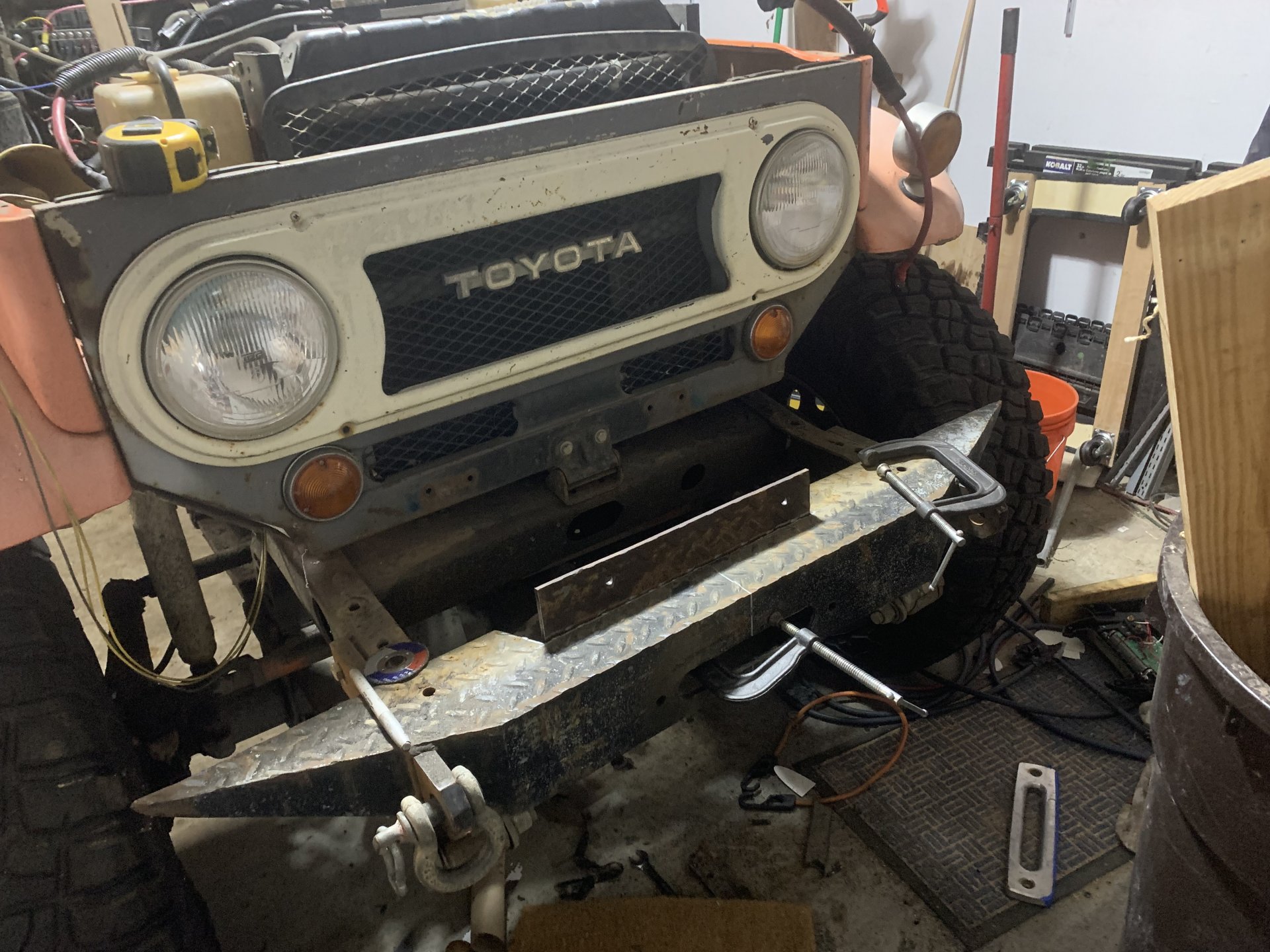

Acquired an 8274 need had to modify the bumper to mount it down between the frame rails.
Poser! If I ever met a driver who DIDNT need a winch, it was you Chris.
You just wanted a bling way to put some extra weight on the front axle.😉

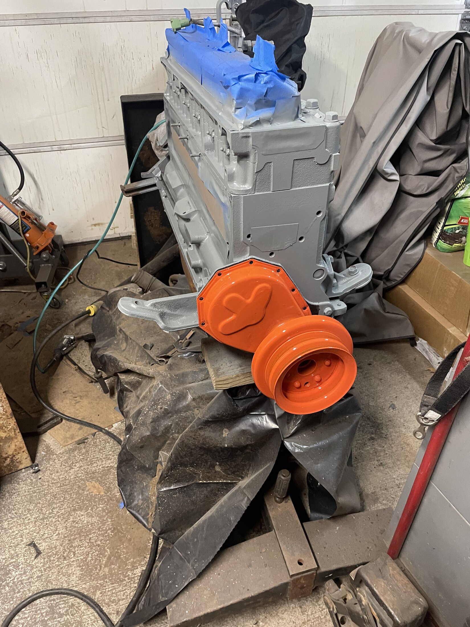

Out with the F in with the 2F!

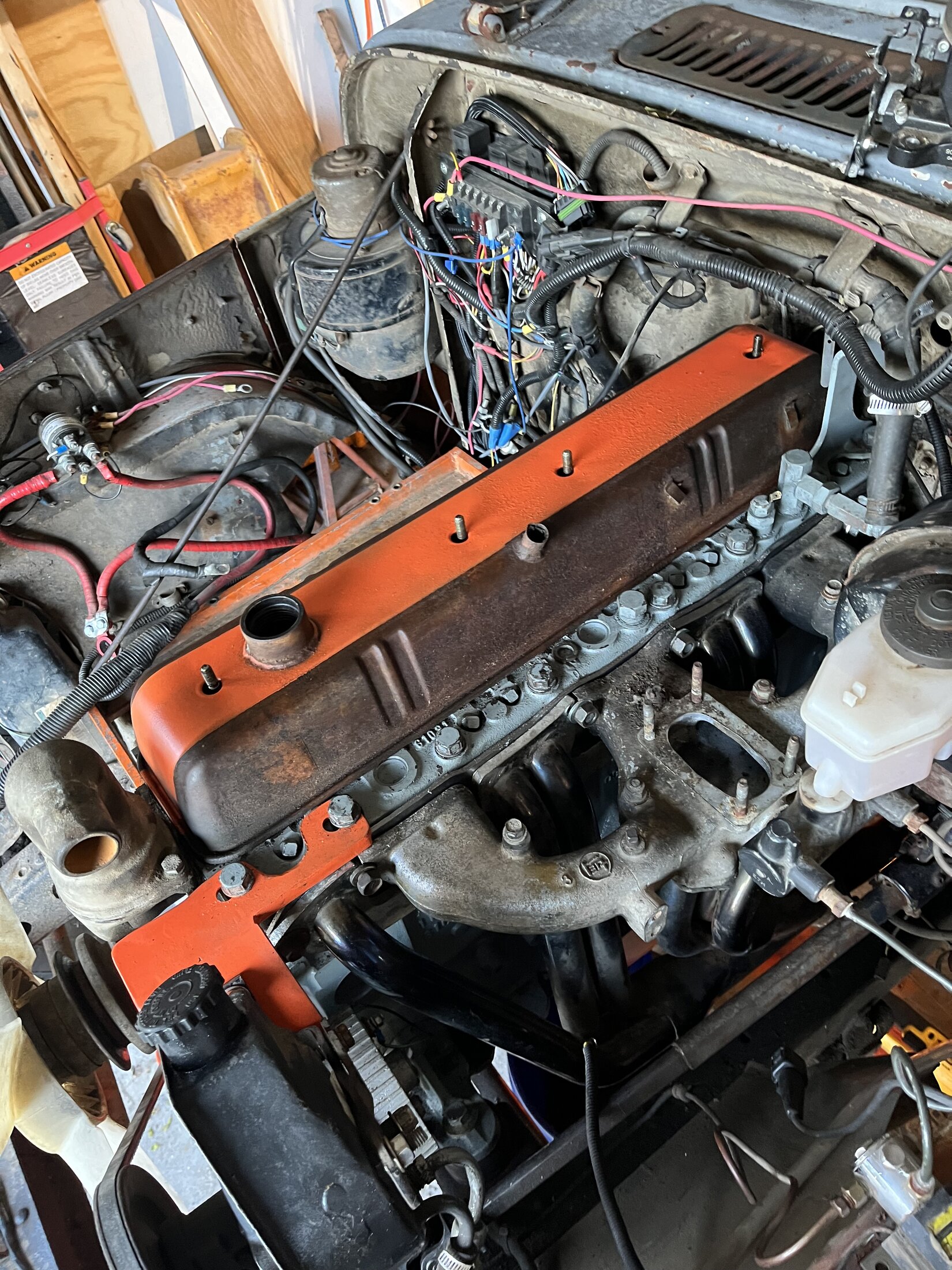

Plan is to just reseal it, new water pump, try Y Header, maybe shave the head.
Did a Craig’s List rebuild on the 77 2F. Replaced all the seals. I plasiguage the mains and rods. The rods were fine the Mains were just out of spec so I replaced the mains. Went through the head, Lapped the valves, replaced the valve seals.

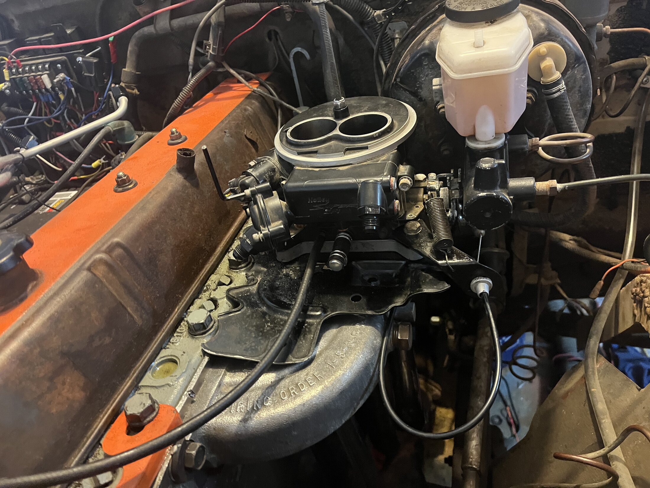

Got the 2F running with the carb then because I’m gluten for punishment I’m putting the sniper back on!
I’ve got everything installed but the analog coolant sensor.
