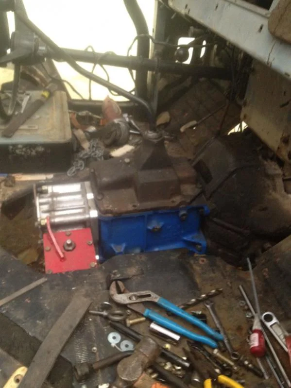

Got the parts in to install the sm465.

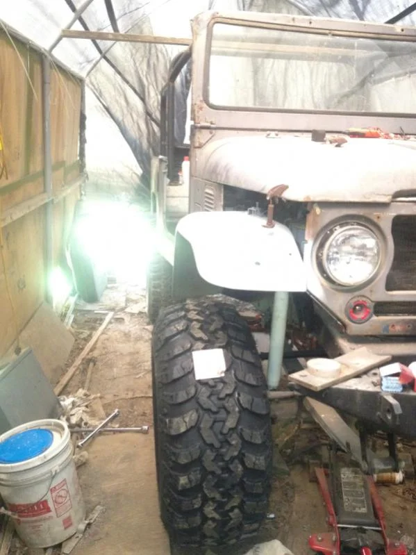

Orders tires went with irocs 36-13.50-15 need to change the rims or do some spacers they hit the TRE.

Sm465 is in!

The trans cover is kicking my butt not as easy as cutting a new hole. Going to work on it today.

Spacers came in today got the passenger side tires on. They look good.
