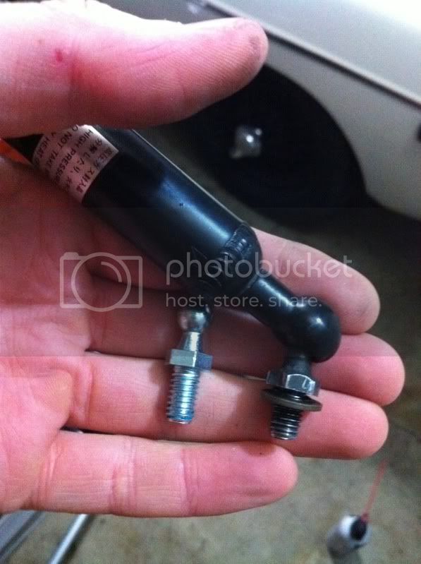

Having a similar problem replacing the springs on the liftgate of my 60 - ordered the two replacement springs from Reid (item GAS-124) as well as the screw in studs (item GAS-30).
Anyone know what the thread count/pitch is on the OEM studs? To my untrained eye, the thread pitch looks different; I'm already fearful of buggering the threads up in the liftgate, but not certain.

Srogers someone said earlier that the threads were the same but I don't think they are, at least mine weren't. They are real close so I went ahead and installed them and they seem to be in there pretty good.
Thanks tclark - it doesn't appear that they are, but I wasn't sure if there was another thread pitch or count that someone was aware of.

When in doubt, lay the two together, side by side, one pointing the opposite direction from the other. If they are the same pitch, the threads will mesh cleanly.
