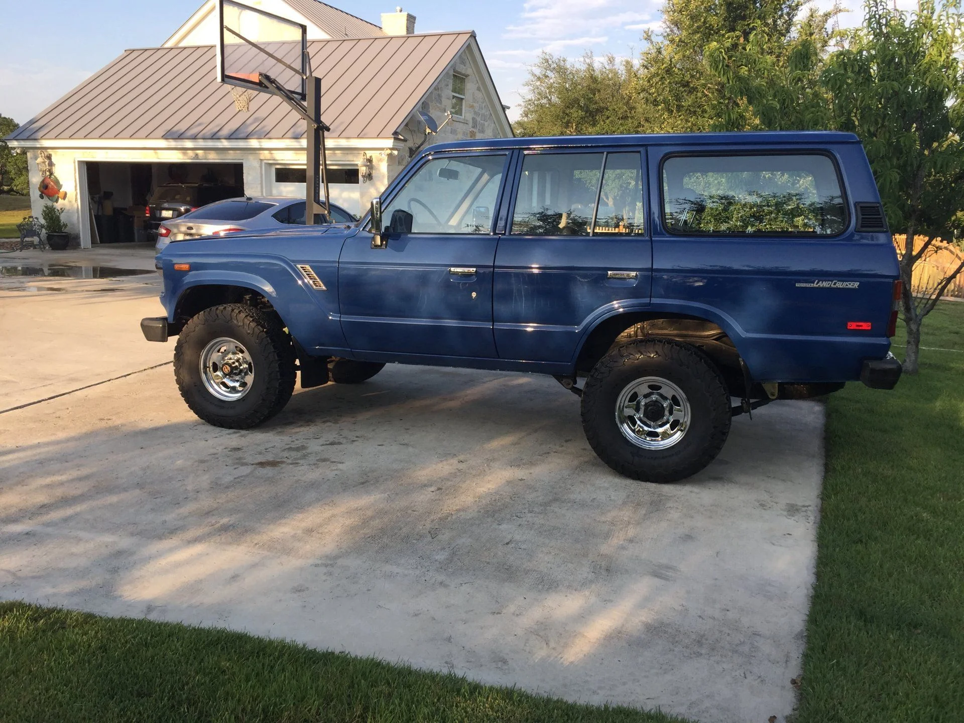

HOLY wow! That is a BEAST! Awesome job Jim!!! @landcrusher909 check it out! I talked to Rob today and told him about that beauty your getting ready for CO.

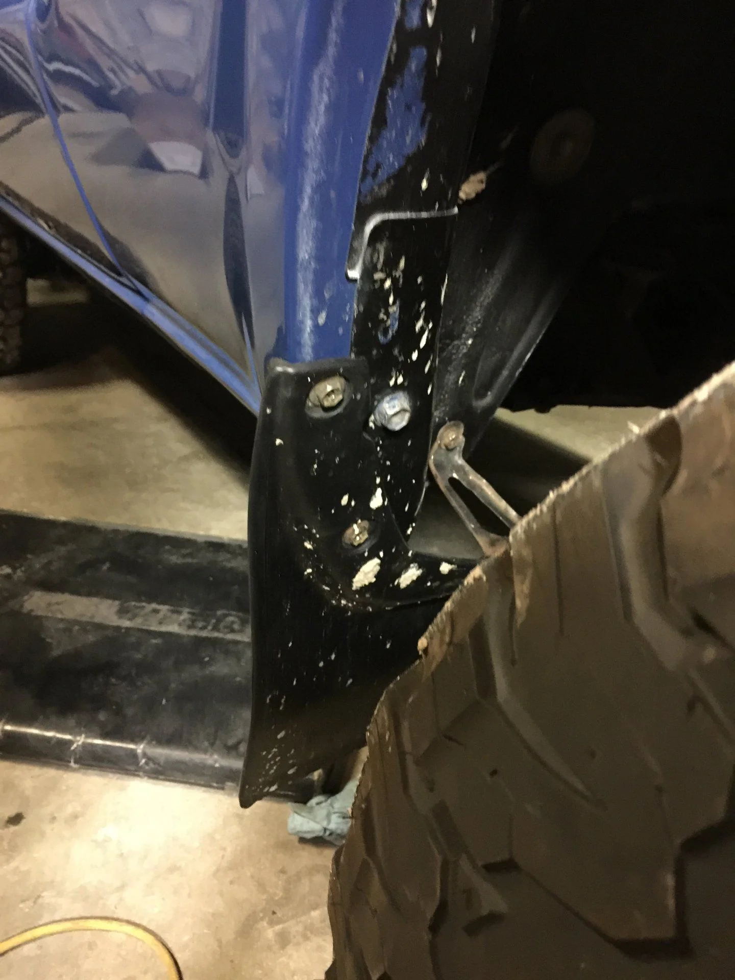

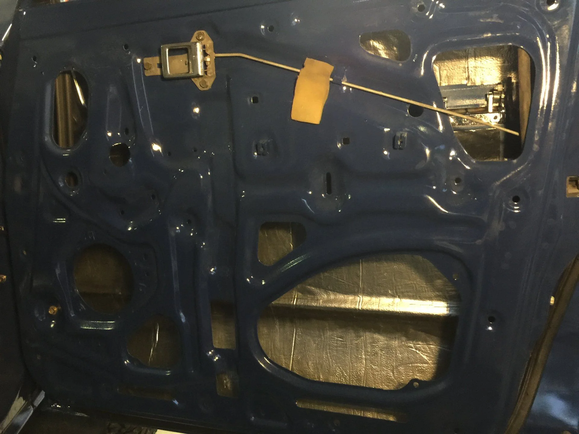

Did quiet crap in the doors. Pretty pleased with it. Thanks to Cim and Roma (& a few others) for their feedback on this s today. Truck is running pretty good. Appreciate the compliments. The motor seems to be running well. Mcguire informed me the idle may be a bit low (650). Seems to buck a bit when luggingbin 1st or 2nd
Yeah yeah yeah! Awesome progress!
