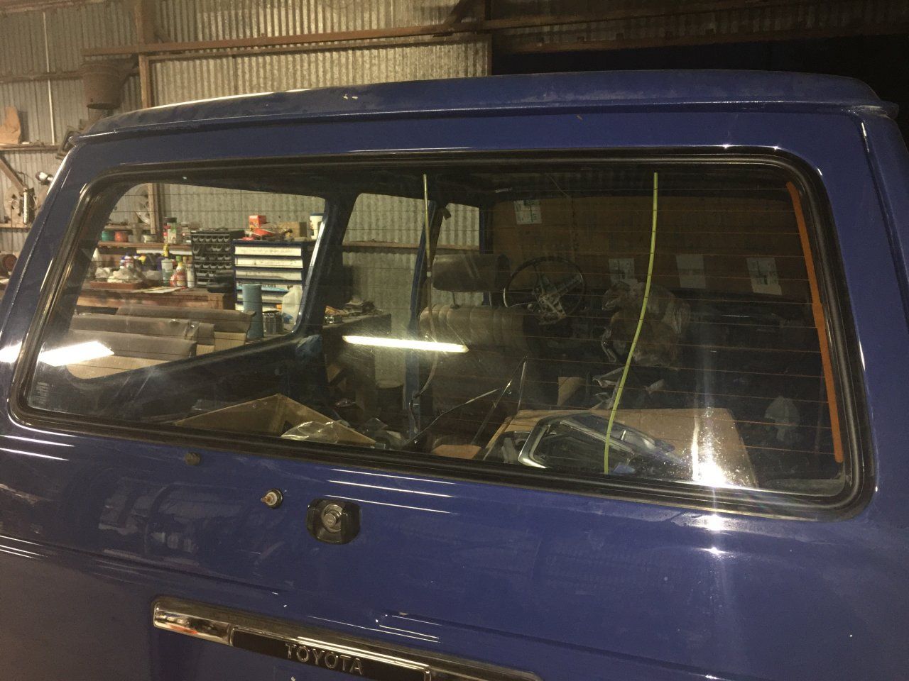

Rear glass in. Was easier than I thought it would be. Have not put the gasket spacer in, but have a roll from Jason that for that job.
Just installed the rubber gasket insert from @reevesci. As he said to me, silicon and some special tool and it's not a tough job. He was spot on. I don't know the name of the tool, but I used one of the nylon interior panel removal tools and it was not bad at all. I have to believe these rubber inserts perform better than OEM. They really displace the gasket material creating a solid seal on the paint/glass sides. Thanks again J.
I usually use a big wide flat head screwdriver to do that job, but I'm sure the special tool made it easier! Looks great!
View attachment 1373054 Just installed the rubber gasket insert from @reevesci. As he said to me, silicon and some special tool and it's not a tough job. He was spot on. I don't know the name of the tool, but I used one of the nylon interior panel removal tools and it was not bad at all. I have to believe these rubber inserts perform better than OEM. They really displace the gasket material creating a solid seal on the paint/glass sides. Thanks again J.
Here is the tool I recommend for this to make it even an easier install.
J
Amazon.com: Lisle 47000 Windshield Locking Strip Tool: Automotive
Actually just looked at it online. That's kinda like cheating :). My nylon (guessing on the material) pretty much worked like a flathead. Sure the Lisle would be faster though.
HELL YA! I can do all 4 pieces in about 10 min nowadays...
