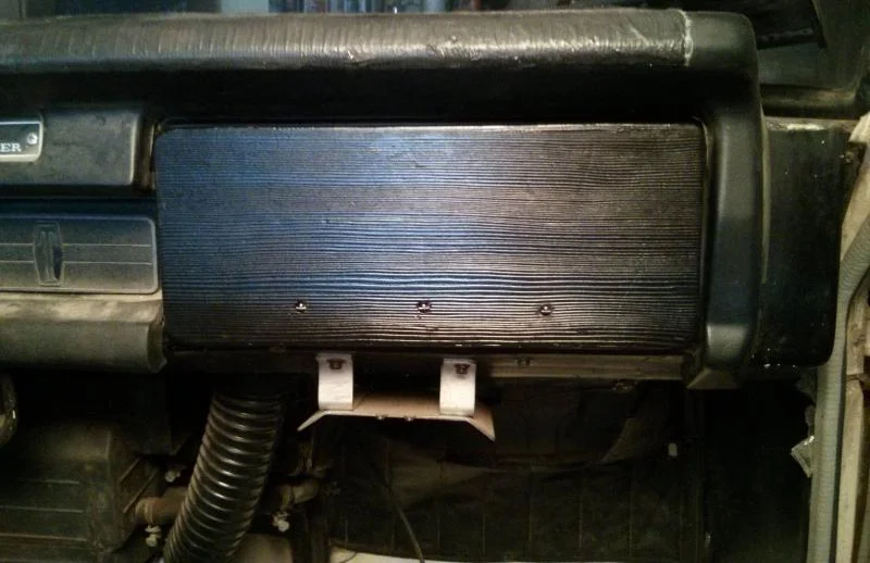

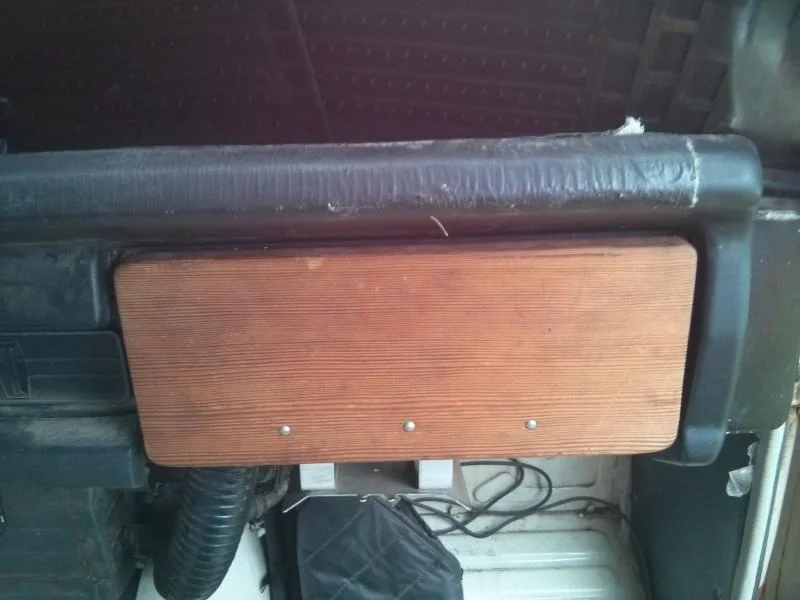

Glovebox painted
This is my greatest work yet in auto painting. Which means I've still got a lot of room to grow.

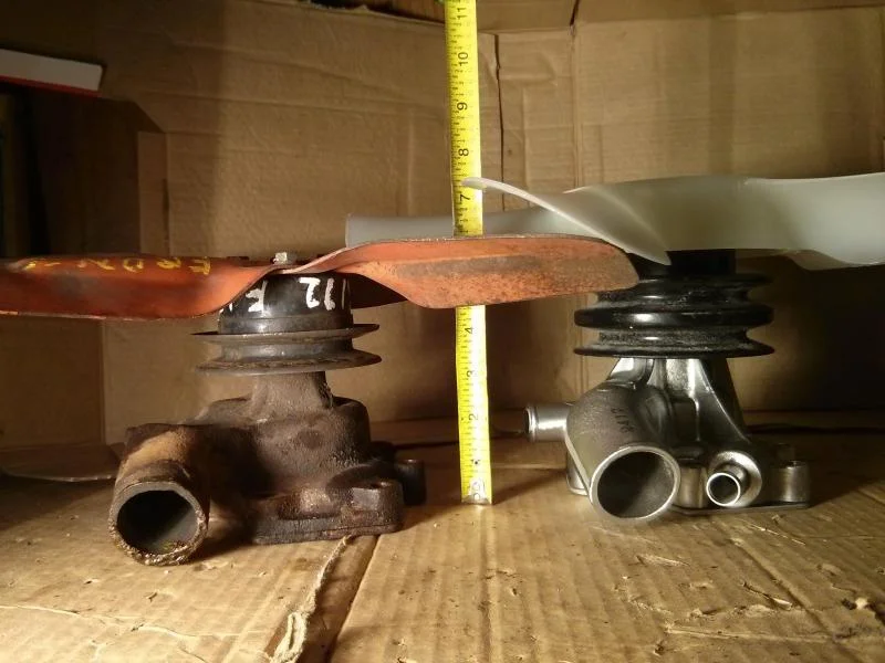

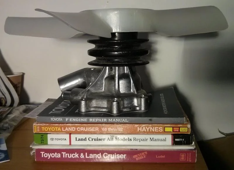

Water pump sub-assembly for 2F in early FJ55
Here's the new water pump and fan along with new-to-me used double-groove, deep-dish pulley. All 3 are from SOR. The fan looks misaligned in the photo but it spins evenly.
I do not have the spacer disk as shown in the following thread:
https://forum.ih8mud.com/40-55-series-tech/278560-f135-4-blade-fan-upgrade.html
Anyone know if I'll need the spacer disk either for getting the fan away from the fan belt or for getting the fan further into the radiator's shroud?
my set up uses NO spacer between the fan and pump flange/pulley...On a 2F, prolly not needed; an F may be a different story. I believe the water pump used on the engine in that other thread is a different depth...HTH
Satin Colonial Red paint in outdoor lighting
Pablo: great books, every one has something of value.
Lambcrusher: good point, that probably is a different pump
Here's a shot of the painted door in outdoor lighting. My paint job is nothing to be proud of but it's just about rust control and "blending in" until a real paint job happens. The color is not a a bad match and if I took off some of the dead oxidized paint maybe better (not gunna happen).

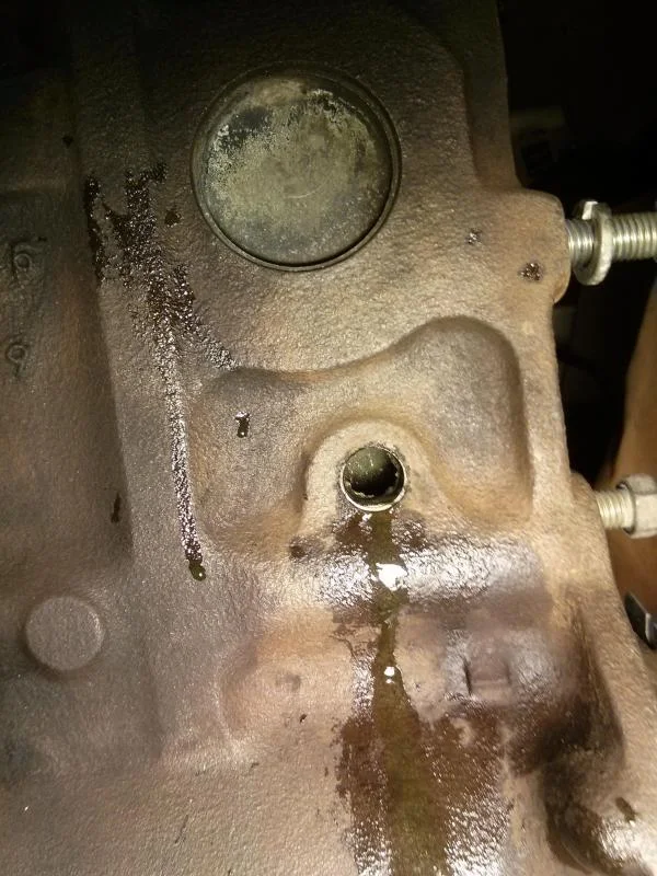

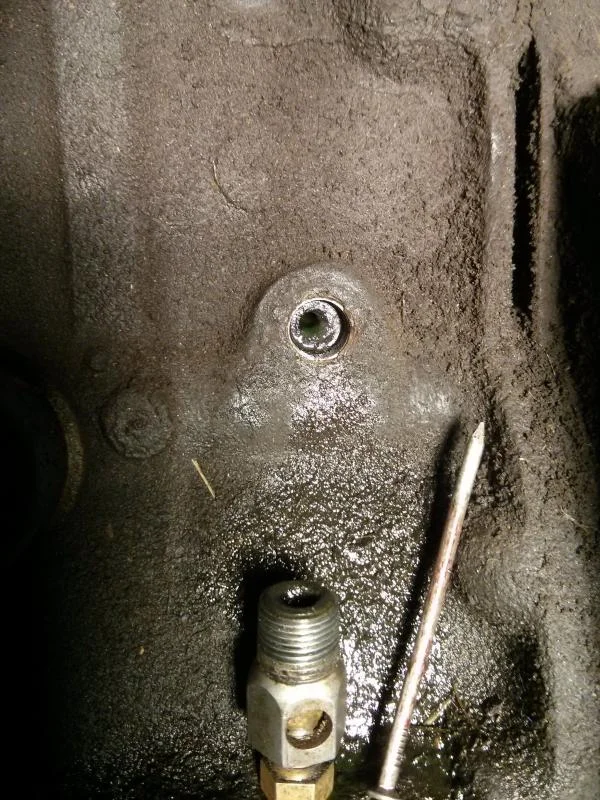

F and 2F engine draincocks
Dirty situation is the dead F (first pic). The clean engine block is the replacement 2F (second pic). In both pictures the draincock has been removed. The draincock can be seen in the first picture.
The draincocks seem interchangeable between the F and the 2F. The draincock it a two part affair; a brass part (14mm socket) threads into a steel part (19mm socket) which threads into the engine block. There is a hole in the side of the steel part which can be easily missed upon casual inspection unless observed from below. The hole is installed to point down so the coolant drains through it. The steel part is 33mm long. There is a minimum of 30mm from the surface of the engine block to cylinder #6. So if you can't bury something at least 45mm in, there may be some undesirable buildup in there. Other threads here on MUD state that this is where build up gets bad in these water jackets.
This F's water jacket was so badly gunked up I had to drive a nail through it to get coolant to flow out. The build up is visible in the F's picture; that inner ring is just hard crud not part of the engine. Fortunately the 2F seems to have been well maintained. That and the fact that I saw the engine running before it was pulled is making me hopeful that this 2F is in good shape.

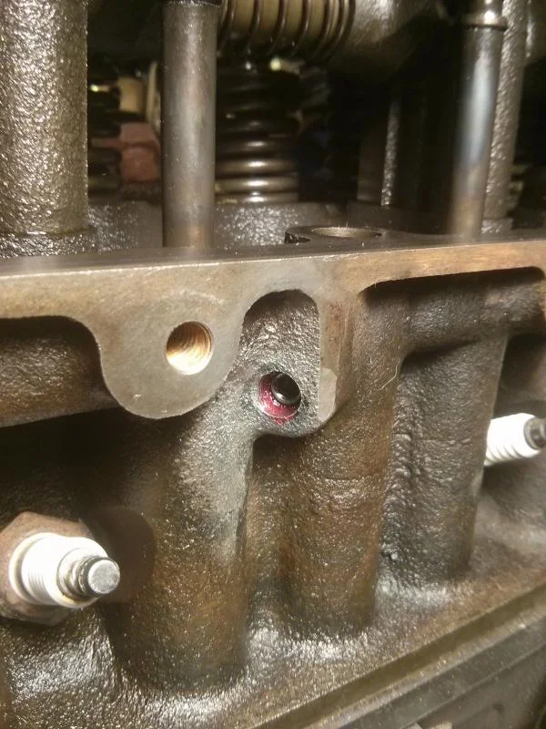

Problematic oil gallery plug in 2F cylinder head addressed
Thanks.
Tapping chips were contained by removing the cylinder head bolt and plugged the gallery hole from behind. My first attempted was to use engine assembly lube as a plug but that was a bit runny so not a good idea. Filling the flutes of the tap with grease and periodically removing and refreshing the grease and the captured chips was a good idea (screwbird's tip).
By leaving the cylinder head bolt in place while tapping, with a rag wrapped around it to catch any chips, that stopped the M8 x 1.25 plug tap at the perfect depth such that the taper on the plug tap head left original metal for the set screw to stop at and snug up against when installed later.
Since I messed up my first attempted I ended out tapping most all the hole to where the cylinder head bolt is and using 2 set screws. I got that idea from Texican, but I used M8 x 1.25 set screws. No drilling required for me.
https://forum.ih8mud.com/showpost.php?p=4368789&postcount=23
In the first picture, where my finger tip is on the machined surface to the head bold is 23mm. I guess when the engine is running oil comes up around the cylinder head bolt and passed though the oil gallery up to the rocker assembly. (In the pic the gallery goes away from the cylinder head bolt to the NE; oil flowing below that raised bit in the top of the cylinder head.
The set screws are about 8mm long. In the second picture, you can see at what depth the second set screw ended at. You can also see where I messed up tapping the first 7mm of what could have been good threads.
Threadlocker Red was used. I never knew Green and Purple existed as well. I'm stocking those now, as well as a can of their Surface Prep activator.

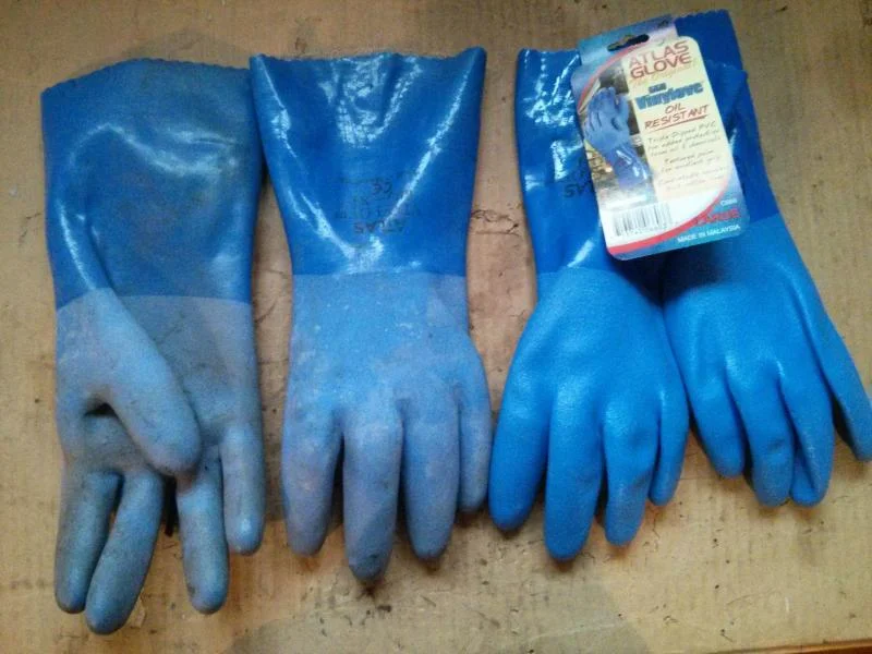

Vinylove gloves
I'm sure the kids in the marketing department had a good laugh naming these. Nonetheless, at US$6 for a pair these are now my go-to gloves for non-precision work. Lesser gloves don't stand up to some harsh chemicals nor getting banged around (a mason I know uses these in Montana winters); heavier gloves lose too much dexterity.

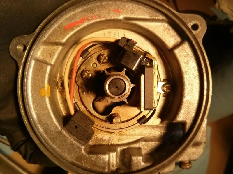

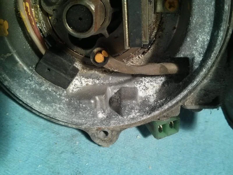

2F stock distributor from mid-80's FJ60
Tag on outside of body, right below vacuum advance says "19100-61102" and below that "029100-6821"
I decided not to do a total overhaul because I'm not tooled up to deal with removing and replacing the peened pin on the cam drive gear. Replacing that with simply a roll pin didn't feel right; maybe I'll do that later if someone confirms that as good enough. Although I'd like to overhaul the ball bearings in there, the main shaft turns just fine at this time. Clean up around the sensor simply involved mechanical and a vacuum cleaner.
After removing the vacuum advance unit the sensor rotation ring was very, very gritty when turned by hand. I don't have a impact screw driver and the screws holding that ring down were not respecting my screw drivers. So, I ended up just spraying some Super Lube dry-film in between the rings and working things back and forth until it loosed up pretty good. I dabbed a bit of Super Lube synthetic grease at the point where the vacuum advancer arm attaches to the sensor's rings (yellow). It's not perfectly smooth but good enough for now.
I've got another one of these distributors as a spare. That one might get a total overhaul and this one will be the fallback in case something goes wrong. Purple thread locker was used on the vacuum advance mount screw. Moving on for now.

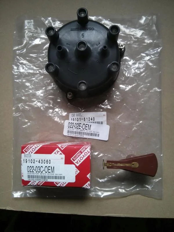

2F stock distributor related links
Pictured are Toyota parts I got from SOR.
