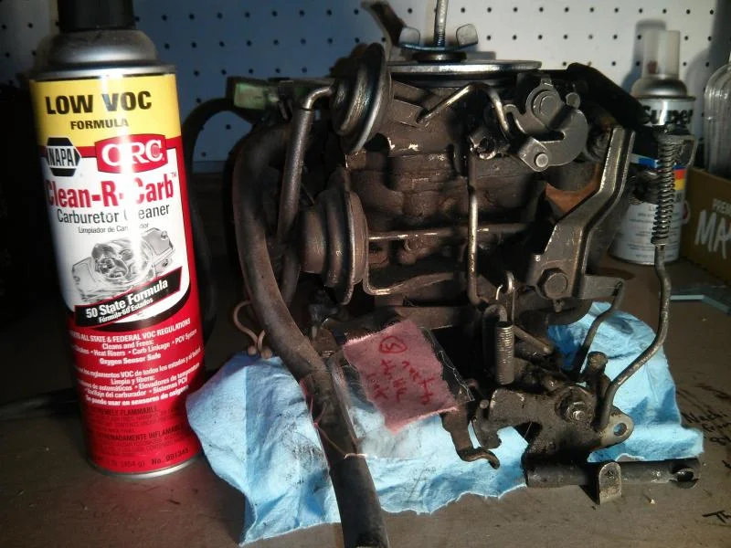

Dirty FJ60 carb
Post vacuuming, pre-shower. Tomorrow I'll see what that can of carb cleaner is capable of.
I don't know what I'm doing but washing it down cannot hurt, is the thought. I'm hoping to get lucky and just bolt it on in order to postpone opening it up, breaking it down, and giving it a proper bath in Berryman Chem-dip or such.
After the shower, in the background is a bottle of Super-Lube. I'm thinking to finish with some teflon perfume, on the outside only, while manually exercising all the linkage.

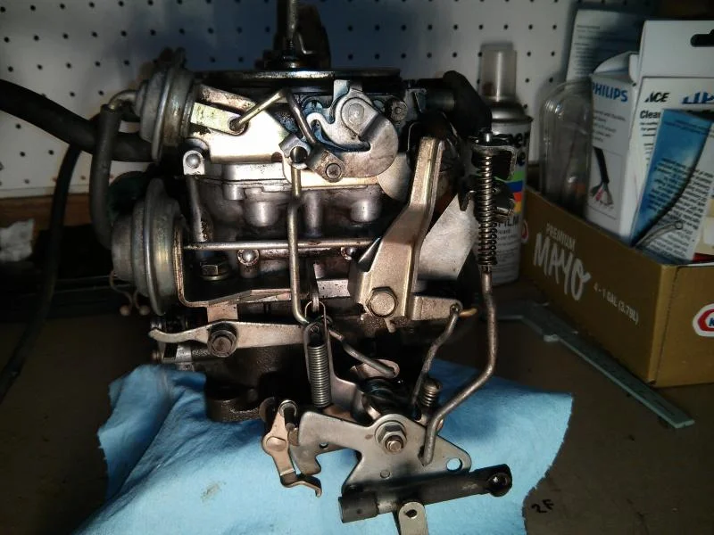

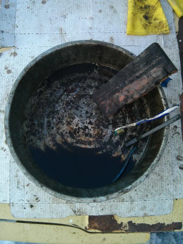

Cleaner FJ60 carb
3 spray cans of carb cleaner later. I ran out. 2 more should finish the job tomorrow. This was all external spray and scrub with a toothbrush.
This carb is much happier already. The linkage is much freer and both butterflies rotate easily which was very much not the case this morning. The idle adjustment screws look virgin. This carb may never have been screwed with.
I'm trying to get away without tearing down the carb but I wonder if removing the plugs to the jets in the bowl (right below the sight glass) and spraying some in there would be too clever by half...

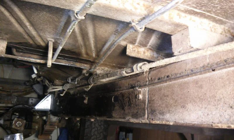

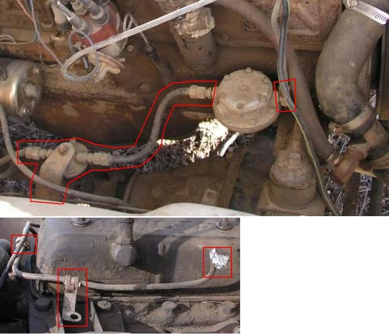

Fuel return line
Another gift from the giving truck: a fuel return line. This came off the donor FJ60. Thanks for the clue-in JimC.
Seems that Toyota changed the fuel pump in 1/79. Before that there were only two ports on the fuel pump: one line from the tank and a second went up to the carb. I'm not clear on this but it sounds like there were fuel return lines on some of the carbs before 1/79, again not sure. Then with the later fuel pump the third fuel fitting appeared on the fuel pump and that one is the fuel return line.
This 6/72 FJ55 does not have a fuel return hard line (nor fuel hose) and I hear the stock gas tank didn't have a port for fuel return. This truck does not have the stock fuel tank, rather it has an aftermarket 30 gallon tank which came with a port for a fuel return line, which seemingly was simply plugged:
https://forum.ih8mud.com/fj55-iron-...rivetrain-swap-84-fj60-drivetrain-13.html#242
Currently, a 2F with a 3 port fuel pump is going in the truck and there is a fuel tank ready for a return line. So, a hard line connecting the two would come in handy. JimC pointed out that something fitting that description was to be found under an FJ60.

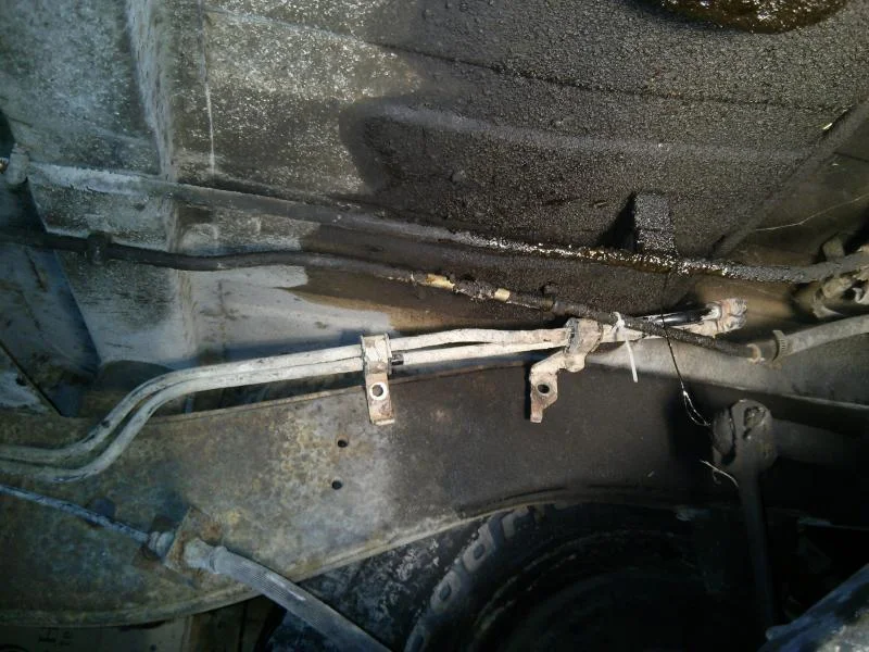

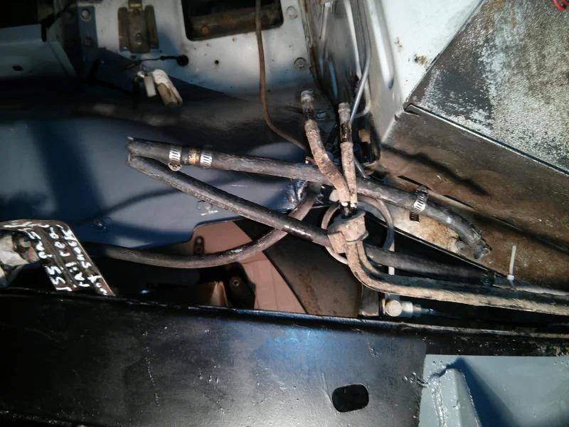

In these pictures it's just zip tied to the body. Note the donor actually gave two lines which are paired together via some clips; I will only be using one of the two. After the engine and other parts are installed I'll permanently affix it. Kinked up from the factory to follow the frame rail closely the FJ60 fuel line none the less fits very well in the FJ55 with the ends very close to where the stock fuel hard line routes to.
There is a very brittle, bend in half, cracked fuel hose in the third picture. Given its condition, all fuel hose in the vehicle will be replaced. The well lettered small bracket on the left is where the stock fuel filter was, it seems:
https://forum.ih8mud.com/attachment.php?attachmentid=875133&stc=1&d=1394729638

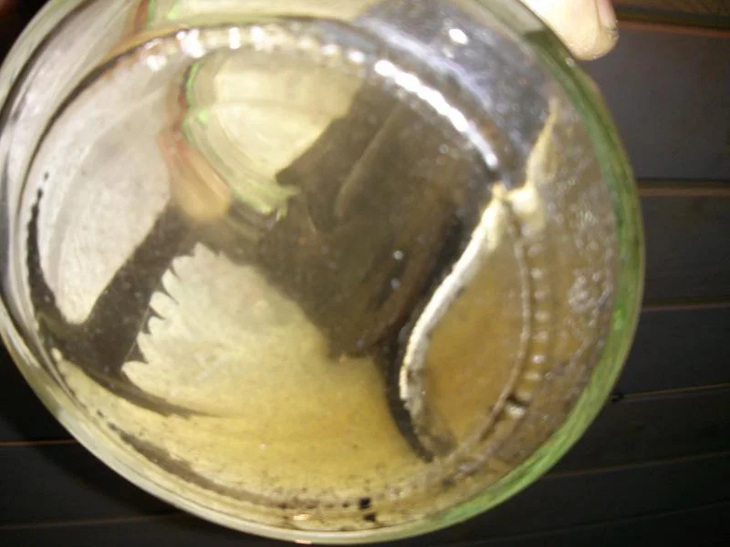

Carb insulator and bonded gasket materials versus naphtha. Let's see where this goes over the next 24 hours.
[EDIT: a day later, nothing. The naphtha didn't touch the insulator, it's bonded gasket, nor the bonding material. At least that demonstrated that naphtha is a safe cleaner for the insulator-cum-heat-shield. Still trying to figure out how to safely separate the broken gasket from the insulator.]

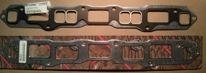

SOR manifold gaskets
In this picture are 3 manifolds gaskets: 2 identical 2F gaskets and 1 F gasket, which is stacked atop one of the 2F gaskets.
http://www.sor.com/cat044.sor?tabpage=TAB5
F: 044-01B Manifold Gasket - Fits 1968-1974
2F: 044-01C Manifold Gasket - Fits 1/75-8/87
Not clear to me if these are OEM.
Consensus seems to be that the gasket to use is OEM or Felpro, which might even be the same thing.
Mixed reviews on the newish Remflex technology. Mark W says avoid the SOR Kevlar:
https://forum.ih8mud.com/showpost.php?p=1657425&postcount=17
For the 2F: "OEM Part number: 17172-61020 / 17172-61030 / 17172-61031 / 17172-61040 / 17172-61041"
http://www.fjparts.com/75-87-land-cruiser-fj40-55-60-manifold-gasket-p-1708.html
Big take away message seems to be that manifold bolts should be repeatedly retorque during the first weeks after install or at least retorque after about 10 heat cycles, engine does not need to be warm:
https://forum.ih8mud.com/showpost.php?p=1671912&postcount=26
Some people seem to like to double up the gasket in order to help prevent leaks.
https://forum.ih8mud.com/60-series-wagons/125958-double-manifold-gaskets.html
https://forum.ih8mud.com/showpost.php?p=2905657&postcount=36
"i double up the felpro gasket party w/ some aerosol spray copper coat. i've tried several combos but this seems the seal the header the best."

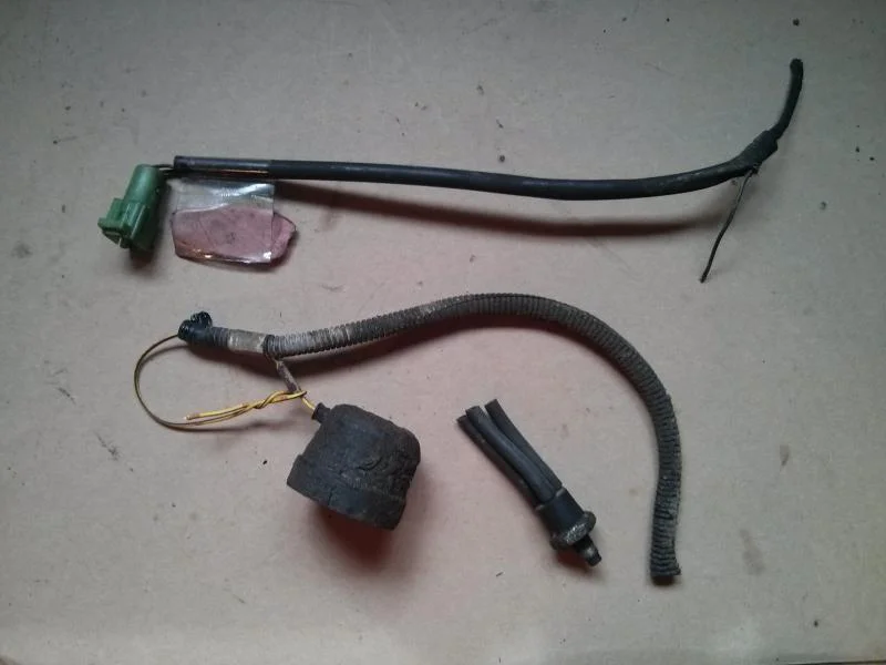

Here's more bits I pulled from the donor FJ60. I should have pulled these when I pulled the carb and emissions bits:
https://forum.ih8mud.com/fj55-iron-...rivetrain-swap-84-fj60-drivetrain-18.html#352
The green plug is for the carbs idle cut solenoid.
The dirty cap with yellow wire is the weather cap for the oil pressure sender unit.
The doodad with 3 hoses coming off it is the "gas filter" which is to be found on the front top of the intake manifold, useful if someone removed it while putting on a Weber and the truck is now being de-Webbered back to the stock Aisan (not to be confused with "Aisin" or "asian") carb.
So, consider adding these to your shopping list next time you're raiding a donor truck.
Also grab:
-The plug that goes into the FJ60 alternator. Very useful if upgrading any earlier Cruiser to the internal regulated 79-87 alternator.
-The plugs that go to the ignitor (power in and tach out).
