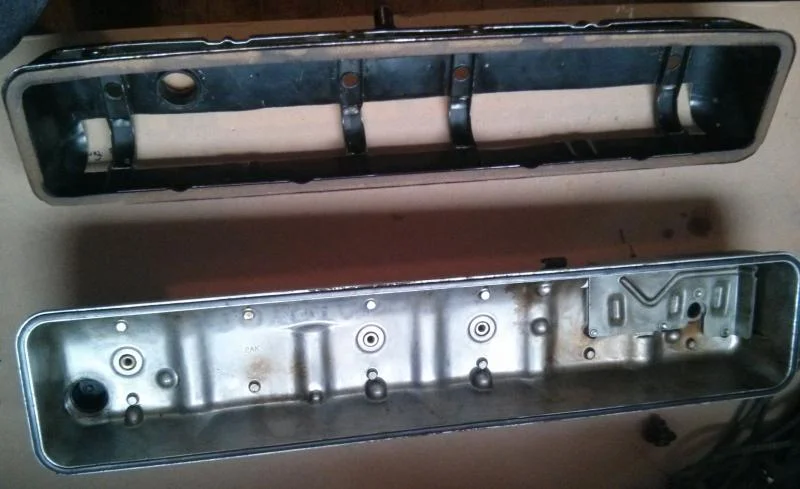

F valve cover modified for valve lashing
I learned about this idea when I had a Corvair. In the case of a flat-six engine, like the Corvair's, a cut valve cover is very helpful for containing oil while doing a running engine valve lashing.
http://corvaircenter.com/phorum/read.php?1,354190,354190
In the case of an inline-six, like with these Land Cruisers, this little (yet to be tested) project may turn out to be a waste of time but I do see some folks on the Web doing it for other inline-six engines.
http://www.inliners.org/ubbthreads/ubbthreads.php?ubb=showflat&Number=43363#Post43363
http://www.hotrodders.com/forum/best-way-adjusting-valves-sbc-132599.html#post923702
At the least it was a small project to start learning about working with sheet metal. For example, it would have been nice to know this procedure for spot weld removal before I started:
http://www.youtube.com/watch?v=A3Cw58U0I4Q

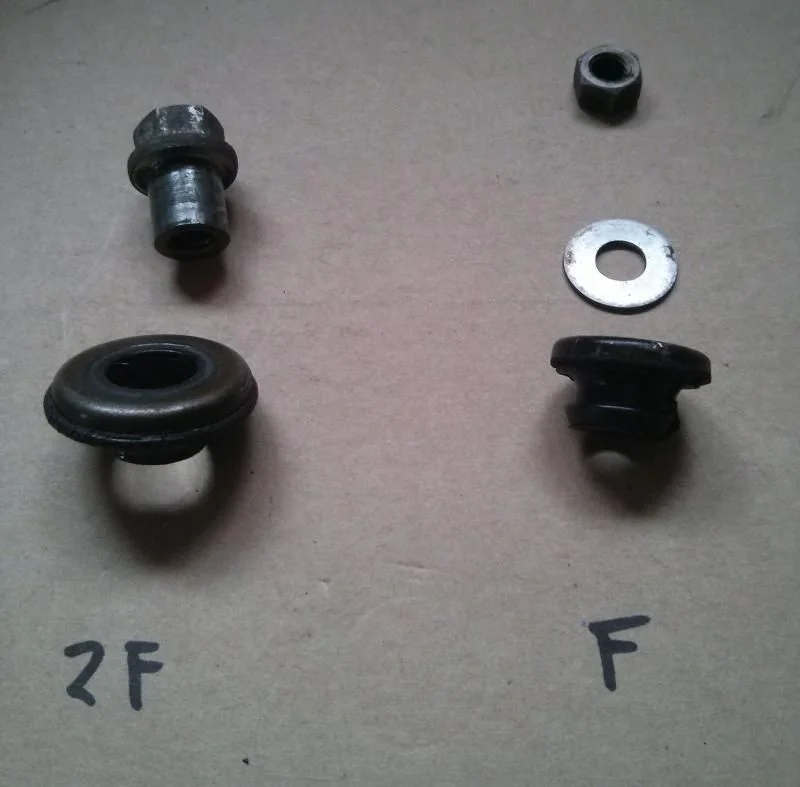

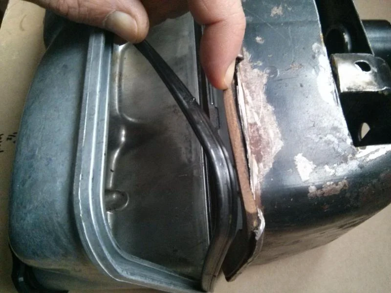

This is the valve cover off an F engine; it's just stamped sheet metal spot welded onto some ribs. It fits well where the greatly improved 2F valve cover (cast? aluminum) goes on the 2F. I needed to use the specialized nuts that hold down the 2F valve cover as the studs atop the 2F valve rocker assembly are shorter than those on the F. Only new parts are four 1/2" flat washers to spread the load a bit.
I'll edit this post later when I actually get to trying it out on a running engine. I hope I didn't cut out too much metal.

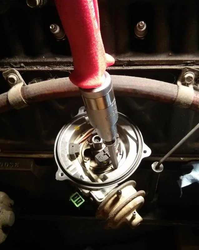

distributor breaker plate hold down screw removal
Got my first impact driver today. Nice tool! How did I get by without this for so long?
A dead F engine block makes a great vice for holding a distributor while removing the obstinate little screws the hold the breaker plate down in place.

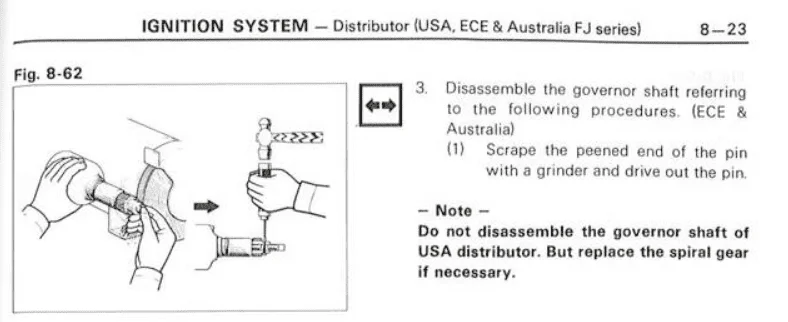

Here's Figure 8-70 from the August 1980 2F Engine FSM. Sure looks like the distributor I have out of the 10/83 FJ60 and from digging in sor.com it seems like the distributor stayed the same from 8/80 to 8/87.
http://www.sor.com/catproducts.sor?from=022&part.number=022-01&tabpage=TAB3

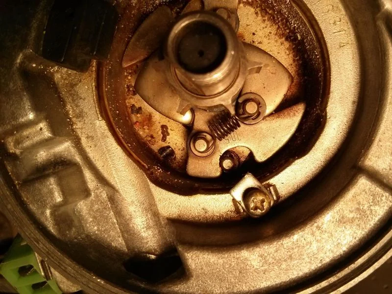

Late 2F distributor internals
Here is what things look like under the breaker plate.
Below the "10.5" marking is the governor pin. The pin's bushing has broken down. Black bits of the pin's bushing can be seen on the floor to the left of the pin.
I read that Jim C. uses brass tubing to replace the bushing (although the distributor will work work without a bushing seemingly). I'll see what I can find at the hardware store tomorrow.
2F distributor governor shaft
Breaker plate is all bound up, super gritty but looks to be easily overhauled with nothing more than a small screwdriver. Clean it up and Super Lube synthetic grease to its ball bearings.
Main governor shaft seems to be in great shape. The FSM seems to say don't disassemble it so I guess stop after lubing the governor weights and adding a new bushing to the governor pin.

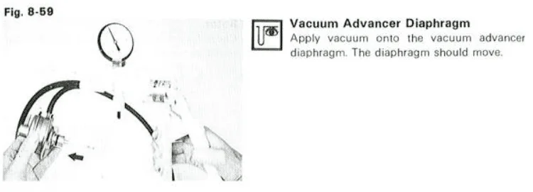

Be sure to test the vac canister for leakage.
New ones are NLA, so if it is bad...:meh:
Both ports hold 600 mmHg of vacuum for over a minute.
Inner port moves "arm" about 4mm, outer one moves it about 1mm.
I am still not clear about which one I will want to use. Seems people are using only one and opinions differ as to which one. I am hopefully going to put something on the governor pin to replace the bushing which is shot. This truck will spend most of its time at sea level, occasionally spending some time at 3,000 ft. I am not even sure if that is relevant. I will revisit this once the engine is running.

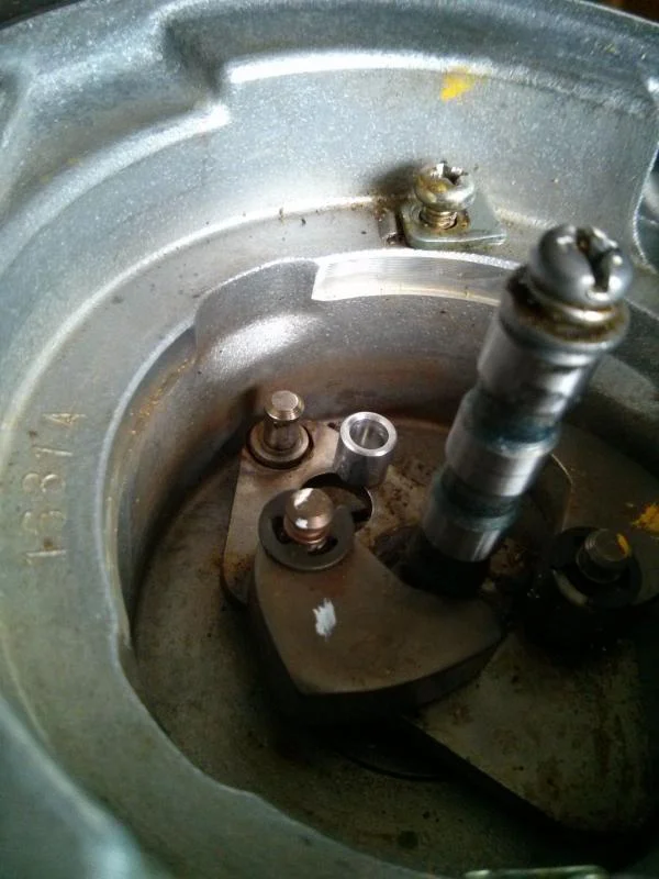

Potential distributor governor pin bushing
The best thing I found at the local hardware store for a late 2F distributor governor pin bushing replace is this thing; in the first photo it is just siting close to the pin it might get installed on. I heard of Jim C. using brass tubing to replace the bushing. This is aluminum so not sure about that. I'll need to shorten it a bit but the grinding wheel should make quick work of that.
Does anyone know what the O.D. of the stock bushing was?
P.S. This came from the local Ace Hardware store.
Neat find on the bushing. I love finding stuff like that at the local hardware. Brass would wear better, but in a pinch alum will have to do.
Maybe try McMaster-Carr.
