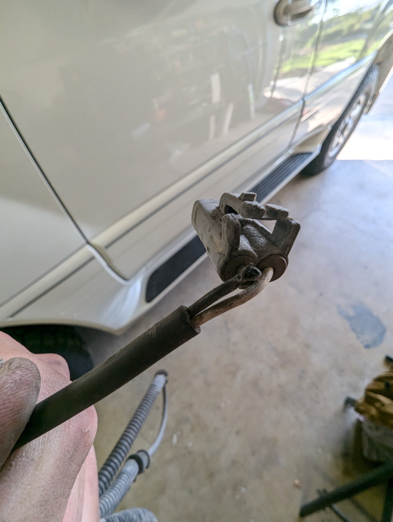

I think the issue is fixed! BAD WHEEL SPEED SENSOR!
After figuring out which sensors were giving me a speed reading on my OBD2 through unplugging different sensors on transmission, the final option was wheel speed sensors and it turned out this is where the speed was being derived from. Jacked up 1 rear wheel while in accessory mode, spun it hard and sure enough the speed value on my app moved.

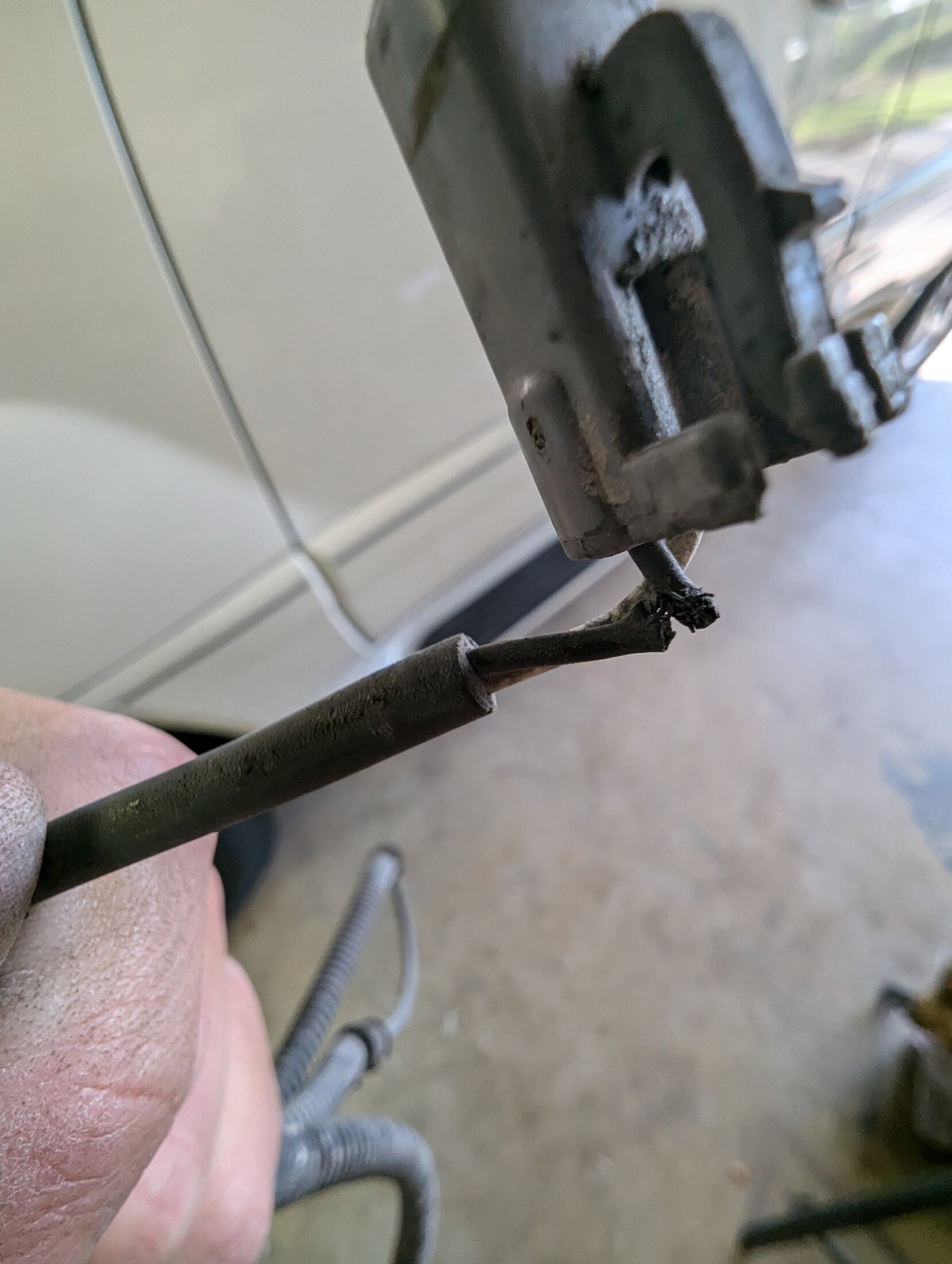

Then, using the FSM, I wrote down the resistance value range for speed sensors. Note- fronts and rears have different values. Fronts and driver rear were all in spec. THEN, I looked at passenger rear and the wire was almost completely gone. Only a couple strands holding it together. Below is a photo.
Also, the way the rear passenger wiring is done, it is a REALLY TIGHT fit with strain on wire. Other 3 seem totally fine, no strain. To be fair, this is probably original sensor and still had 335k before starting to short out.
As for replacing, no local dealer had sensor in stock and dealership price was like $330. I went to AutoZone and picked up a duralast branded sensor. I happily discovered that the "duralast" speed sensor was made in Japan with Aisin on the sensor. $130 for Japanese made sensor, most likely near OEM quality.

Great and thanks for posting cure. But strange you didn't see a CEL with wheel speed sensor DTC. Nor dash light-up and ABS/ATRC/VSC shut down.
When we first turn on IG key. System goes through selftest mode. We see all dash warning & indicator lights come on for a few seconds. Do you?

1. All the dash lights do indeed come on when turning on car. No CEL or ABS/Vsc. I do not really know why. My best guess is that the sensor was shorting out but I do not know how the computer interprets the wheel speed sensors or maybe averages the speeds out? If so, perhaps the sensor/wire was still providing information (to some small degree) and therefore not totally "dead". Perhaps if it was totally dead, it would have triggered a warning light? When the issue presented, the speed reading derived from OBDII did NOT go to zero, rather it would not read past 26 mph, and subsequently that speed is not high enough for 4th gear to engage.
