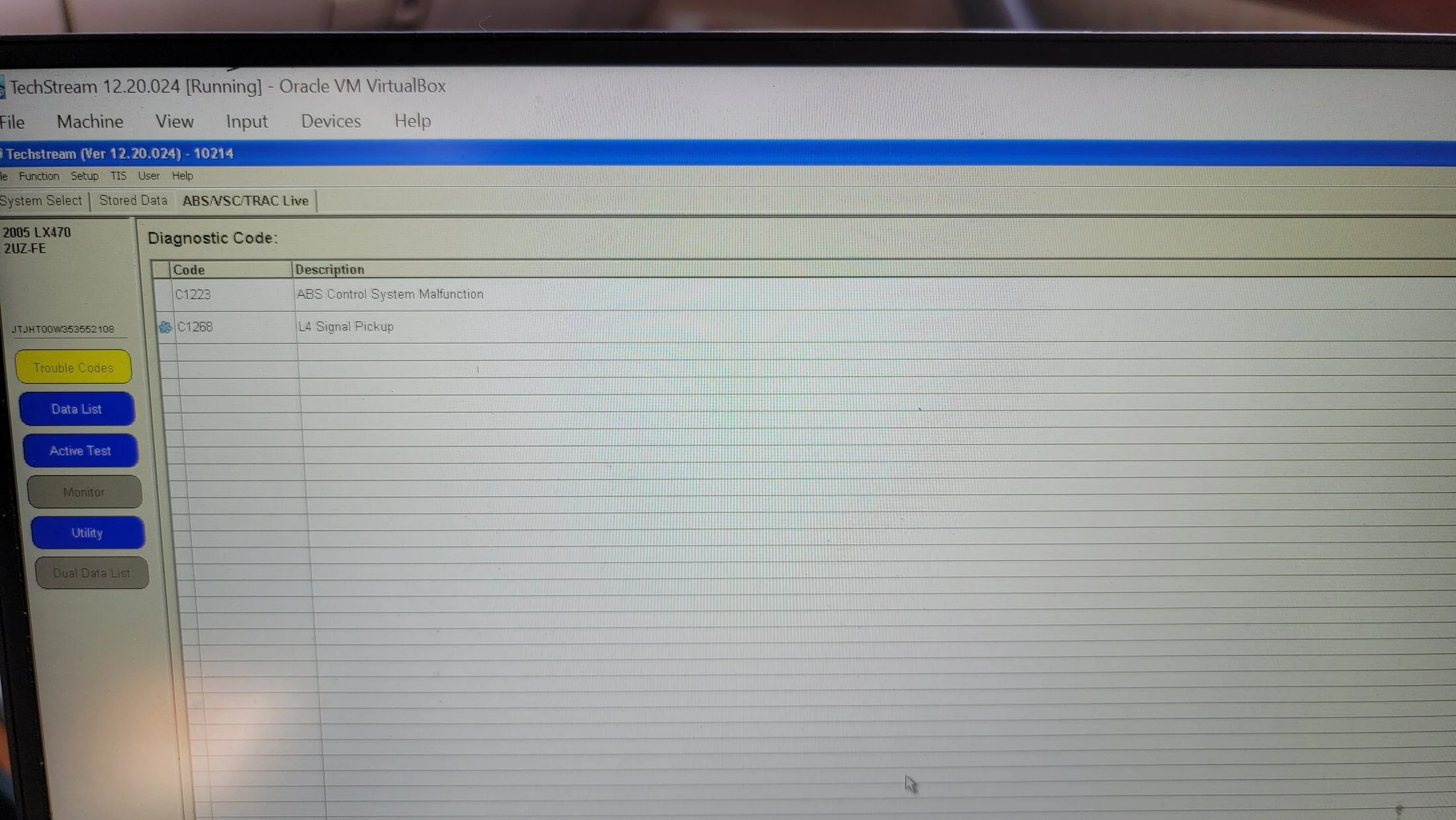

At this point, I've changed the transmission control module, the ECM, and the complete trans. The only thing not changed is the trans wiring harness.
Pulling codes at @cruiserpatch 's place now and this is all that comes up. No longer a solenoid code.
