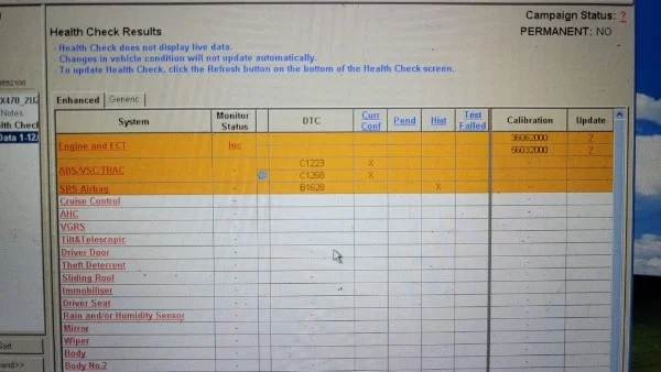

So I got TechStream on my laptop. Took it outside and pulled the following codes:
I tried clearing the top 2 codes (both in ABS/VSC/TRAC system) and neither seemed to clear. They never left the screen. My ABS light did go off, but it has been intermittent. Exiting TS and then retesting gave the same codes. Am I now looking in to the wiring harness (again) or the ABS/Skid control ECU?
Also confirming, clearing the L4 pickup code (which is the 1268) did not seem to change anything in driving. Still locked out of 5th. My new sensor/switch arrives tomorrow. I will install it, put my rear shaft back on, and see if anything changes.

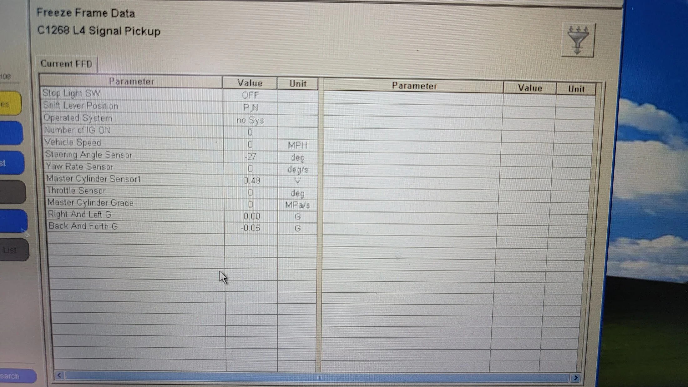

What does the freeze frame data look like on that ABS code? Should be able to pull it up by clicking that blue cloud.

Good question. I wondered what the blue logo was. I will check in the morning.

Am I understanding this correctly that the truck is saying the trans is in park and case is in neutral?
If that's the case, that's probably something. Trans was in park but case was in high. Moving the case lever to low and rechecking did not change it.
I did also clear the airbag code and it went away. The other 2 mentioned yesterday are still present and cannot be cleared.
I don't know what I did, but I was able to clear ABS/L4 the codes finally. They went away from the screen in TS. "Brilliant!", I thought. Until I put my foot on the brake to put the truck in gear to drive, and the codes both popped back up immediately. I have not been able to clear them again.
Hmmmm, I'm actually not sure. When you pull up the transmission page, how do those values change as you cycle the transmission & the T-case lever?
Charging laptop now but I will try again. Changing the case lever did not change, but I didn't try changing the trans lever.
That doesn't shock me - best we can tell, your transfer case has zero idea what position it's in, hahaha.
