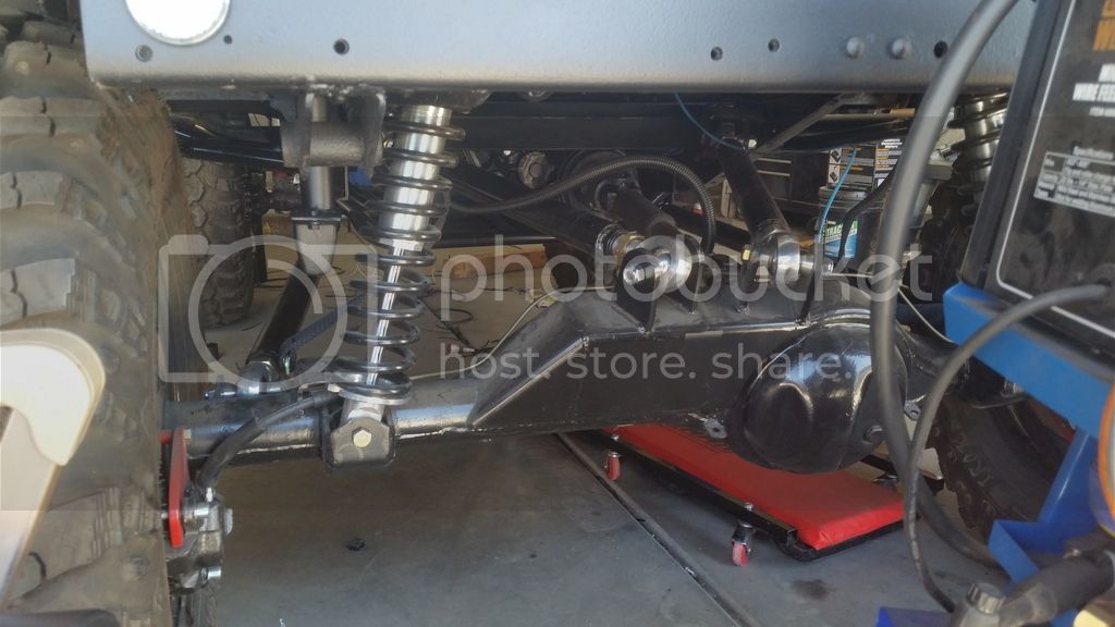

Thanks, I've been working on the rear links right now and will come back to the front shortly. Need to put the front axle at full bump and mount the power steering gear box. Had to go too school for a couple of days, had to work a couple also.

Get your front three link in before finalizing motor mounts
The upper link mount and front driveshaft want to occupy the same space
I offset the engine to drivers side a couple inches to get driveshaft to clear
I'm running a small block 465/203/205 doubler
I build everything with the suspension at full compression that way you know everything clears

Three links are in in the front.
Neighbor had a steering gearbox from a chevelle. Making a mount for it, everything else has a heave tack weld.
Welded the front axle to the frame at full compression, made it easy. Pulled the AC compressor off.
