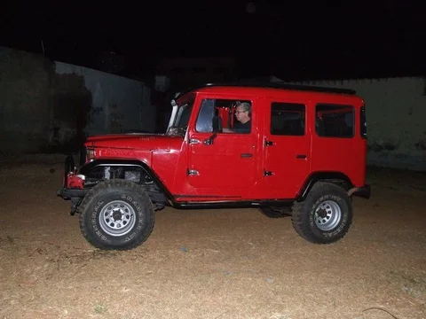

Found this on facebook ,user "toyoteros en el mundo" if you what photos this guy has plenty!!!
That is awesome. Closest one I have seen yet to what I have envisioned. The angled rear door & shortened back end are right on. It looks like they did away with the removable top option. B pillar needs to be narrower, but that is pretty much it. Really cool. Cant wait till I have enough parts to start the build.
