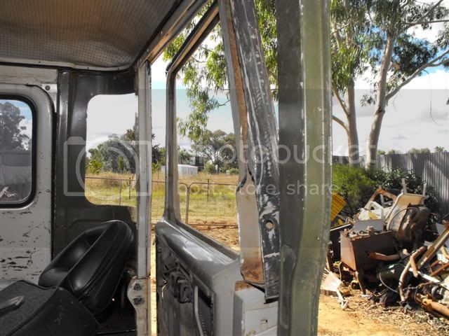

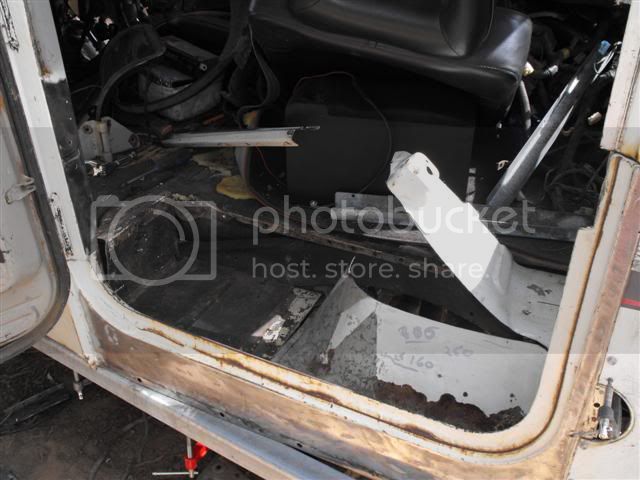

This is my dads project Twin Cab. He has used a full door and lower sill section from a ute cab we had hanging around.
Does your dad plan on running a short or long bed?
We will build a short tray as we are also going to cut the rear chassis off just behind the hangers for better departure angle.
