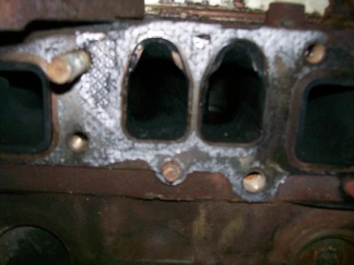

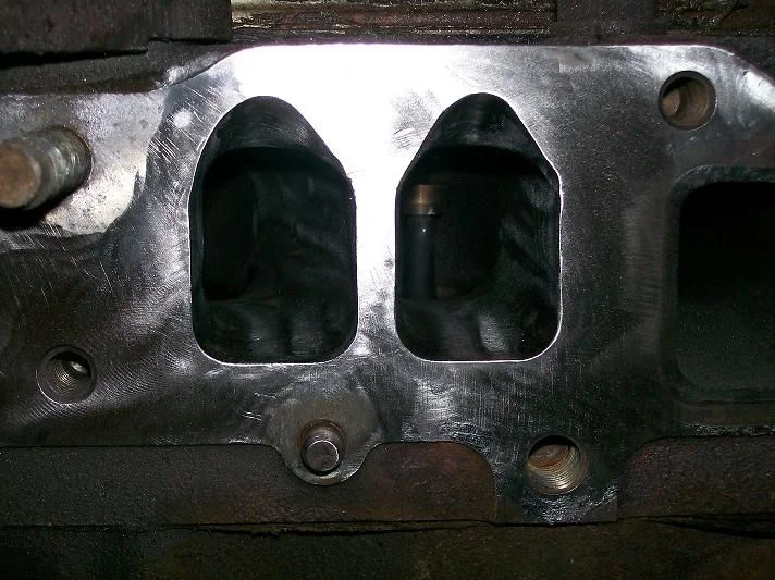

Port and polish
Here are a couple pics of the before and after polish on the head.

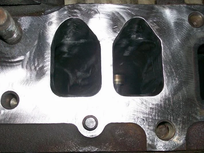

Polished
And the polished close ups. I concentrate on where the injector shot is delivered to the chamber. I open it up and relieve the transition so it has a nice clean shot going in. I will follow up with a smaller grit flex wand and get em nice and pretty.

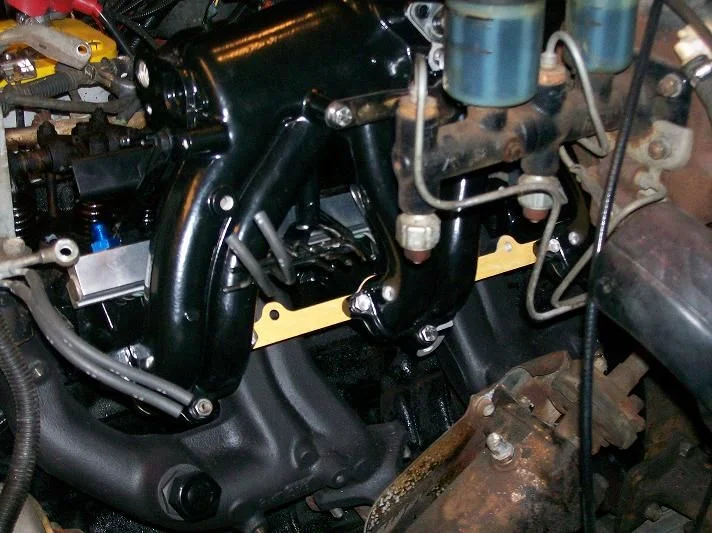

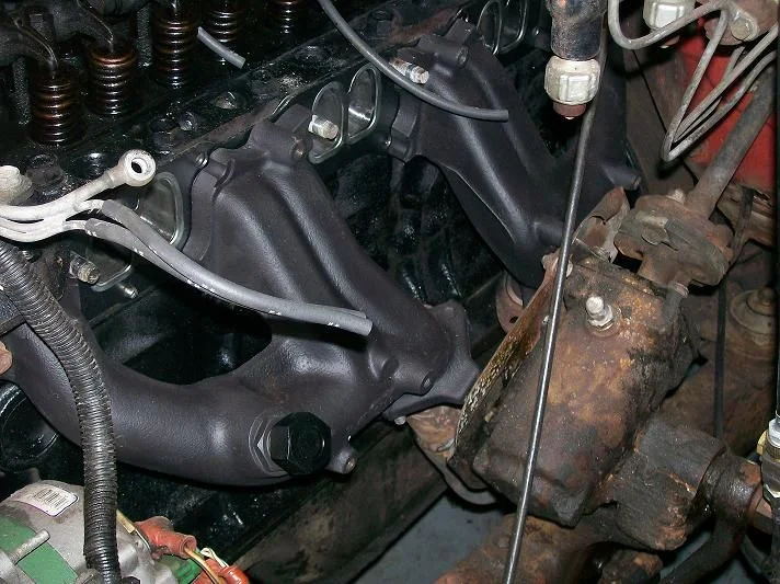

Update
OK Got the head finished off. Working on getting the TB all set up. Yes I am doing it on the bench per the FSM. I have everything else ready to bolt up so I should be ready to go tomorrow afternoon. Trying to get everything cleaned as I go.

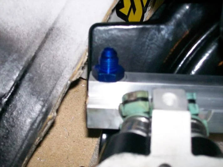

More pics

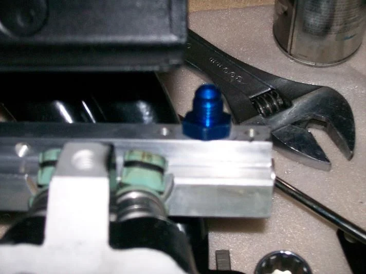

Also I am ditching the vaccum fuel pressure regulator and going with my old reliable. Here are the pics of the frame rail retapped for the -6 an bulk head fitting. This will dispose of the need for a lot of vaccum hose!

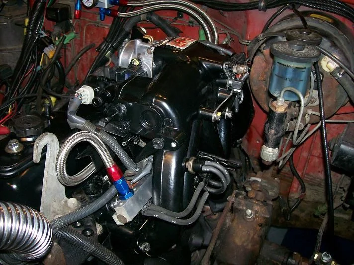

Progress report

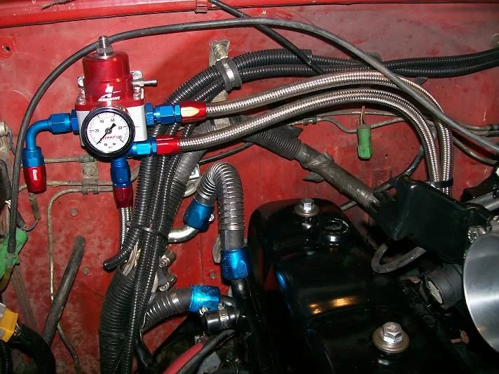

Well the intake is all back together and I have run fuel lines for the new Aeromotive regulator. So here is the progress so contain your DROOL!! I am going to start cleaning up the harness tomorrow before it goes to paint just because it is irritating my creative bug!
Be careful. The booster might not clear the engine with that extra layer of paint. :D
