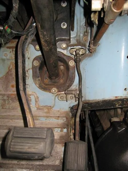

Yeah - my cable route is crap....It's what the PO did and it's a major hack job..Did you see where the parking brake hits the gas pedal. I had to disconnect the parking break the first week I had the truck just to get the gas pedal connected. Iam embarrassed just to post the pictures.
I guess I need to reinstall my parking brake to see if I have any issues. I seem to recall the top of my pedal where the cable attaches is further to the left away from the parking brake.
I used the FJ62 pedal. 1969 FJ40s used an accelerator cable, not the linkage, so I suspect I have it easier. I used the existing hole through the firewall, and modified where the pedal attaches for the FJ62 pedal. I probably will need to bend the pedal a bit to get full throw and keep it off the floor.

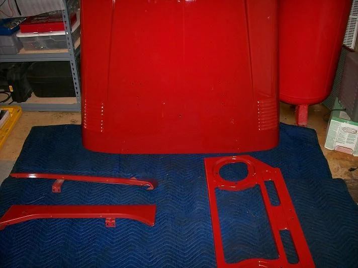

Sorry guys I felt like death warmed over but I did get to put some metal on today and see Lee's awesome looking 62. I still say it is the TPS!!! It did it while it was here. But I was wondering about the smog system may be restricting or failing to vent. But that is another story. Here are the freshly painted parts and the frame work so far. Still need to get the front on and the hood then I can drive it and work out the bugs. THIS TRUCK WILL BE AT THE ROCKS!! :clap: :D

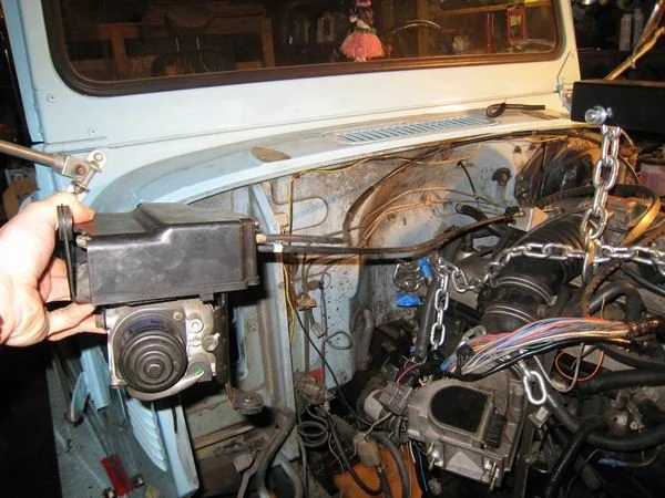

I seem to have it better I guess. I used a dremel to widen the holes of the FJ80 accelerator cable mounting plate and used a file to make the metal end fit in my pedal.... end result is that it looks the same inside.
The cable is insanely long so I might have to do someting about it, but I can route it anywhere I like. The box I'm holding is the cruise control actuator. The accelerator cable comes into it and another cable goes to the throttle.
