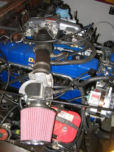

Pappy - do you have a picture of how you routed the air filter and AFM. I would like to shorten mine and maybe angle it towards the PS of the truck, and not out the front. But it does get nice air flow out the front, maybe I should leave it alone?

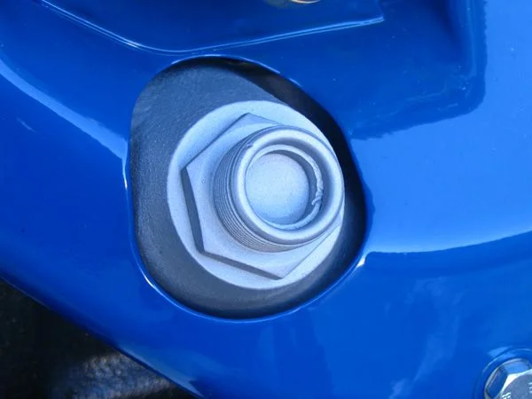

What did you use to block off the EGR attachment to the exhaust manifold?
Are there no 34mm (I can't remember the exact size) cap nuts out there? I don't really like to alter anything, whether or not I will ever use t that way again.
I used an expansion plug, which may or may not work once the manifolds gets real hot. My backup plan is to take another fitting, grind off the threads that stick up, and weld a bolt head into the hole. I might do that anyway.
Iam going to drop a 5/16 freeze plug or a round blank into the original nut off the egr, and add a little RTV to it. The freeze plug I picked up at Napa has a rounded top and matches the curve in the nut so it should make a good seal. Iam then had a few of these Stainless steel EGR plates made. I have a few extras if people need one - just PM me.
I'll bet that fitting is metric pipe thread. McMaster-Carr sells bronze caps in several metric sizes that might work. Not cheap, though.
