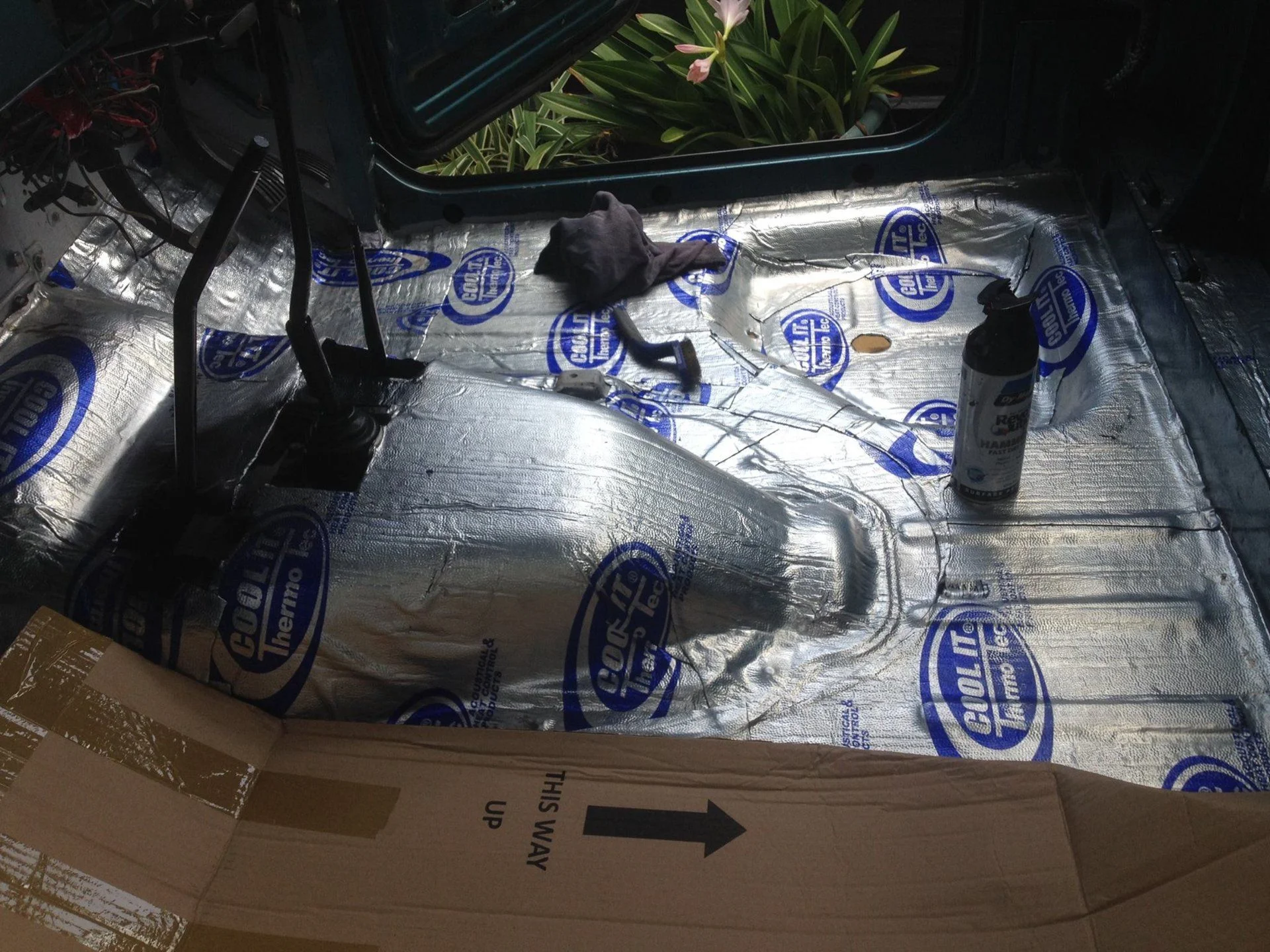

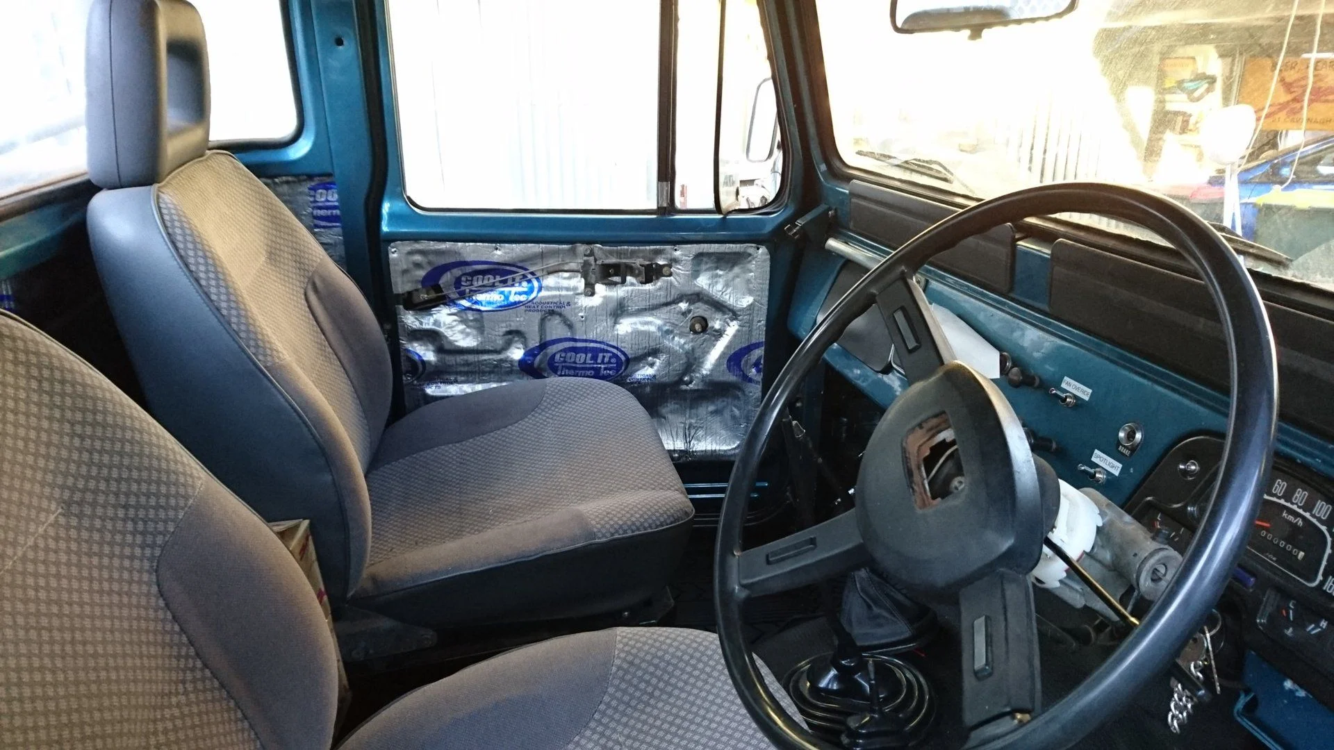

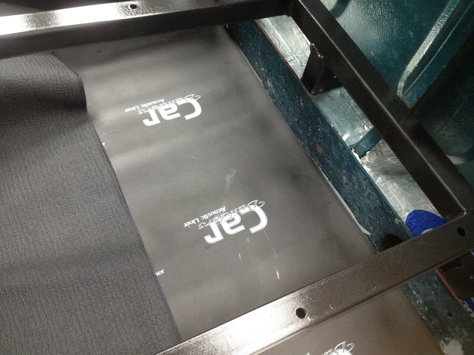

New vinyl Floors with triple sound proofing

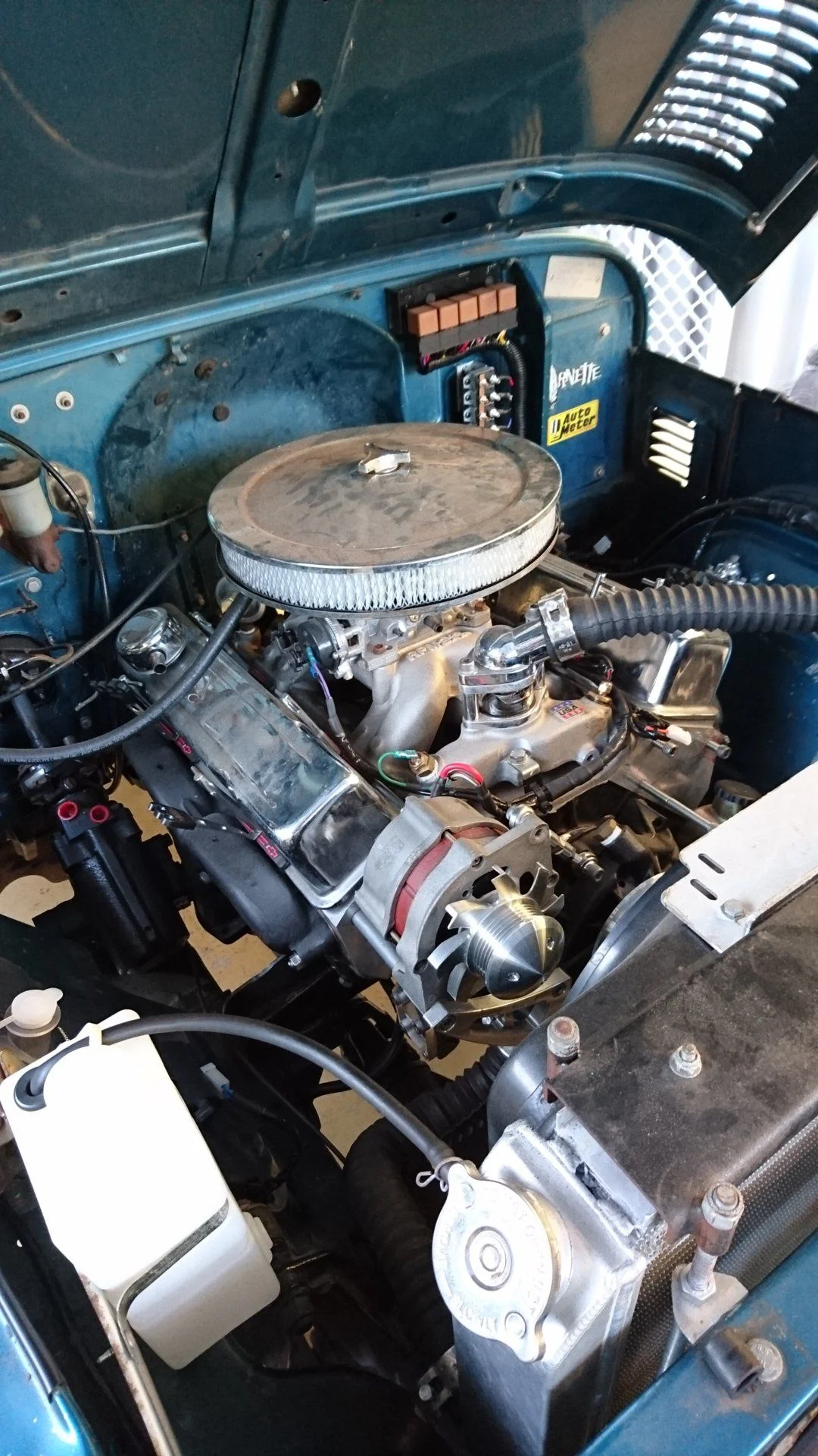

Okay I see what you are saying I should have also mentioned in the original post that I have put a big 3 row or core I can't remember which aluminium radiator and black widow fan but yes I see what you are saying!

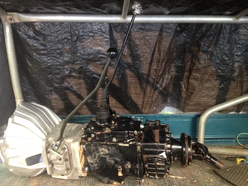

Rebuilt H41 4 speed
Orion TC with lower low ranger gears
Ranger overdrive

Update I should have said it also has a big 3 row or 3 core aluminium radiator with black widow electric fan!
You can just see them in the picture of the engine!
What kind of cooling fan arrangement are you using? I ran a high strung 355 sbc for nearly 20 years in my 76 as a daily driver(Michigan -23*C to 38*C temps) with an Edlebrock carb w/electric choke(looks as though you're running the same carb?) and stock clutch fan and both stock radiator and aftermarket aluminum. Found the aluminum did okay, perhaps a known name brand would've done better. Perhaps with a quality SPAL electric fan wired properly would have done the trick with the parts store radiator. The factory copper did fine, it just was unrepairable after all these years.. In any case never had a boiling over problem. Also your relay and breaker setup on your firewall looks very nice, well done! By the way I loved that carb, dead ass reliable! Easy to tune, simple to rebuild/service, and wonderful driveability! A vacume gauge, watching your plug color, and you can dial that in to be very reponsive and crisp for normal driving.

Oh, and BTW, I personally don’t trust the aluminum radiators made for the LCs. I will not install one at my shop... period.
^^same here for what that’s worth. I tried two, both ended up leaking fairly quick. I believe it’s due to their inability to handle the flex in the cruiser. I never achieved sufficient isolation.
