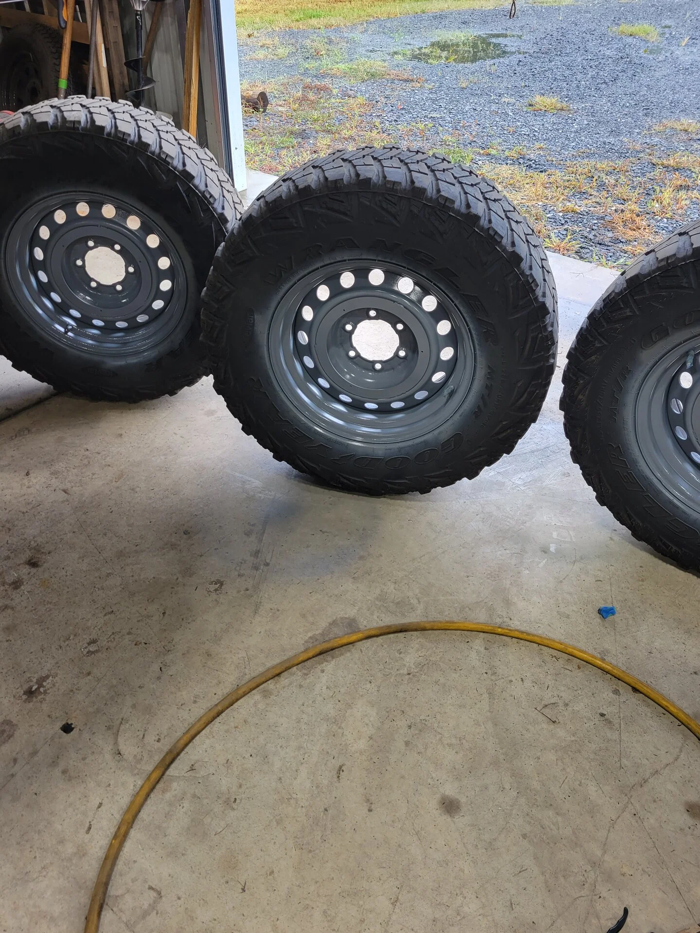

I make rings to put the hubcaps on 17" Toyota spare steelies, those are a 17x7.5 with 4.25" ish backspace
I also stock the hubcaps and rims and can weld them for you for additional if you'd like.

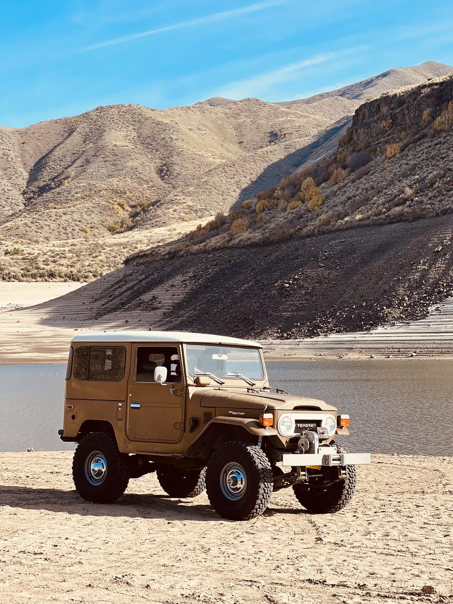

Below are some pics from @CondeCruiser recent install.
Read through this build for a few pages starting here:
35x10.5x17 Kenda Klevers on 17" steelies with OEM hubcaps attached by custom means.

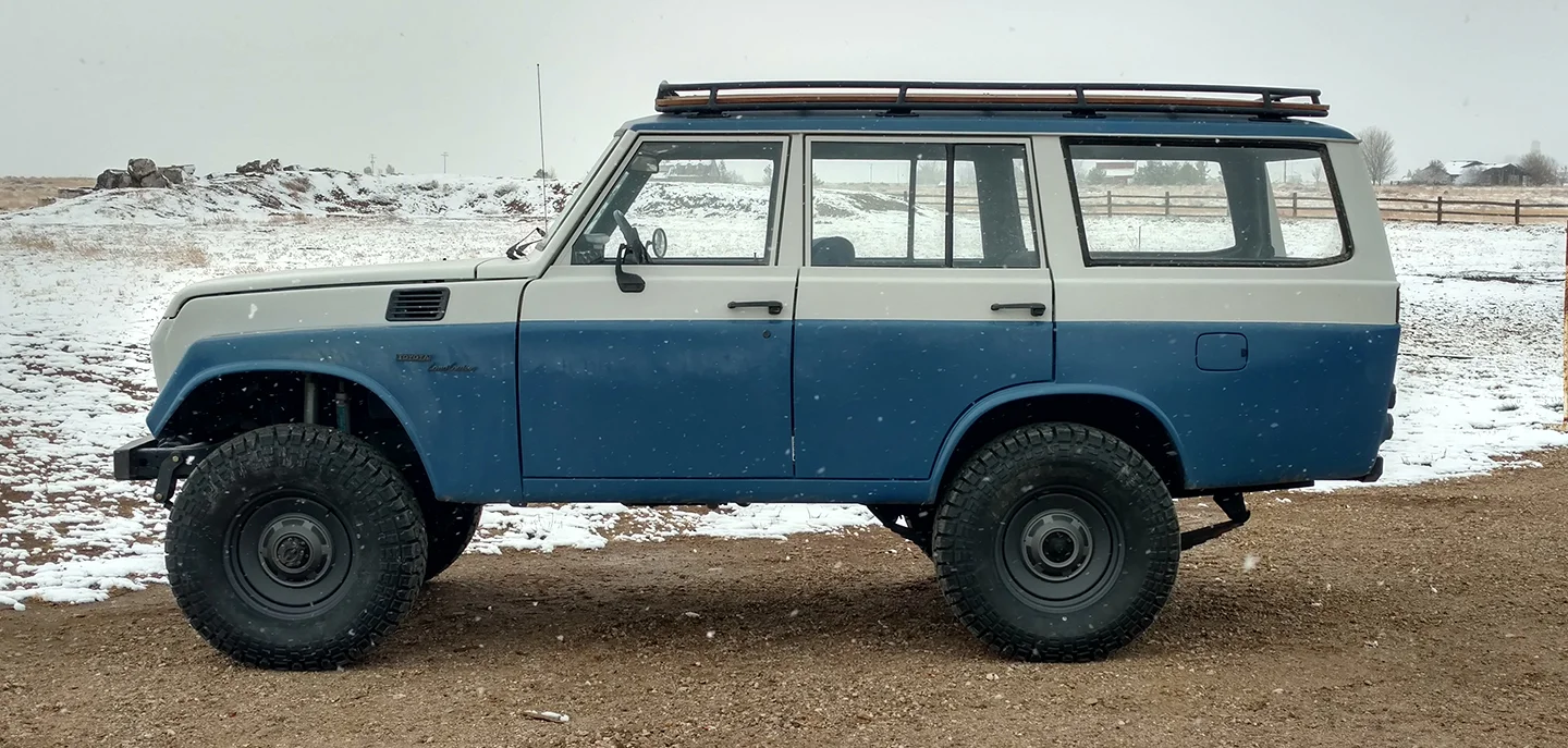

Another 17" wheel option with OEM hubcaps fitted:
Shown here, but I don't see the details on the actual wheels used or method of attaching the hubcap. User is still active, so likely could get details through PM or replying to the thread.

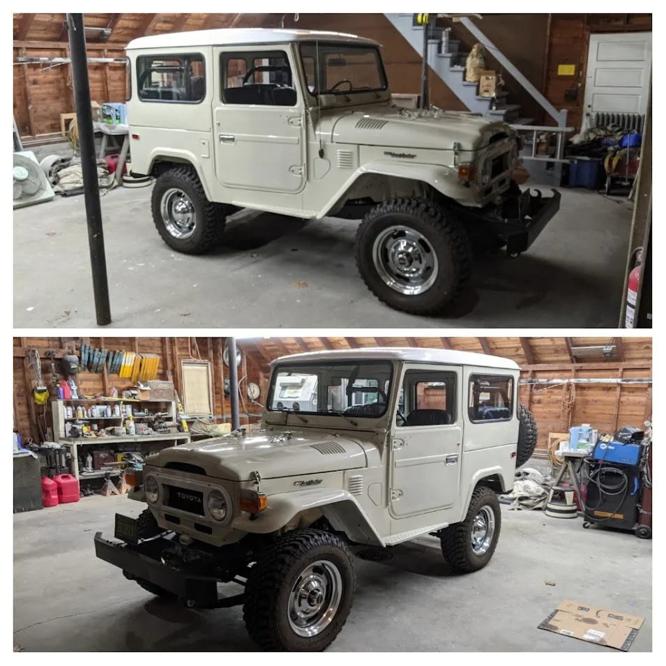

View attachment 3458806View attachment 3458809
Thanks for the info! Any spacers needed on a pig?

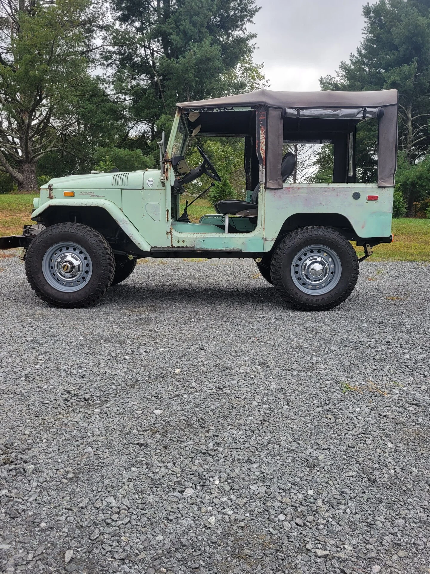

I am not running spacers on the disc brake axle in my 40. Tie rods clear by about 1 1/2".
Those are mine - they're a 17x8 Vision Rally wheel:
I ended up fabbing up a new lip on the hubcap itself to clip to the rim where the typical Chevy rally dishes would go. Size and backspacing works nicely, and the 17 gives a bit more room around the front discs.
Tires are a bit smaller than 35s though - more like 32s. (255/75/17 if I recall)
