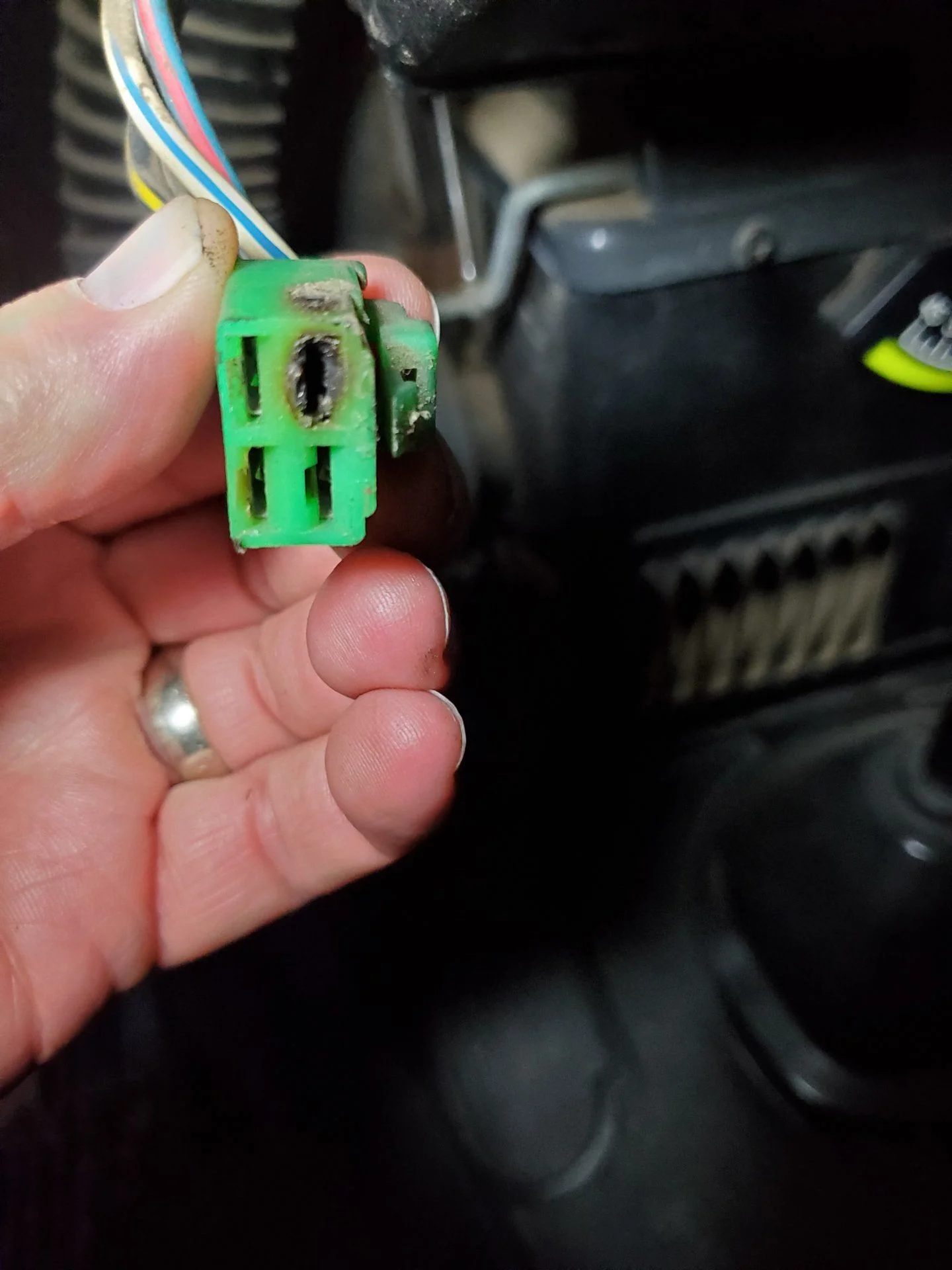

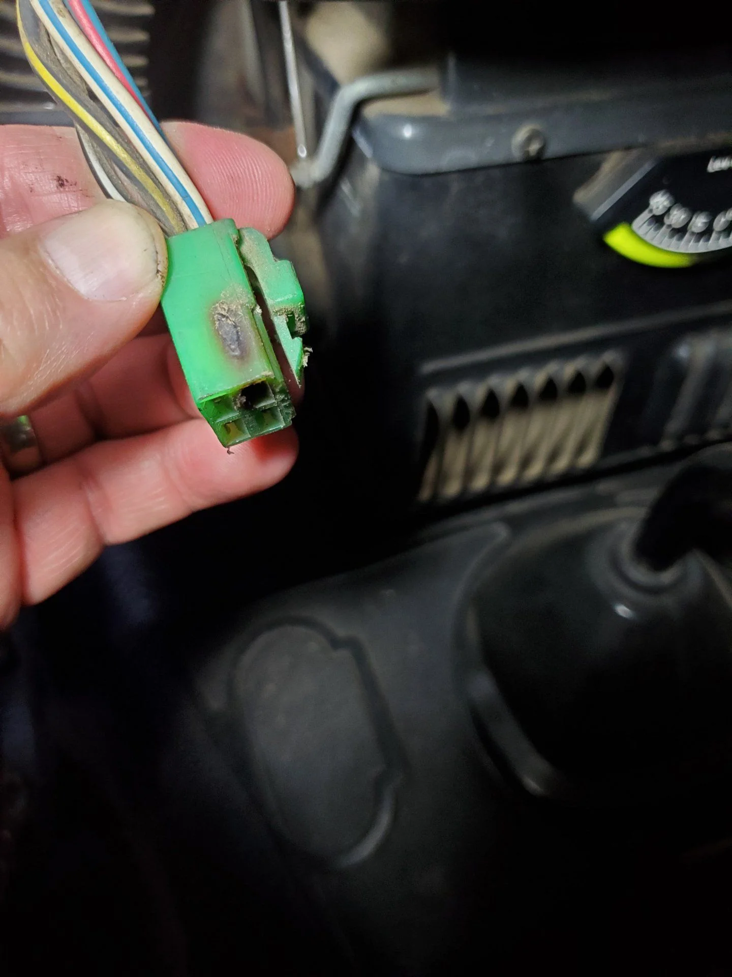

Took y'alls advice and used a push button remote between the solenoid and the battery. Fired right up. I may just bite the bullet and replace the wiring harness from the ignition to the starter. Never done that before so should be interesting at best, backbreaking, mind blowing, followed but a litany of curses at worst. Any hints from previous experiences would be greatly appreciated.
I think I just found the culprit. :):confused:
Anybody got a link to the female end?
Rhetorical question. Do I have to have a connector? Wouldn't it be easier to straight wire and just not have a connector?
You don’t have to. Back in the day, I had the same problem and cut the wire on either side of the plug and crimped on some male/female bullet connectors so that it could be disconnected and reconnected if need-be. It’s a red-neck fix, but I never had another problem with it.
Yeah, I'd love to replace the connector but I've never wired one of those connectors and don't have a clue how to do it. As with most projects it would take me 3 tries to ge it right.
