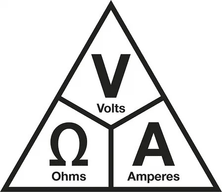

The engineer in me wonders what caused that lead to burn in the first place?
It's crossed my mind as well.
Ohm's law is your friend.
