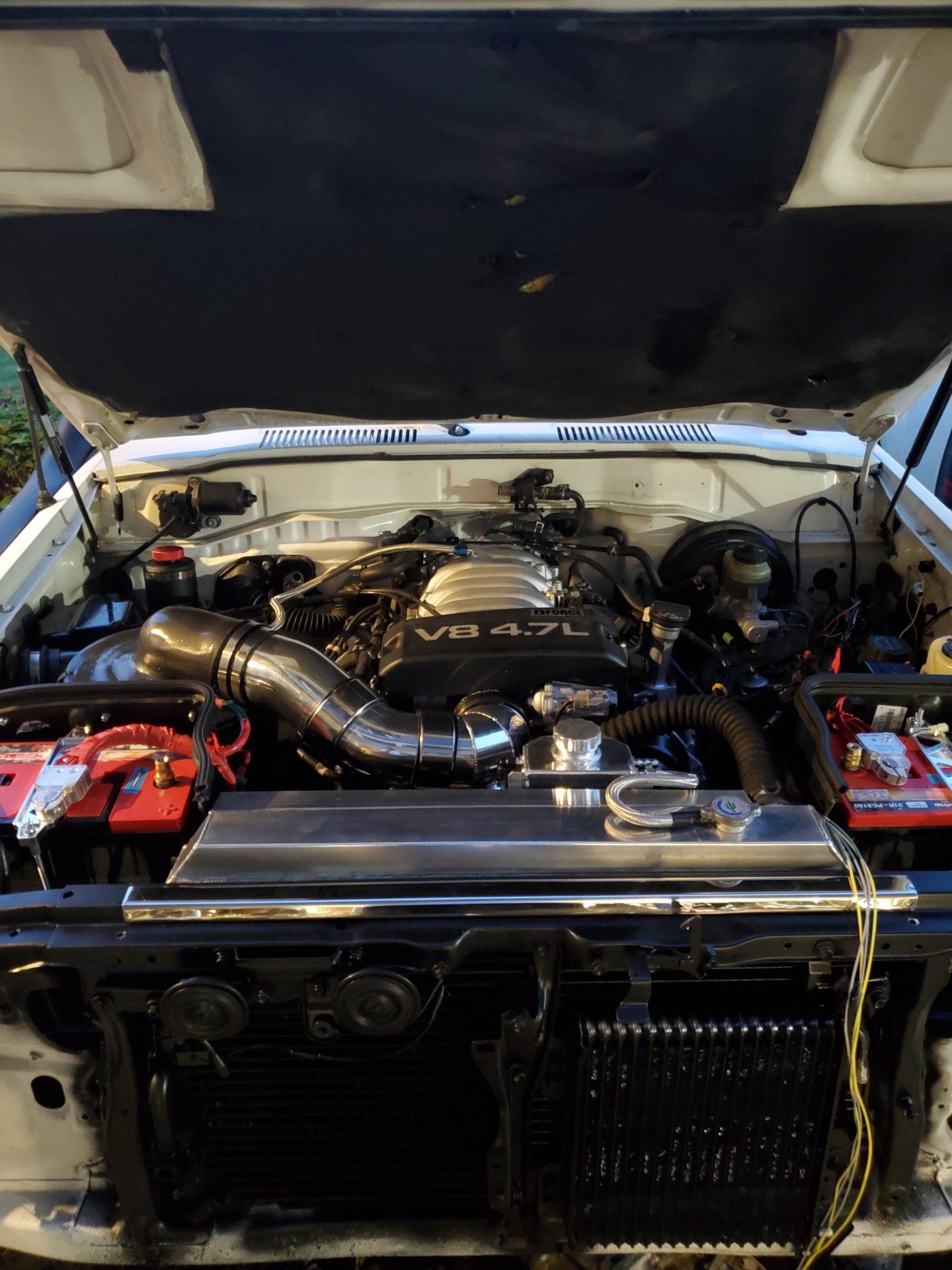

I'm finalizing my 80 2uz swap.. had to fab up an intake. Gave up with the wiring and just going to have North West Toys down in OR handle the wiring adapters for the harness to support the 2uz. I'll have to update my list of things I did to get this far. The goal now is to have it done for the Gambler 500
Man, that is a REALLY clean looking installation! I'd be really interested to learn as much information as you're willing to provide, regarding techniques, parts used, what works / what doesn't, etc. There's just no clean "road map" out there on the best way to go about doing this swap (not that I've been able to find anyway)
