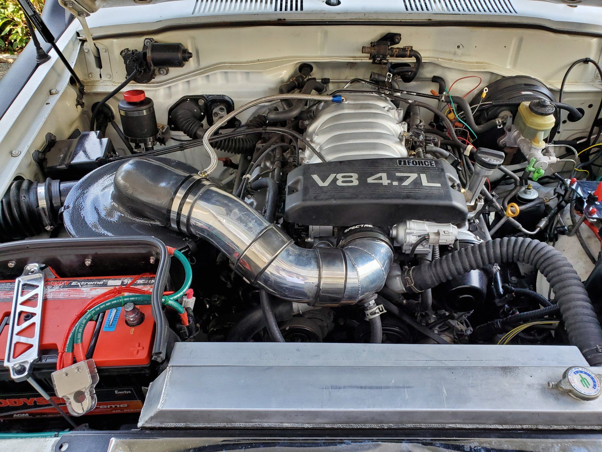

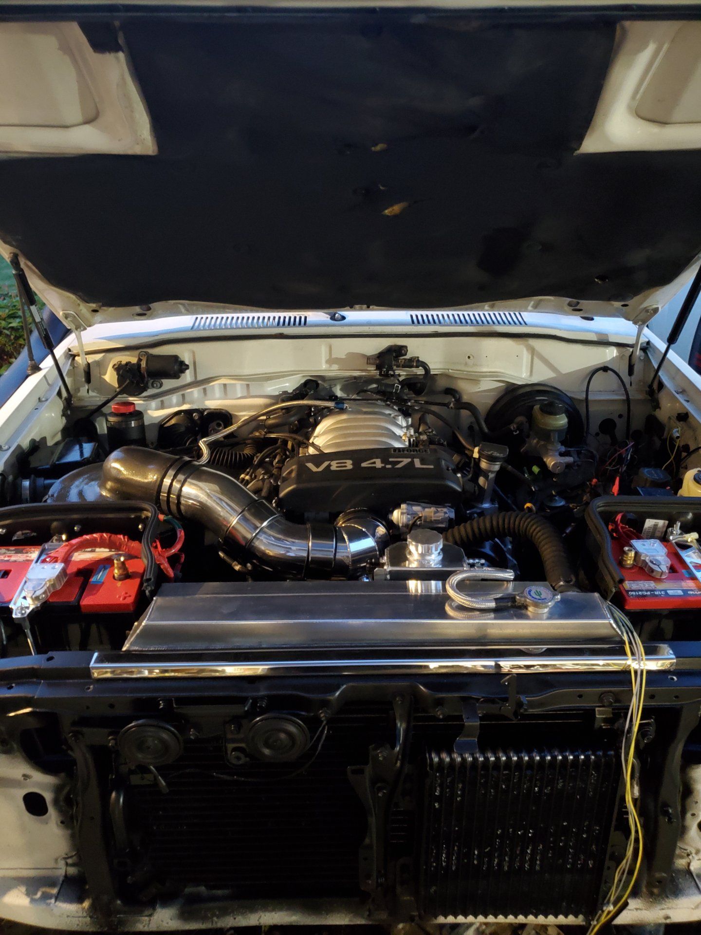

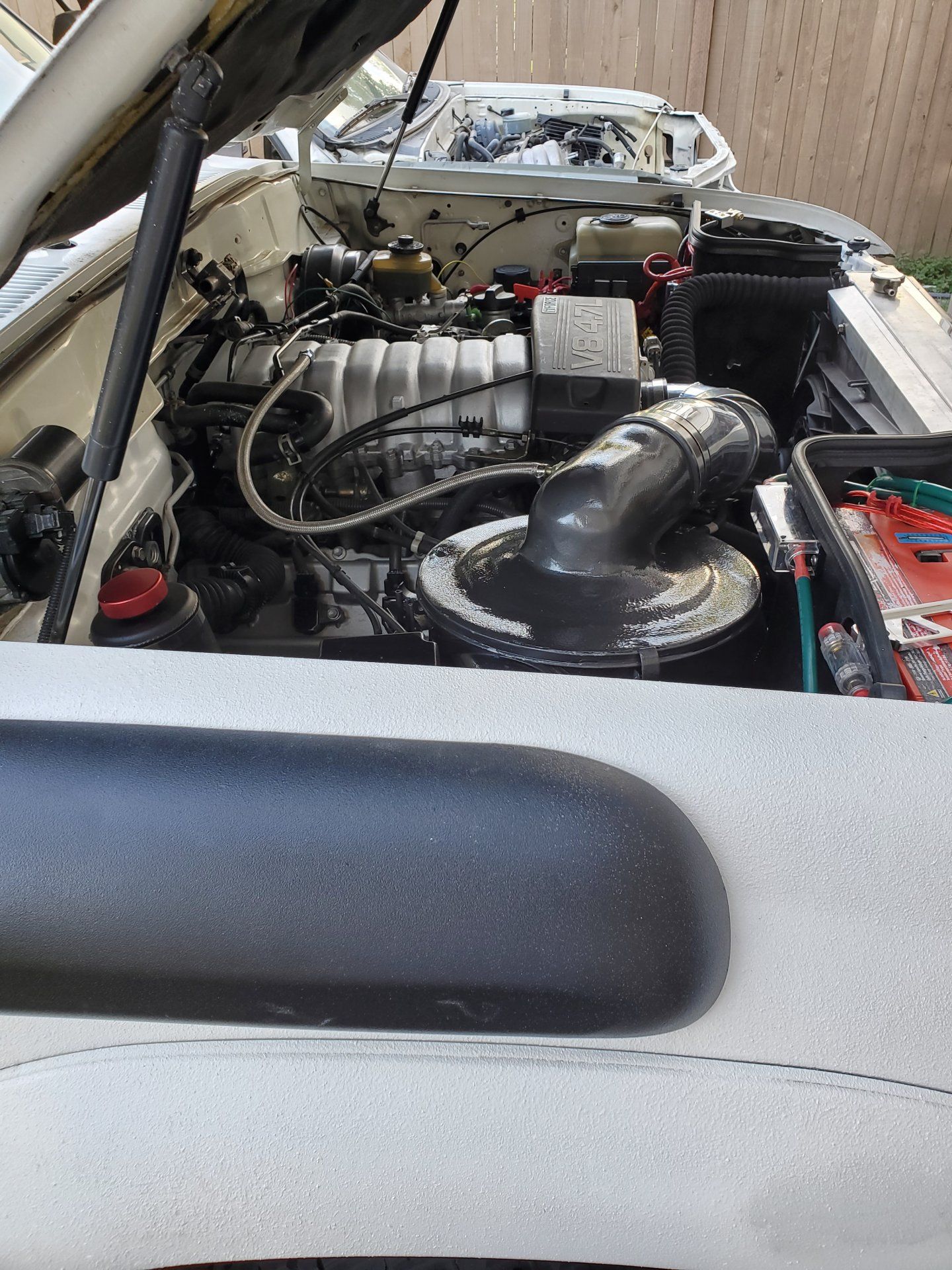

I'm finalizing my 80 2uz swap.. had to fab up an intake. Gave up with the wiring and just going to have North West Toys down in OR handle the wiring adapters for the harness to support the 2uz. I'll have to update my list of things I did to get this far. The goal now is to have it done for the Gambler 500
That is a very clean installation. I’m just waiting on a few engine accessories then I’ll be starting. My plan includes a non-vvti 2uz with an a750f out of a cruiser. I’m still trying to figure out the wiring specifics for that union. I am also using an ecu out of a 2wd v8 4runner because I’m keeping my stock t case. How did you do the engine mounts? That’s my next pre install problem.

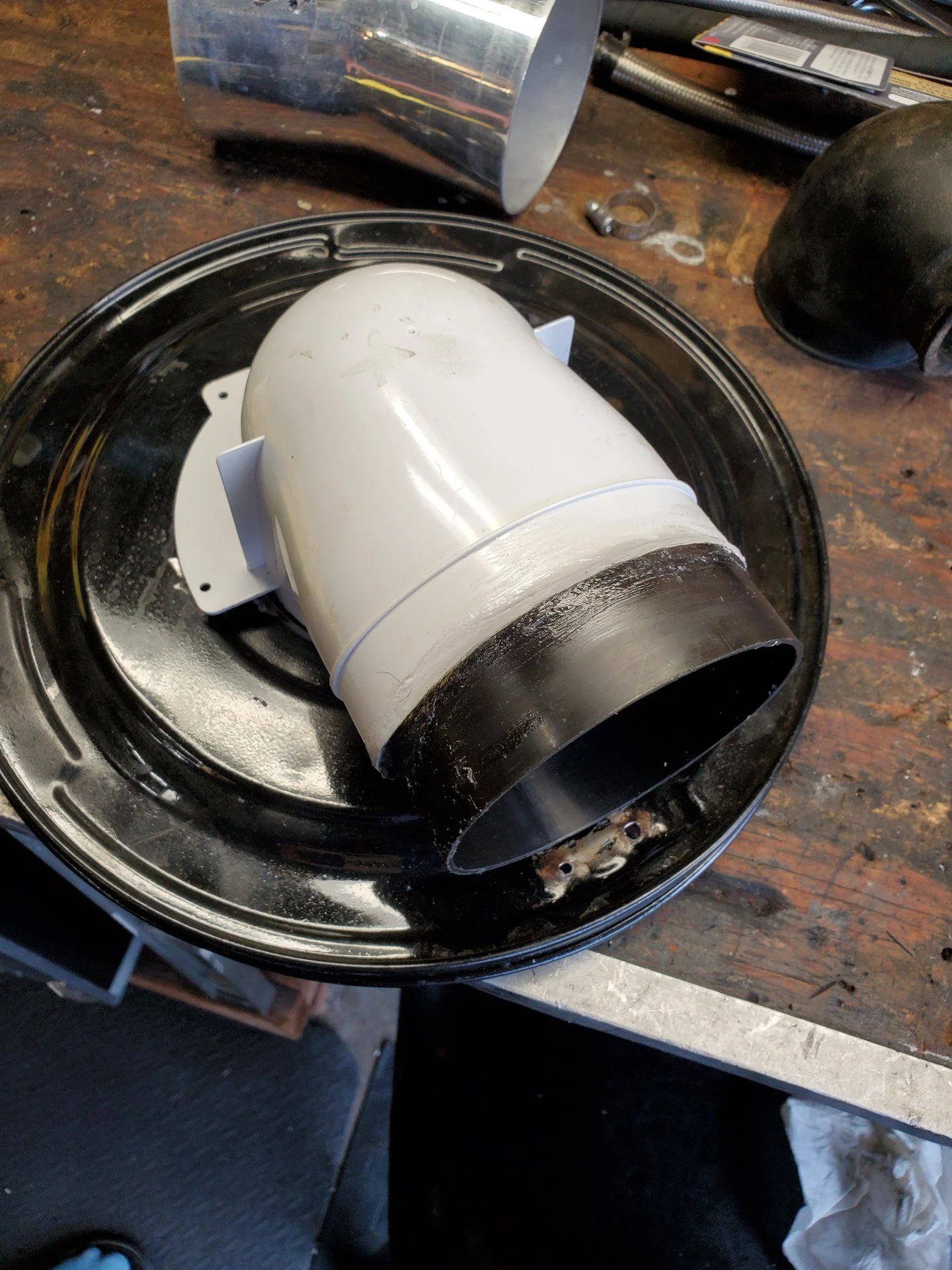

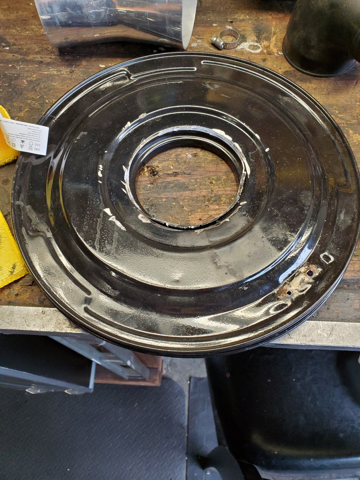

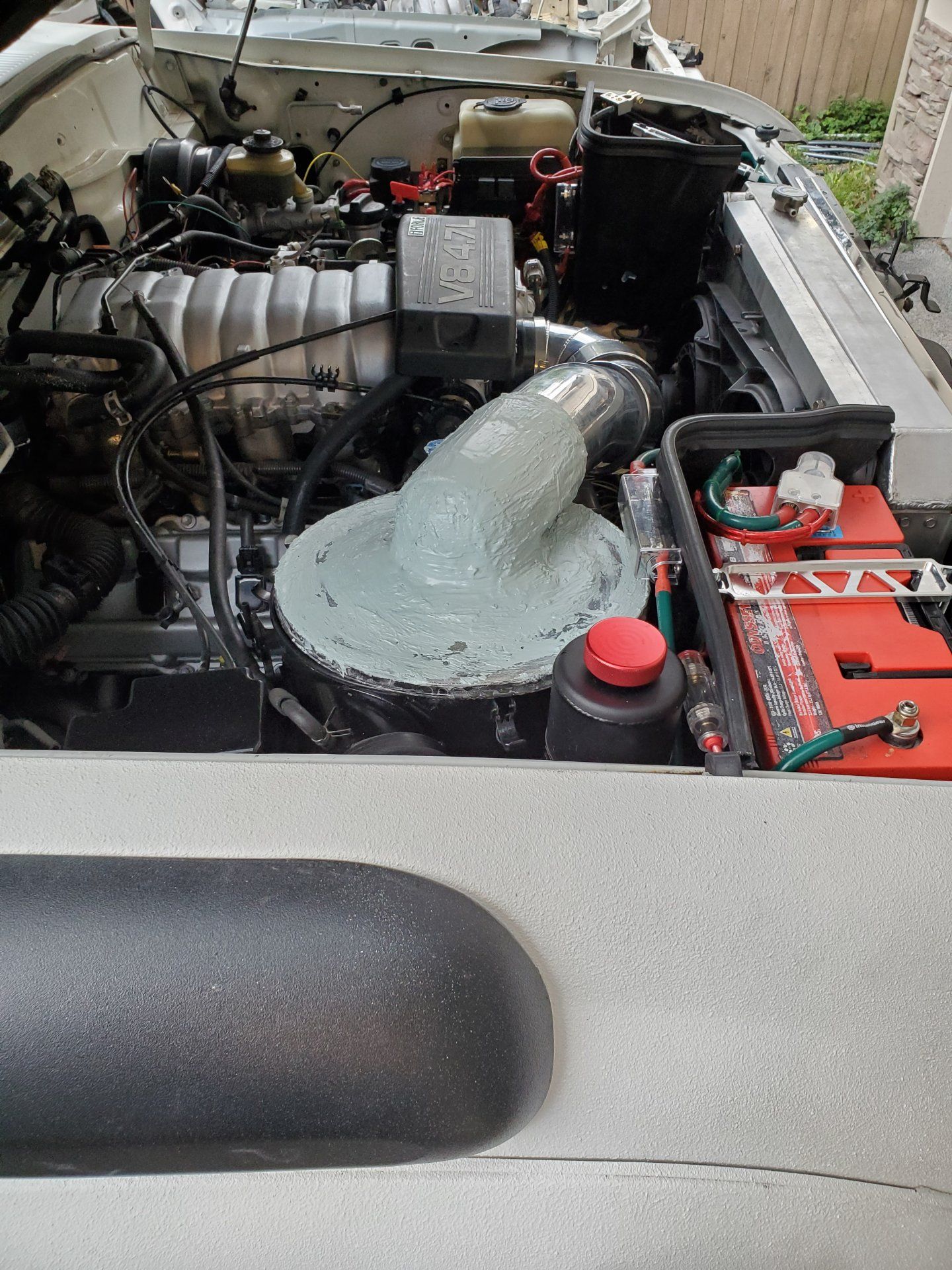

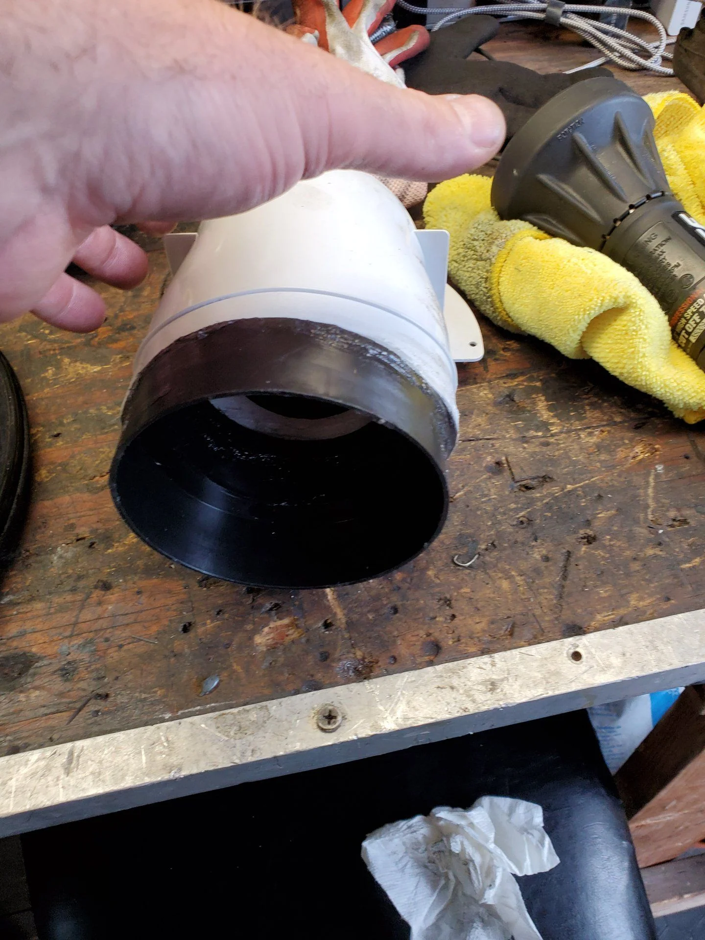

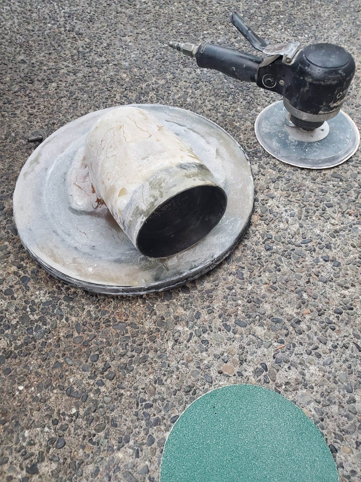

What did you do for that airbox lid? Originally a 91 thru 94 lid?
I took the original Air cleaner top and cut it off. I fiber glassed some PVC plumbing thing I found at HD and made it work

I'm about $3800 in on this swap. I bought a running 2002 Sequoia and used that as the donor. The donor is the best way to do this swap in my opinion because I used a ton of parts that would have cost way over the $800 I paid for the entire truck. My LC is a 91 making it a bit easier to swap and of course the 2002 2UZFE engine without VVTI makes it even easier. I bought a 96 LC a343F and HF2AV (The AV is longer in the rear shaft side then the HF2A because of the Viscous coupler).. I added a shift kit and electronic solenoids to get rid of the kickdown and filled the hole where the cable was. That way there is only one cable at the throttle body.
The 2UZFE does fit in a 60 body without any cutting. You have to use a Land Cruiser oil pan and not a Tundra oil pan. Then it clears the diff.
