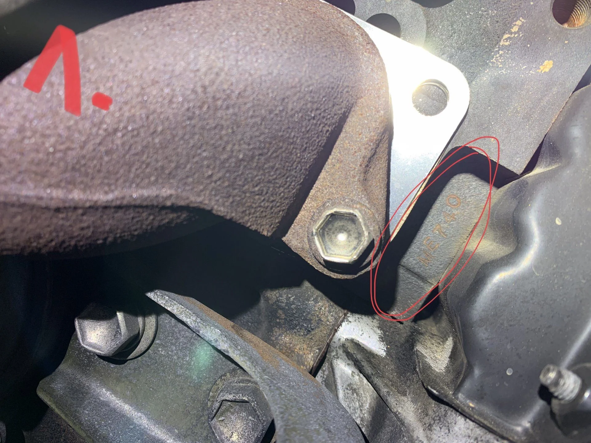

Thank you for the answer and the links. Here are 2 photos of the head. 1. What does this number means? Maybe a “remastered“ head? 2. Here you can see the oil leaking. Eventually there is something more than oil, maybe the mechanic used some paste too, not only the gasket?

I can't say definitively about the numbers you have identified. Many people have asked about how to identify various L series heads, but no one seems to have an answer.

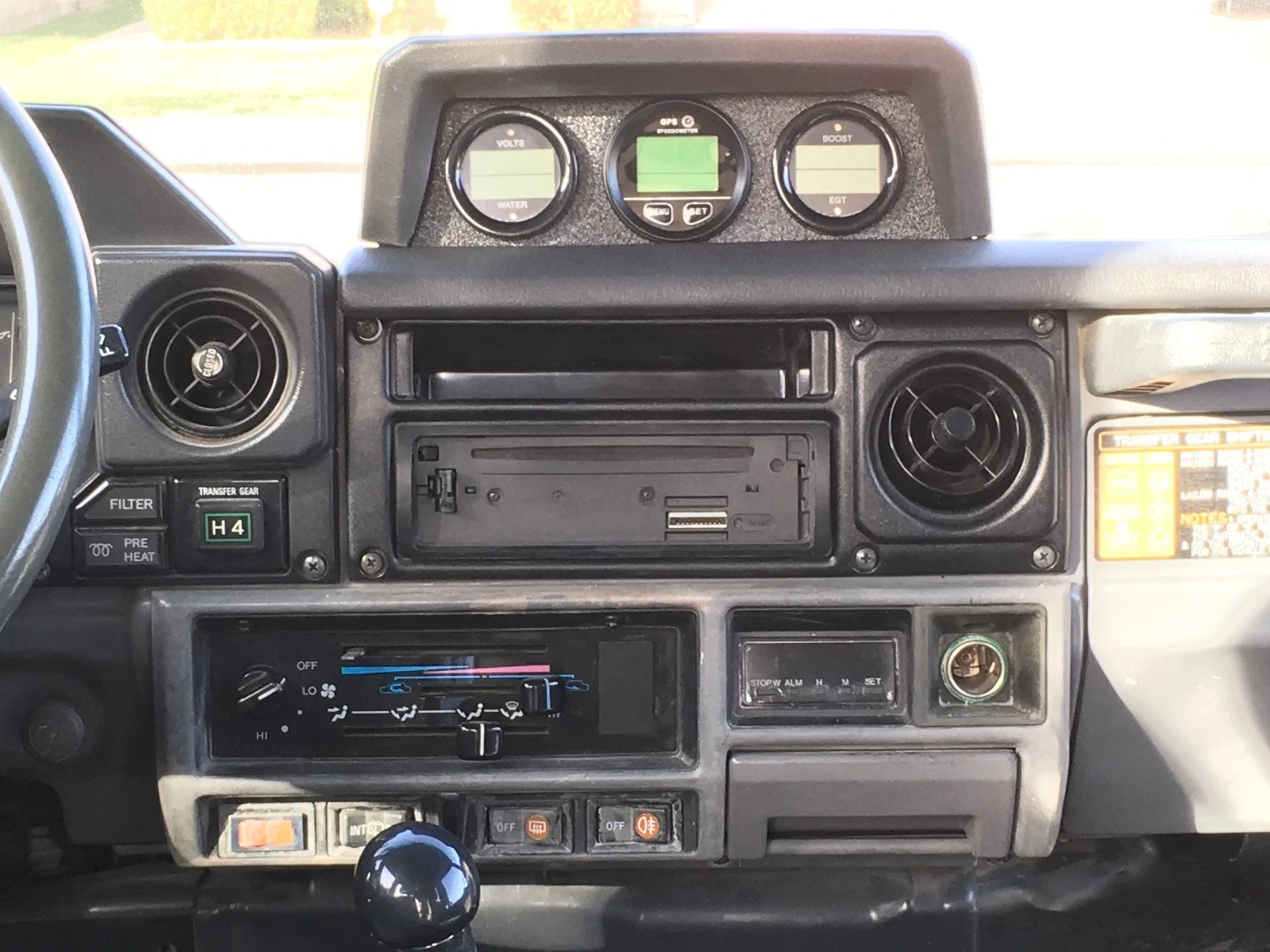

Any idea why "24 volts" stamped on the Volts gauge?
Same gauge both 12v and 24v systems?
I have come across 24v marked gauges in 12v LJ70/73 before, clearly stock.
It's been ok, but for some many of them have the same oil gauge issues.

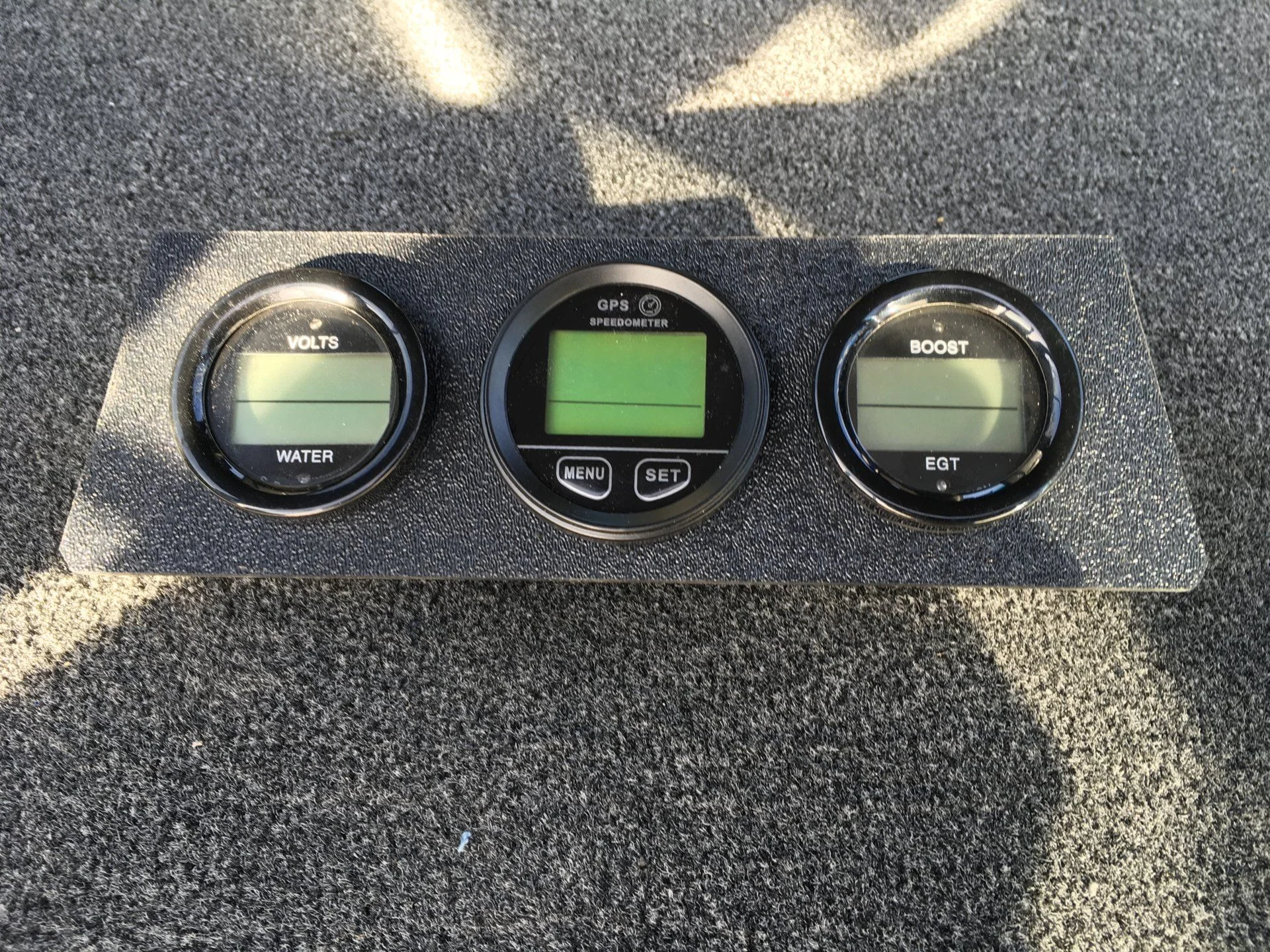

I decided to make a face for the 3 gauges I purchased and go for a more stock look.
ABS Stock is 1/4" and the template is 25mm at the bottom, 22mm at the top, and 18mm wide.
Additionally, I found decent option for 3rd hole of Instrument Cluster.
While the first 2 gauges are 55mm, the center one is 60mm, but so far this gets a thumbs up for value and versatility. I installed this GPS gauge that reads in MPH or KMPH or NMPH for those water crossings. It also has a volts gauge, odometer, and built in clock. So far, I'm more than happy with it. Takes less than a minute to get a lock on the satellites.
Interesting with that 60mm gauge! Do you still enjoy it?
If so, what type/brand is it?
Cool build!

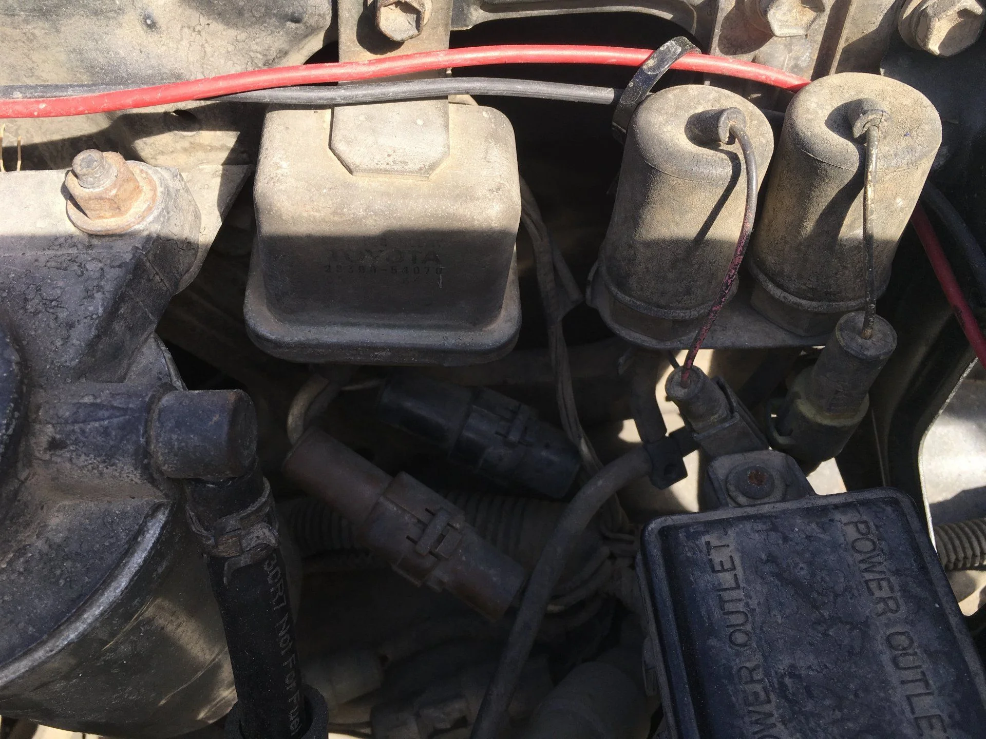

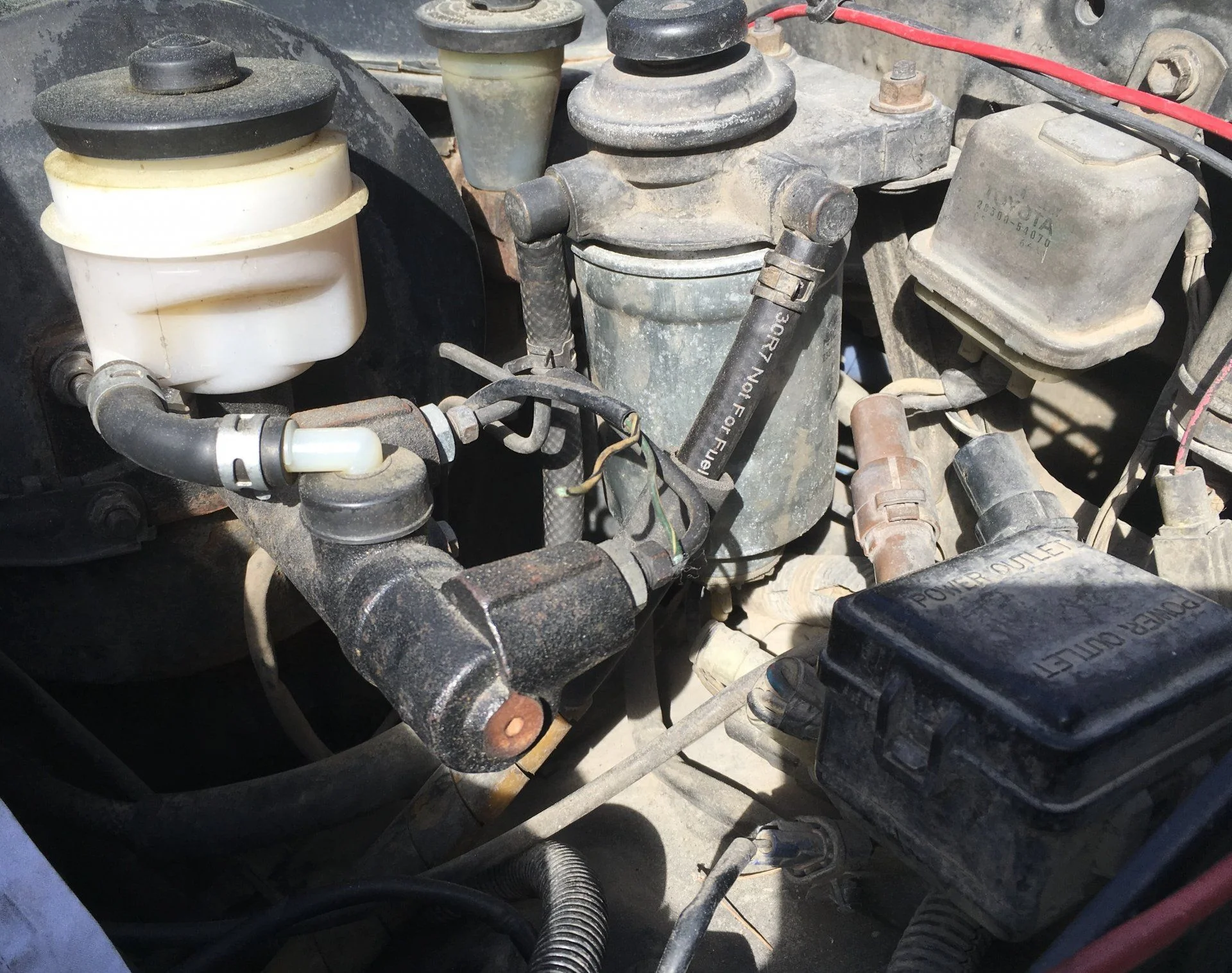

My Relays have a bit more age than Nick's.

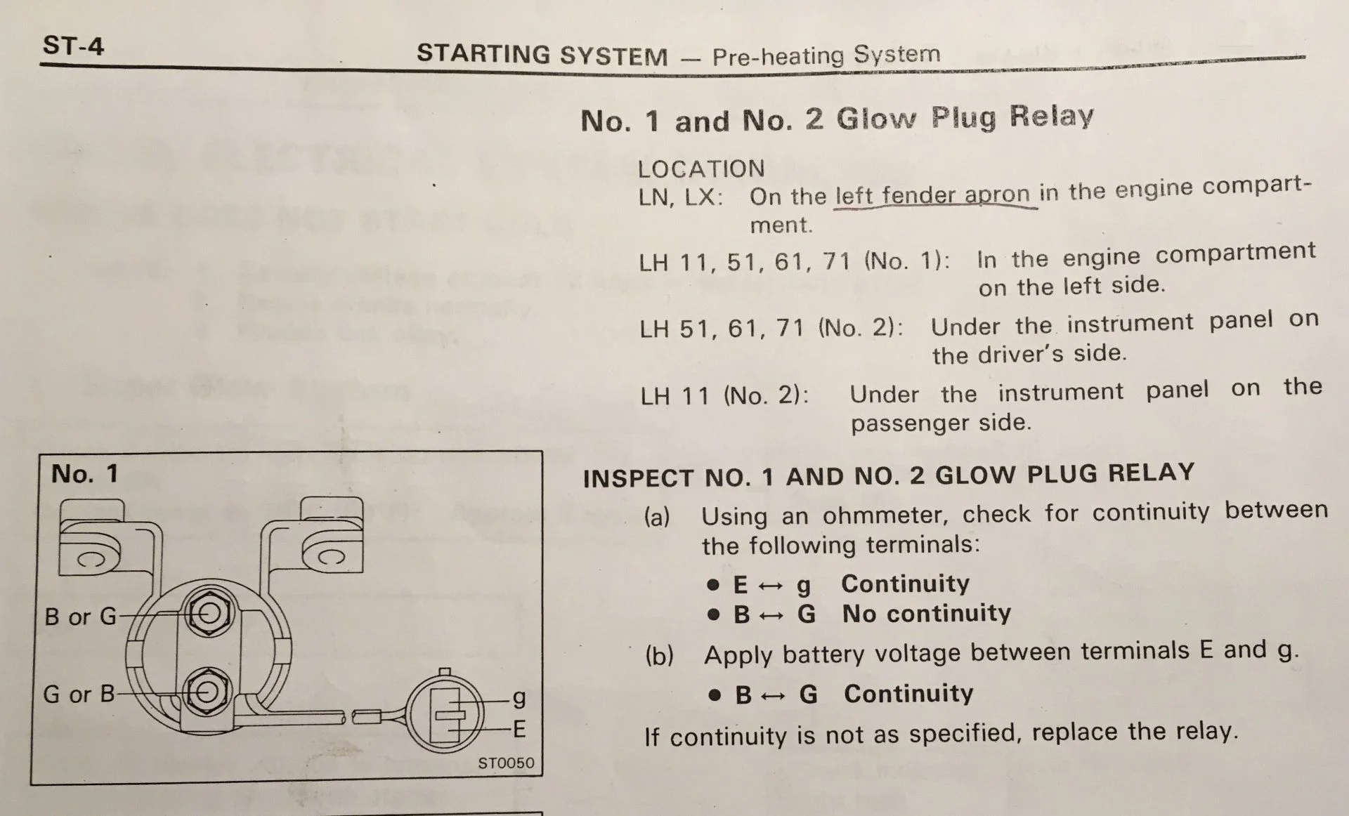

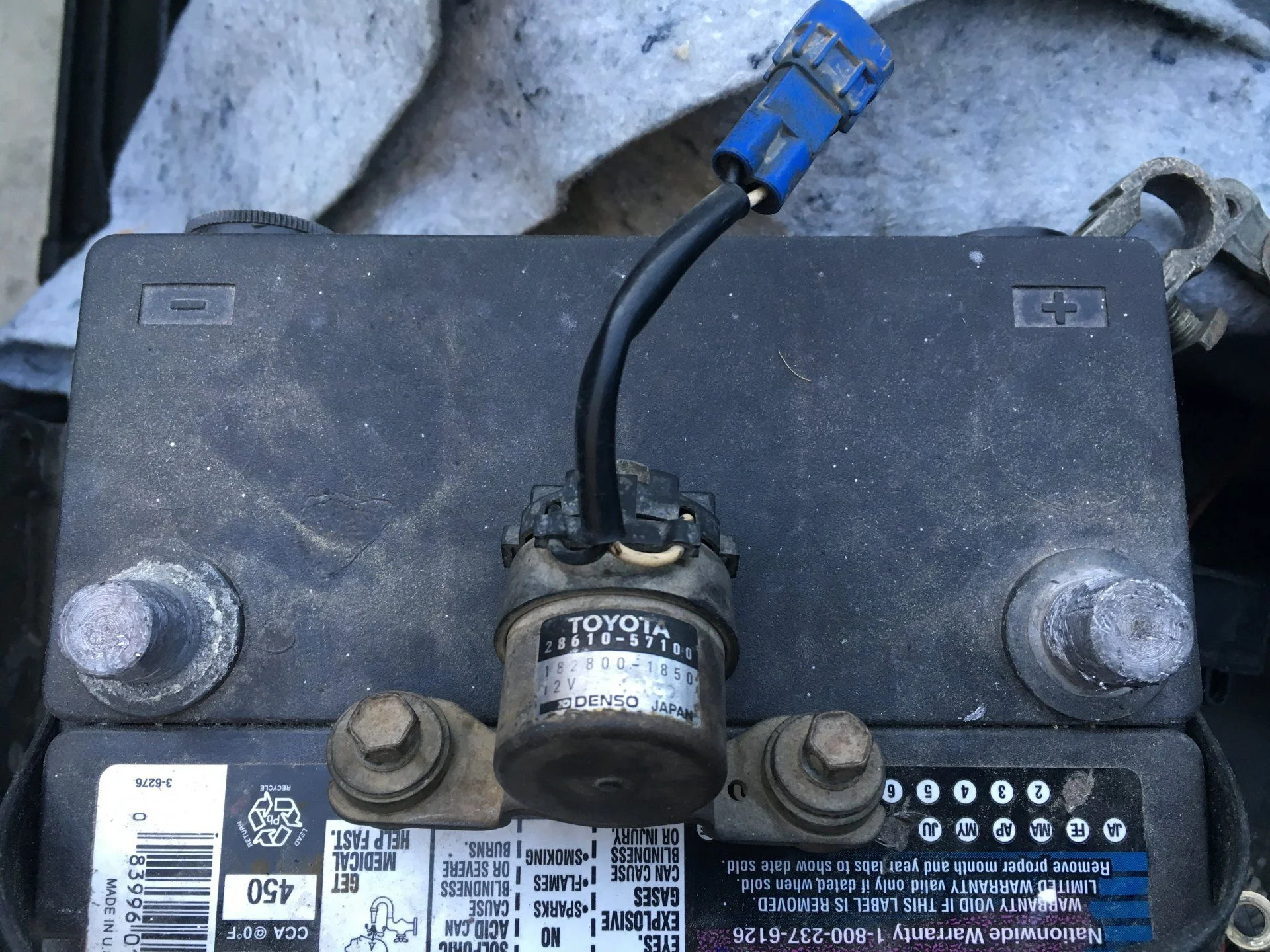

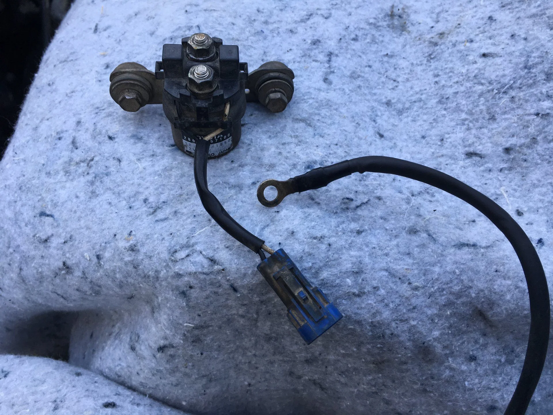

That said, I have concluded my glow plug voltage problem lies with the either the Current Sensor or Timer Realy or how the two interface with the Main Relay.
Main Relay passed all tests from page ST-4 of the service manual.
My Timer Relay, is the goldish colored square next to the fuel filter above left wheel well.
It is a self contained PFM self contained unit, that I don't feel like breaking trying to pry it open.
I get 11.5 volts on Baterry Post of the Main relay and Zero volts at the other post that has the lead for the glow plug rail post (at all times).
The main relay will not release any voltage to the glow plug rail, so I will bypass the Super Glow System all together.
Here are some pics of the Super Glow System that will get Bypassed.
