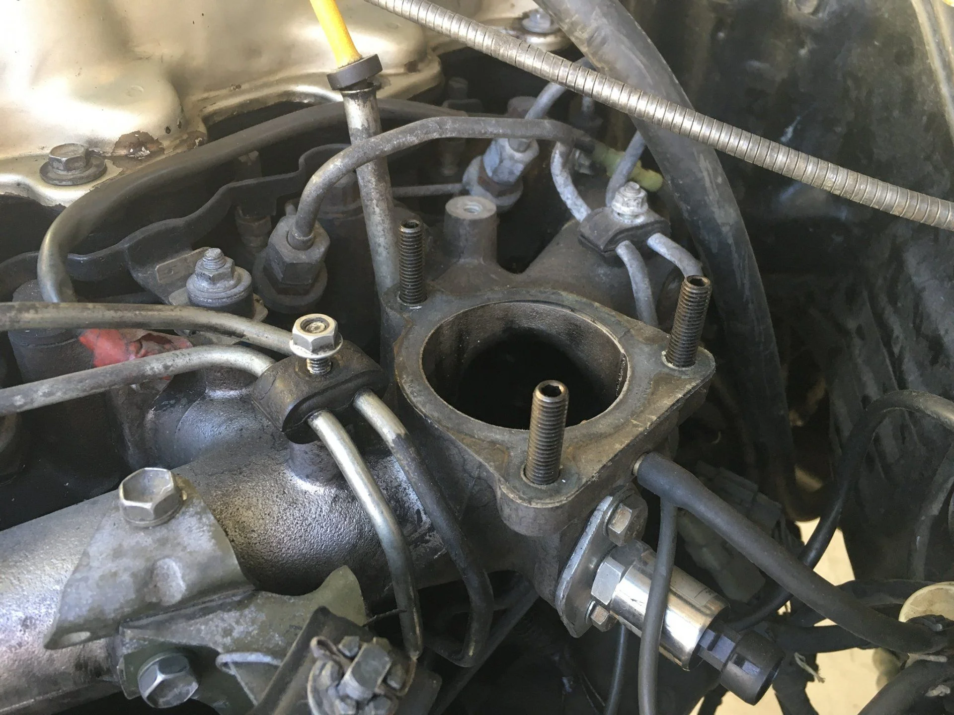

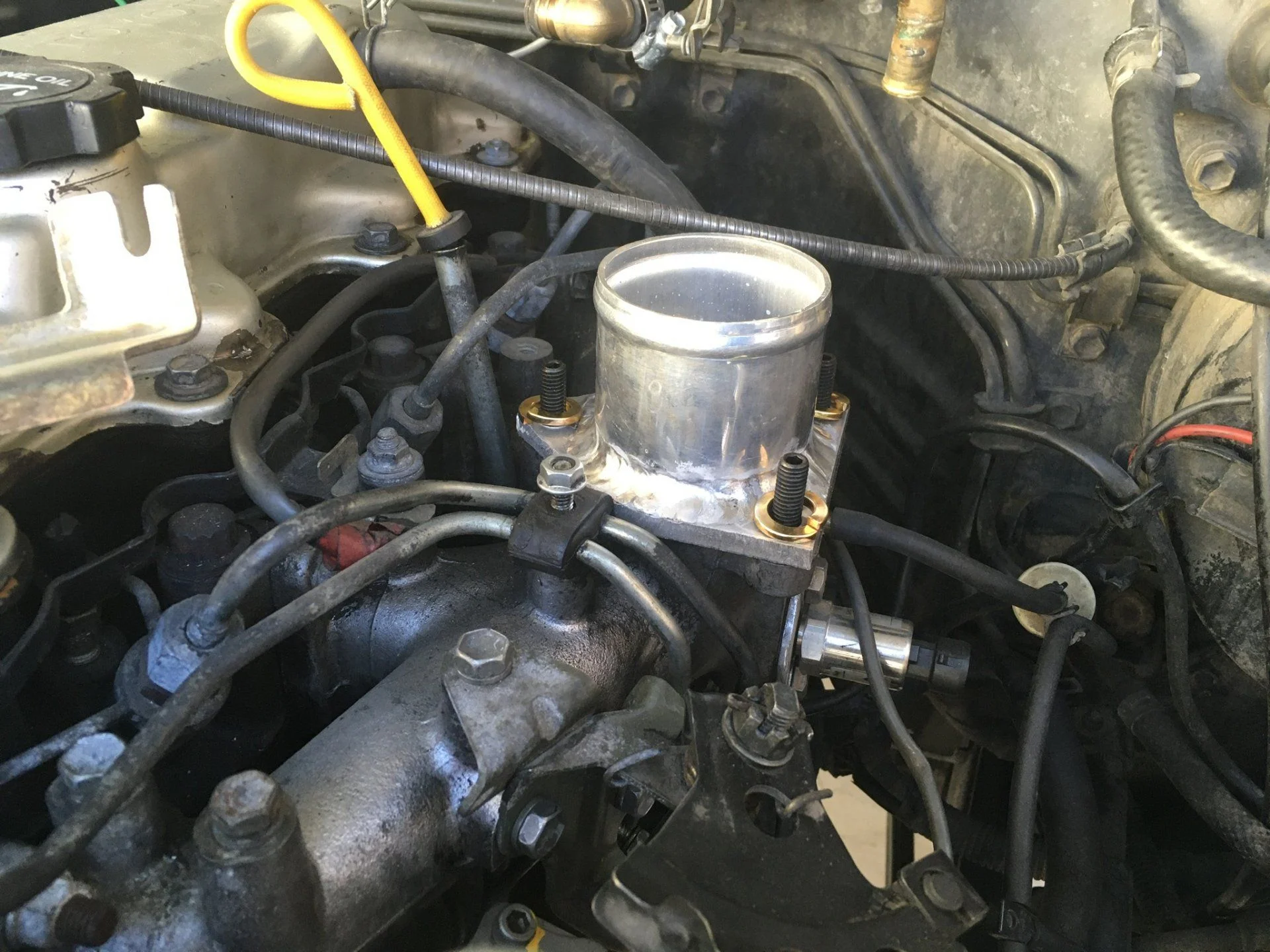

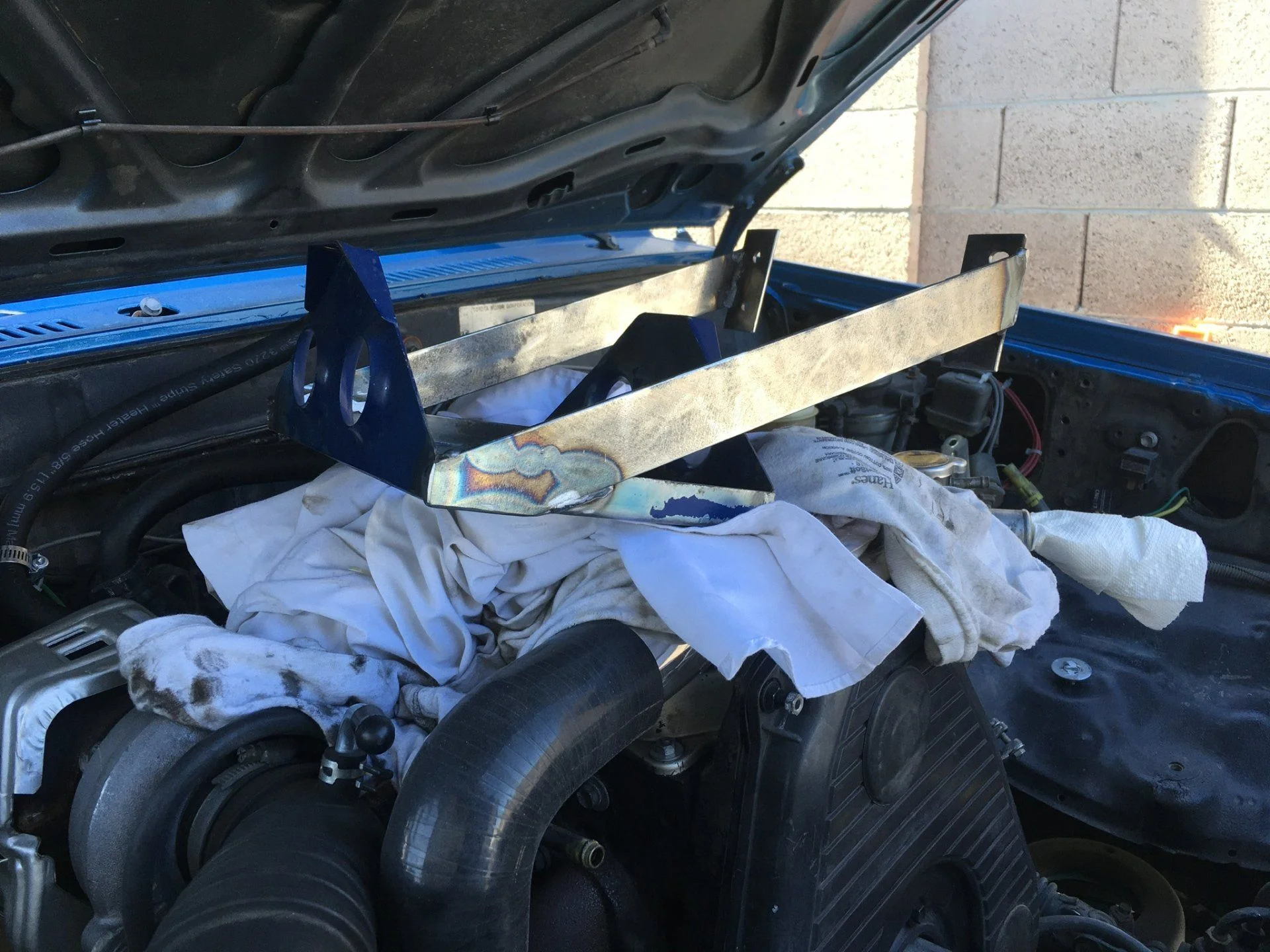

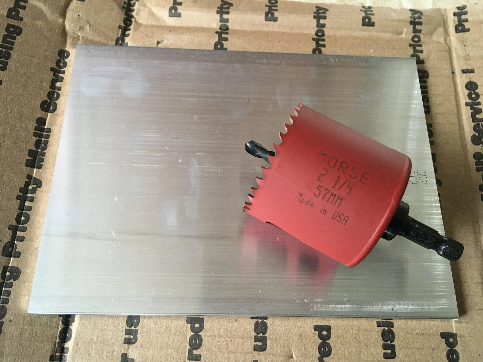

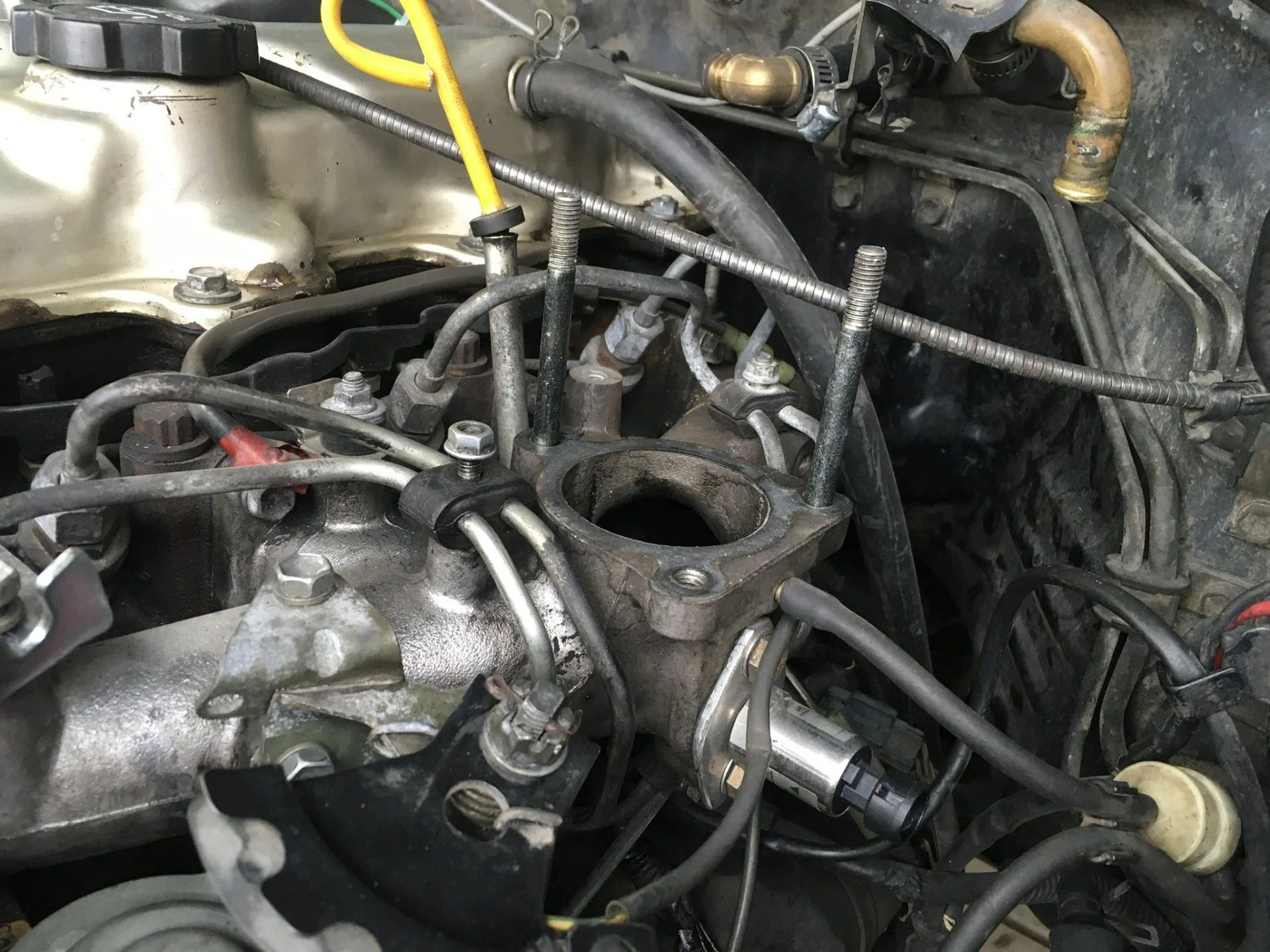

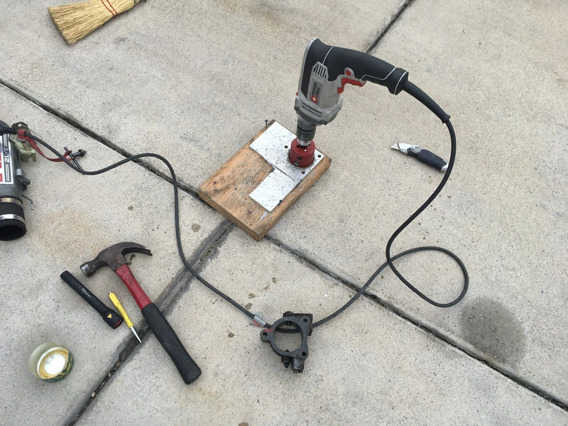

Then get your 1/4" Aluminum Plate and 57mm Hole Saw to cut the flange for the Intake Manifold. I found it easier to cut the (3) mounting holes first and then cut the 57mm hole second. Much easier to get the spacing correct. Also, get some shorter stud bolts for the Intake Manifold, as the stock bolts will be too long.

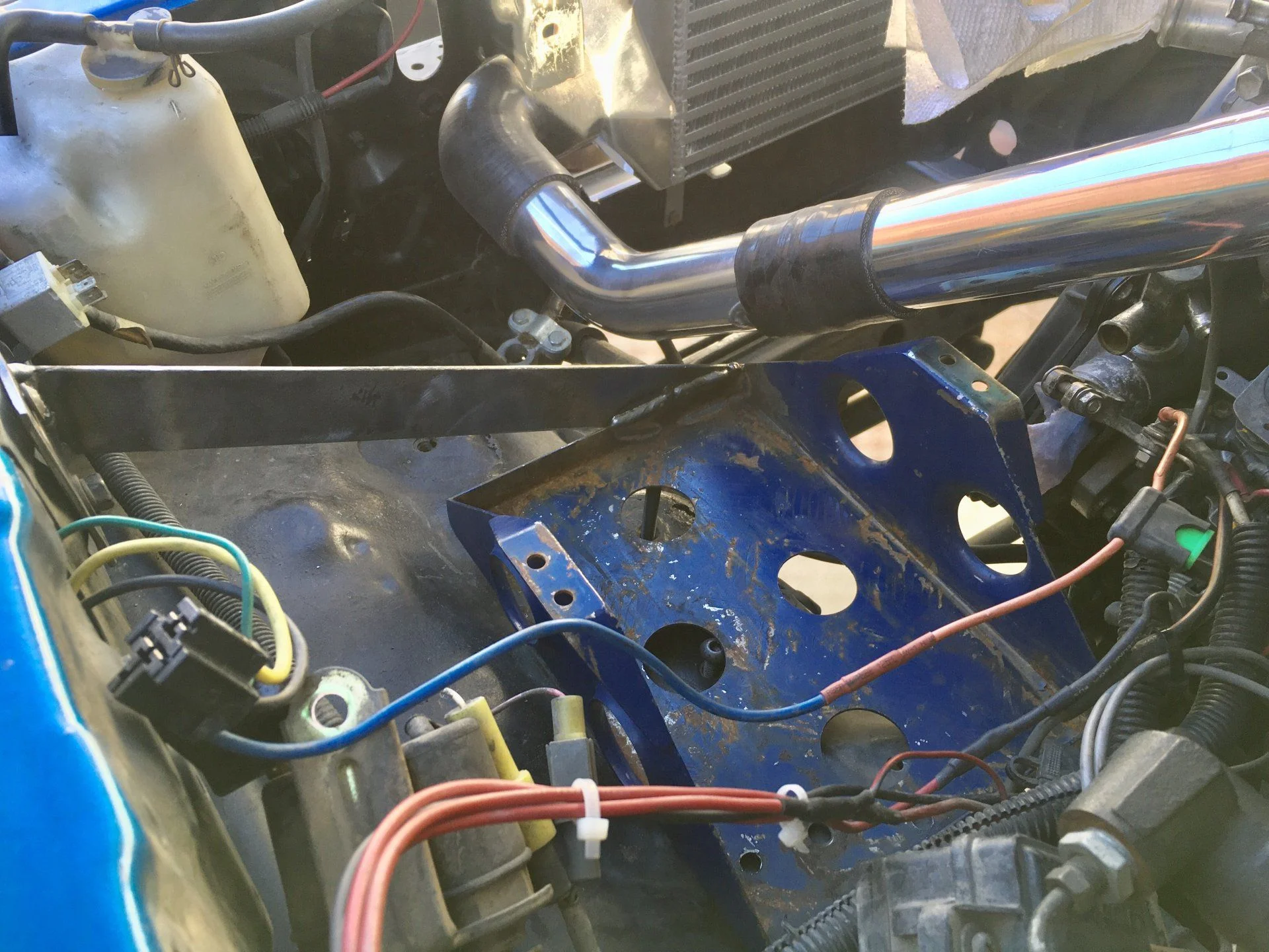

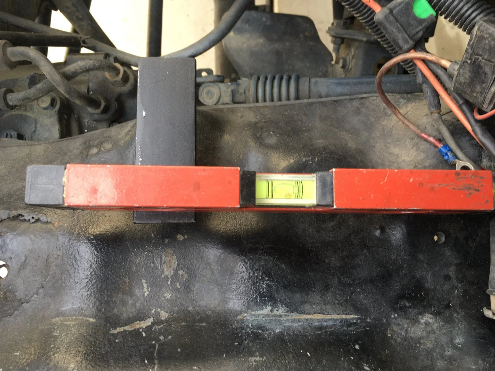

Next, relocate the stock battery tray back toward the firewall approximate 3-4", or the battery will hit the tube from the IC to Intake Manifold. If you are lucky like me, the PO will have installed an alarm system in the real estate you now need, and you get to deal with going from under the hood to under the dash, fun stuff. I used the stock support holes on the fender and wheel wells as best as I could to provide strength and support the weight of the battery.

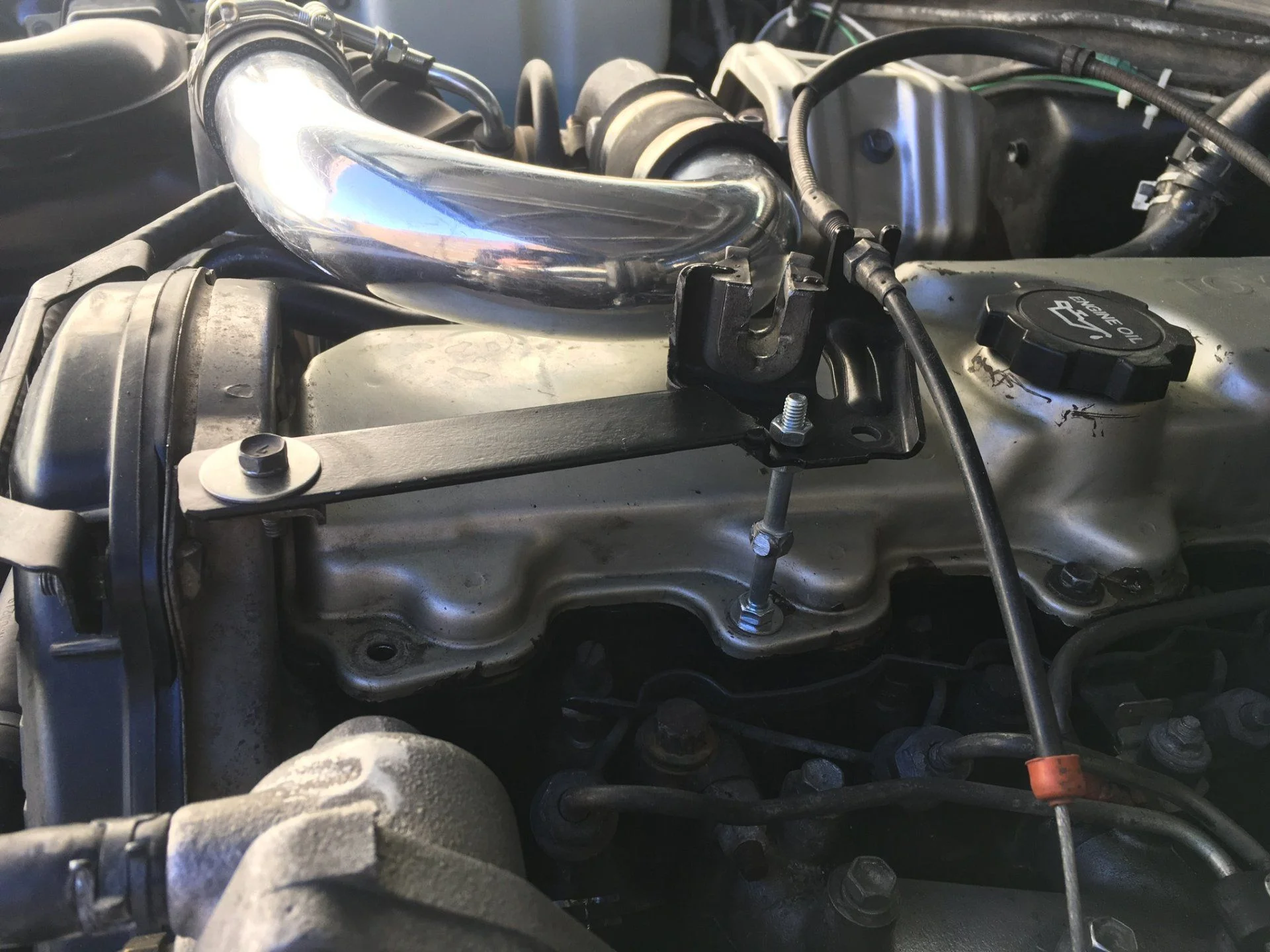

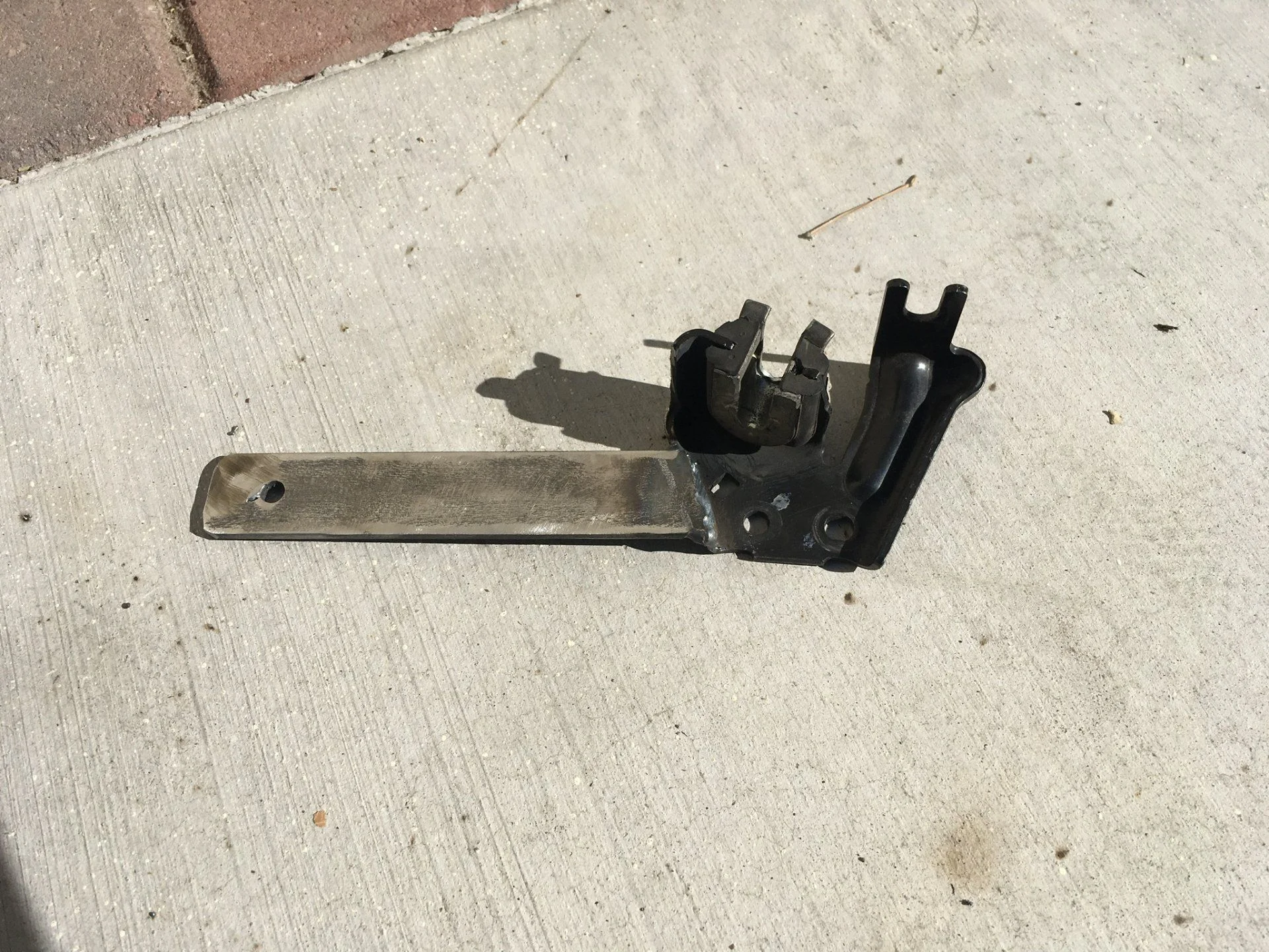

Just to recap some Throttle issues, My LHD LJ70 is a 1989 that came with the first generation 2L-T engine which I replaced with an 2L-TII that came out of RHD vehicle. The previous Throttle Cable support / actuating system was somewhat cobbled together due to a variety of reasons. Previous set-up utilized the "Turbo Intercooler / Cross-over Tube" to hold the Throttle Cable. Fabricating the new Throttle Bracket was probably the most difficult part of the job. Everything needs to line-up and be supported. Just tedious, not impossible.
We shall see how this solution holds up over time. It is a bit more rigid than the previous set-up since the previous had hoses at each end to cushion vibrations. Time will tell.

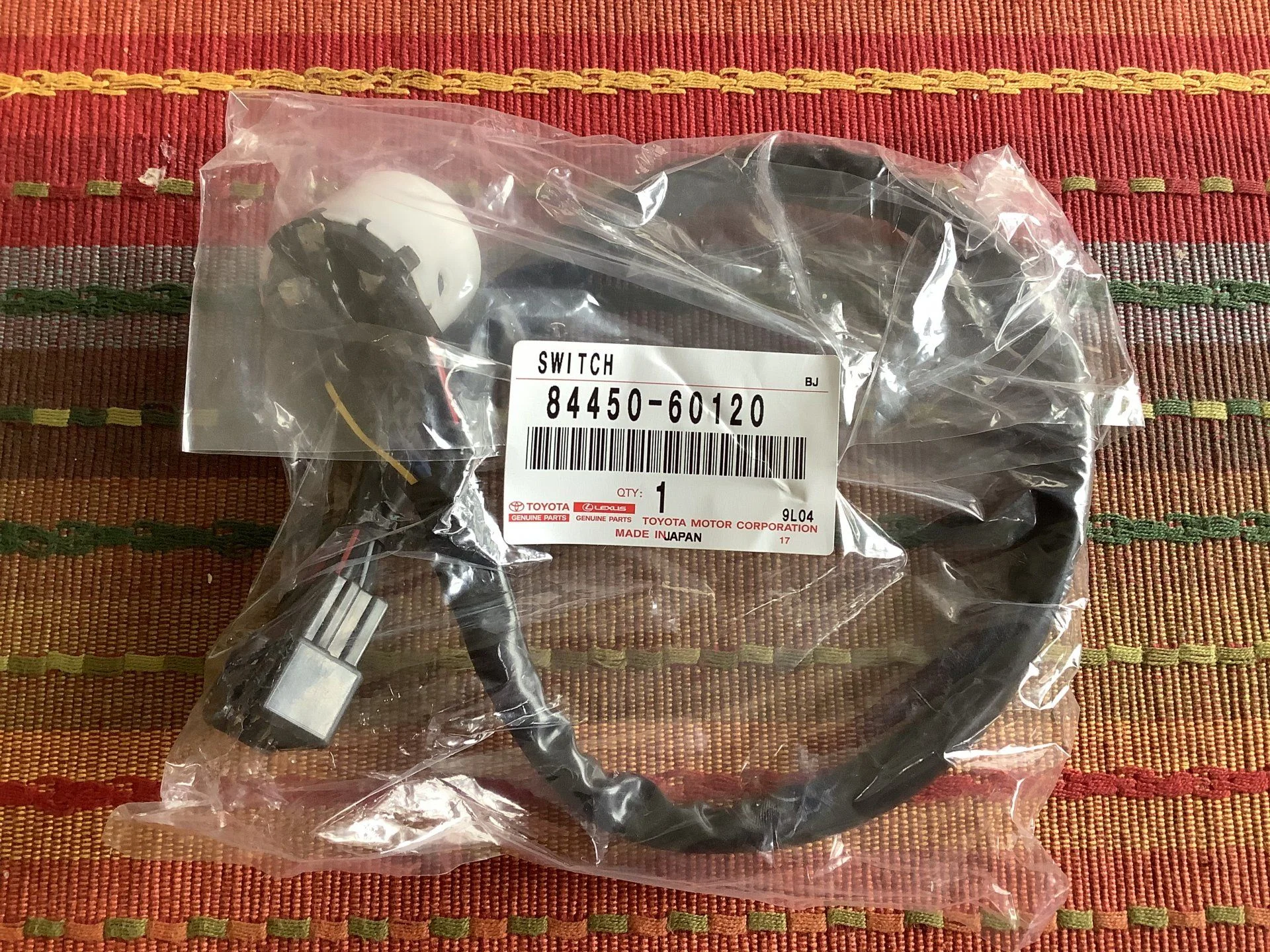

I got everything lined up with the Throttle Cable, finally. I also bought a new Ignition Switch Harness and I went with a new Ignition Key Cylinder Set as well, since there wasn't any key code on my cylinder and the key was occasionally getting jammed up, usually when it got cold.

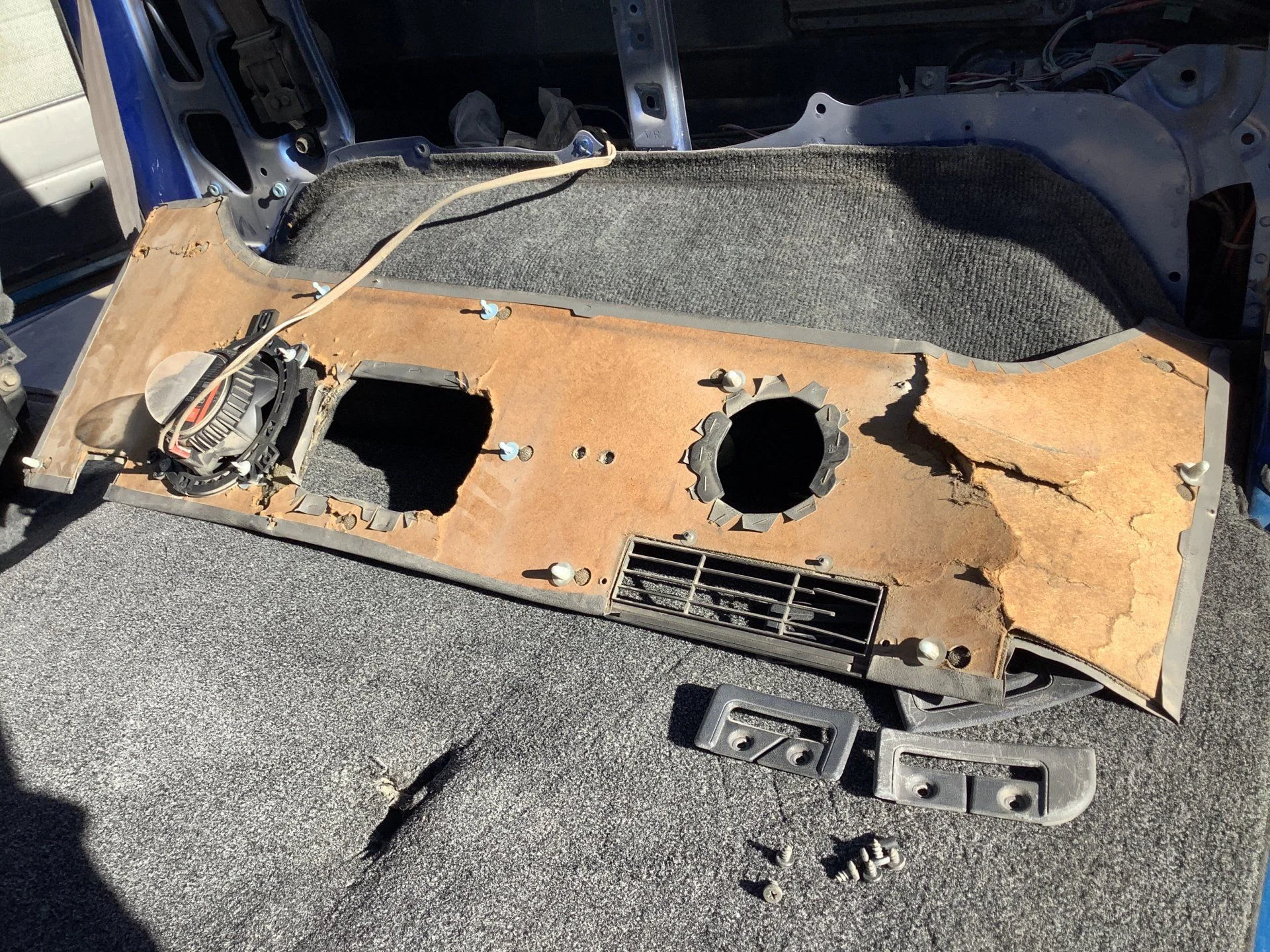

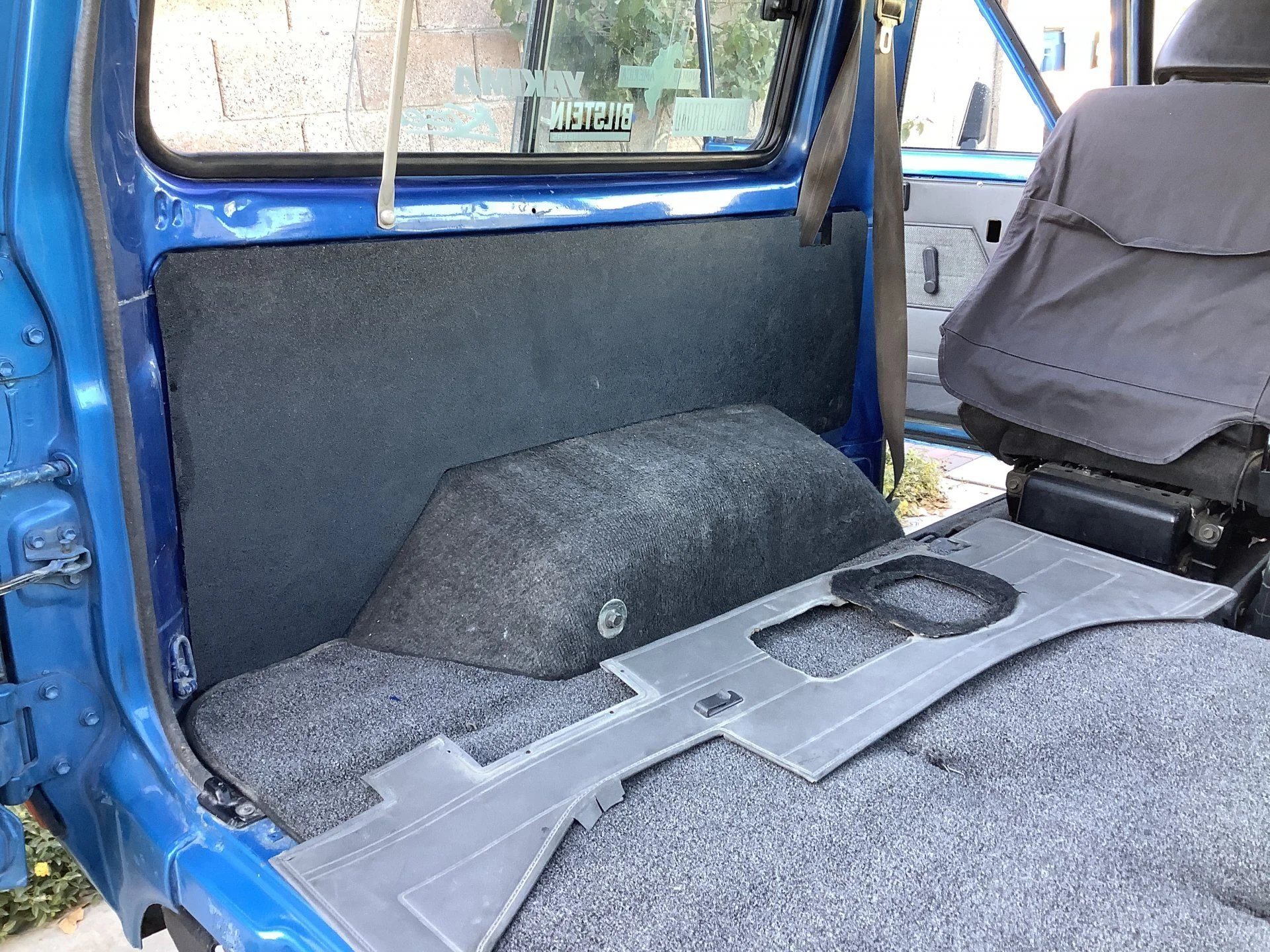

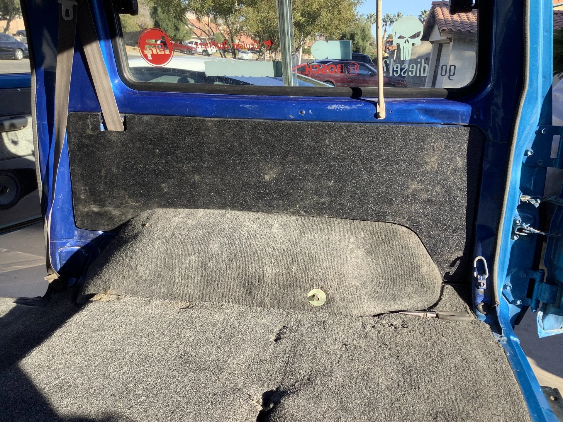

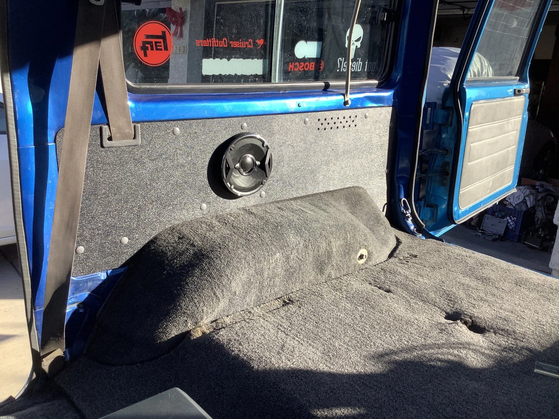

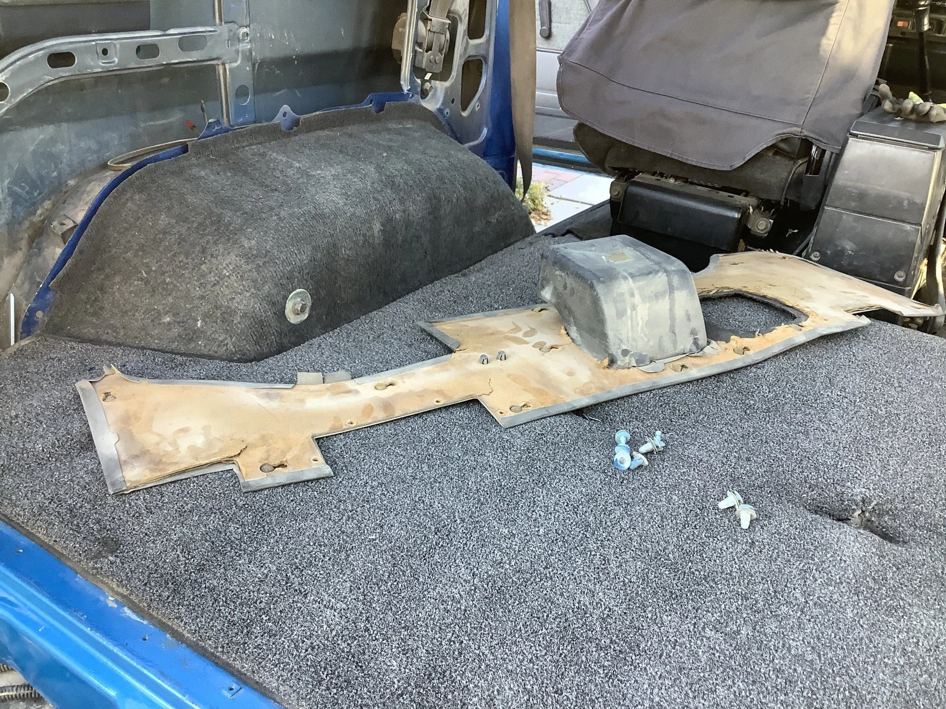

Cut out some new panels out of ABS for the back of the LJ70.
PO really jacked up these panels up, cutting holes for rear speakers.
The Importer blamed U.S. Customs for destroying the panels, as they supposedly were looking for contraband.
I'm not buying that excuse though. Hopefully these ABS panels turn out alright w/r/t not making too much vibration.

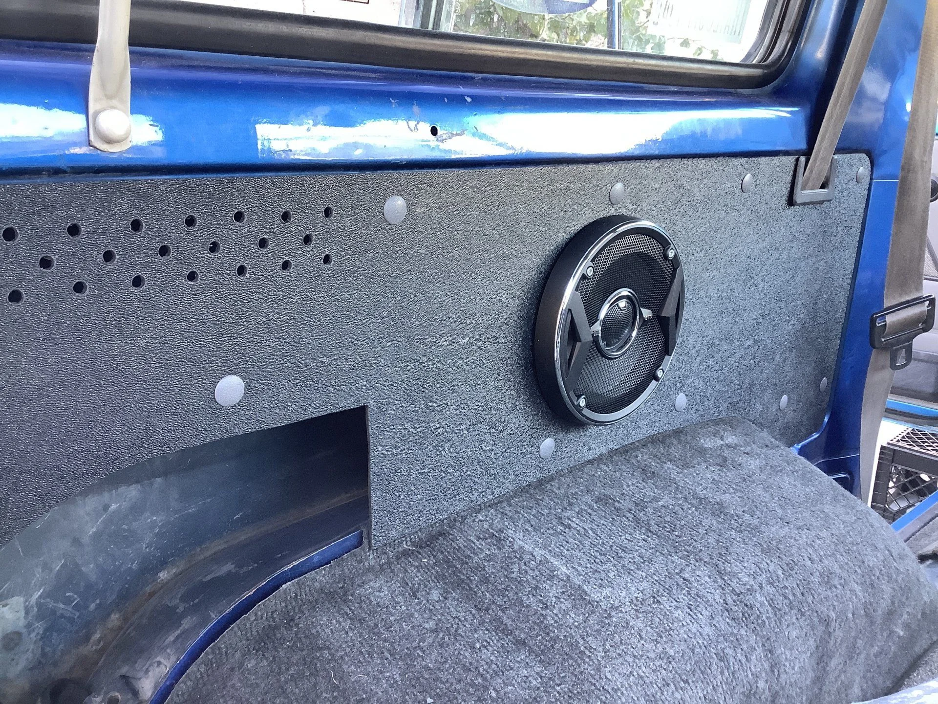

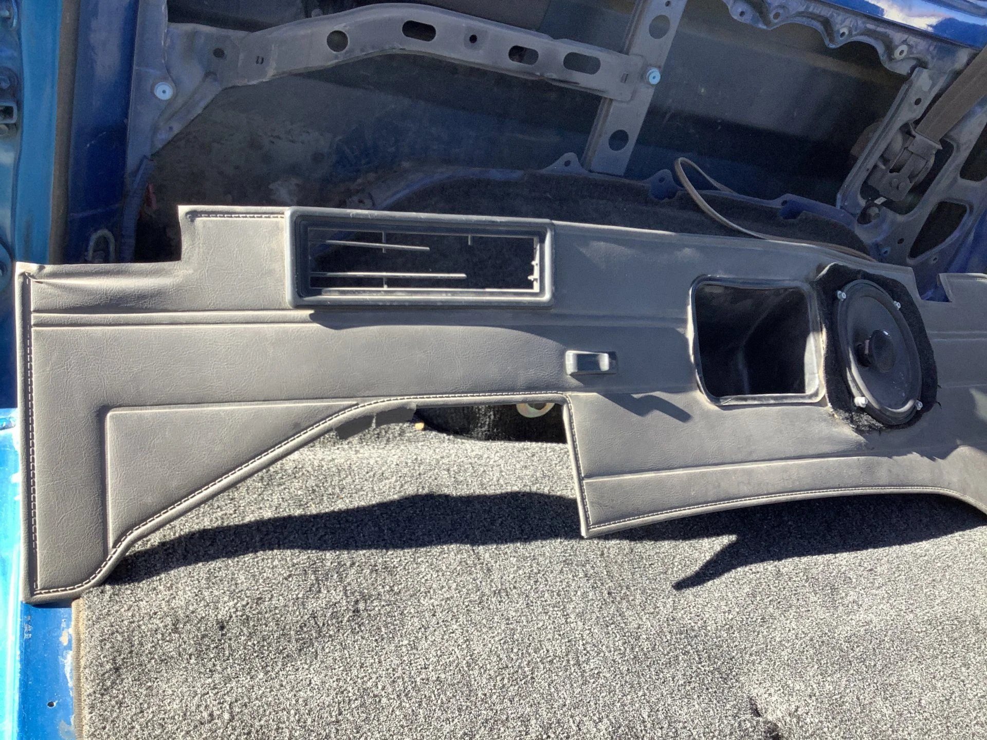

I finished dialing in the Inside Trim Boards today. Everything lined up pretty well, and I wish I had done this project a few years ago when I did the rear carpet. 1/8" Black ABS sheet match the grey interior rather well. I had grey on order, but the supplier couldn't get at this time.
So overall, I'm happy with the black. Don't for get the Trim Board Clips #90467-12031 for this job.

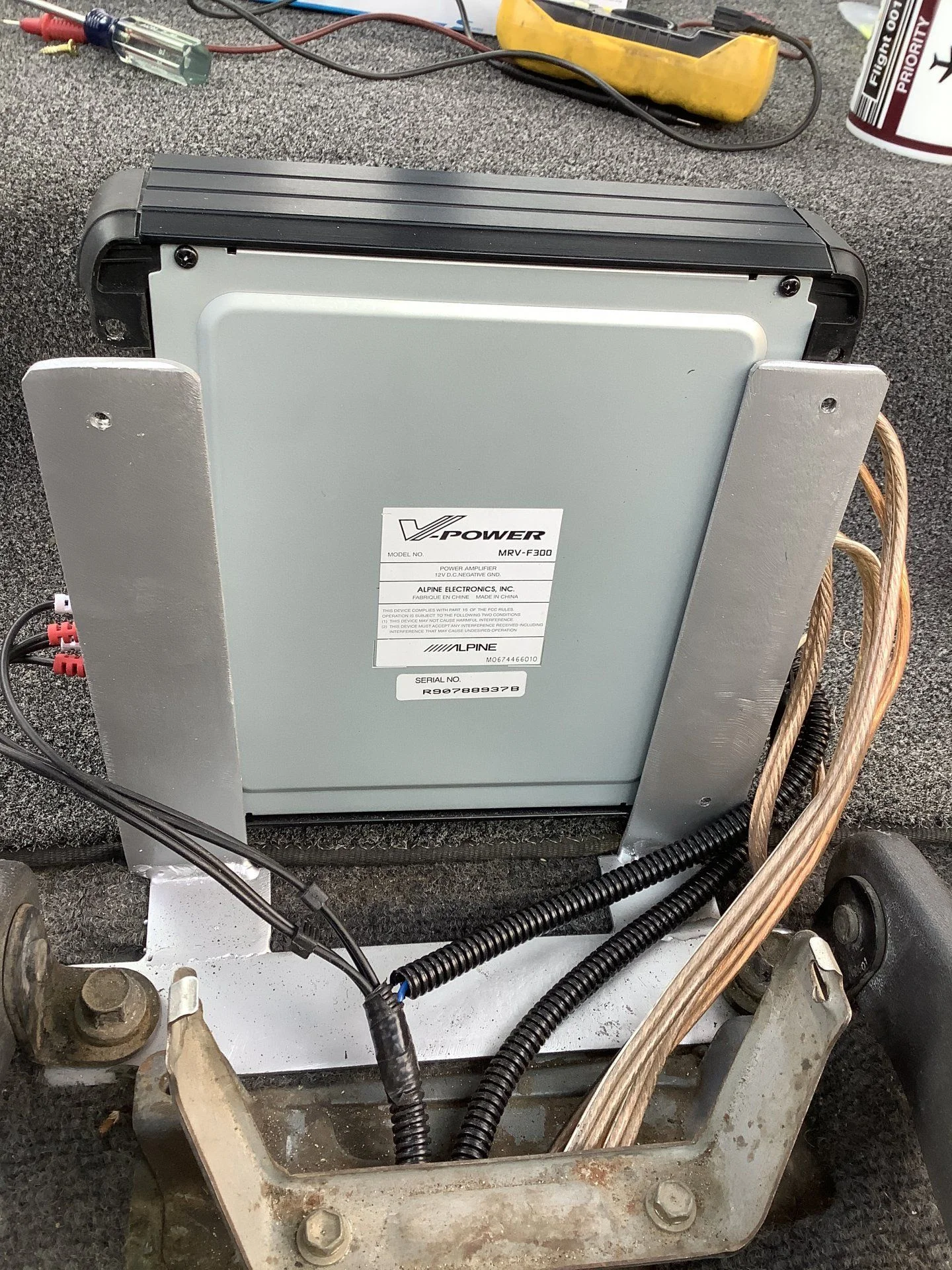

Fabbed up a mount for the Amplifier. The longest thing about these projects is deciding where to put things. In the end the amp went behind the center console. Toyed with the idea of hinding it behind or mounting it to the Inside Trim Boards but it ended up behind the console. There also seemed to be excessive dust and dirt entering the area behind the trim panels. Seat Belt mounts hold this unit in place.

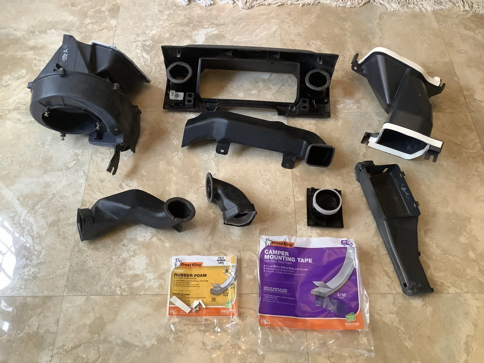

Starting to button things back up. Not sure if this will work long term, but put “Frost King” self stick Weatherseal & Vinyl Foam on the vent openings. Factory stuff was pretty much all gone. We shall see how long this aftermarket stuff lasts...
