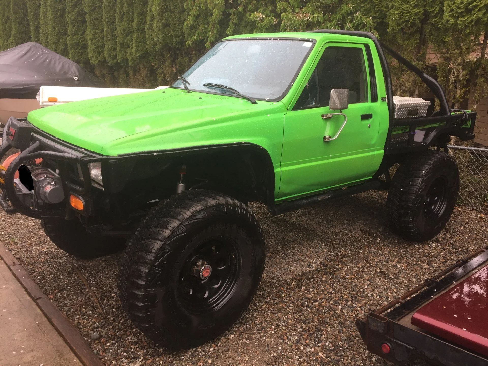

Yep. 22r with a carb. Don't let my signature picture confuse you, the truck I'm talking about is a 1985 standard cab pickup with a carb'd 22r. Before this happened, the carb was dialed in perfectly, so I don't think it has anything to do with the carb.
