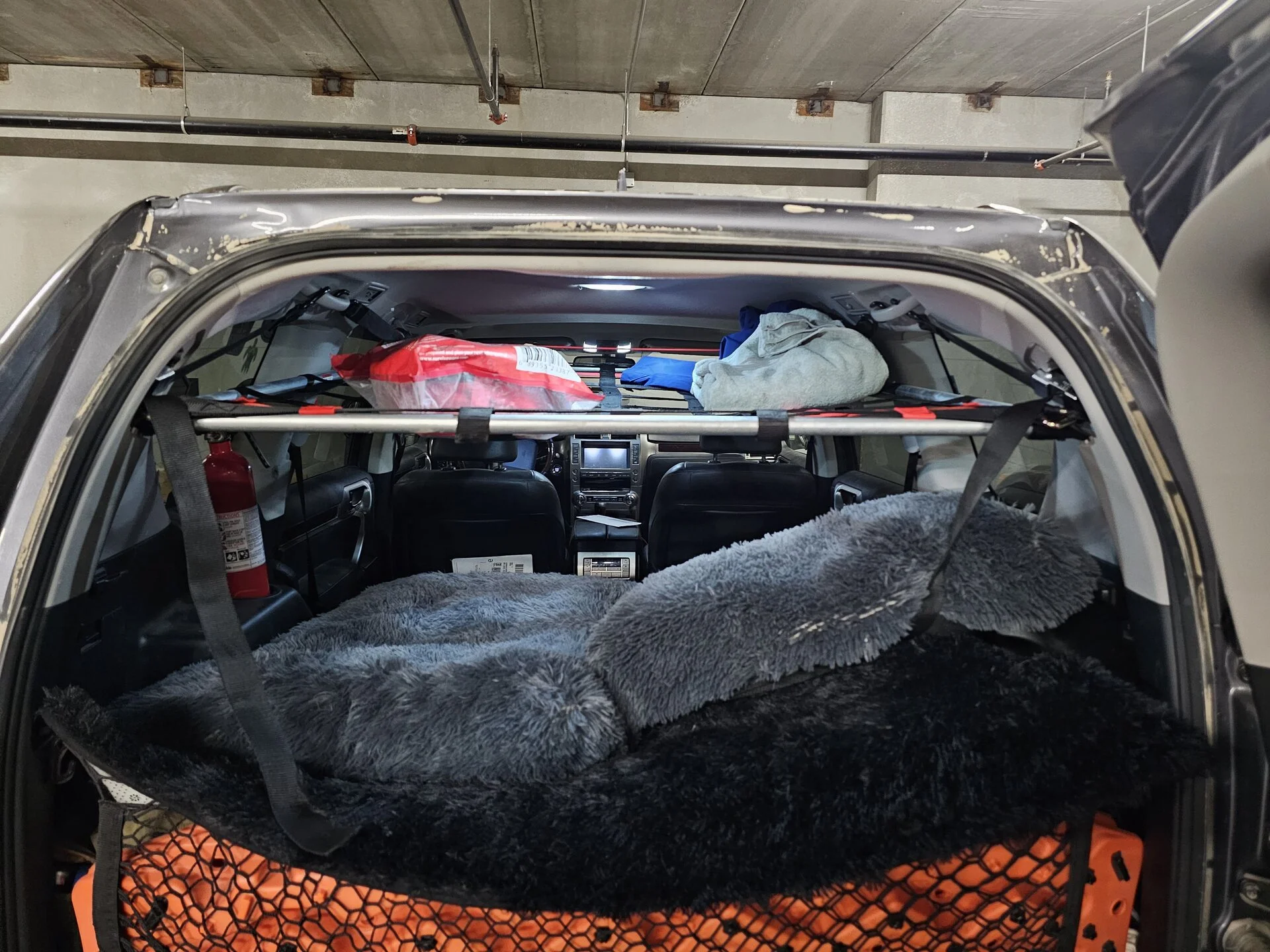

I am in the process of mentally tetrising 3/4" EMT together in my head to tackle all my interior storage needs. I figure I can do it for cheaper and lighter than about any other option. I will probably get something like a raingler meshed webbing to work with it and maybe some molle panels. I did figure it would make constructing the spare tire storage signifcantly simpler and I should be able to build everything inside for both less money and more capability.

Took a cheap Prime day cargo cover.
Bought some 3/4" EMT
Then I ordered some parts and pieces fromTink Tube and made this. I do plan on running some legs down somewhere to tie in to the floor and probably some variation of a diagnosis brace between legs.

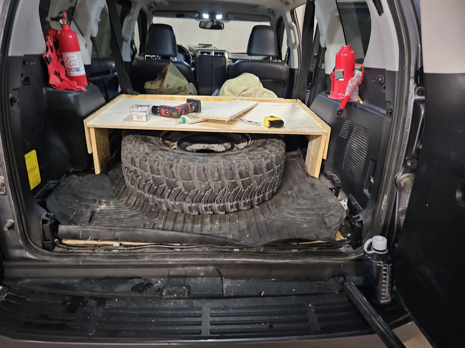

Just bought 2 more sticks of EMT, 2 1x4x6s and 1 1x6x6 and a piece of 2'x4' x1/2" plywood
One eternity later
I have a bunch more pics if anyone wants to see what I did. Lots of titebond #3 and rated screws. Also lots of engineered ply mixed with 1x pine. Everything is tied into existing seat tie in points so should be engineered to hold the wait of the tire.

One eternity later
Solves the problem of where to put an oversized spare!
It does! I sized it for up to a 37, because you gotta have life goals. 😄
It pulls out relatively easily if I need to put the second row in and should allow us to pack up with a lot of stuff, leave lots of room for the dogs, while leaving almost everything accessible.
I also wanted to make sure I had something that could help keep the tire contained in the event of a crash or a roll. I do plan on keeping the tire strapped down, just to be safe.
