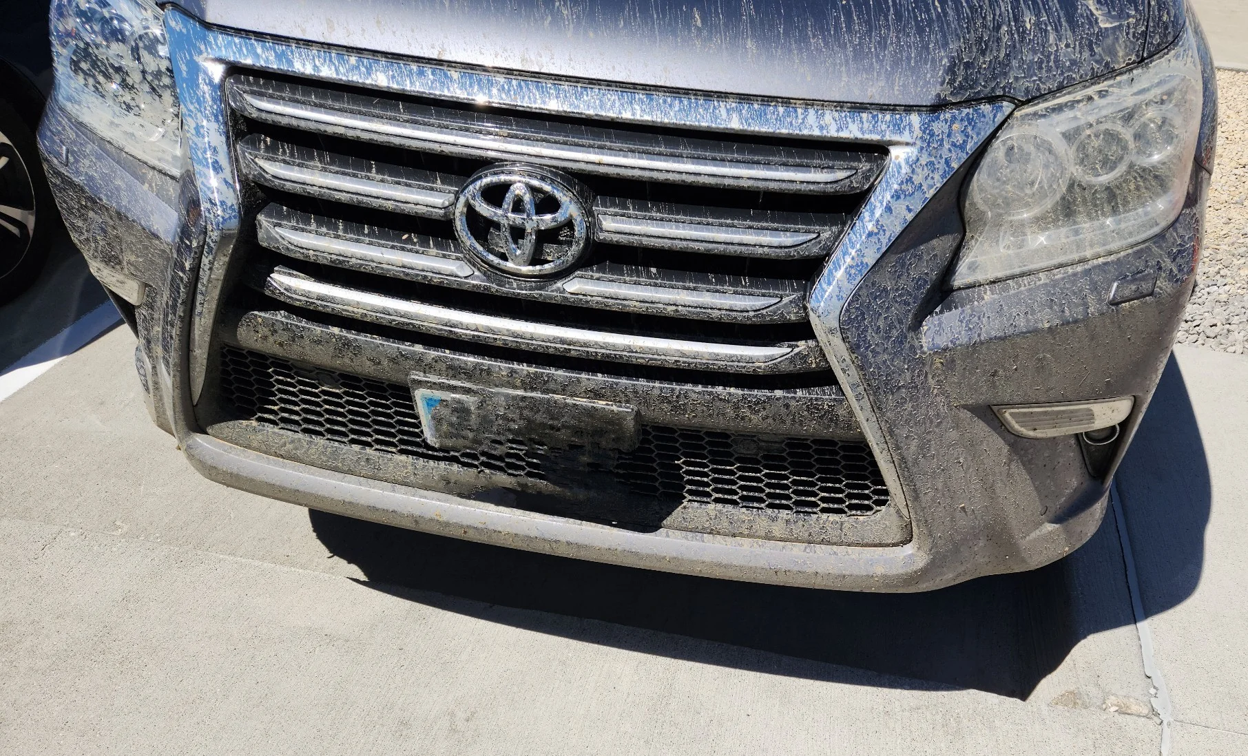

Pic of the front with some dirt from a B Road near where I work.

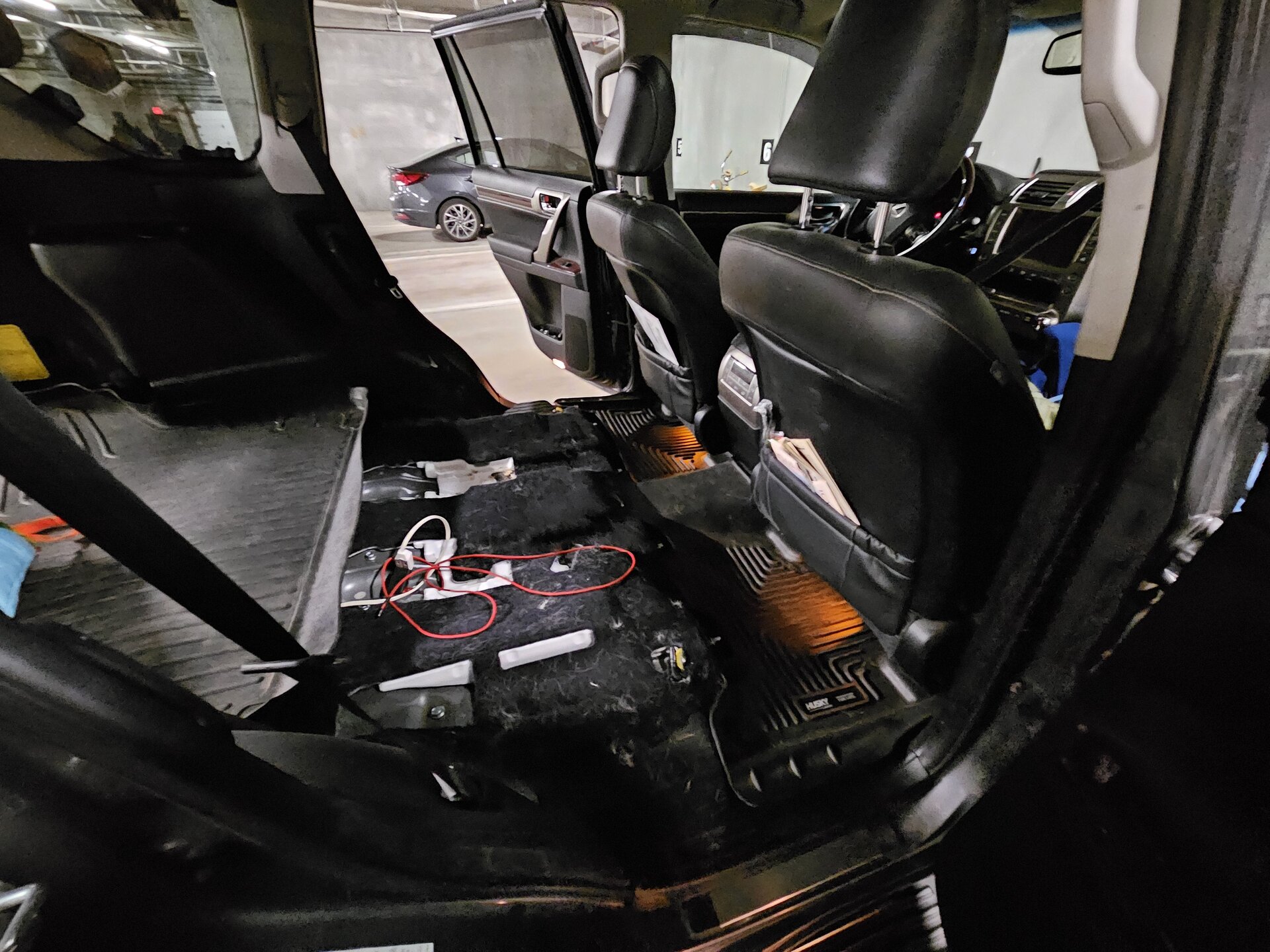

Discussed it last night and I am going to pull the second row as well.

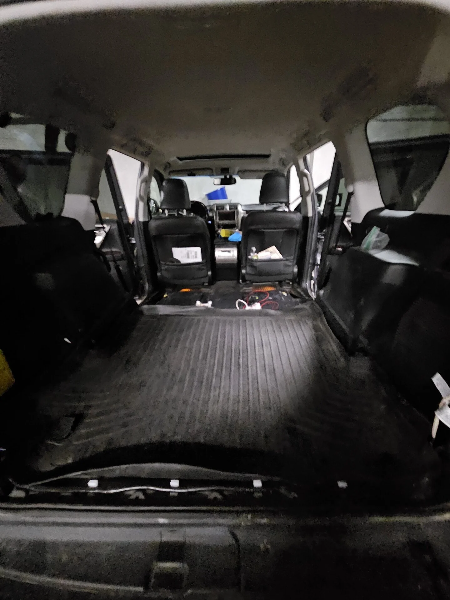

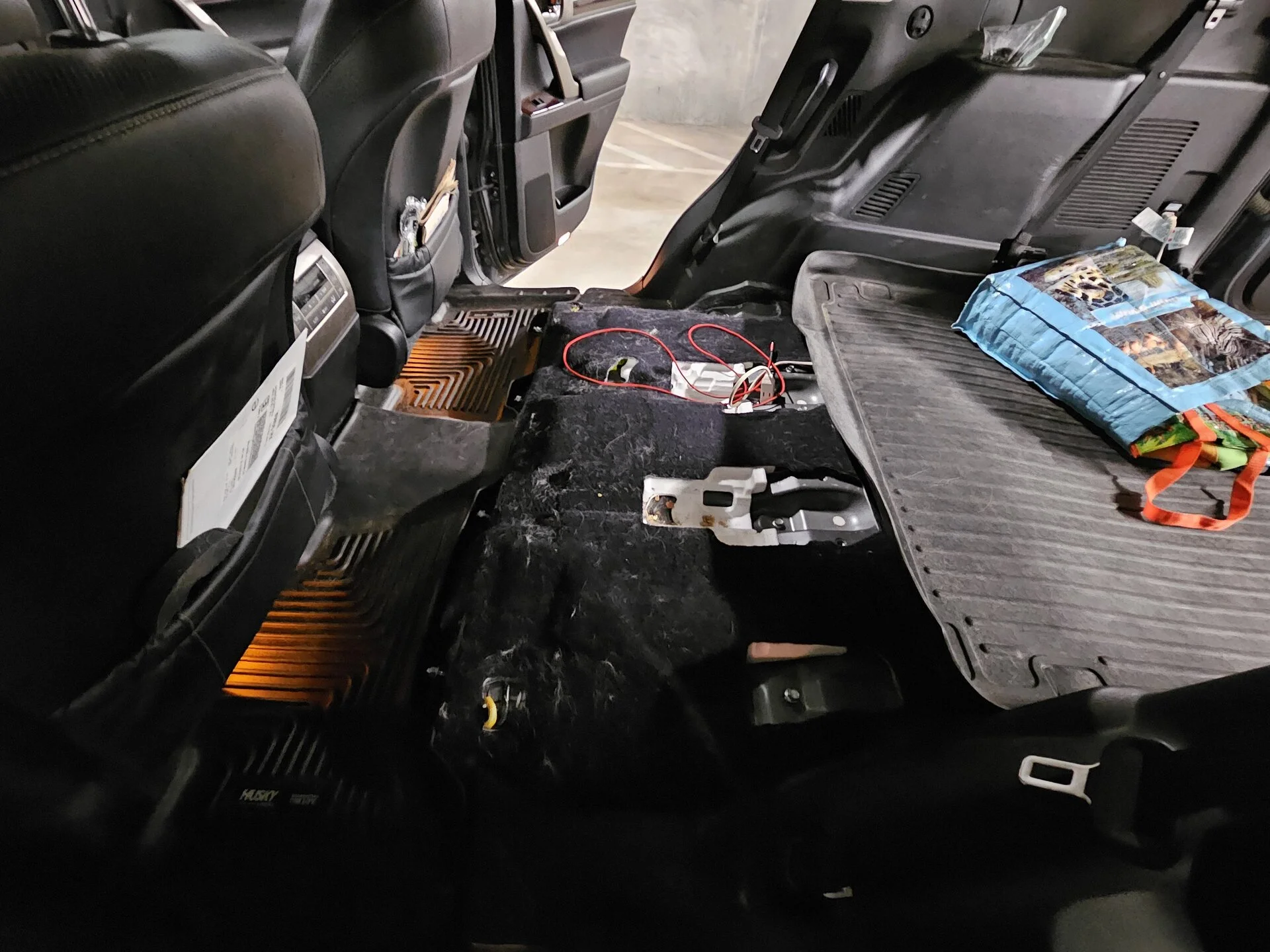

12 bolts and 4 connectors later and my GX is now a 2-seater. The carpet was disgusting, going to do a highway air out then clean it up.
It's pulled enough weight that it feels noticeable lighter than with just the third row seat gone.

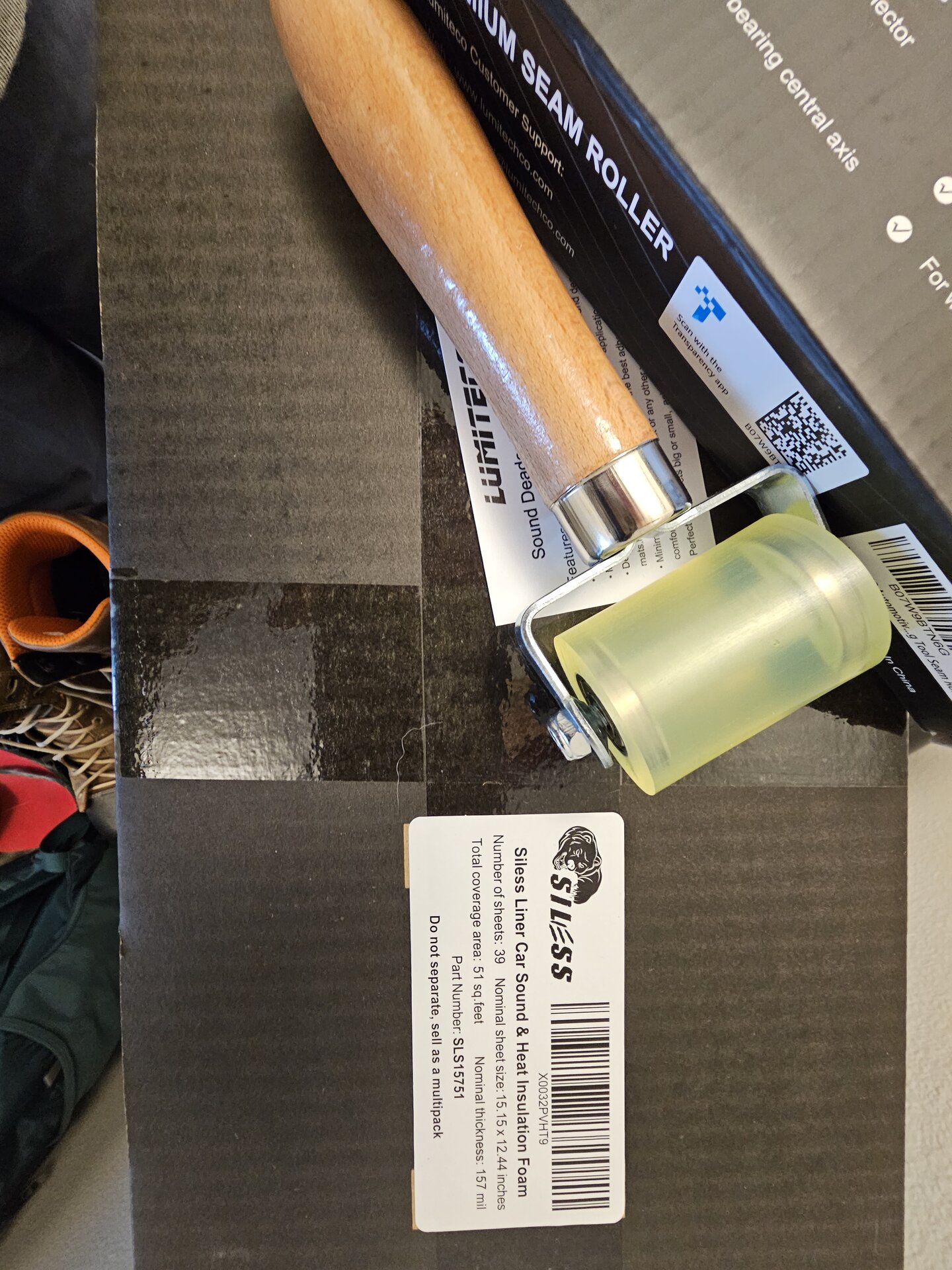

Yea... so about all that dynamat talk, I cheaped out.
I neurotically layered dampening material on the back flat metal area and it made almost no difference in how loud it is now.

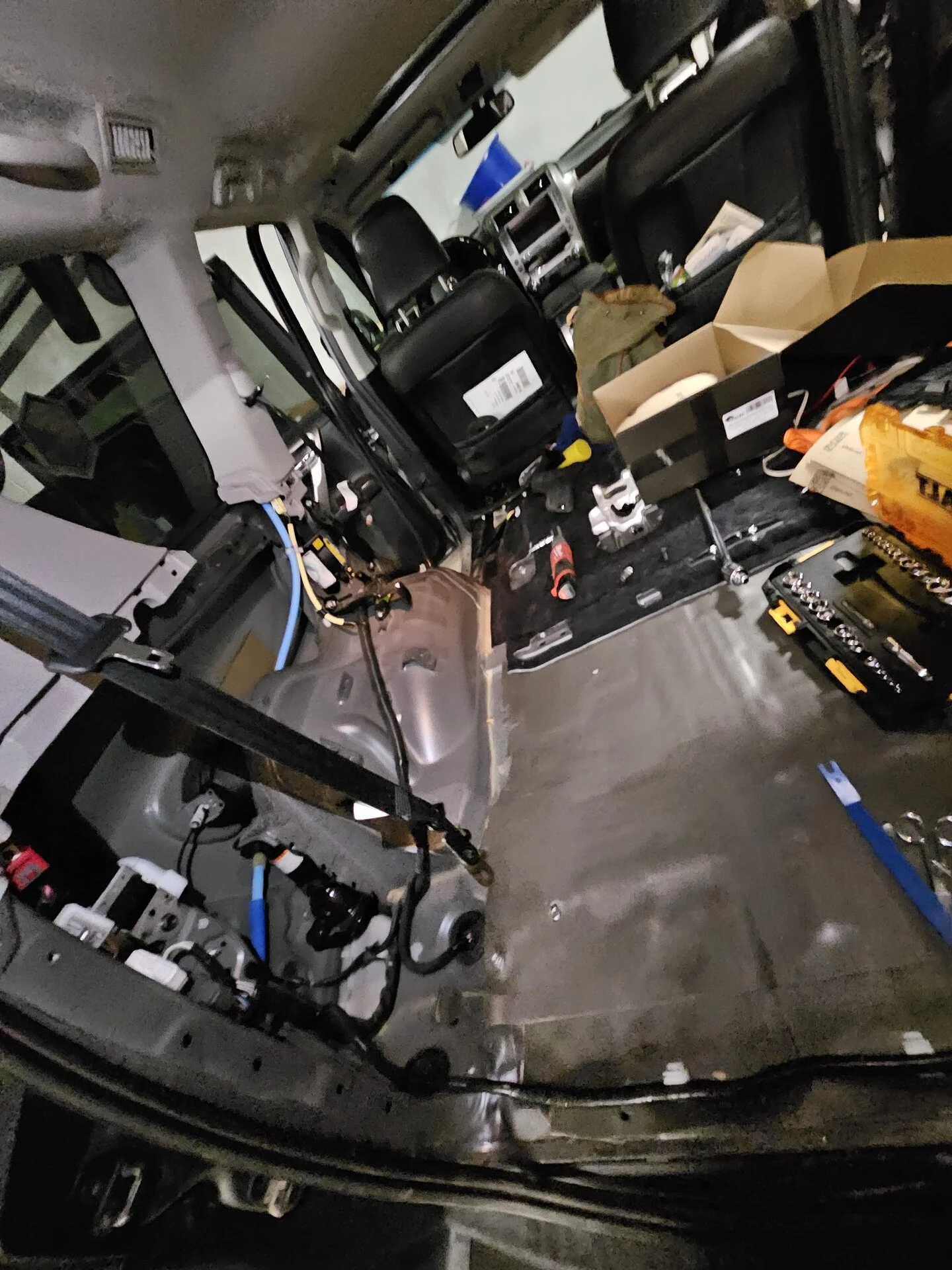

Second round of sound deadening made a noticeable difference. I also used it as an opportunity to pull loose the 3rd row seat belt.
I did a non scientific knock test to determine where to put and tried to cover the wheel well thoroughly as well as get the back side of the panels through the access hole. The duct from the ac unit can slide up and off to get behind it.
I have get enough energy back after dinner will do the driver side and if I have enough energy and maybe the tail gate.
Exhausted, got the barn door and other wheel well done. I feel especially in my forties, time to self medicate and chill.
This picture was taken when I was out of the back and happened to remember to snap a photo. I used most of the 51sq feet. Spent about 8 hours or so doing it. Should be a big improvement.🤞
I can confirm that the areas I did are quieter
And it's about 90% of the way to being quieter than before I started.
