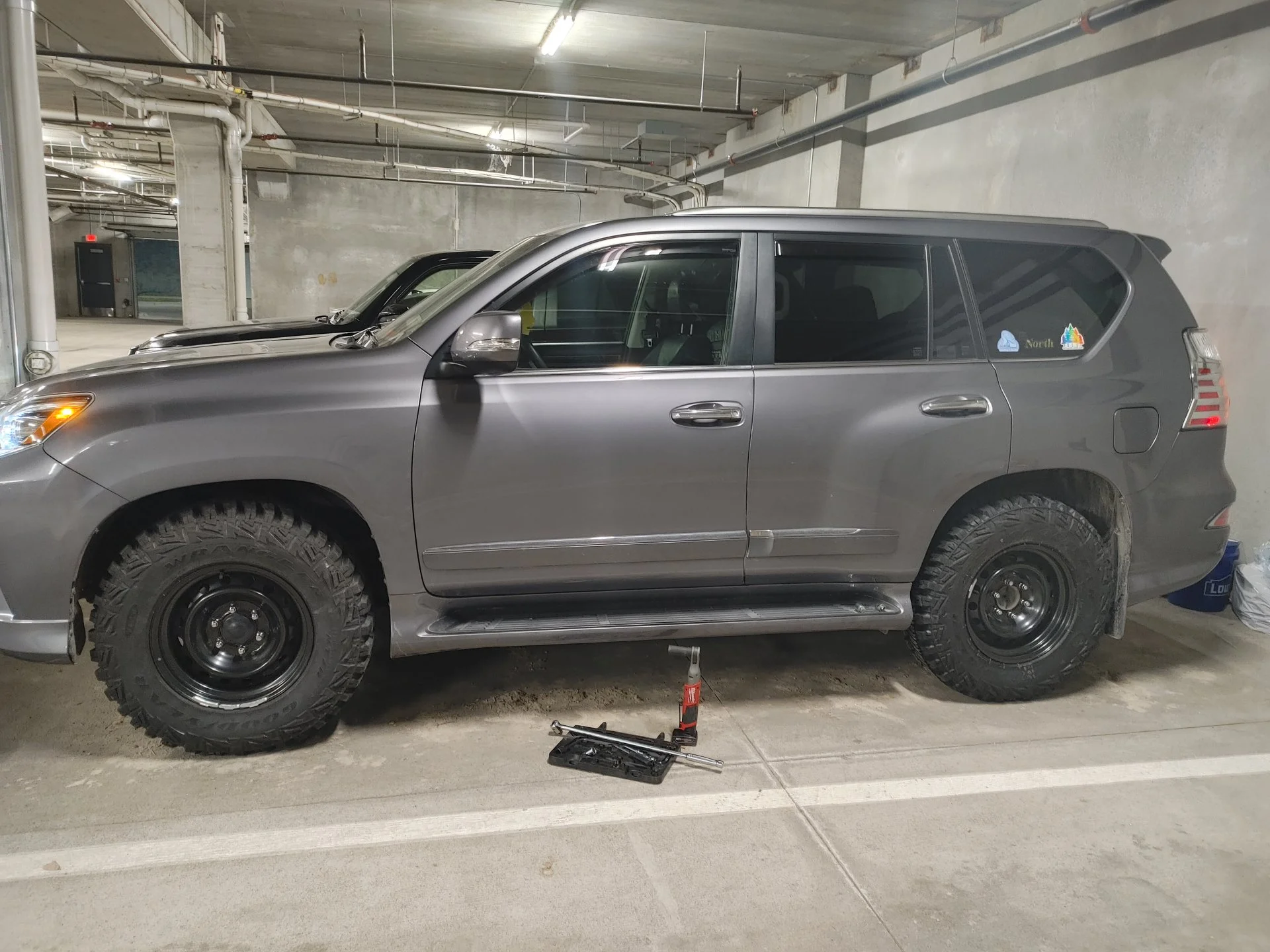

My build is pretty straightforward. I have aquired Bilstein 5100s that I have not installed yet as well as a set of Goodyear Wrangler MT/Rs in 33/10.5R17.
They are basically the same size as a 255/80R17 which my first two choices were. One tire was on national backorder Yoko G003 MT and the other is no longer in production, the BFG KM2. My fourth choice was also out of stock.

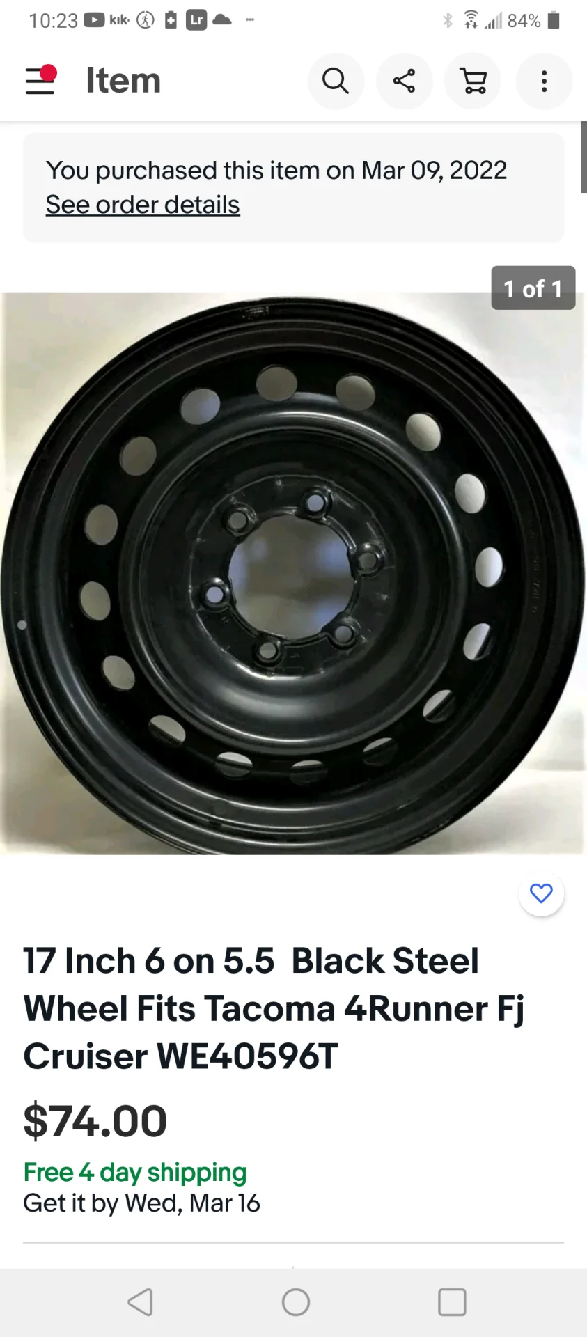

I mounted them to FJ Cruiser steelies take offs. I got 5 for less than $400 with shipping and tax.
I have already purchased hardware to pull back on the steps and swap the bolt head that rubs, I just need to install it and slide back my inner fenderwell inserts and redrill the holes.

Looking very para-military/utilitarian with the black steelies. Just needs a matte vinyl wrap, maybe OD green, sand or your color in matte? 👍
Thanks! Was definitely going with the utilitarian look. All function no form. Doing the opposite of what a lot of people do, with their negative offset wheels and excessive lift that limits articulation.
I might have to steal that look. I haven't seen a dark gray GX with black wheels that I have liked until this one.......👍
Go for it! The wheels are pretty much new and were a great deal. They are the perfect offset for pizza cutters or stock sizes, and they weigh about 30 lbs each so a bit heavier but not a crazy amount.

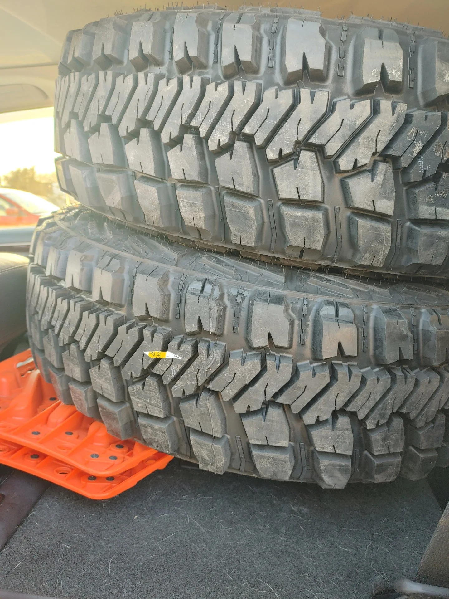

I had noticed that one of the tires was installed differently than the others. I was oblivious during the install as I was focused on other things.
Upon closer inspection, 3 of the tires were inside out. Called Discount Tire and made an appointment to pick up the spare, which had come in, as well. Well, the spare was also inside out. They got me fixed up and with veteran discount I was out the door for about $1540, mounted and balanced, for all 5. (What I paid a week and a half ago)
On a side note, the tires are slightly quieter and ride incrementally smoother, now they are on properly.

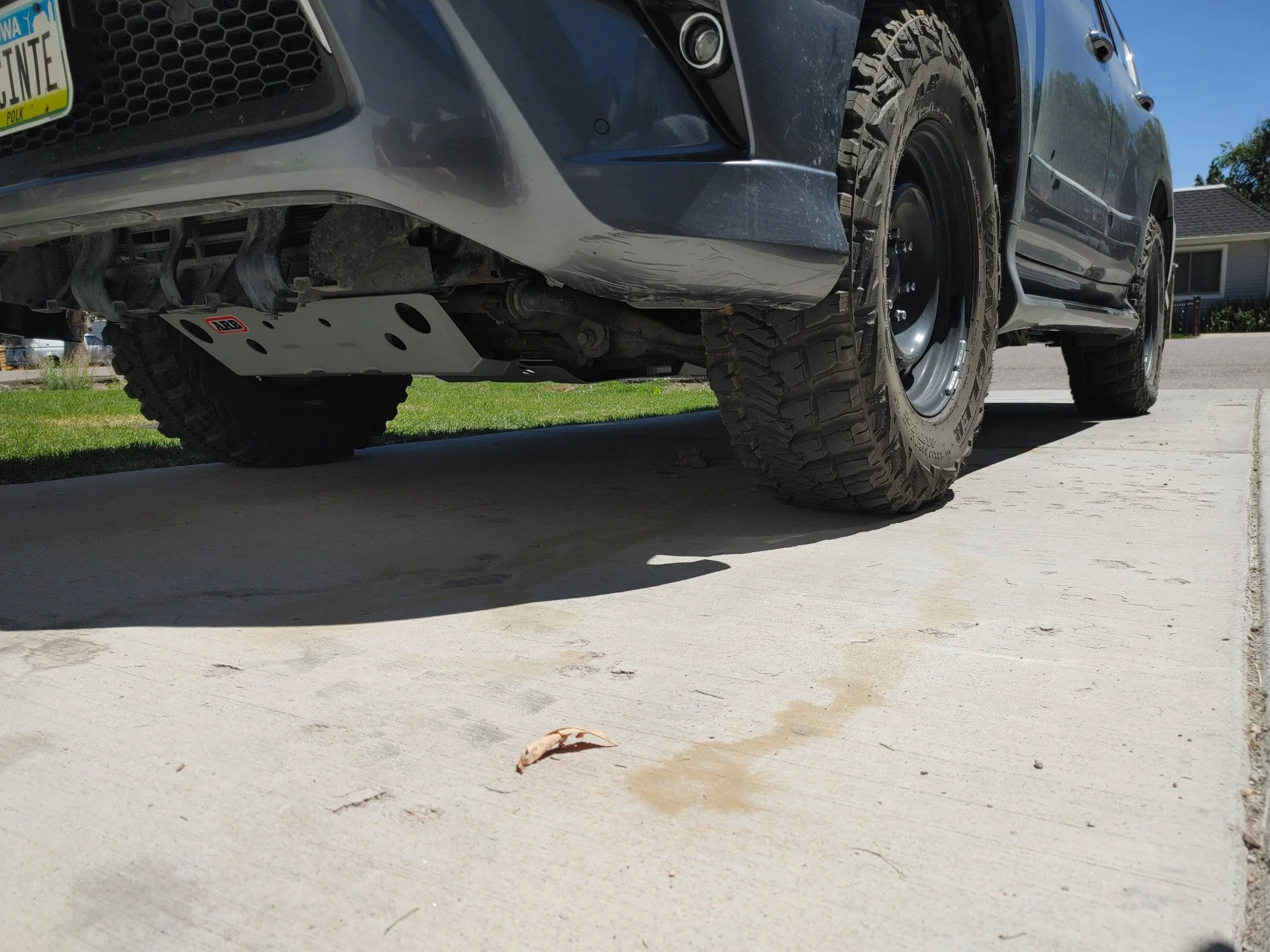

Picked up some ARB skids from Slee while visiting in-laws in Golden. Just finished putting them on this morning. This is the first real wrenching I have done on my GX and I think it went really well. I would definitely appreciate the added room when I do lift it. I am not as svelte and contortable as I was on my early twenties.

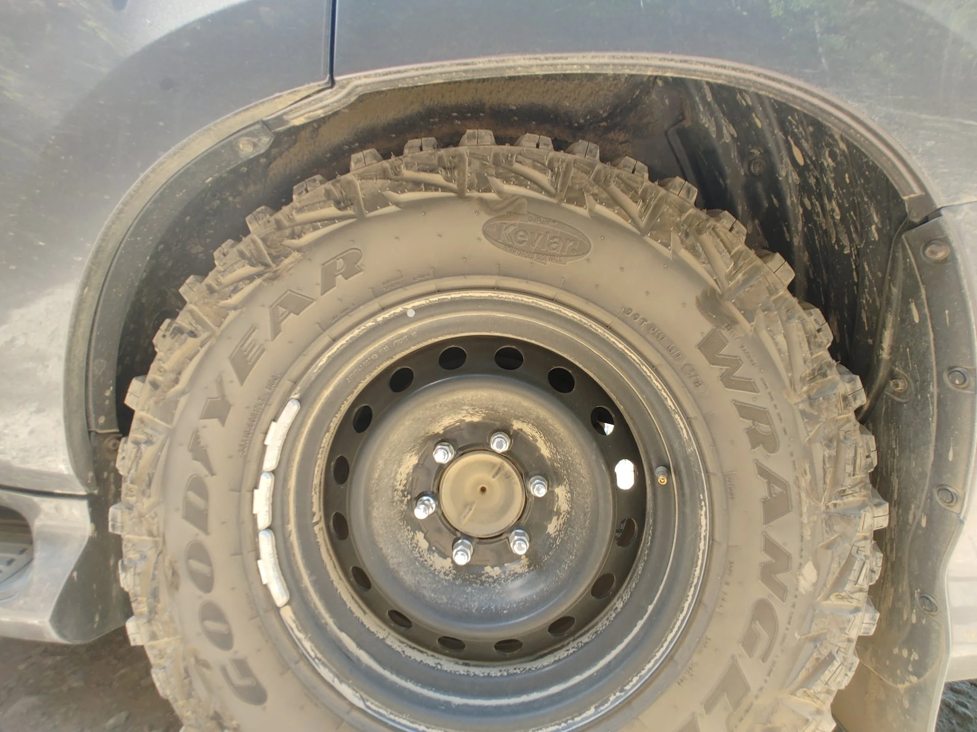

Spent a bit of time with the liners and only using zipties I eliminated the rub and hope to have a steel bumper by next summer.
In the end I only plan on doing a small lift, so I wanted to make sure I didn't have issues rubbing at factory height.

I definitely like how they tuck up in the wheel well and I know if I had any more backspacing, they would rub almost everywhere.
With the ARB skids. If I can get it flexed up I might try to get some pictures of it, showing the tires tucked in the wheel wells.
Not super flexed but slightly stuffed.
Second shot is looking up into the wheel well to show that I wasn't rubbing, my first real opportunity to safely flex it.
