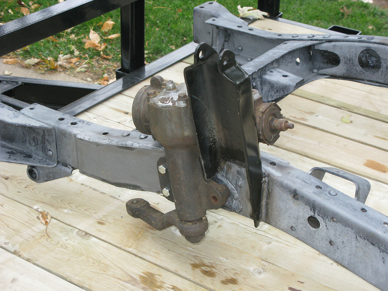

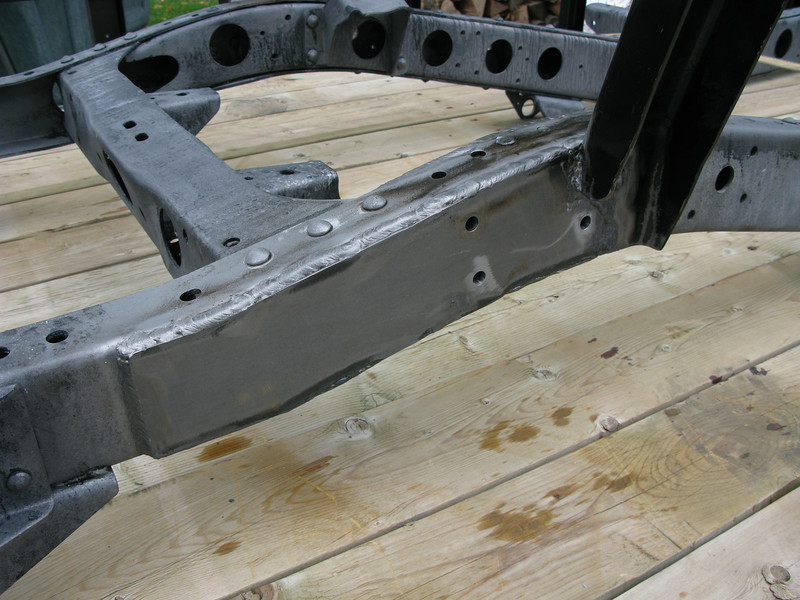

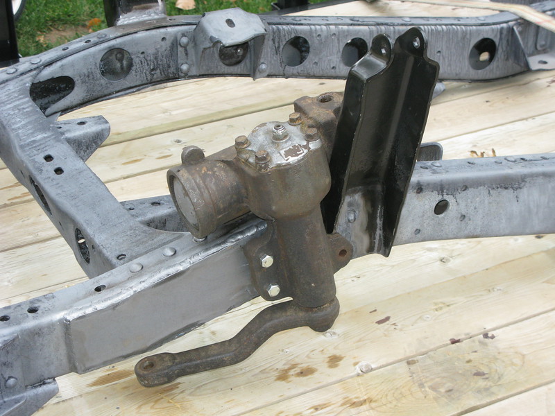

Scout Saginaw
Plated inside and out with 3/8, sleeved.
The hex nut is gone now, got a little hot on the sleeve and it stayed put. 4.5" angle grinder is my friend. So is a Lincoln 255.
Hope it's all in the right location.

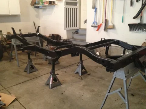

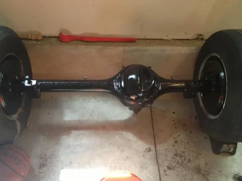

I got my frame back from the blaster. Stripped it down, degreased, etched and coated it with POR-15. Also coated the axles and started installation of an OME suspension kit.
All new tie rod ends swapped in and I took out the old diff drain plugs and put in new magnetic plugs.

Are you top coating over the POR15?
I have a trailer that was finished in POR, not pleased with how it weathers the sun. Seems it needs a top coat of paint.
Mine is rolling on OME now, will get a pic. I need to put together $$$ for my steering. Box rebuild and pitman (I am not sure I have the one I need) and tie rods / ends. I also need to put this in reverse and do the axle overhaul, which will take some more money. So long as it is a roller, it is using 35 year old axle parts.
How is your motor?
I have a partial can of chassis black from POR if you want to topcoat your POR15. I did the front and rear sections that get sunlight. Warning.... It is slightly different sheen.
