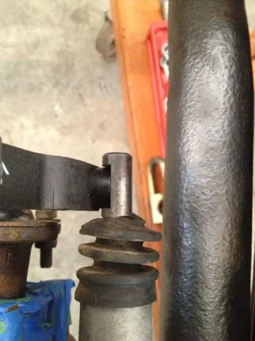

Mine seems to work okay, but it looks to me like I must be missing a piece of the linkage. The linkage bar has a round bit that sits in a slot on the shaft of the PTO gearbox. It can easily just pop out of that slot. Was there some kind of retaining clip at one time?
