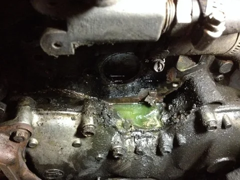

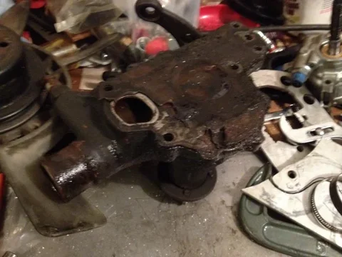

Here's to fixing leaks! Replaced disintegrated water pump gasket only to discover the WP also leaks from the weep hole. New WP is en route.

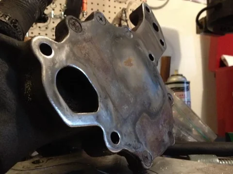

Removing the old gasket thoroughly
What a mess
