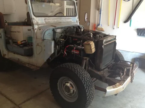

Took apart the fuel pump and cleaned it out. Then I pulled apart the carb and cleaned it out. It's amazing how much stuff gets in there after 20 years of sitting.
do they still sell the fuel pump rebuild kit? i remember rebuilding one of those a decade or so ago. i have a couple of those pumps lying round..
Mine was just all gummed up with crud. So I cleaned it out. The I wasn't getting gas past the banjo bolt on the carb do I took the carb apart and it was full of all kinda crap. From mud dobber nests to you name it. Once we did all this she fired up without any starting fluid for the first time in 20 plus years.
