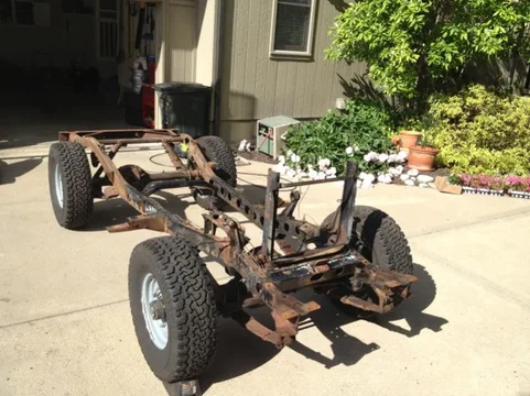

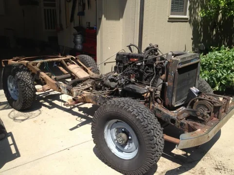

Pulled the engine and transmission! I'm hoping to get the frame all cleaned up and painted soon so I can start rebuilding it.
Today I finished stripping the hardware off the frame and power washed it for another hour or so. Then I blew the last bits of water and debris out of the boxed part of the frame with a leaf blower. It's really clean and almost no rust until you get to the back and then it's really just surface rust.
I broke out the angle grinder with a knotted wire brush and started wheeling it. For the most part, it looks great and ready for primer. Obviously, I'll never reach the inside of the frame or some of the tighter nooks and crannies. Should I just go ahead and take it to a sand blaster? I'm thinking I'll get a much better end result between the more thorough removal of old paint and rust and the better "tooth" for the primer to adhere to. The frame should be pretty easy for two guys to lift onto a trailer, right?

Yes on the sandblaster. then plan on getting primer on it immediately when it returns. There is some paint in a can that has a long hose that some guys use to get inside the box. Forgot the company.... Erik, what is that stuff?
Yes on two guys moving the frame.
eastwood sells a paint with a hose for the inside frame.. I used an eastwood gun to shoot the inside of the frame, had a long hose with a wand that I just kept moving along inside the frame. THen shot the outside with the regular HVLP gun.

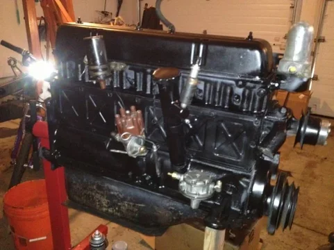

I've also been scrubbing and stripping my cruiser's engine for the past few days. I finished that this afternoon and got the thing painted.
I had another busy day today! Stripped and painted the oil pan that looks so bad in the above picture. Also stripped and painted the oil filter canister, bellhousing and some other smaller engine parts. Took off the water neck and polished it for a little bling.
Put in the proper air rail plugs and got rid of the crimped/JB Welded air rail tubes.
