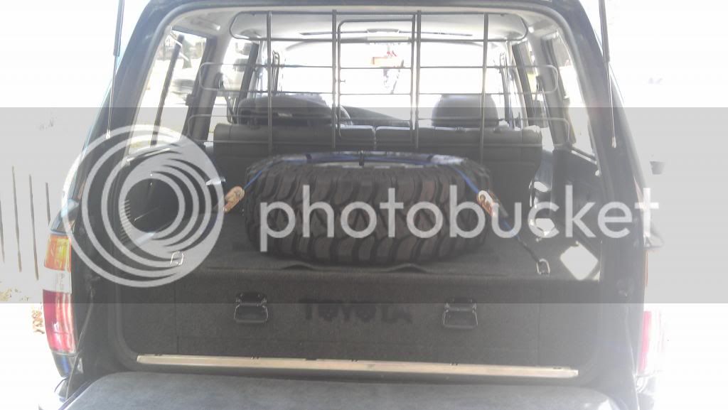

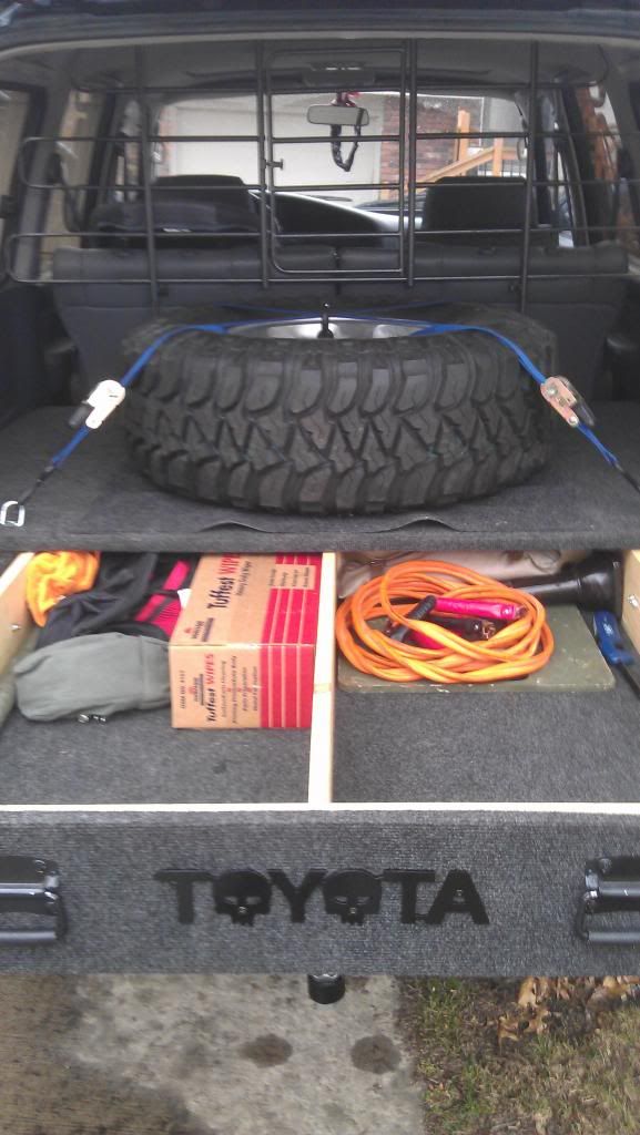

Added a few touches to the rear of the 80 yesterday. Installed a garage sale divider ($5.00) and added my CNC TOYOTA logo to my drawer system. Also extended the front diff breather still need to fininsh the rear and t-case.

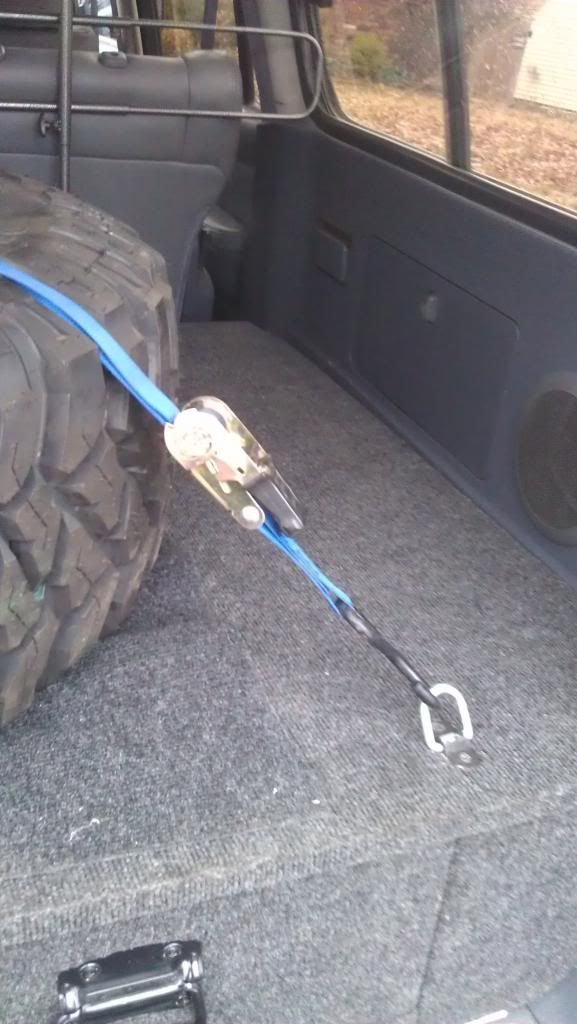

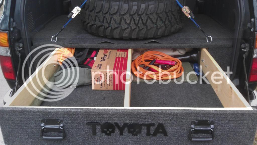

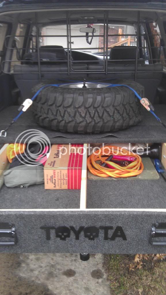

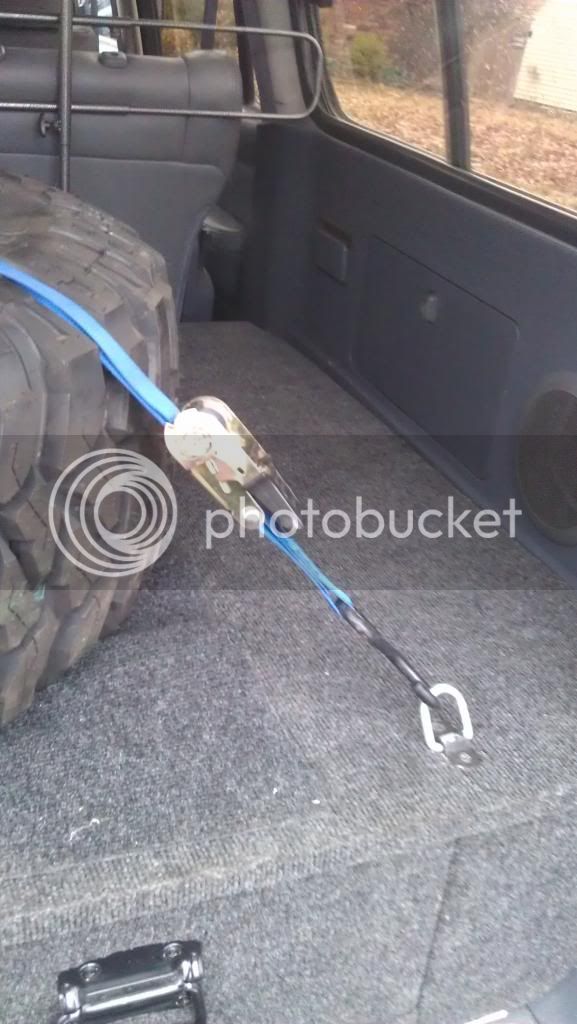

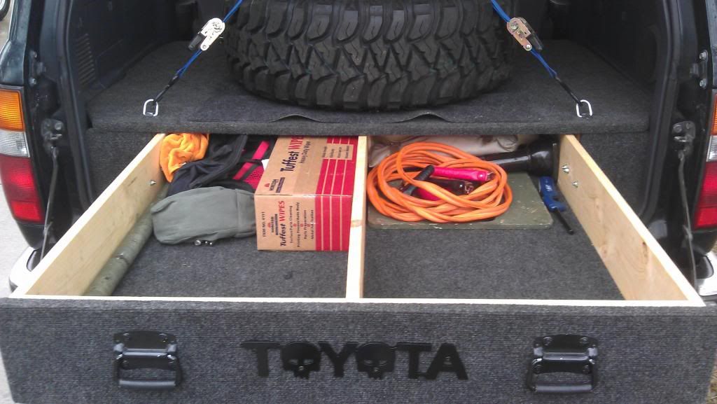

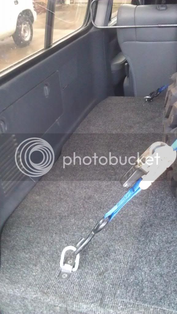

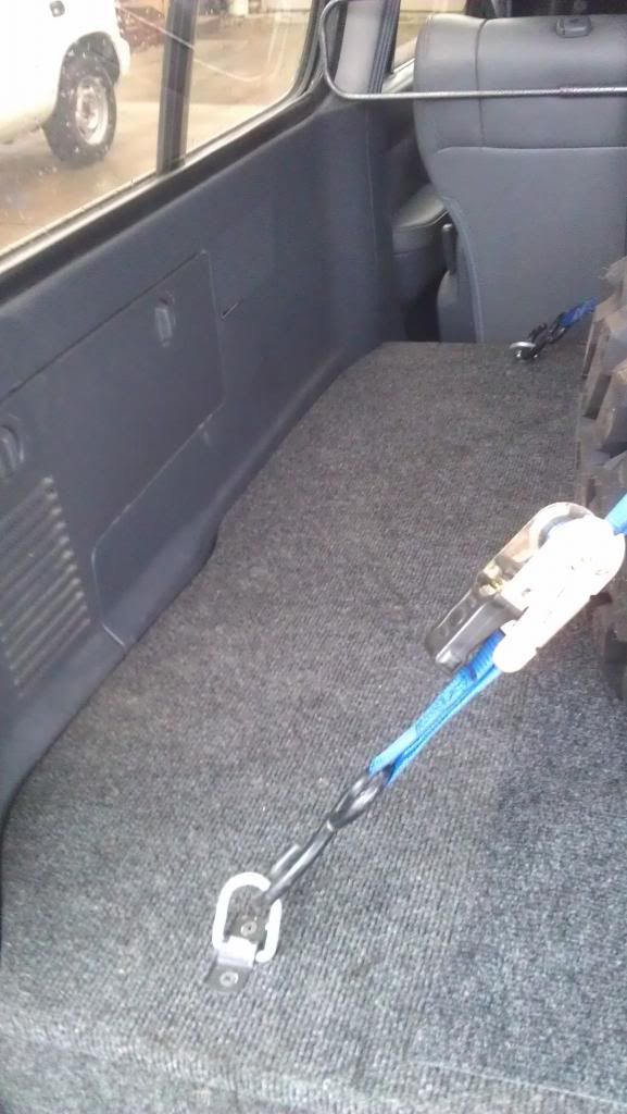

Yeah I built it nothing fancy it's a single large drawer built it about a year ago now, its seen pretty good use and holding up pretty well. I spent maybe 80 bucks in materials minus the slides. I cant recall how much they were.... I do remember they are 500lbs from McMaster-Carr. I'll get some more pictures tomorrow.
More pictures... I don't have any of the build. Its secured to the 3rd row seat mounts inverter will be going in soon.
In a nut shell framed it out with 2x10's the drawer is 1x6 white pine with a 5/8" plywood bottom, the deck is 11/16" and is one solid piece I wanted the structural strength of a solid deck. Before I screwed down the top I sat on top of it putting all my weight on it then secured it to the 2x10 frame. I did this to put a friction on the drawer it worked very well. It holds the drawer closed with a great amount of force. I have 2 load-bearing clamps from McMaster-Carr however I haven't needed to install for the past year its been in the truck.
I used outdoor carpet, spray adhesive and staples to secure it.
I didnt want to have a huge or tall setup thats why I opted for a shallow profile it lines up with the 2nd row folded down.
Hope these help with your plan.

Nice work, it looks pretty sharp especially the Toyota emblem.
Most likely I'd keep it one big shallow drawer. This way every thing is right there. I really don't have to spend a bunch of time looking under things or in different drawers. Just an ease of use type thing for me, and less materials to buy; slides, wood, carpet. They are not full at the moment but for trips they are usually at capacity with an extra birf, tools, etc.
I looked at many set ups before I did these and didn't really like the deep, double drawers. They were just to bulky and looked to reduce the area of the rear. Thanks for the kind words and good luck on your build.
