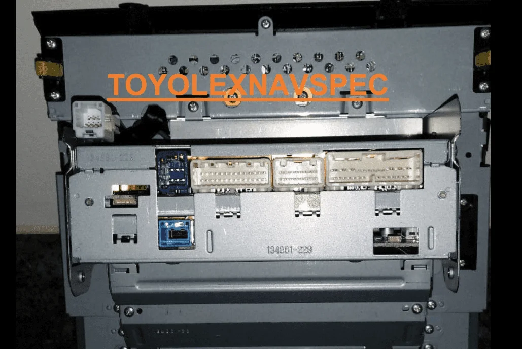

Does anyone have any photos of the rear of their navigation and radio units? I am looking for the pins as shown above. The FSM shows all of the plugs but it is tough to tell which plugs actually attach to the back of the radio/nav units. If we have any members with a non-nav 200 with photos that would be huge.

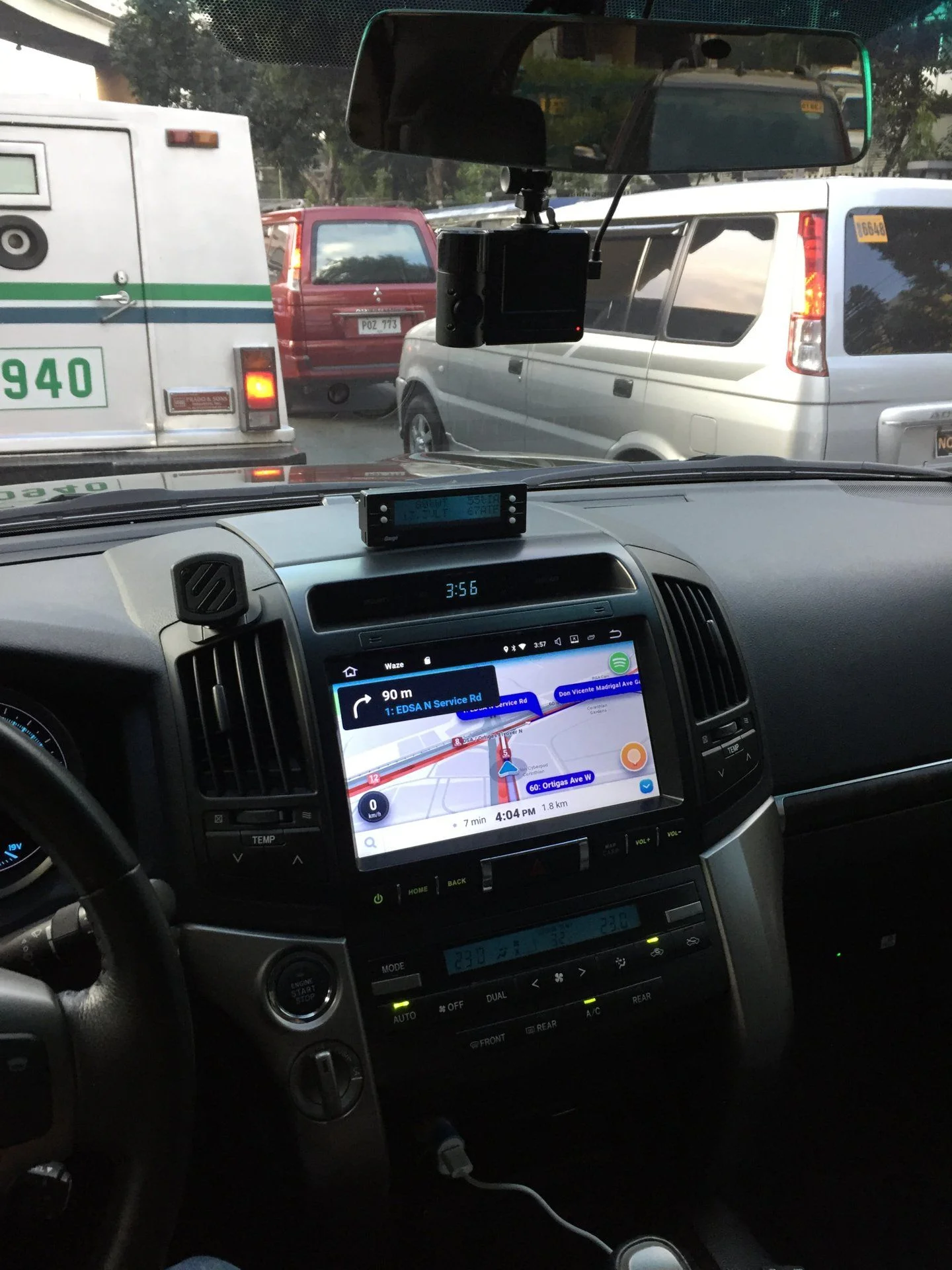

The new double din stereos have Waze and apple car play. They are as current as can be.
It's called Android Auto, or Apple CarPlay. Toyota is notorious at being slow to add tech like this to their cars, maybe they don't want to pay the ransom fees. But they are starting to show up in other models.
I put an aftermarket Pioneer double-DIN touch screen head unit in our Highlander last summer, I finally had enough of the pathetic factory unit with no Aux input, and I wanted the car to have a backup camera. This unit has Android Auto as an option, but you have to connect with a USB cable, which is a nuisance. They do this because the constant data streaming kills the battery in the phone in no time, but I see articles that they've fixed that now, Bluetooth is am option. It basically mirrors the phone screen on the head unit, although somewhat simplified. It works... OK, but not great, and not worth the hassle. On the very rare occasions that she needs nav, it's fine to just listen to the voice from Google.

I was mirorring Waze from my iphone to a Pioneer head unit via AppRadio until I got an Android head unit. The Android is much better to use. With AppRadio, the phone had to be plugged in with the screen unlocked, and it gets hot because of the mirorring and charging going on at the same time. I would imagine it's the same with CarPlay. With the Android head unit, I just tether my phone's data to it. It doesn't get as hot as before and doesn't drain the battery as much.

In my non-nav 200, the radio plugs are the standard 1987-up Toyota radio plugs (10 pin and 6 pin) plus a separate plug for the steering wheel controls. I'll see if I can take apart the dash this weekend and take a photo of the backside of the climate control unit

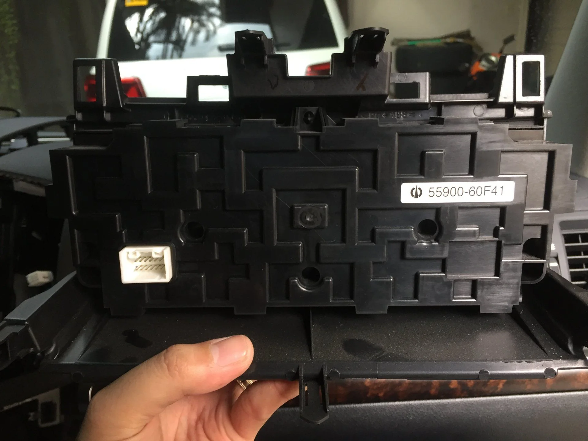

If you could that would be very helpful. I am looking for the plugs on the back of the climate control unit. I am trying to determine how many plugs are actually in play. The FSM does not show different climate wiring between the nav and non-nav. I am having a hard time believing the pin outs are exactly the same on the two. The radio are generally standard but the more photos the merrier.
I had some free time today and decided to pull apart the dash and take some photos. The part number on my 2011 LHD VDJ200 is 55900-60F41. The part number may be different on the 2013 since those have a green backlight on the LCD screen instead of the bluish-aqua backlight on the 2008-2011
