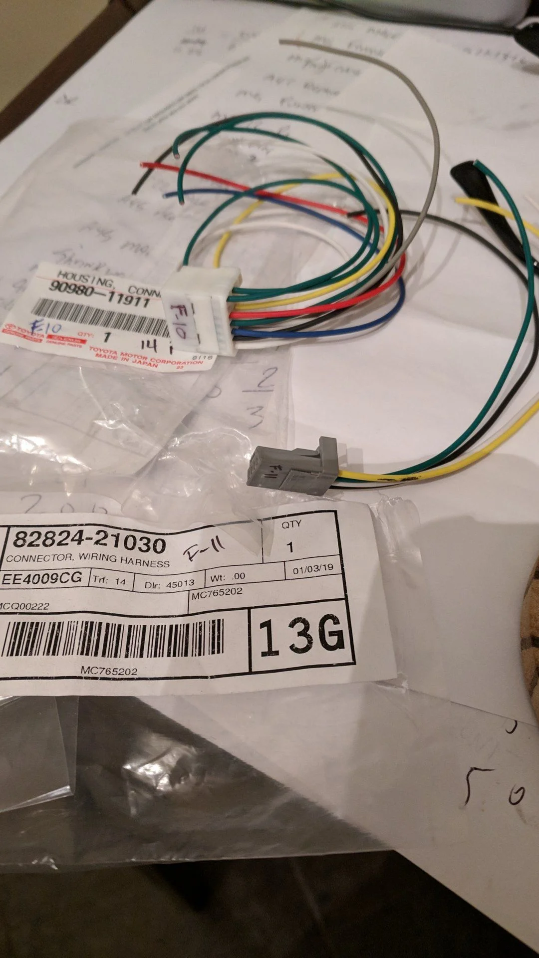

the .64 terminals for the g1 should be these, 1123343-1 (Loose Piece) TE Connectivity / AMP | Mouser
that's what I use for the .64 III with 22 gauge wire. That will be the exact same thing as the 82998-12870 toyota repair wire.
the f10 should be 1.0 III, and if the repair wire is 82998-12690 then the same terminal is this, 316837-2 (Cut Strip) TE Connectivity | Mouser
you can get those as loose pieces from other places instead of the 100 minimum from mouser. From what txsundevil posted the f11 is the same as the G1 as far as terminal goes.

You are correct, the repair wire for the F10 connector should be 82998-12690 and G1 is 82998-12870.
The repair wire for the F11 connector should be 82998-12750.
The F10 toyota # 90980-11911 takes mouser terminals #571-316837-2 cut strip. They are 25 cents each online. The Housing is 6.80$ from toyota. I have not found a matching TE conn/AMP housing, yet.
The F11 toyota # 82824-21030 takes mouser terminals #571-1123343-1 loose piece. They are 10 cents or so. The housing is 6.50$ from toyota. I have not found a matching TE conn/AMP housing, yet.

Yes, the new plugs, with the repair wires installed, will have roughly 6" pigtails, so you need to solder/heat shrink a length of wire to each one and then run each individual wire back to either the location you are tapping (splicing) into (ECU or other system location) or to the original plug. If the original plug, you can splice it into the existing wire or simply cut it and solder/heat shrink.
