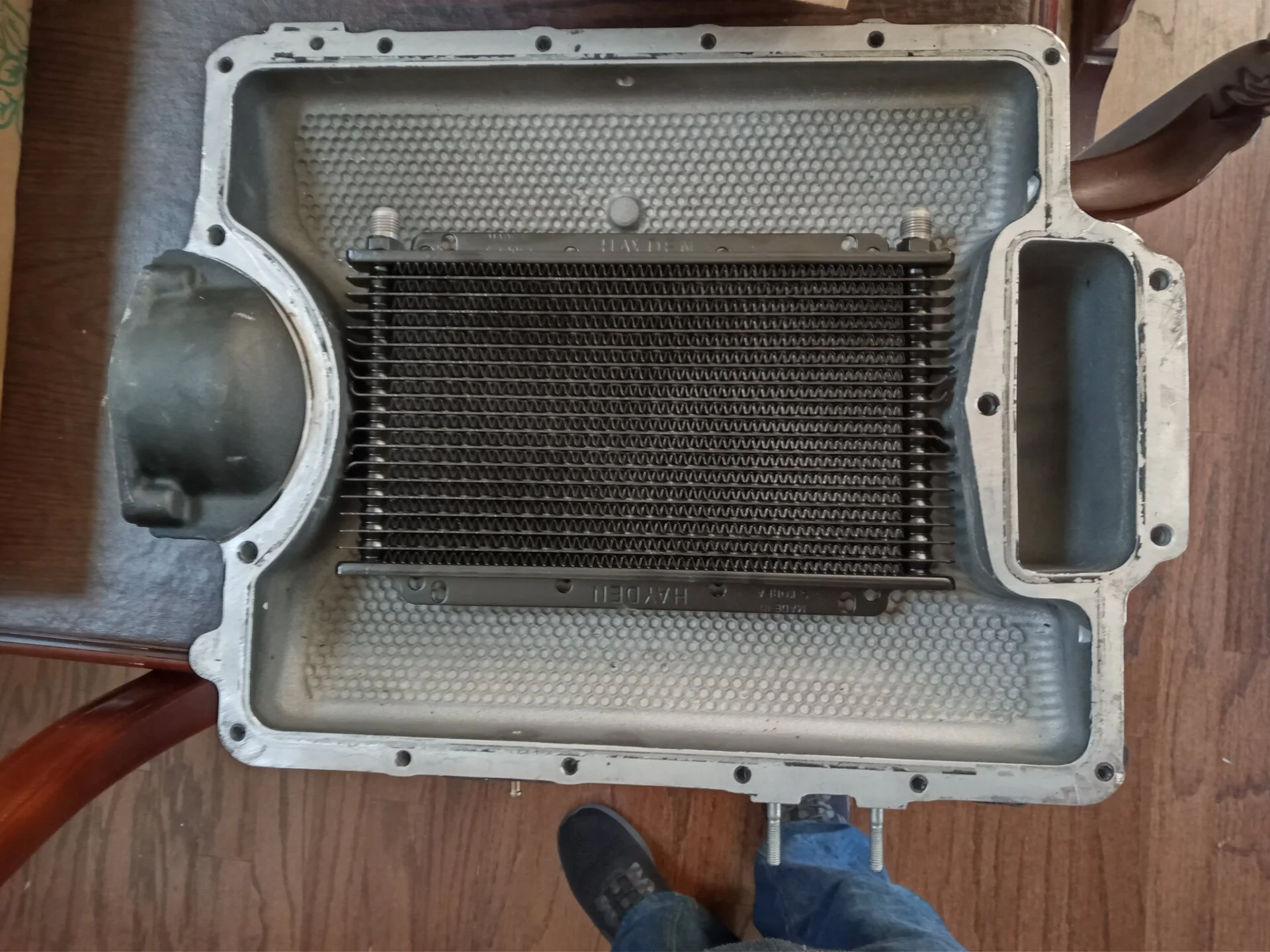

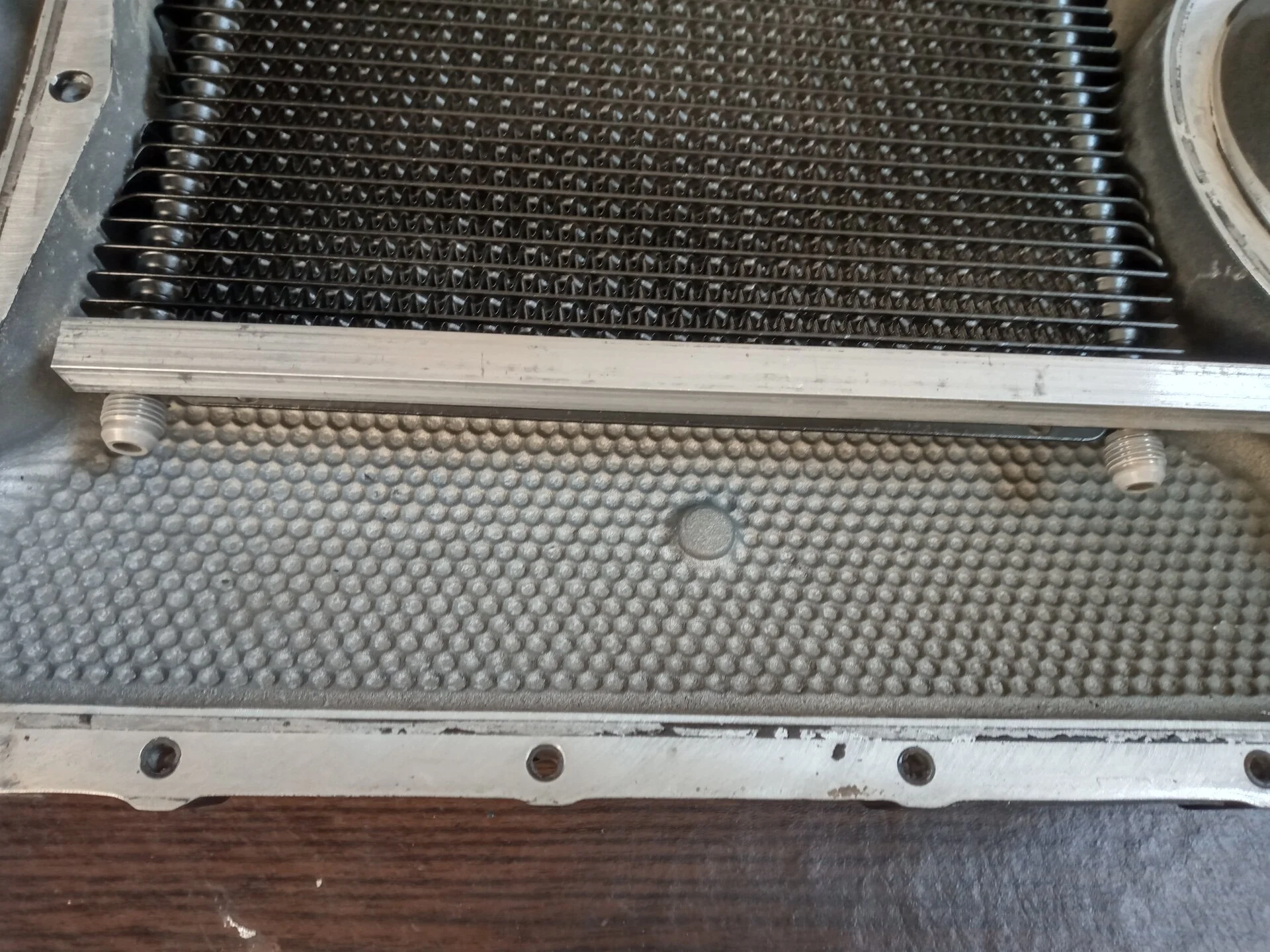

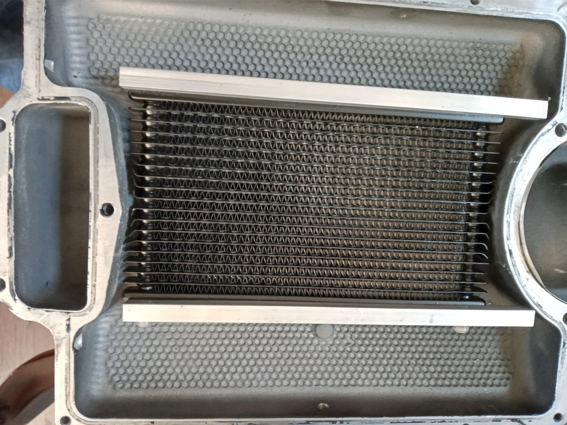

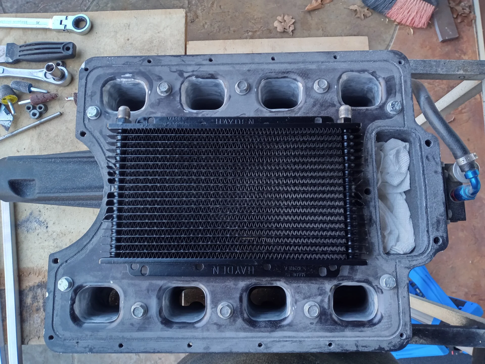

Looks like this one will fit also. Just $56 on amazon. Hayden automotive 687 rapid-cool plate.

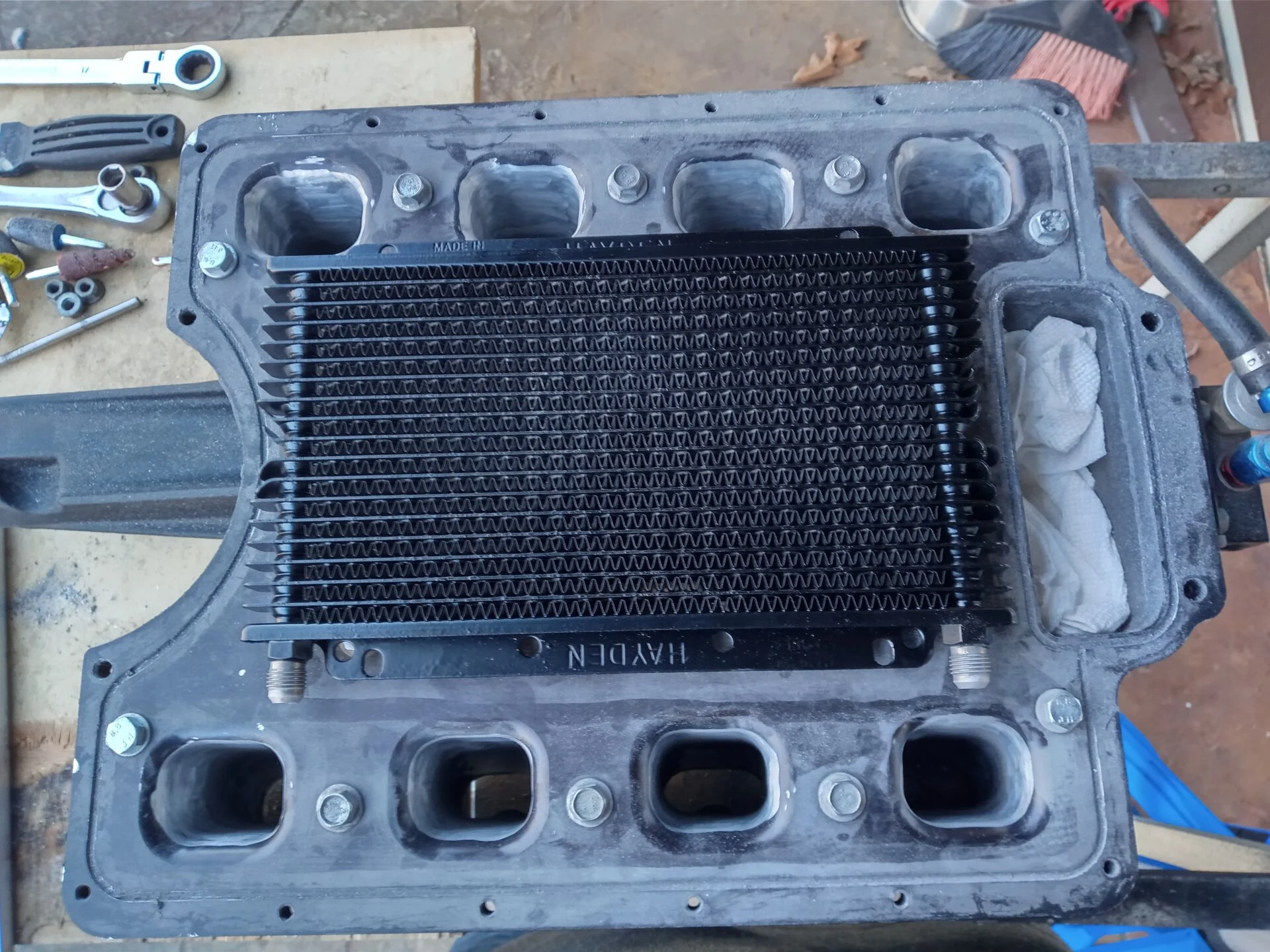

Well I will let J1000 decide if he wants me to get off the thread he started here and start my own. I thought it was good to have comparative supercharging and power ideas under the same thread but I don't want to highjack Jimmy's thread. Here is what I picked up for the front part of the radiator because it is 2 inches thick with lots of cooling capacity $56. It is to thick to go under the hat of the TRD unless I raise the cover higher. I will use this Bosch pump for circulating coolant cost me $38. Will also need a small reservoir tank. I will also make a 1/4 inch frame around the underside of the intercooler under the TRD hat so it allows air to flow thru all the surface area the heat exchanger has to offer.
Some supercharger intercoolers just blow air thru only the center part of their intercoolers as they sit right on top of the exhaust of the blower with little clearance.

From my experience it is easy to build a powerful engine but much more work and science to make them powerful and last. When finished this engine should hold up like the factory ones being blue printed. Short bursts of boost are easier to manage than long periods of boost under constant load (Hauling) due to thermal heat dissipation of what the head design can handle. I will put an inlet air temp. monitor after the intercooler to see how effective it is. The supercharged engines I have built with factory pistons did not hold up over time but the ones I built with forged pistons and ductile iron rings took a hell of a beating and never showed any signs of damage at all. This was even with hauling a boat up long grades where the cast iron head on that engine could not dissipate enough heat fast enough which led to backfires thru the blower. This is when you will be happy you have a smaller belt on the blower to allow it to slip lol! I was running 6 PSI on that engine with boost retard plus knock sensor. At least the 2UZ-fe has aluminum heads and four valves per cylinder to help pull the heat off quicker. I may have to go with the four core all aluminum radiator. I wish I could find some Sodium filled exhaust valves like my Porshe & Audi use that I could fit in the 2UZ-fe. Here are photos of the intercooler with 1/2-inch spacer bars. I will probably settle on 1/4-inch spacer frame although there appears to be clearance for both. If a guy wants to get real creative, you could take a plate of whatever thickness of aluminum you want to lift the TRD hat even higher to allow for a much thicker intercooler. You can see I have been busy port matching the intake runners.
You have to bend the end of the center fins on the intercooler to allow more clearance which doesn't upset anything. If you go with the 14-inch spacers, you need to grind a little off the top of the 6 bolts that hold the M90 blower on. Not a big deal at all as very little needs to be removed. 3/8-inch spacer frame and no worries on grinding.

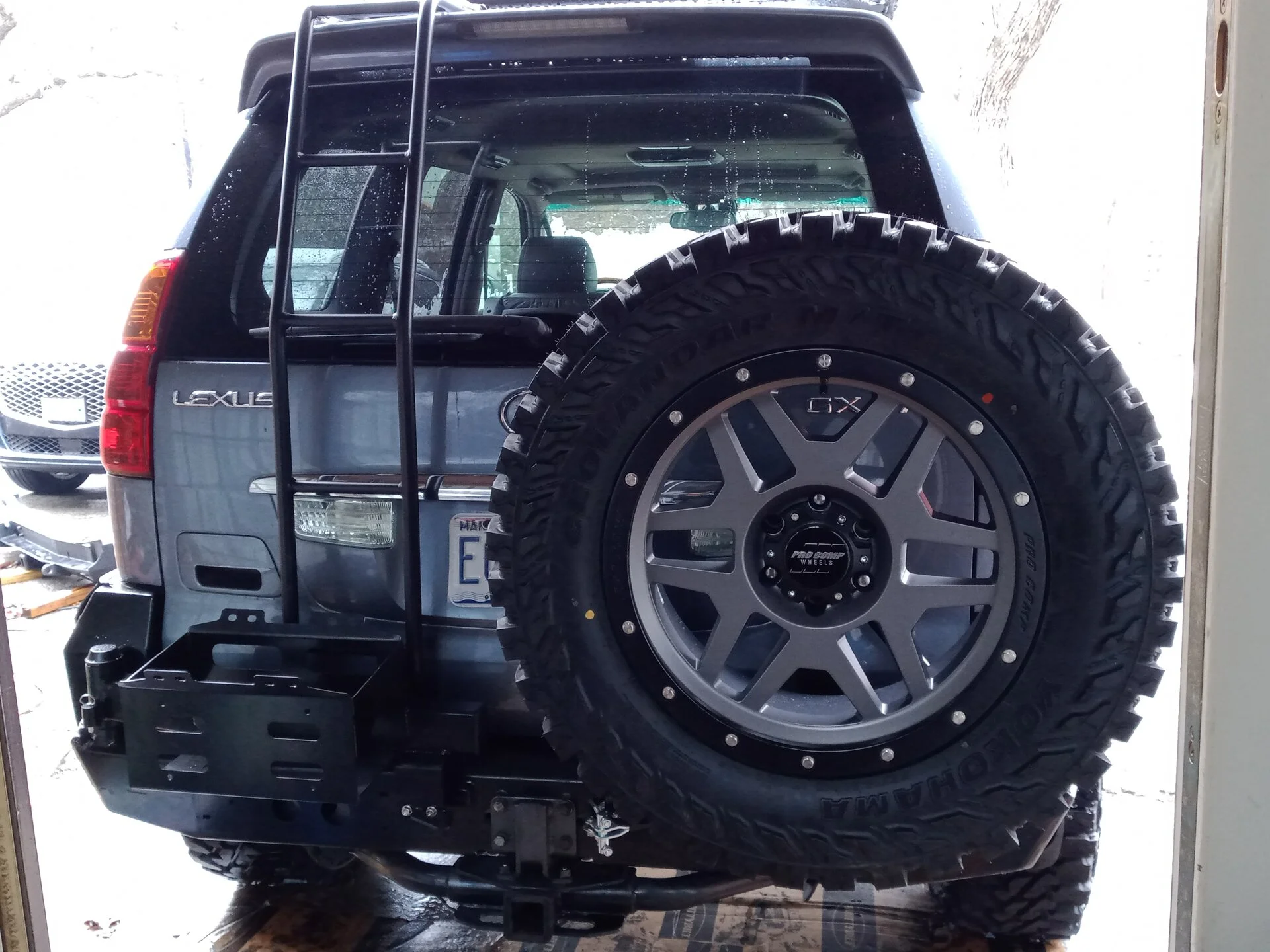

So 0 to 60 under 8 seconds? Looks like 6.5 lbs boost.......J1000 there is a pretty easy fix to get rid of that flashing tire pressure light lol. Got my new back bumper on with factory trailer hitch.
What's the tire pressure fix? Besides installing sensors I mean.
