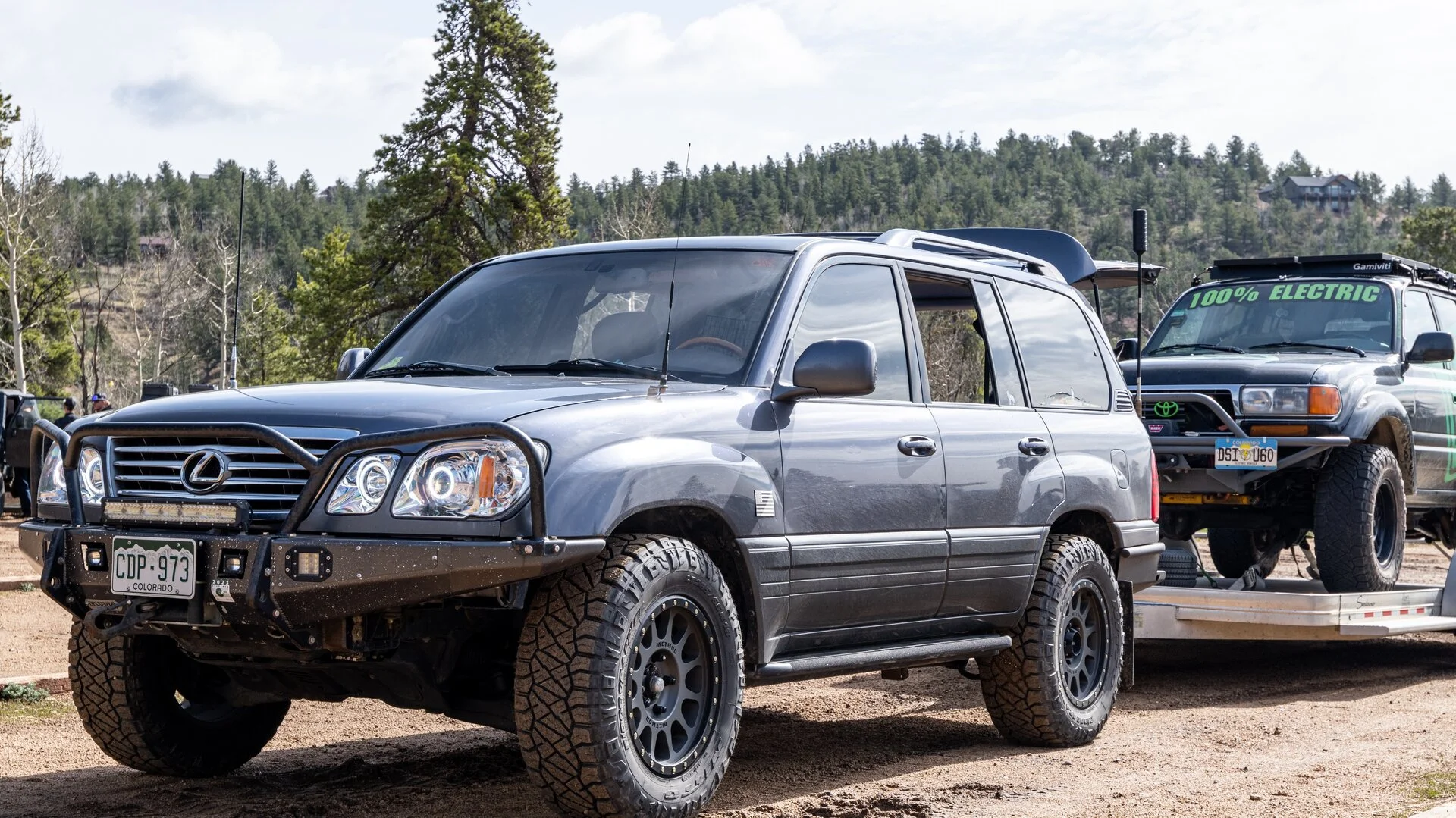

Used my Super Cruiser good and hard this week! Towed my EV80 down to Hurricane, UT for the Offroad Wrecker Games! So frickin cool! Having a blast!
Towed all day at 75 MPH and stopped for gas and snapped this FLIR picture, the blower is barely even warm! It's an efficient unit that's for sure.

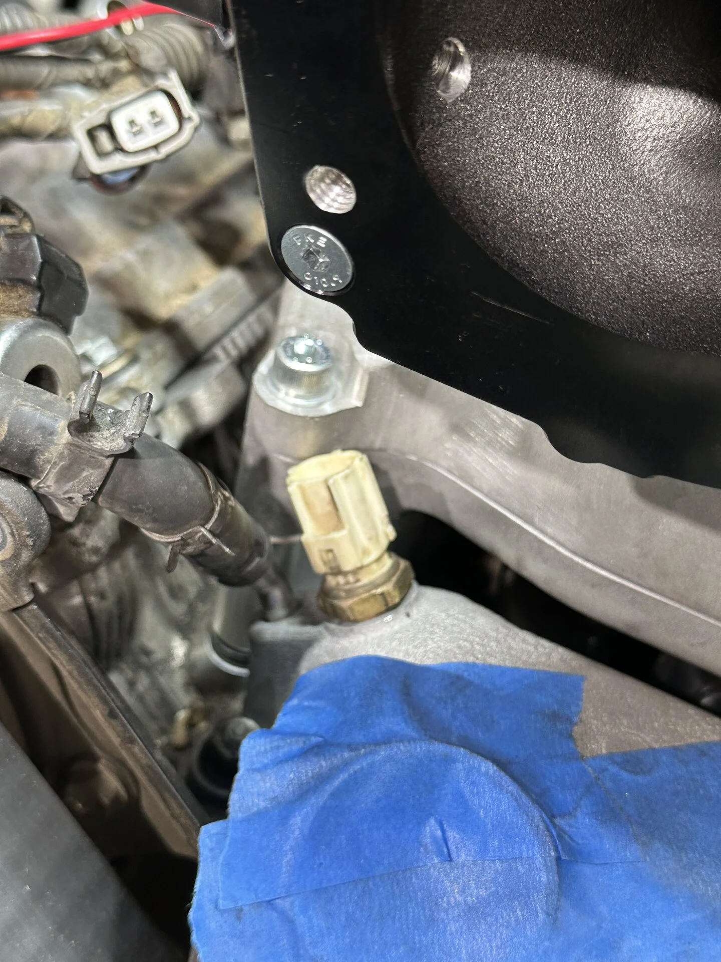

@J1000 Picture request. Hoping to order the same heat exchanger and reservoir from Elate. Mind sharing how you got those mounted? Thanks in advance :)
I mounted the heat exchanger behind the grill. Had to move the horns a little bit. I don't know if it would fit behind an LC grill but it probably will. The reservoir and pump I mounted to the firewall and inner fender area on the passenger side:
