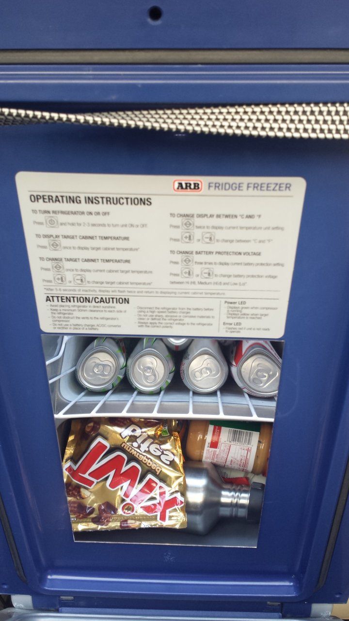

I added a quick mod to my ARB fridge to help make the contents a bit more accessible. My fridge is on a slide on top of my drawers which has the fridge mounted pretty high in the vehicle. It can be a bit difficult to see into the fridge while standing on level ground outside the vehicle. There are pros and cons to this configuration though I usually need to climb onto the tailgate to see and access contents in the fridge. I have also been considering a step stool for use in camp.
I added a flexible adhesive mirror to the underside of the fridge lid to help me see into the fridge from below. Now its a bit easier to reach inside and see what I m getting at while standing outside the vehicle. I did not want to cover the information decal on the fridge lid, but I might adhere a removable mirror to that portion of the lid with some Velcro adhesive. Fortunately these mirrors are not glass so they can be cut down to size However, I did not need to cut this one and it fit well.

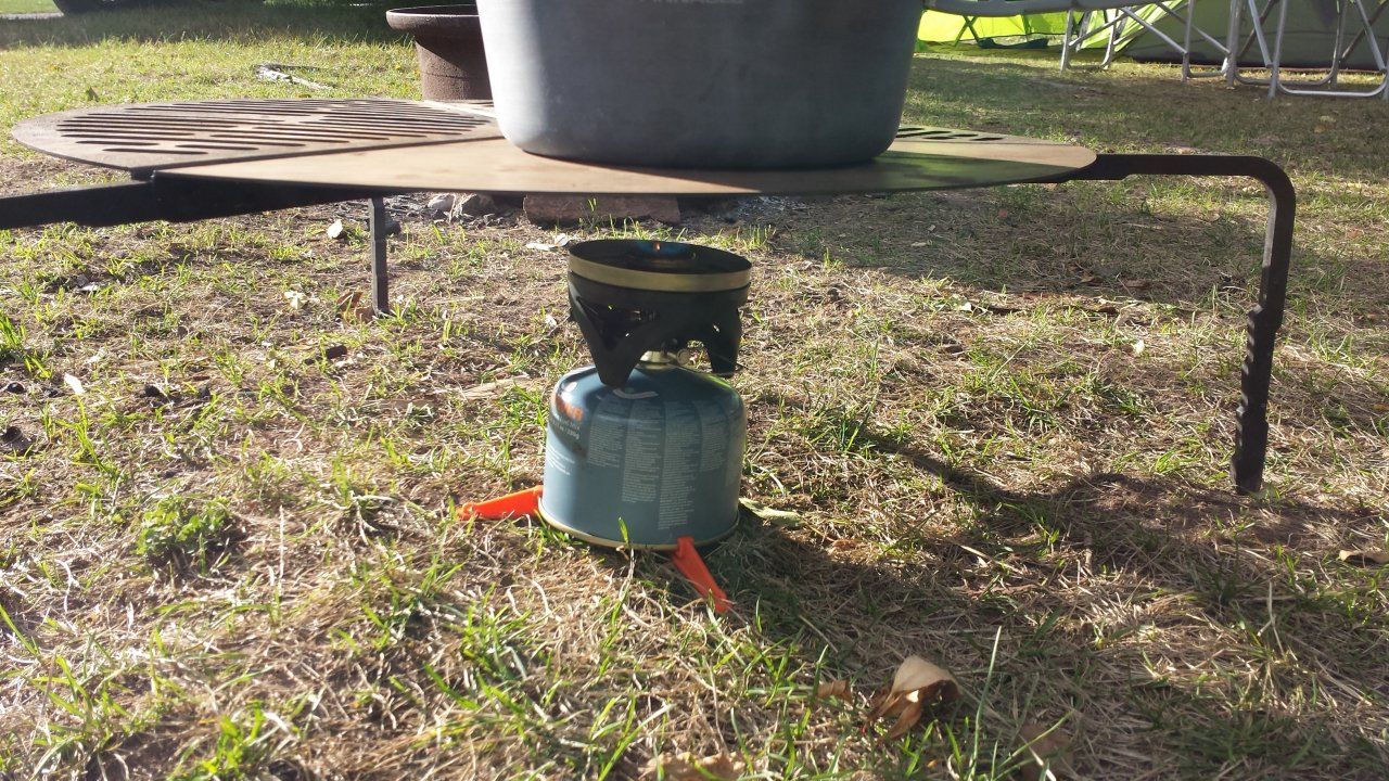

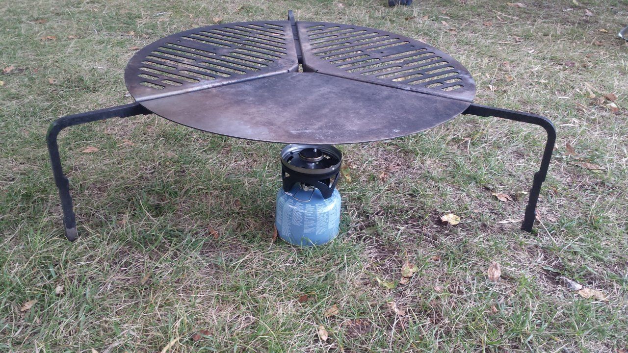

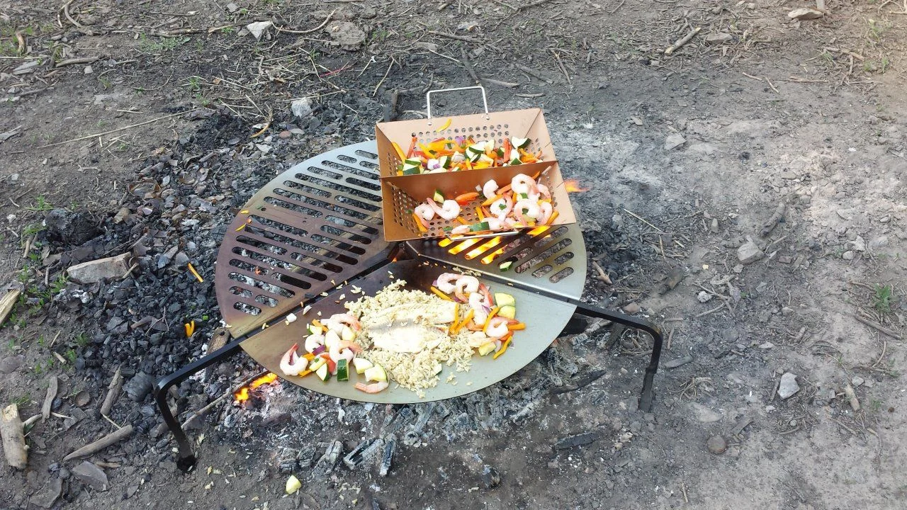

A bit more about the grill...
I like the various options with the cooking surface. I also use a jet boil in my truck often, cause it is a simple, compact, and an efficient way to heat small amounts of water that can be used to prepare a variety of food and drink. Unfortunately the jet boil stove doesn't support a surface for pots and pans that I am aware of. However, the Jet Boil fits nicely under the Brai Grill with a variety of fuel canisters making both items much more versatile.
I can use the jet boil with a solid flat cooking surface, and I don't always need a campfire to use the grill.
I have noticed some distortion in the surface of the Grill over heat, but it seems to cool right back into its original shape.
