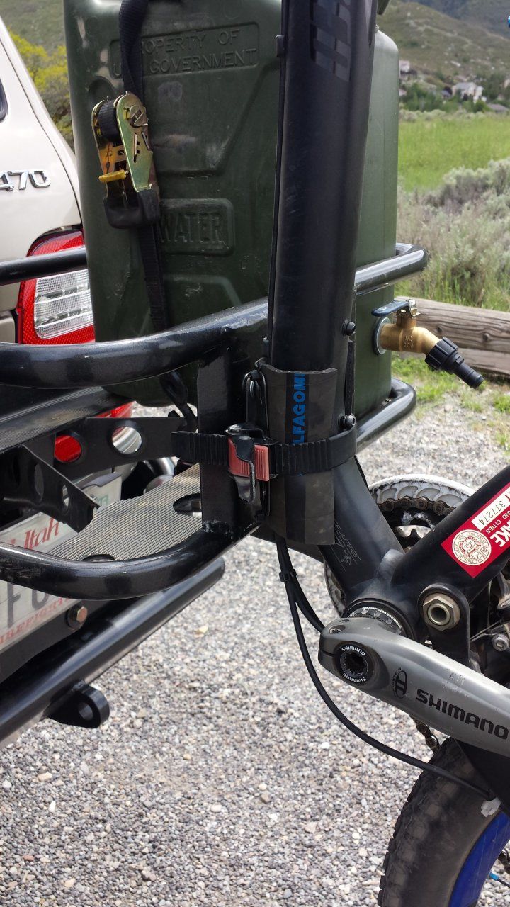

Rear swing bike mount
As a bit more final progress on the rear bumper is done, I have mounted my bike on the rear swing and it fits securely. After driving on a variety of road surfaces, I am rather confident that it will continue to serve its purpose. I can easily swing the bike out of the way to access the back of my vehicle and it is easier to position that lifting it onto the roof rack. For reference, the rear tire sits about 18" off the ground.

Nice bike integration! Would you happen to have a profile picture of the truck with the bike on the back to show how far it sits from the vehicle? I'm trying to imagine a Stumpjumper FSR in profile...
Thanks. I didn't take that picture, but I will next time I get a chance.
For reference, the inside of the frame mount is 19.5 " from the bottom rear portion of the rear hatch lid(closed position). This is a Specialized Stumpjumper Expert Evo.
But you could measure from the bottom of the frame to the seat (and add 19.5 to that) if you have a specific bike in mind.
