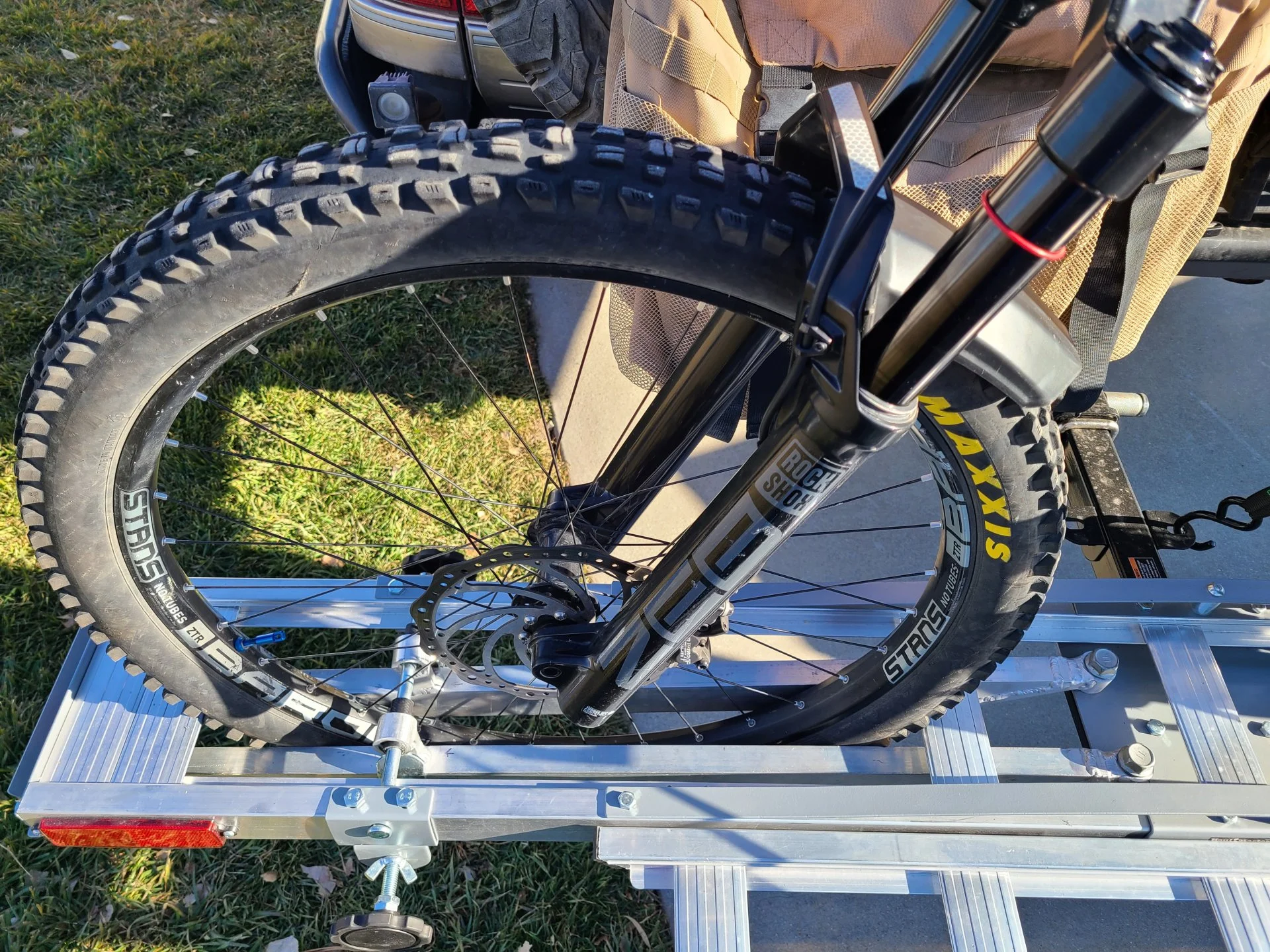

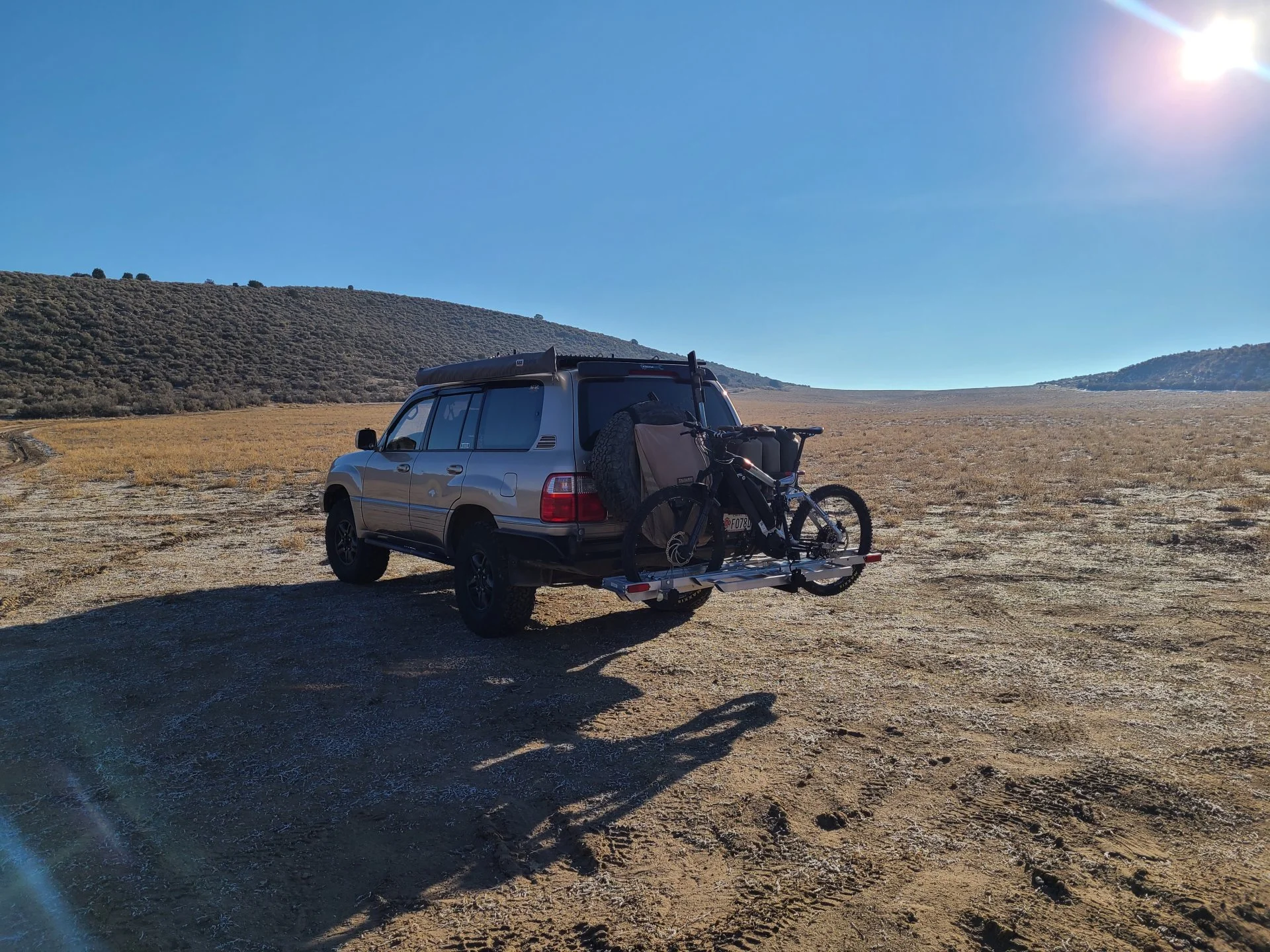

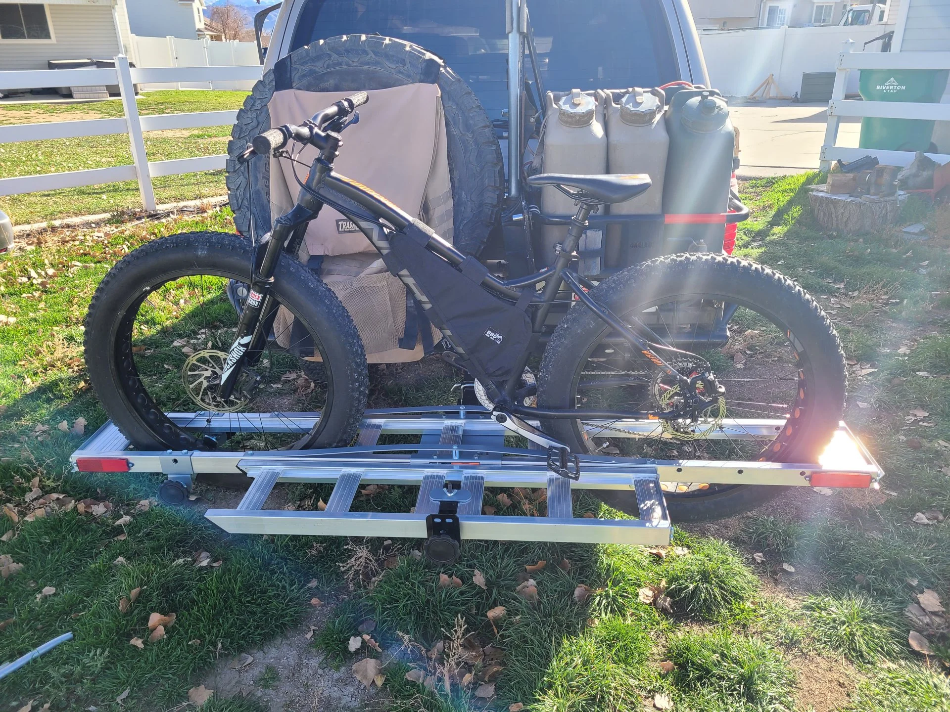

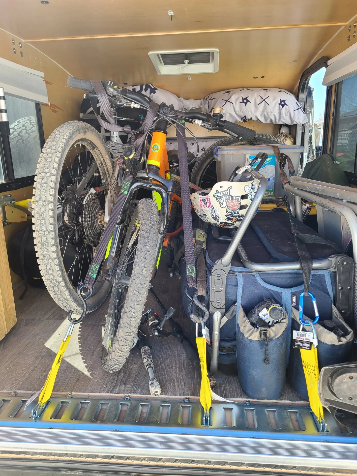

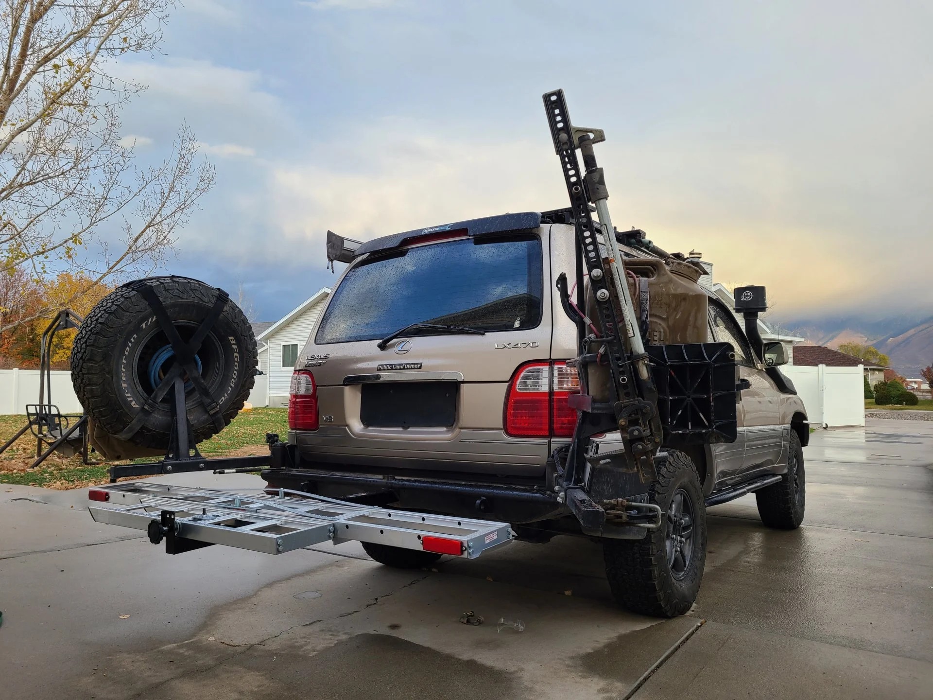

I haven't really been wheeling this rig much as I've been riding my bikes a lot more lately instead. Legusy has still been getting some use hauling the bike around. I still wanted a rack option instead of the trailer so I modified one that works. I realize that the hitch is the most accessible and convenient, and I still wanted to be able to open the swing outs. I conceded that I would have to at least have the bike off the rack to open the swings, but I don't want to have to remove the rack too. The hitch in my bumper is mounted pretty high so there isn't a lot of space to clear the swings. I already have to use a hitch extender to gain the distance so the bike would clear the tire. I wanted something that was easily rated for the weight of a heavy EMTB. I also wanted the rack to fit my fat bike which is quite a bit larger especially with the snow tires on.
I decided to go with an aluminum motorcycle carrier that is rated to 400lb. It also gives me the option to bring a dirt bike or Sur Ron etc. I installed the hitch extension with a silencer clamp and a couple of bolts threaded into the bottom of the receiver tube to take up all of the slack so the receiver and rack is solid. I drilled a couple of rivets out so I could move the cross plates to accommodate different sized tires and the fat bike was good to go. Then I welded up a couple of rectangle tubes to allow the thinner 2.5-3.0 tires of the EMTBs to fit tight. With a strap in the center its been good to go. This has been working well and with the bike off, the swing just barely clears the rack.

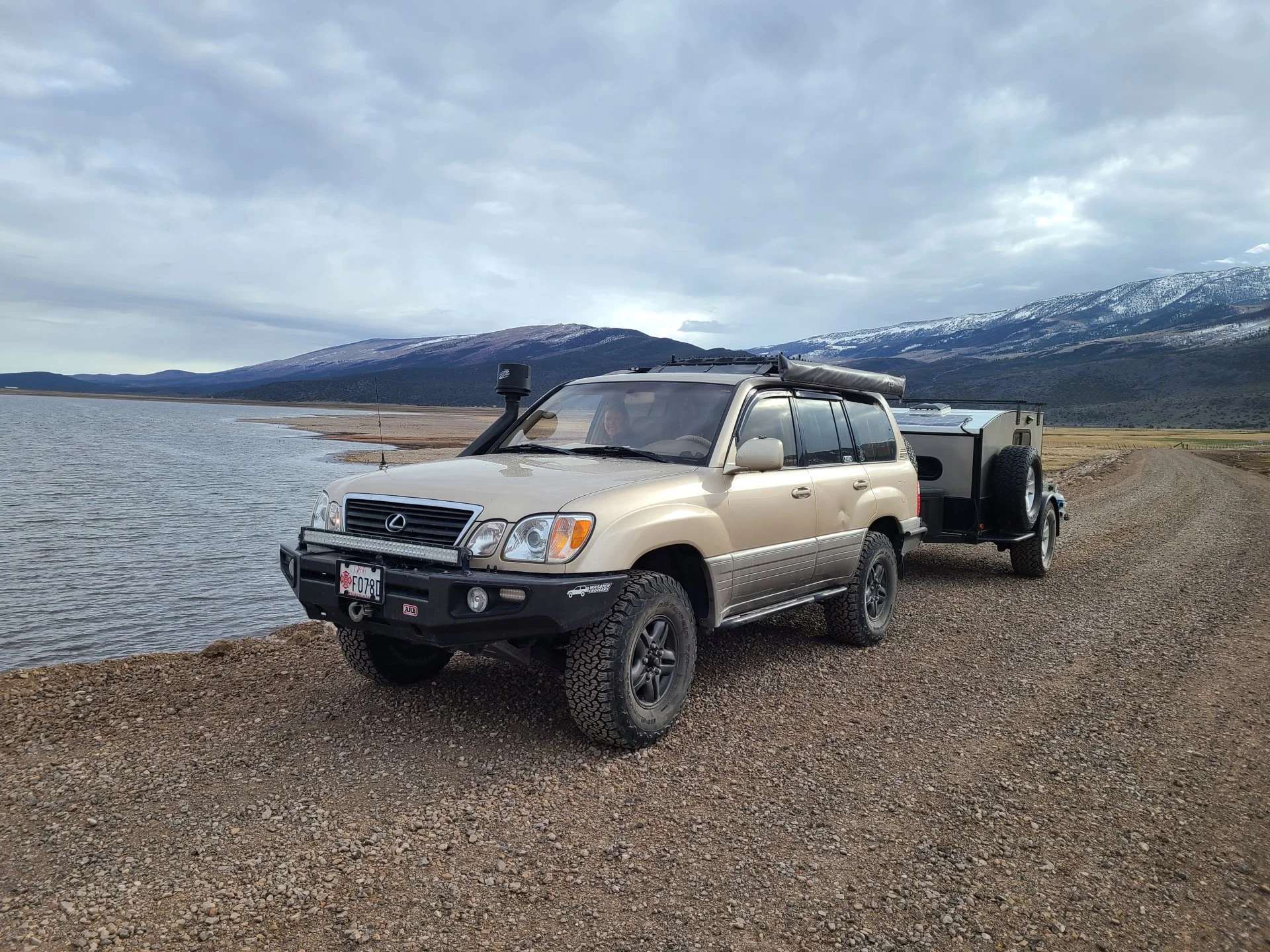

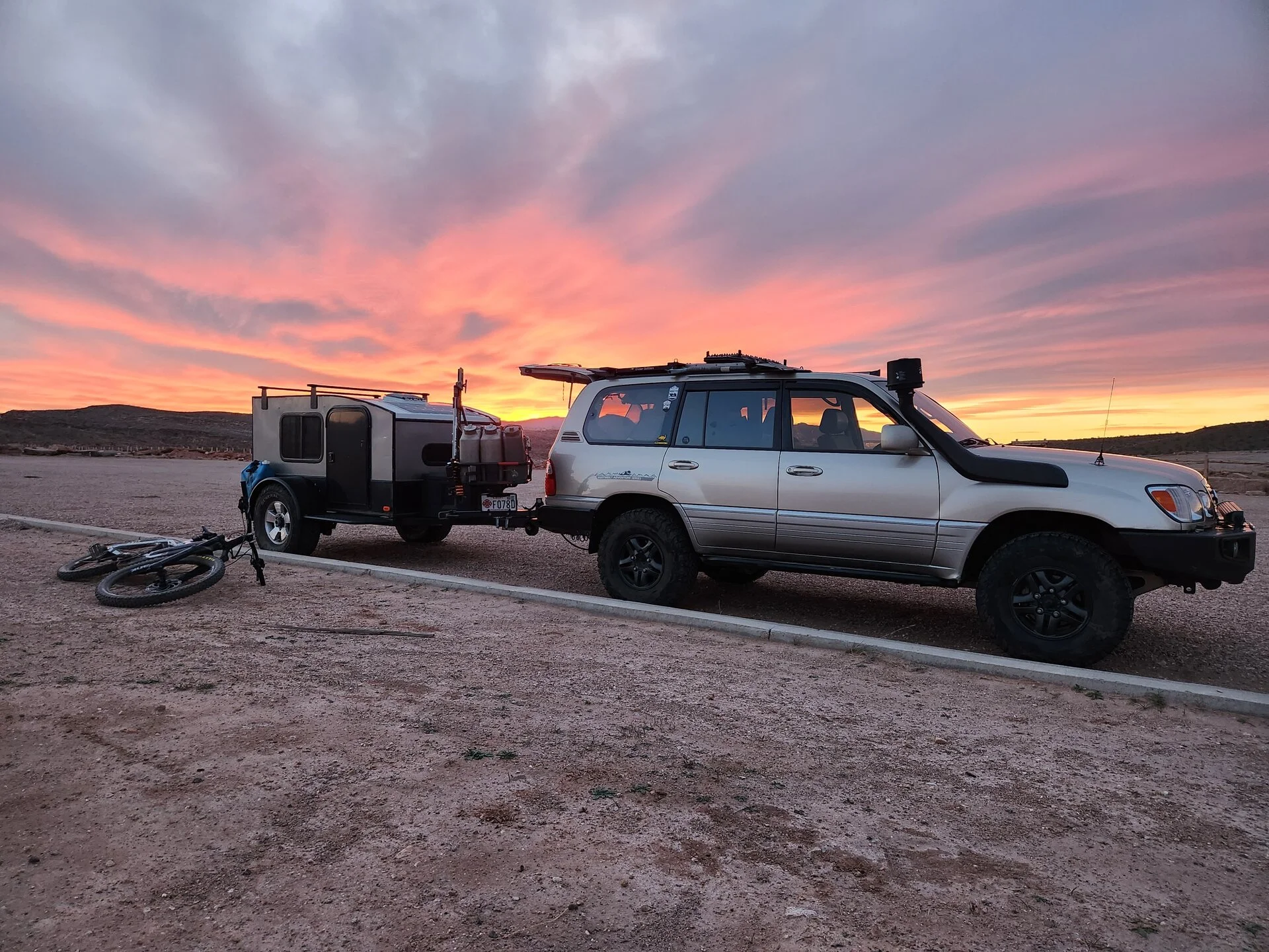

Legusy did make it out to the museum for Cruisers and Coffee as well as several other excursions lately. It was great to see the fellows there. Just after that, we went and picked up another accessory. to improve the capacity and comfort for various trips.

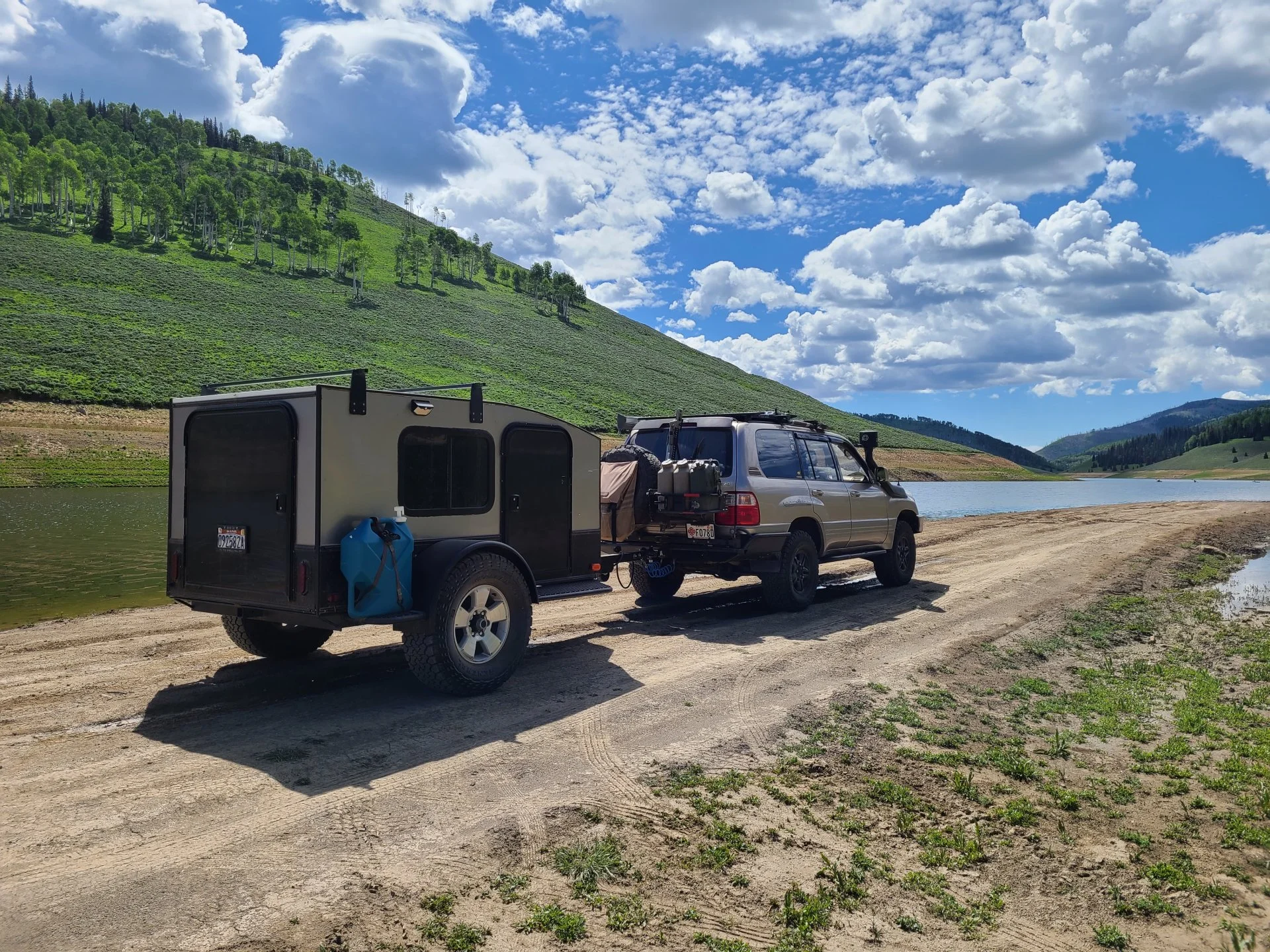

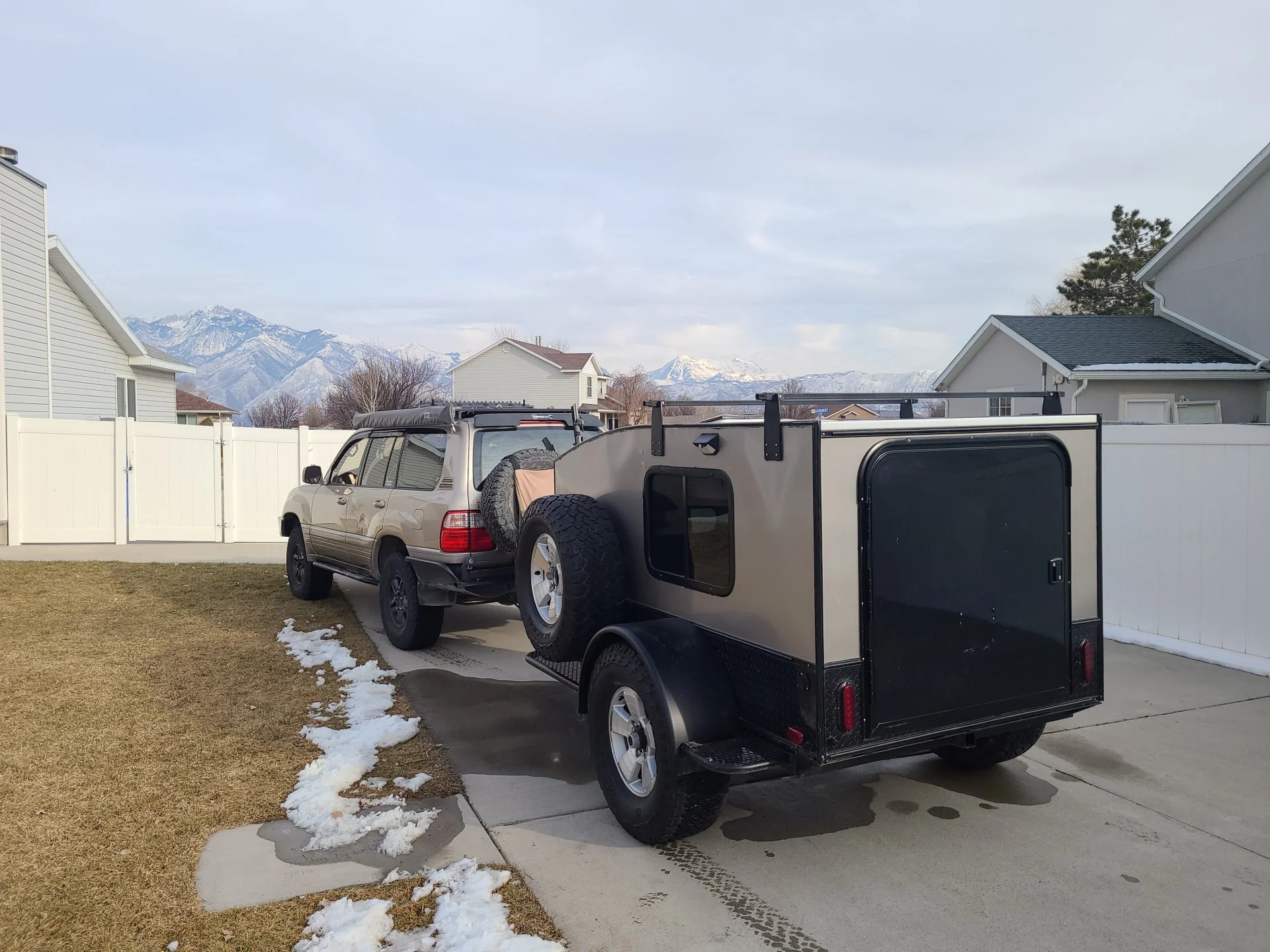

A custom offroad trailer has been in the works for some time now and it is a capable complement. It is based on a heavy duty custom chassis with a modified Hiker Trailer shell that does not have the rear wall for a separate dinette area. I specifically wanted it setup like this because it would allow more space for cargo including bikes and a larger sleeping area. I already have the fridge in the truck so a kitchen in the back of the trailer ( like most teardrops offer) seemed redundant.
There have been several mods to make this fit just right for this vehicle and the first was to chop the tongue and raise and lengthen it to make it straight in line with the hitch receiver, for the most clearance possible and to allow plenty of room for both bumper swings and not jackknife. An updated 7 pin harness also got installed with a max coupler to link them together. I added trailer brakes to the 6000lb rated Timbren suspension. New dual batteries were installed to work properly with the solar, inverter, and shore power charging. Since I figured Rough roads would be hard on shifting contents, I installed E-Track with the vinyl flooring and on the side walls for use with a removable table inside. I used a forklift fuel tank kit to mount a 5 gal propane tank to a custom support. I'm sure that there's more, but you get the idea.
Overall range is a bit compromised towing this addition, but it pulls very well and handles all sorts of terrain. To offset the slight loss of already poor fuel economy, it is nice to be able to unload the bikes and cover many more miles. It has been tested and put through the paces on a variety of windy washboard and tight roads while holding up well. The wife and family have given their approval to its amenities as well.
We took these out on a longer trip in Southern Utah really put it to use. The long washboarded road out to hole in the rock was rough, but things held up. After diving through Capitol reef and exploring several canyons, we were able to get way out on Lake Powell with the water level so low. I think it would have been hell on a standard bike rack, but in the trailer things survived and we were able to escape the wind for the night inside the trailer.
We look forward to many more opportunities to explore in it.

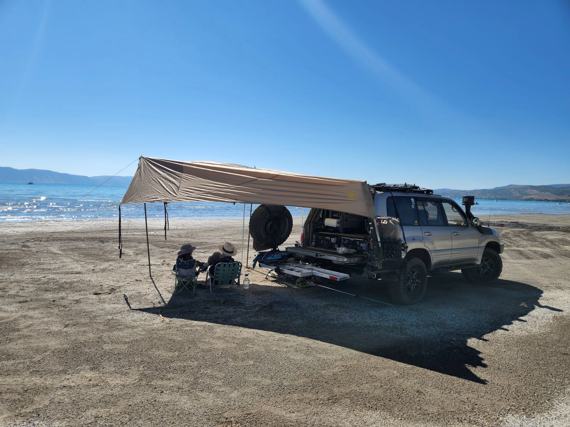

We have been getting out in the 100 a few times in recent past to explore outdoors. It really hasn't been getting as much use as other vehicles lately but it is nice to get out with it. The trailer has been very comfortable and convenient and a great way to haul bikes too.
We made it out to property that has been in my wife's family for nearly a century and with the low lake levels were able to drive this trail out to the beach loaded with accessories.

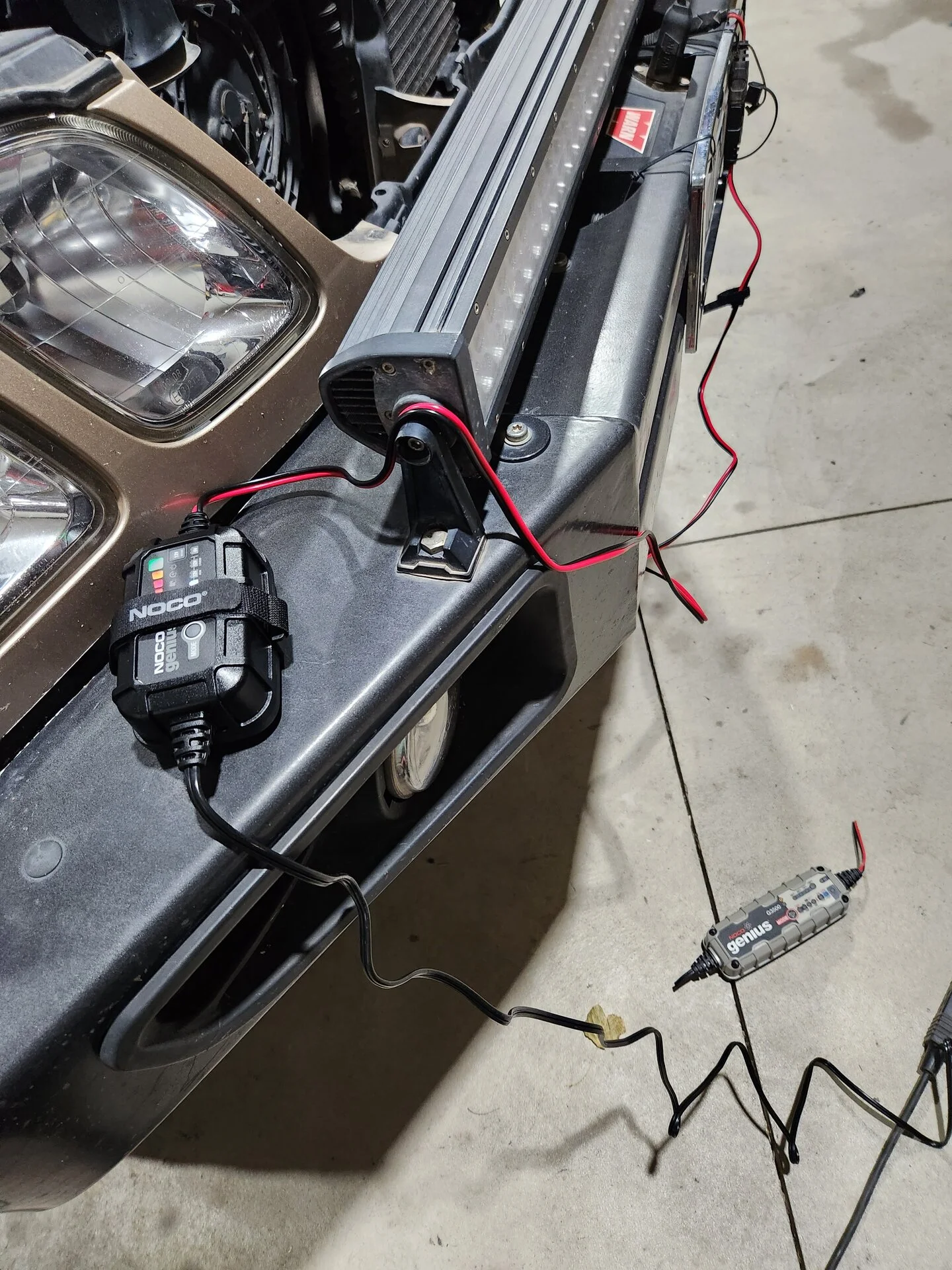

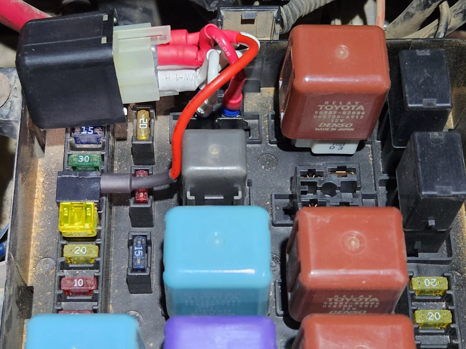

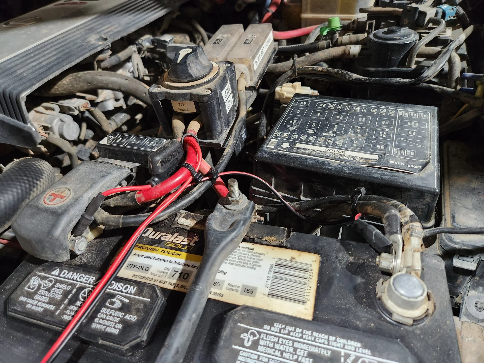

Its past time to get up to speed on this thread. As we were out visiting the Lake, and getting ready to take off and explore some more, I came across a crank no start issue with this rig. I realized right away that I did not have a check engine light on. I did some trouble shooting and found power to all the usual places. So I got out the wiring diagram and dug a little deeper and found that though I had power to the EFI main relay, it was about .5v low. I was able to jump battery power to the relay and the truck would start right up. I had a connector for a trickle charger on the truck and I was able to repurpose that as a temporary jumper wire that got me back on the road and all the way home. I think that there is a bad connection in the fuse block somewhere. This is a well known issue on some 100s and there are numerous threads on it. I think that there is an issue with the cost and availability of replacement parts. There is a pretty well known repair of rewiring the EFI relay in the fuse box. I bought another factory relay just to make sure, even though the old one tested well, and now I have a spare. I've seen a kit for sale here on mud to do this, but it was easy enough to make my own. I installed an add a circuit fuse to the 20A EFI to supply the main relay and it all fits under the factory fuse box lid. Since it has taken me so long to update this thread, I can report that this repair has seen many miles on and off road with out anymore of this issue.
I upgraded the trickle charger to a newer more powerful unit. I had been having issues with the old charger randomly going into a fault. I usually only need the trickle charger when I keep the truck parked in the garage with the fridge on for several days. Now, the new unit seems to keep things charged.

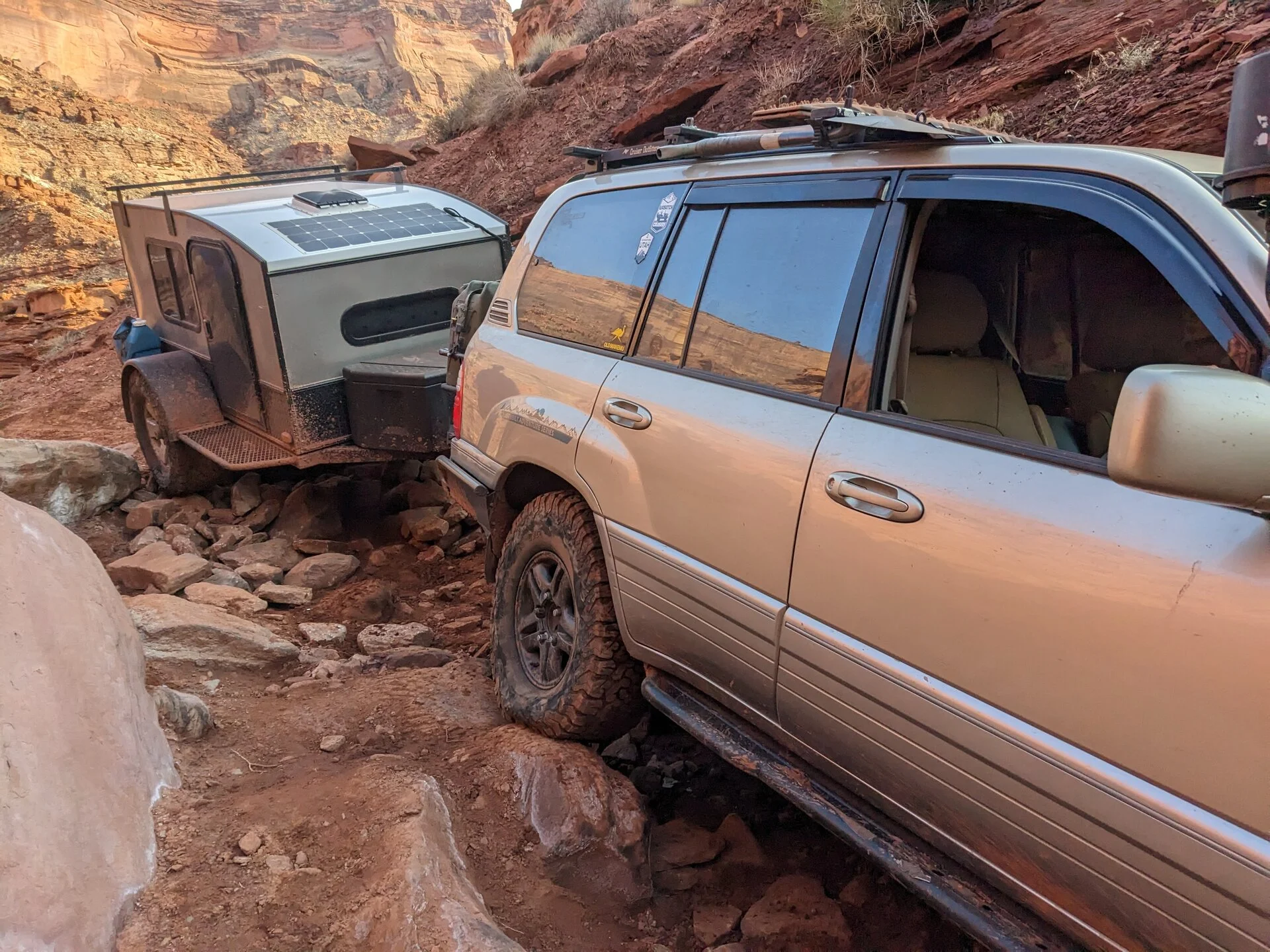

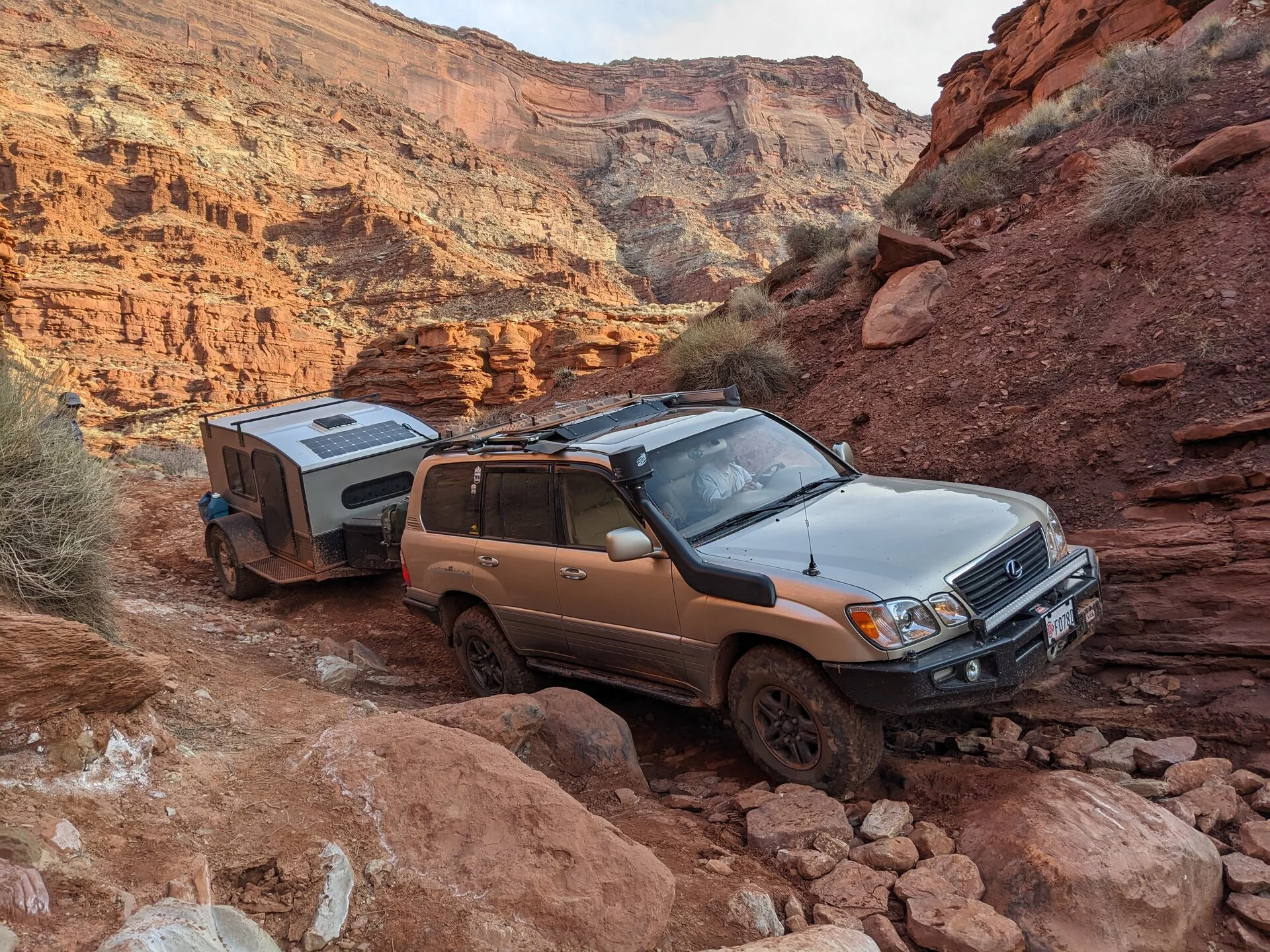

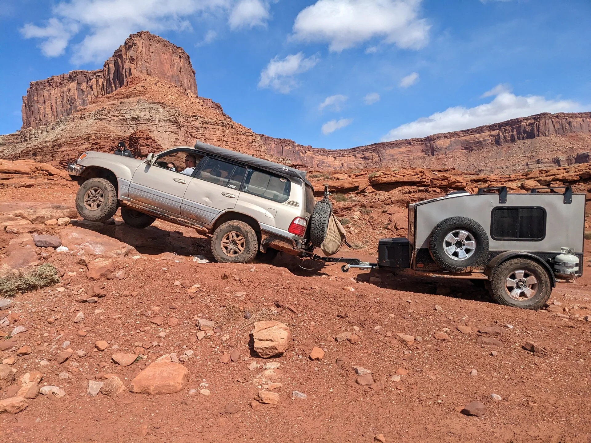

We drove the Lockhart basin trail with the club Wasatch Cruisers as a prerun for Cruise Moab. Since we drove the trail from South to North going downhill the toughest section, I brought my trail trailer. This made it much easier to accommodate my family in the colder weather and I was able to bring my E mountain bike. It was a bit more challenging getting the trailer through a few sections. It was a good test for the capability of the trailer, and a good opportunity to improve my trailer dragging skills. With some careful spotting and driving we were able to negotiate the difficult sections and get through.

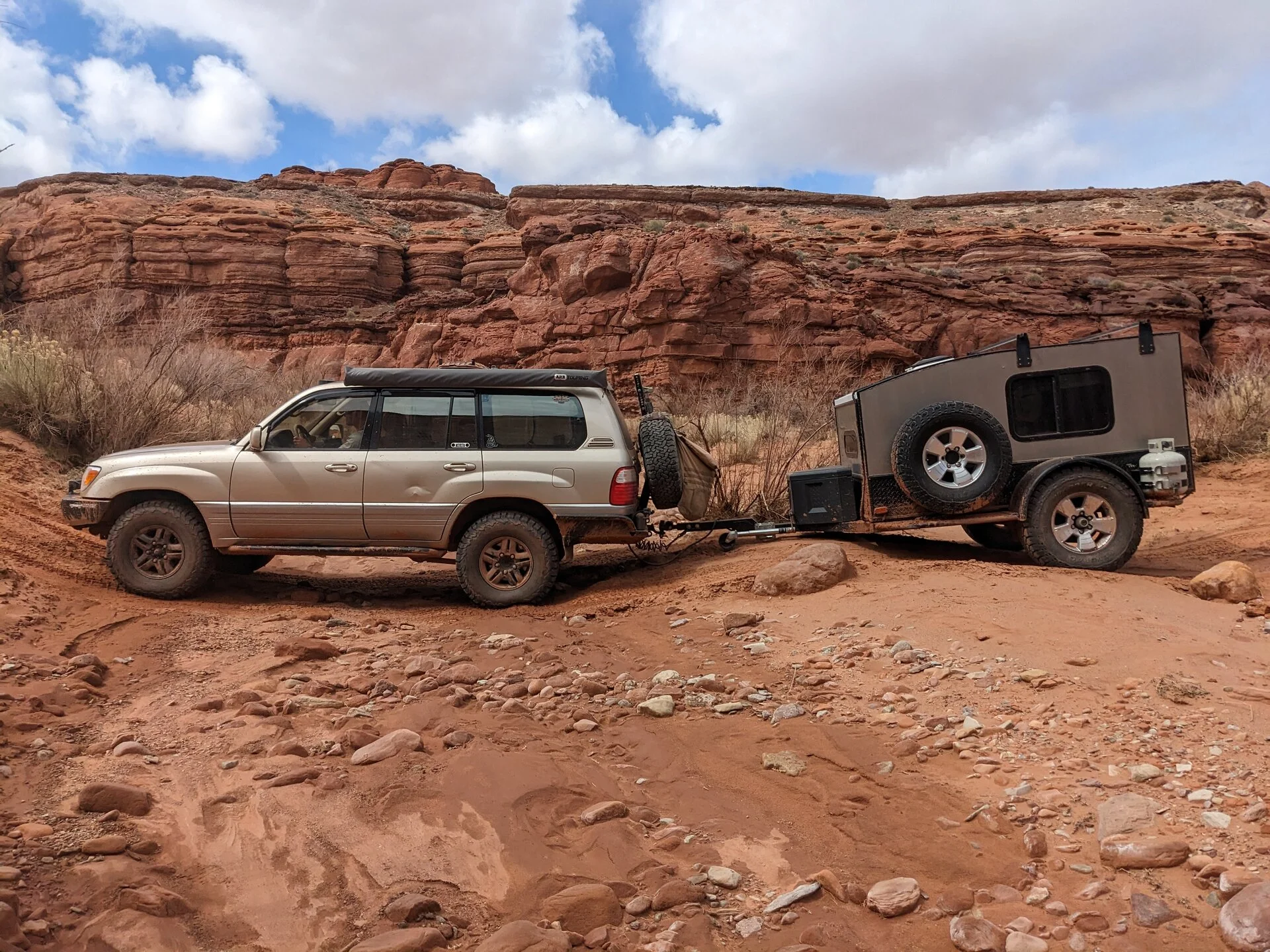

Here are a couple pictures that show how the extended and raised tongue of the trailer clearance worked out to be just enough on approach and departure.
As we dropped down into the narrow canyon things got a little tight, but the trailer hung in there. Near the end, I had to make a pretty tight turn, but I was able to pull right through it. Its nice to know that this trailer will turn as tight as the truck, and I can even back into it a bit to make a sharper turn, so its been pretty maneuverable.

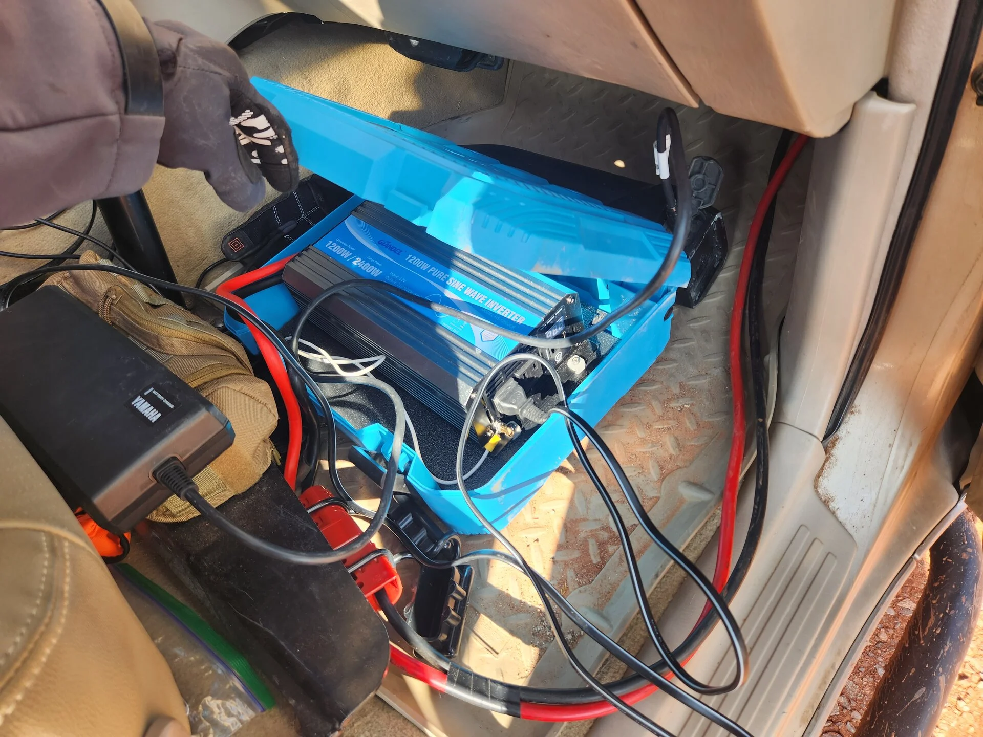

I did this by running some heavy gauge wire directly from a 200A fuse at the auxiliary battery to the cab near the passenger foot well. This is terminated at a heavy duty 2 pin quick connector commonly used for winches and such. It tucks out of the way when not in use. I placed a 1200W pure sine inverter in a plastic case and set it on the floor and connect it when charging the batteries.

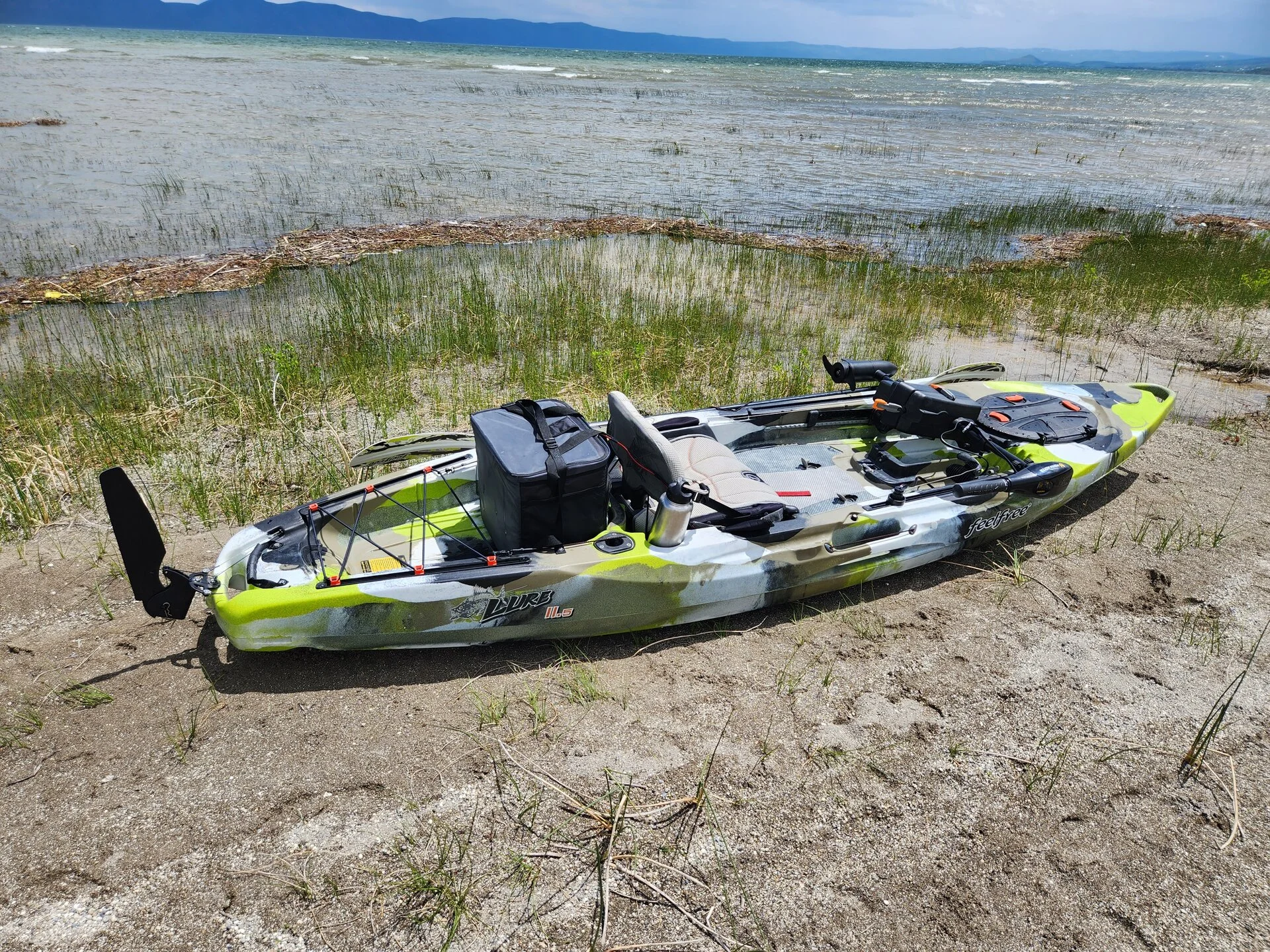

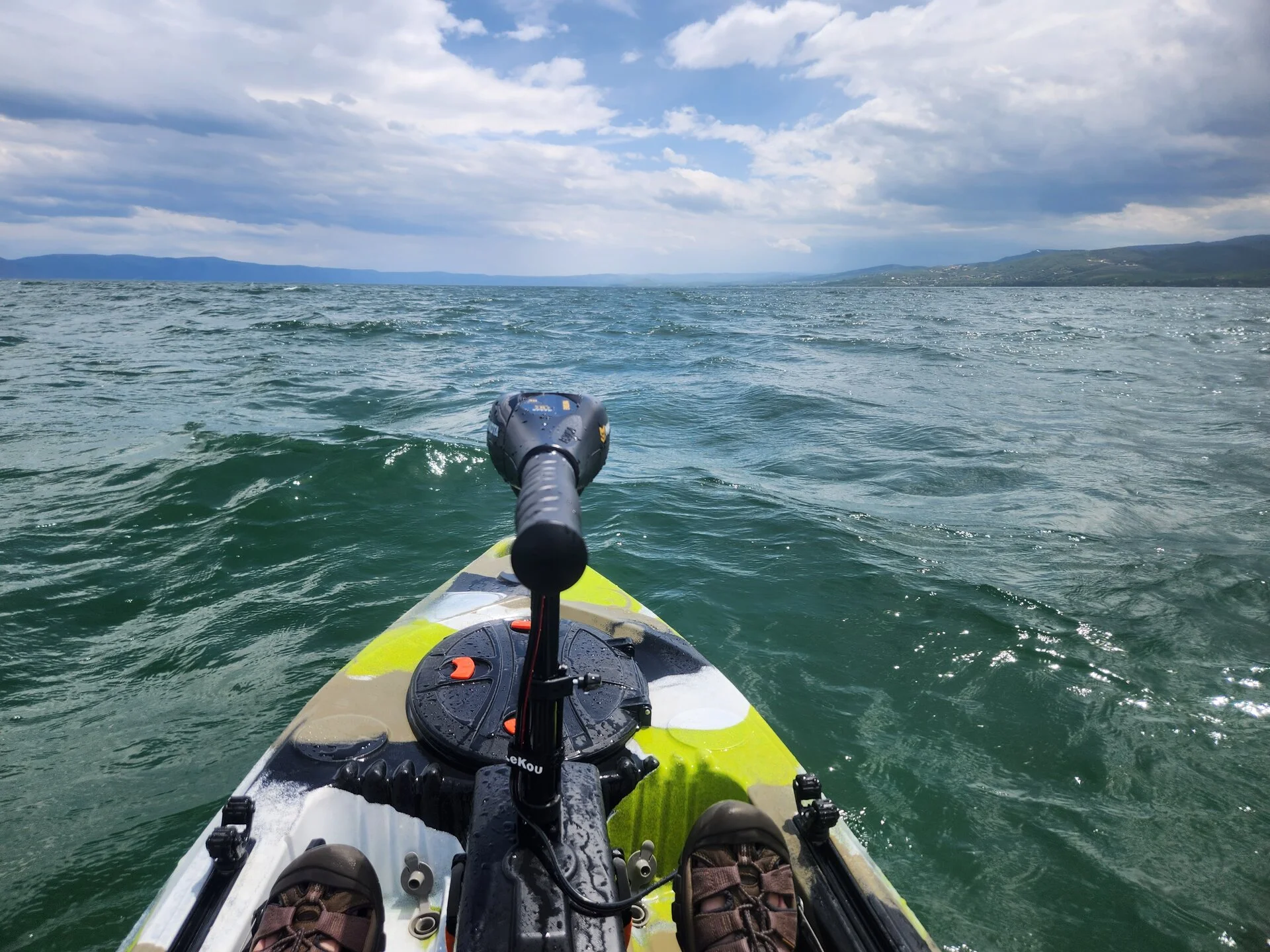

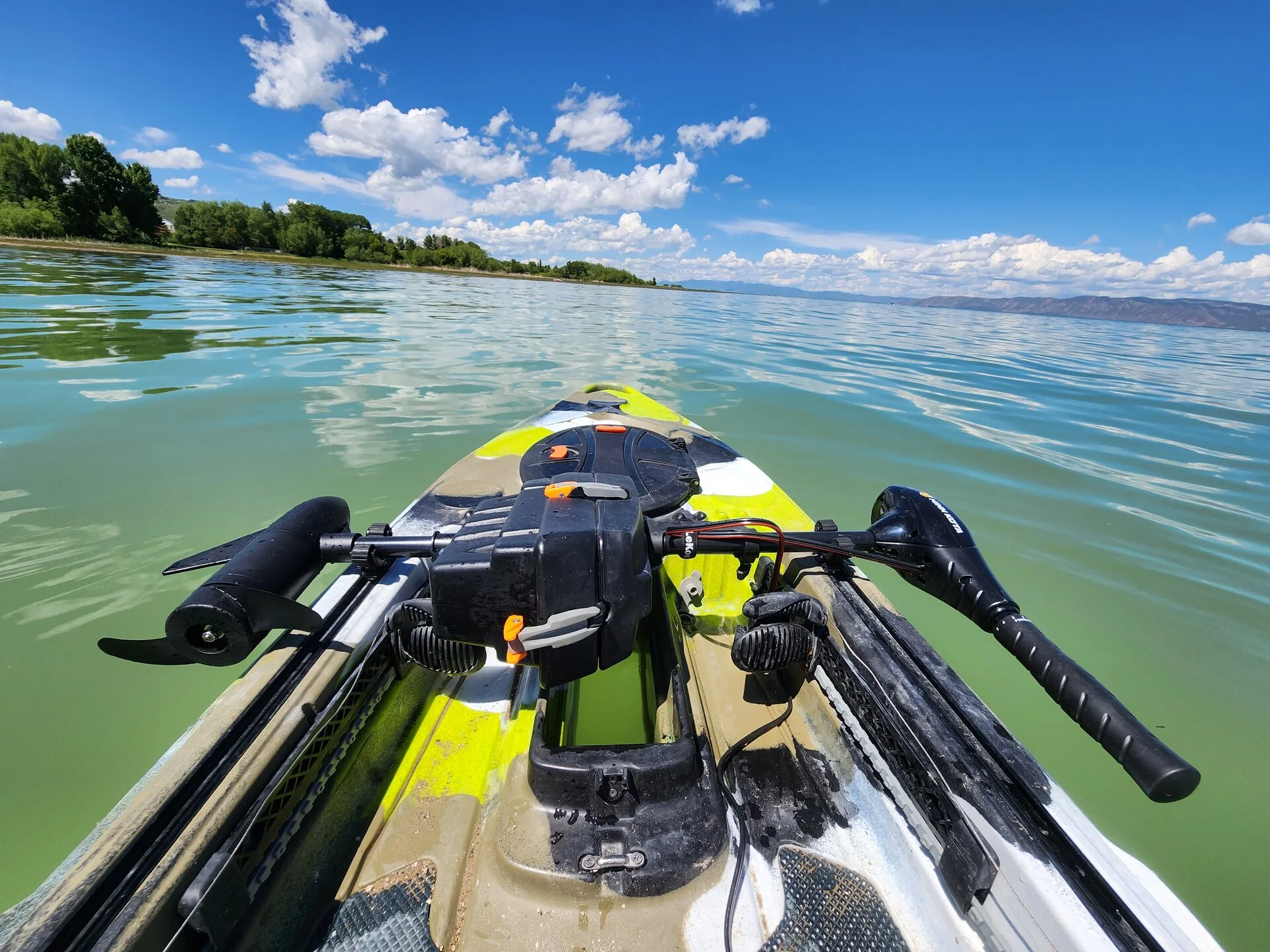

Since I have been really enjoying getting around on ebikes these days to further explore and extend the range of recreation, I decided that an Ekayak build would be a cool idea. I found a good deal on a used Feel Free Lure 11.5 kayak. These kayaks have a removable sonar pod in the center for optional install of a pedal drive, motorized unit, or fish finder etc. As a much cheaper and functional option, I decided to install a trolling motor in the sonar pod. This would allow complete removal of the motor and no permanent modification to the kayak itself. I used a 100ah 12v lithium battery installed in a cooler bag that weighs significantly less than a lead acid battery and will probably run the kayak for 8 hours or more. With the kayak loaded on the trailer, we were ready to explore land and water.
