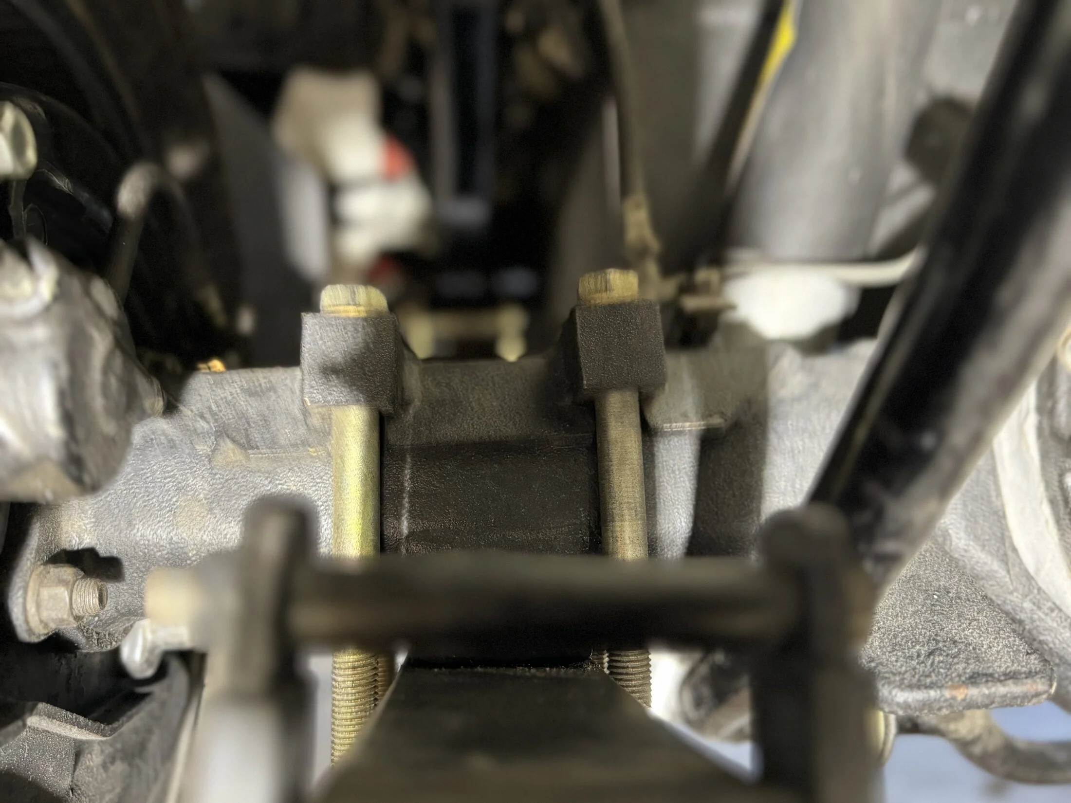

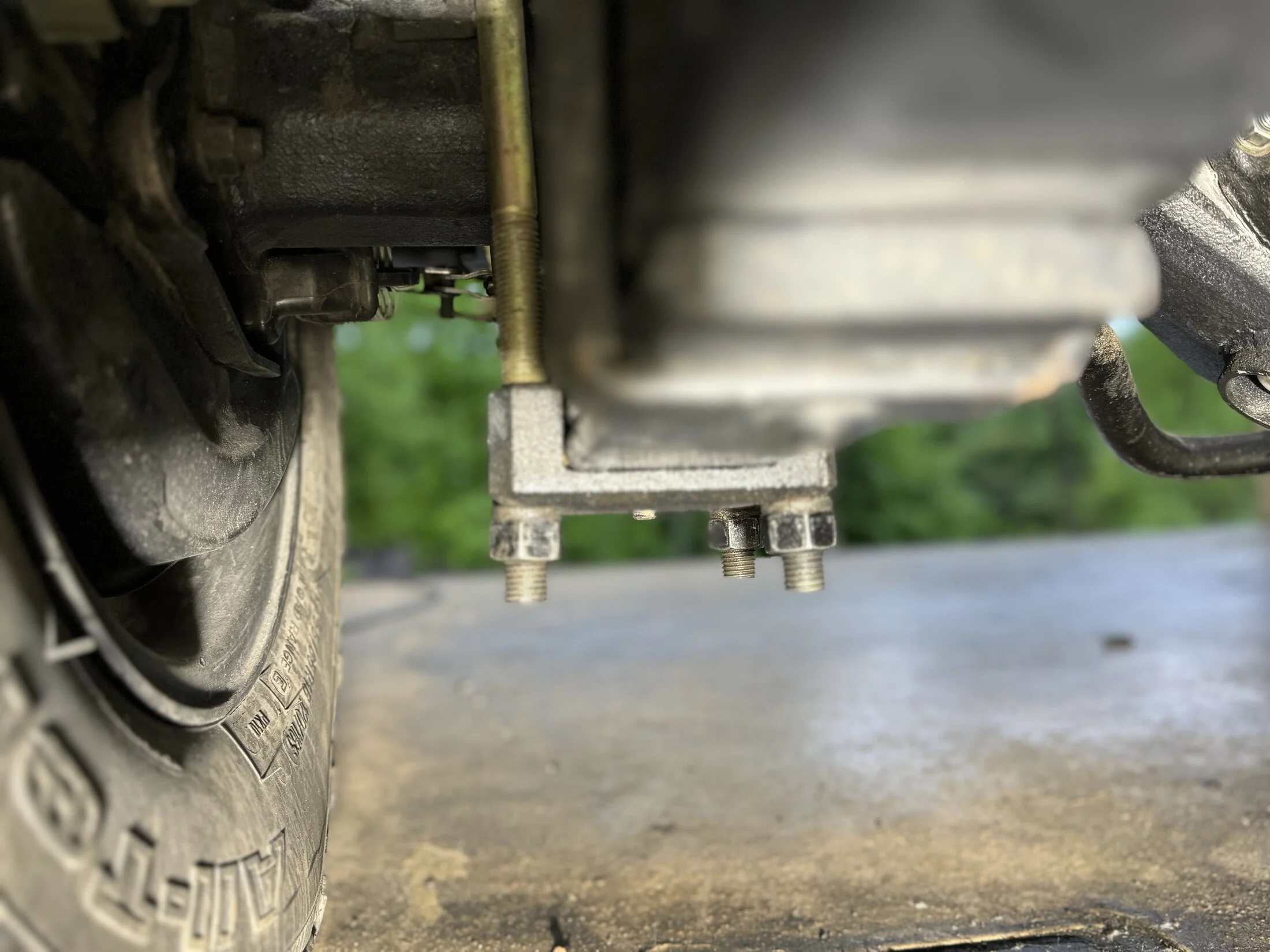

Now the diff housing and leaf spring need to to be torque as well but these are not your regular U bolts they a straight M16 x 2.0 length 11 inch or 280MM I did cut them and taped to make sure of clearance

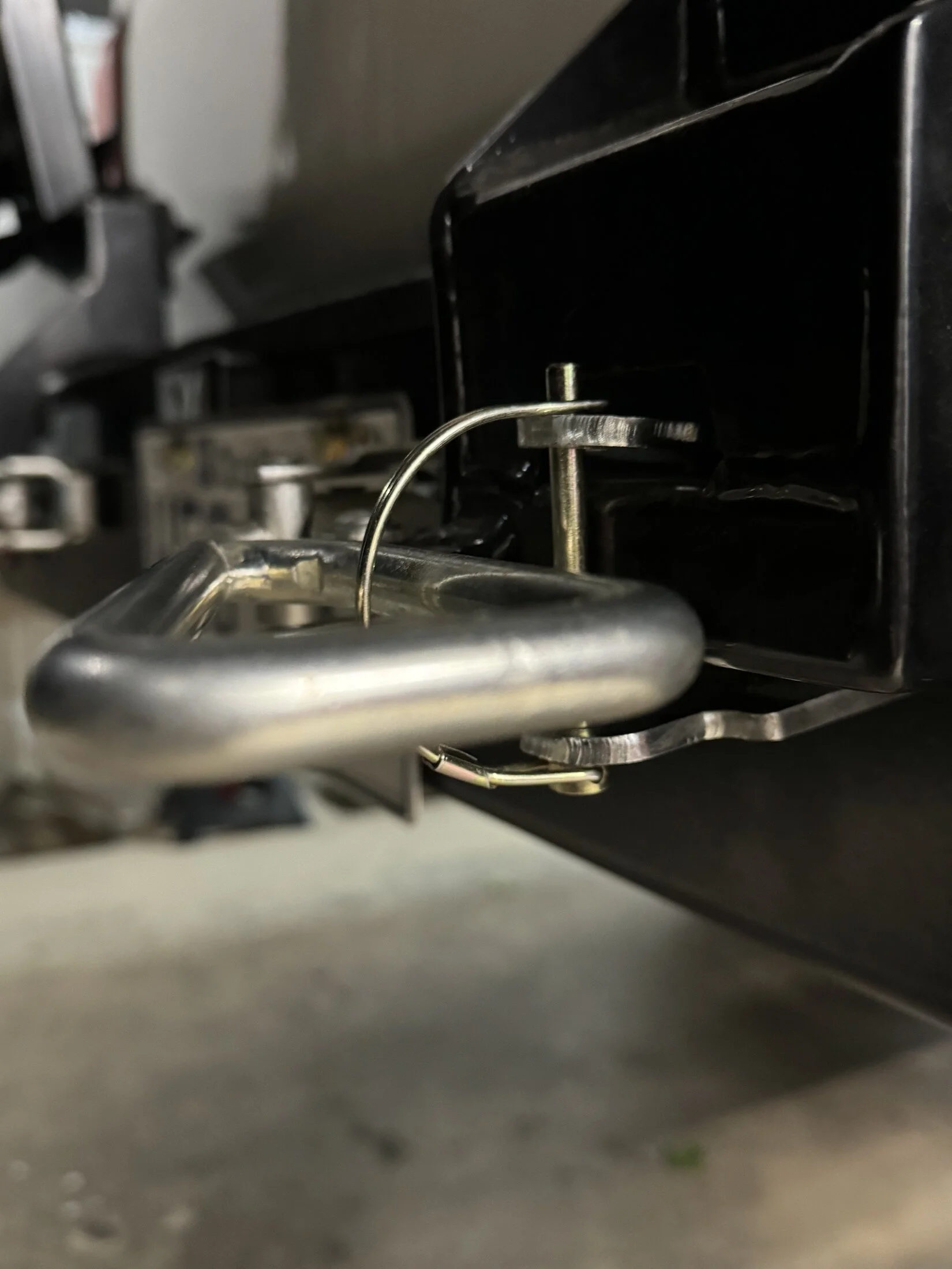

My friend gave me some trailer , tractor pin to prevent the rear bar to open in case of unfortunate circumstances fit very nicely and now protecting IMUA

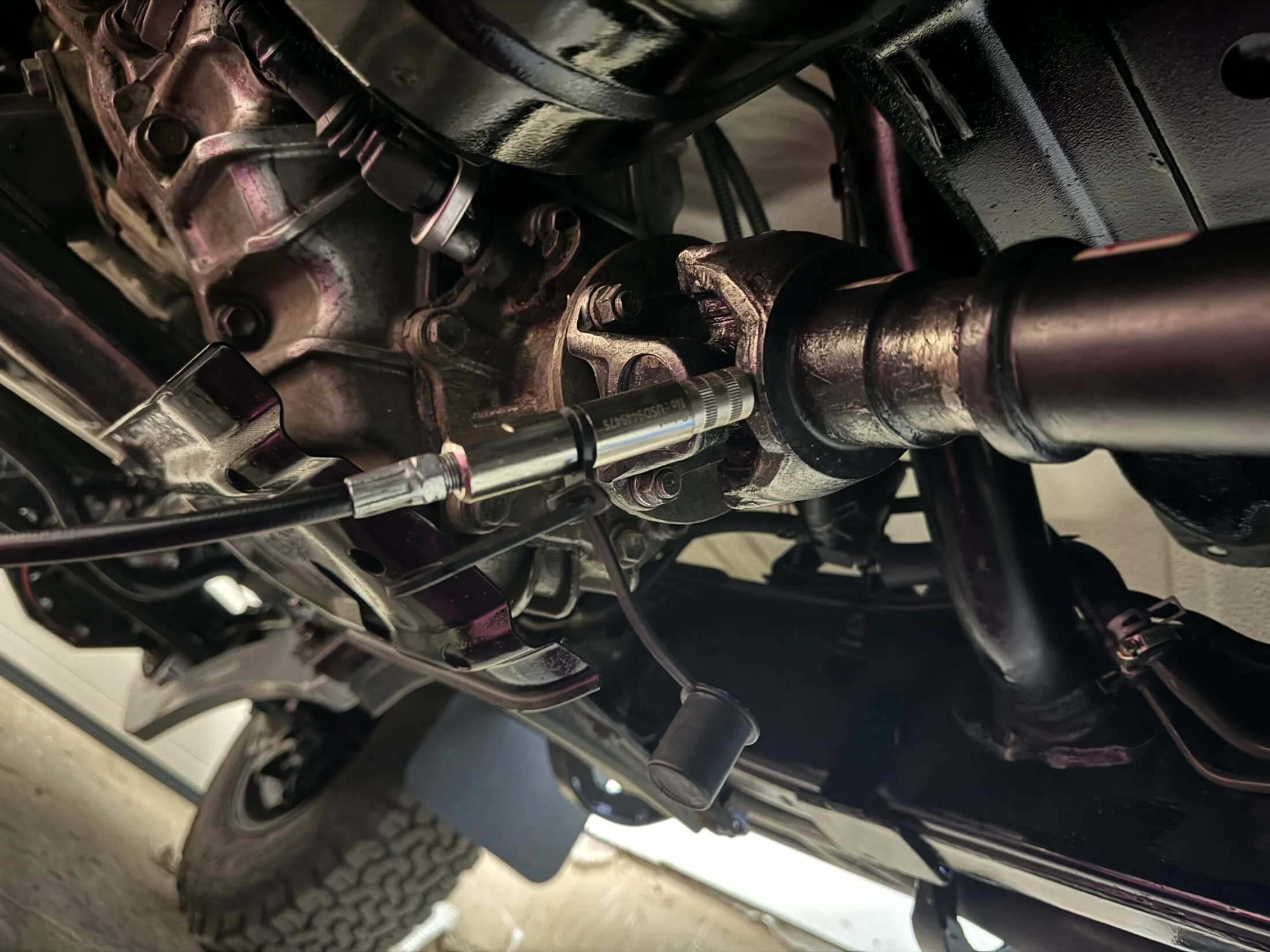

Got my hand on a quick connect for the greasing gun… I will do the propeller tomorrow and still need to add more lubricant to the clutch master cylinder boot as the swintquing sounds still present…

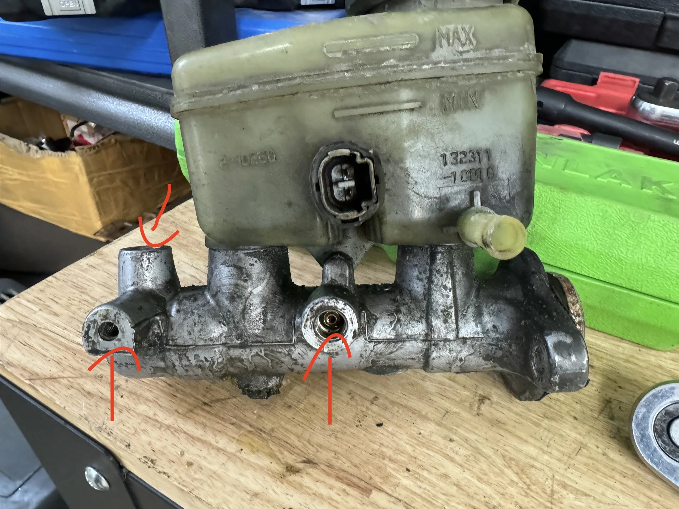

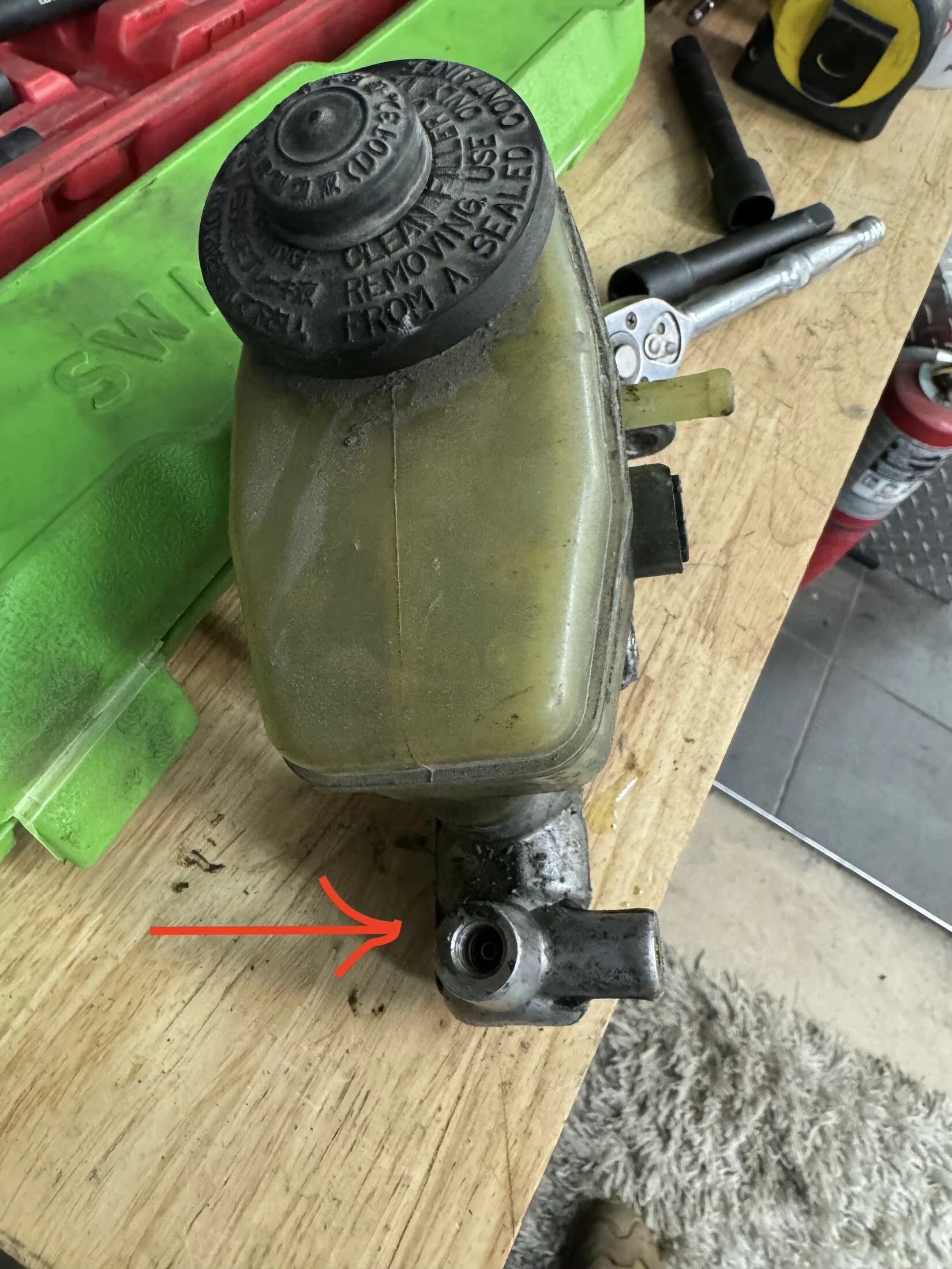

I received the Bendix Brake boster it's a 2 bolt pattern on the master cylinder side mine is a 4 bolts patern no big deal so far so I need to shop for a 2 bolt patern master cylinder but on the 2 bolts one there's 3 fitting compared to 2 on mine (in & out)

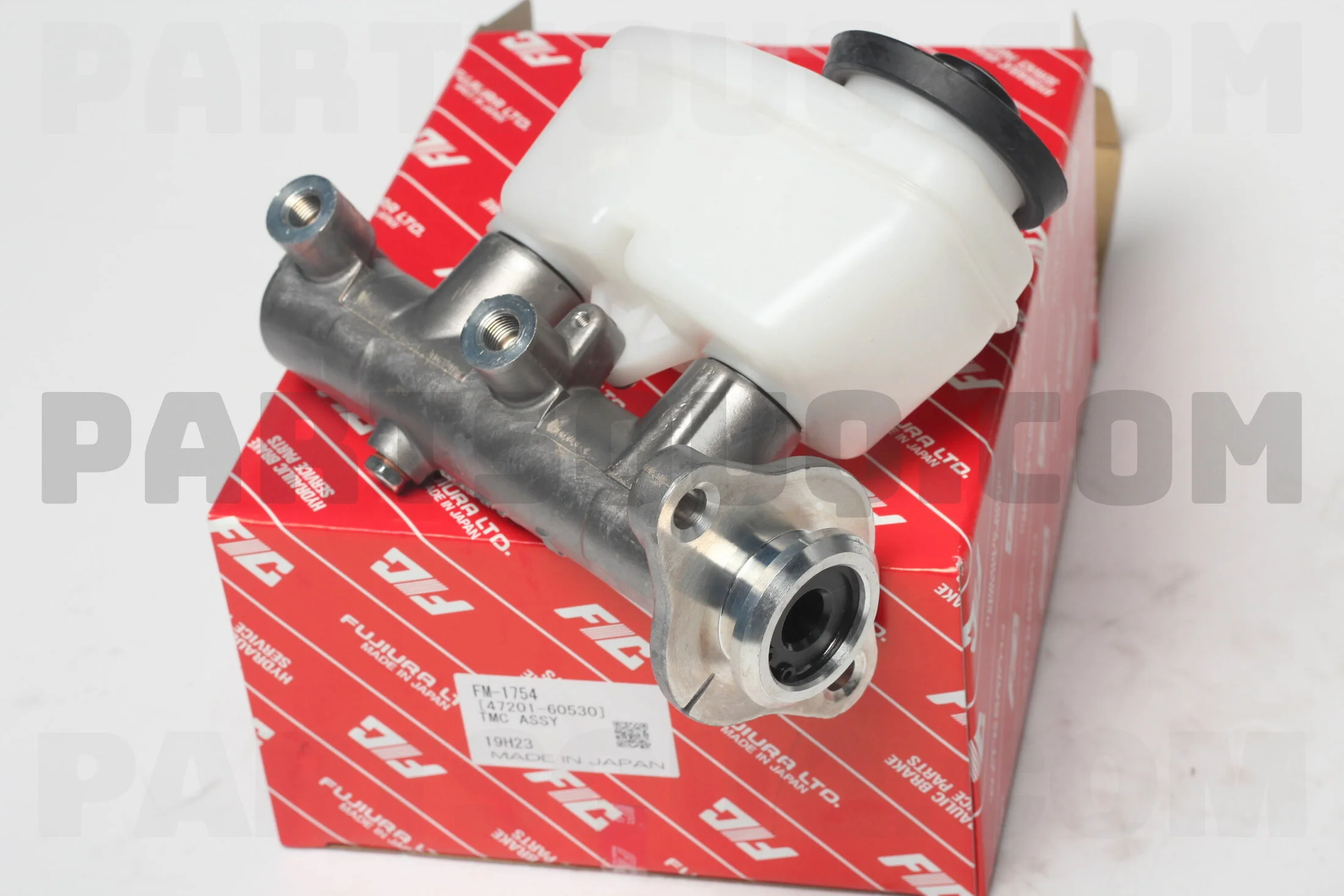

Hope you’re well. I did not order the truss washer kit, but the mechanic at the shop mentioned it and said that he needs to put something, a gasket, because there’s a small backlash to be done on the unit. So this is the Tamr Terrain kit. I thought it would have come with the other, the install kit, but it didn’t, so we’re gonna have to make it fit. Also, there was no output shaft on my new transfer case, so I will have to look into that, but I’m more concerned right now about my little booster brake install. I need to find the proper, master cylinder,
After doing a little research this morning I look up the Master cylinder for a LC80 series and I believe found the proper one to do my swap, Same plug sensor 2 bolt patern instead of 4
Japan made
