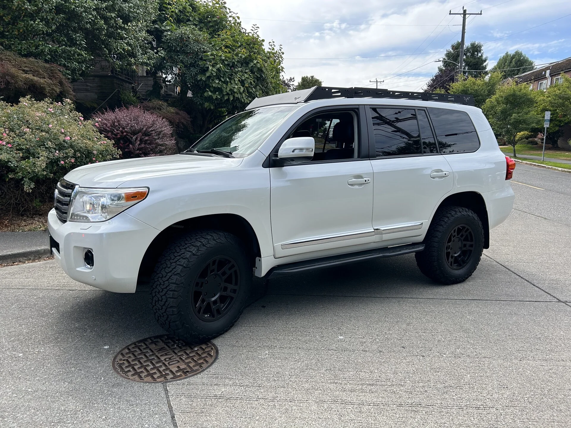

Love my FN wheels (18x9)

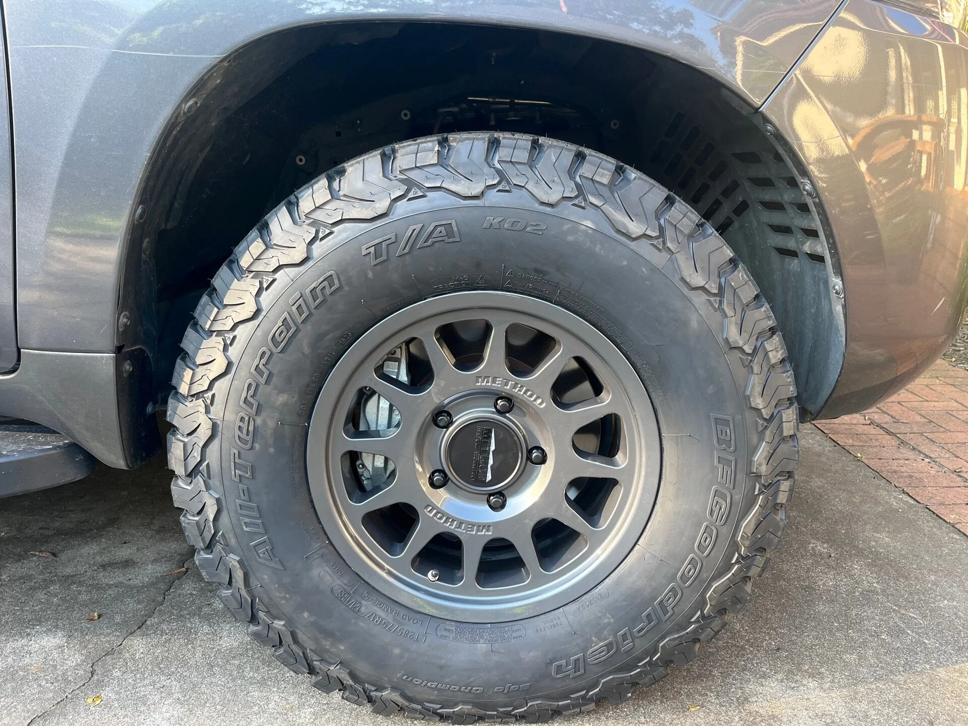

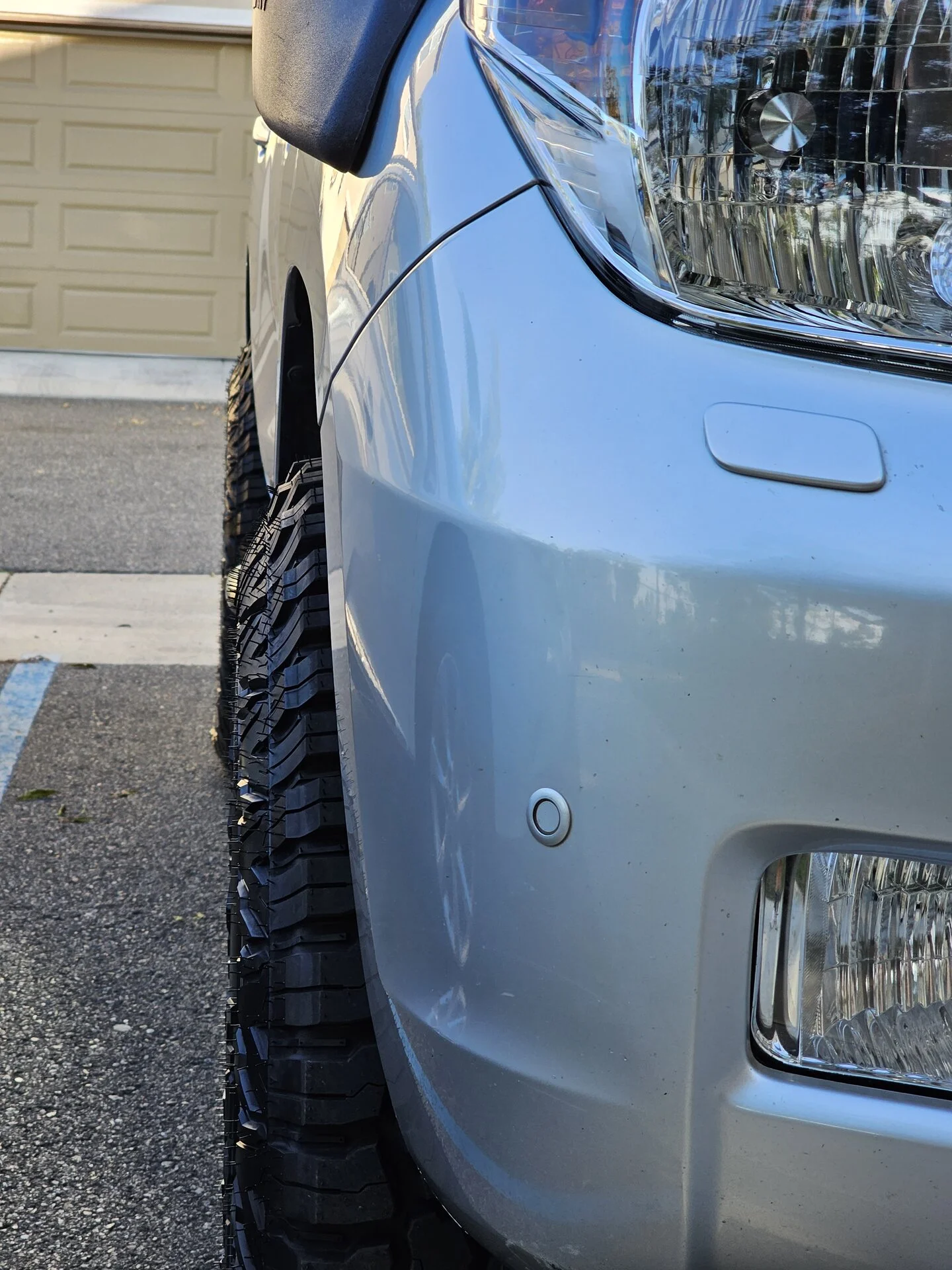

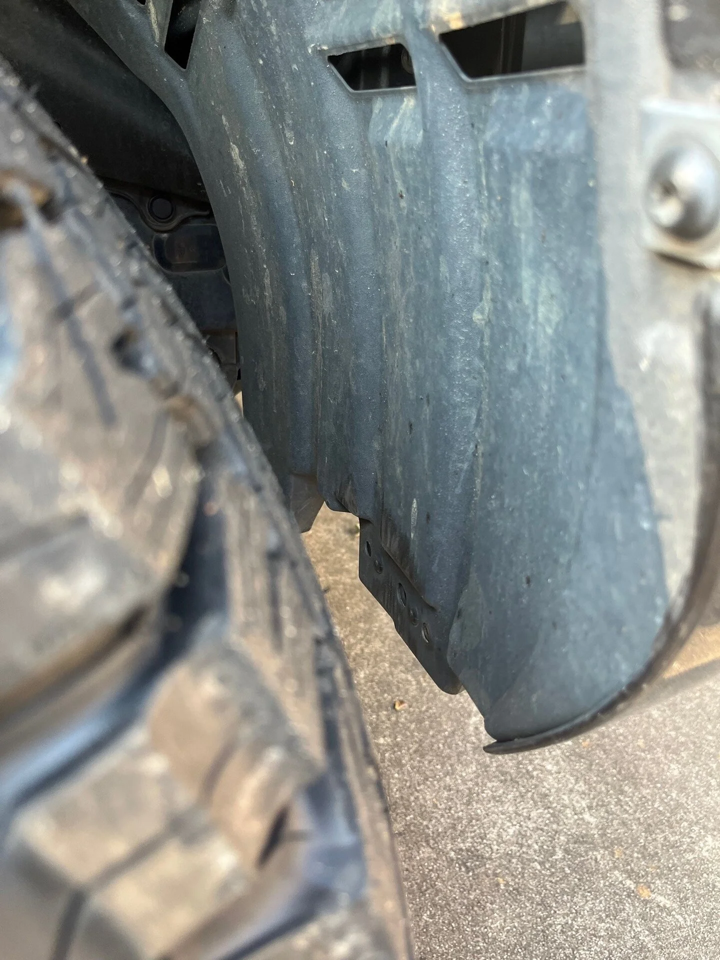

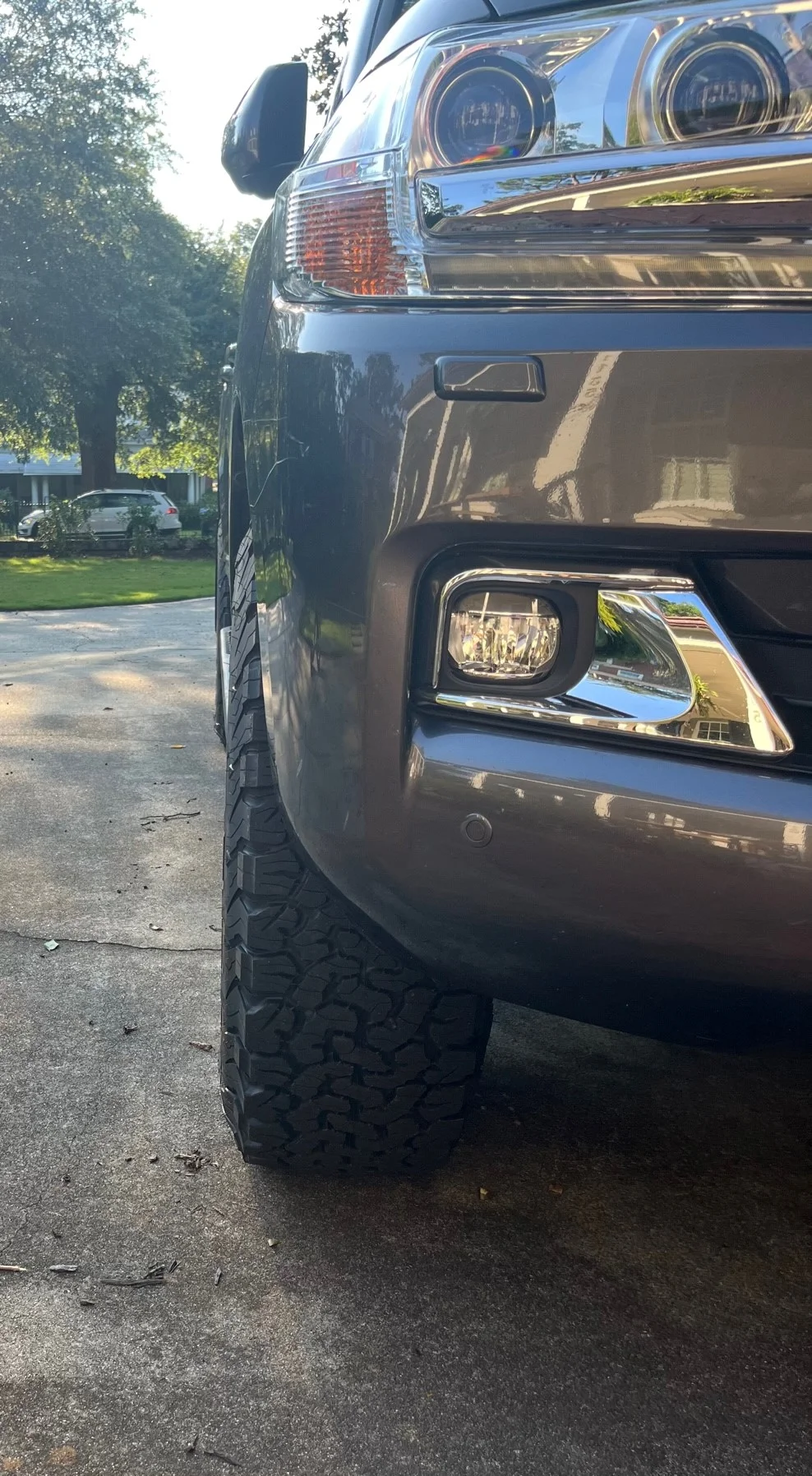

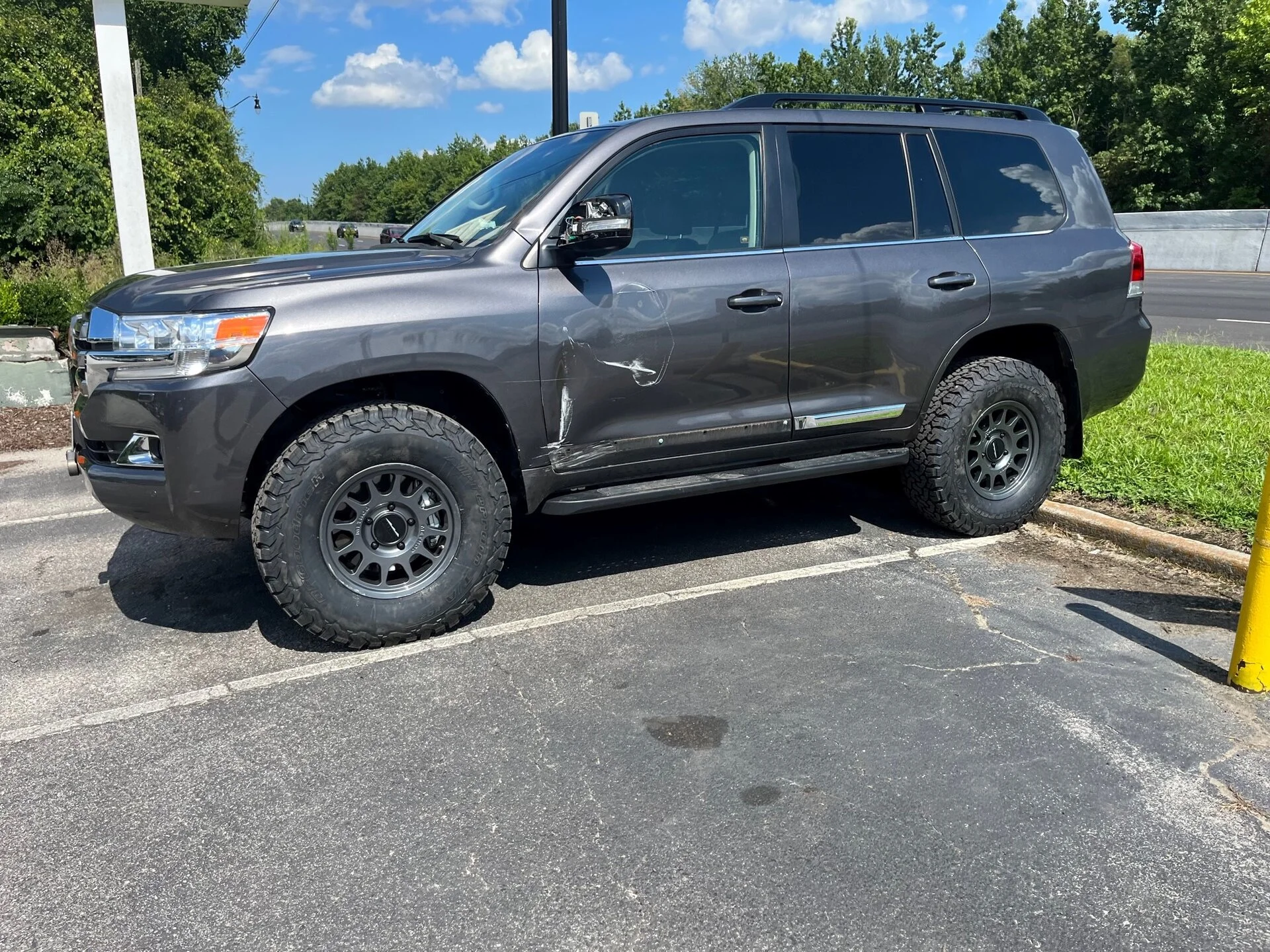

The 285/75r17 (33.9"x11") tires fit well with a 2" lift and the -35mm backspacing of the method wheels (17x8.5"). Only a slight rub on the plastic fender liner at full lock (pictured). Extremely happy with the look, and the fit. Unfortunately there was a mishap at the tire shop though, and the cruiser took a pretty big hit to the drivers door. Drivers side rubs like a sonofabitch, but only because of the accident.
What was the offset on the wheels??

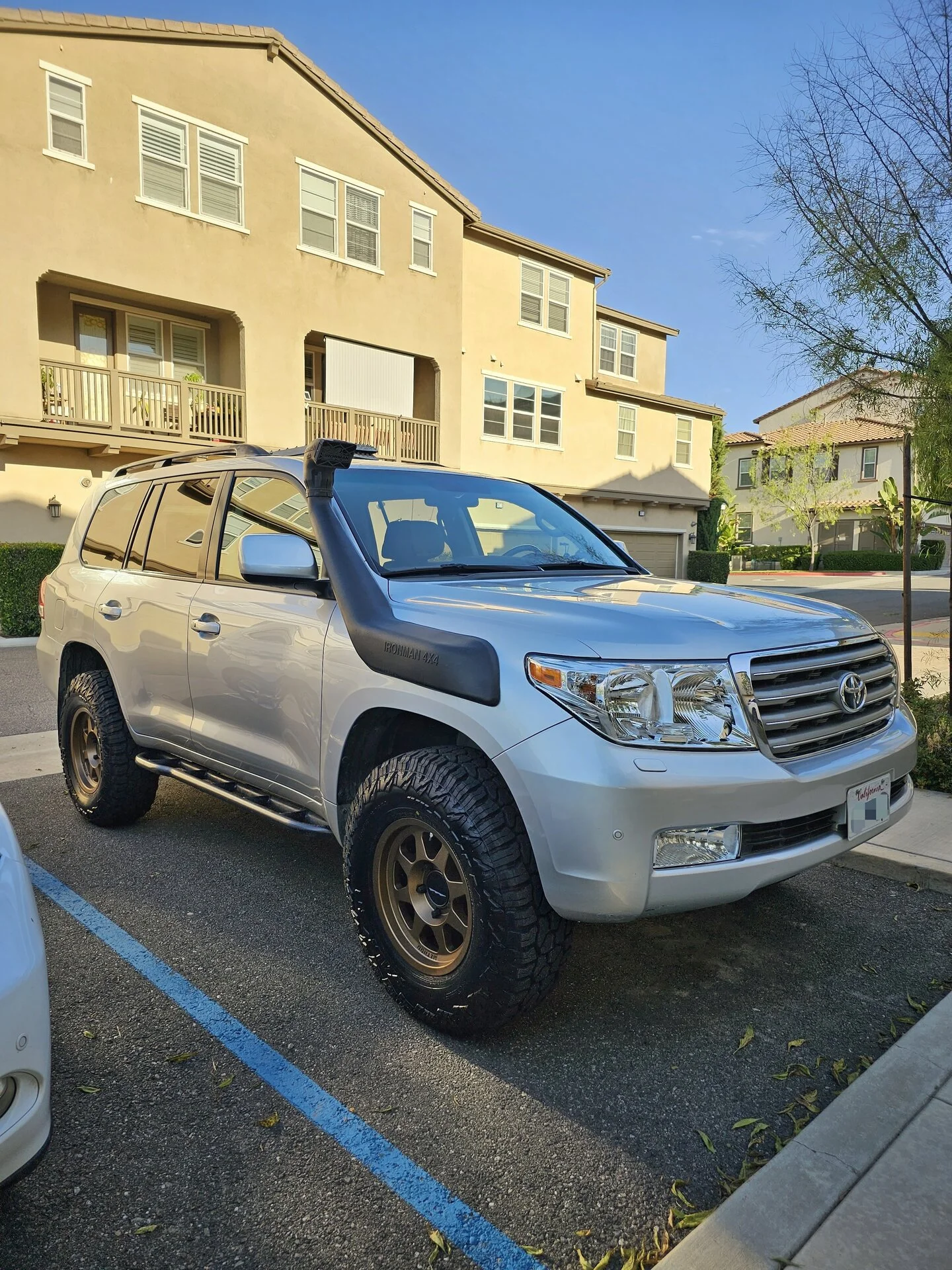

That looks great. Have you twisted it up yet on the trails?

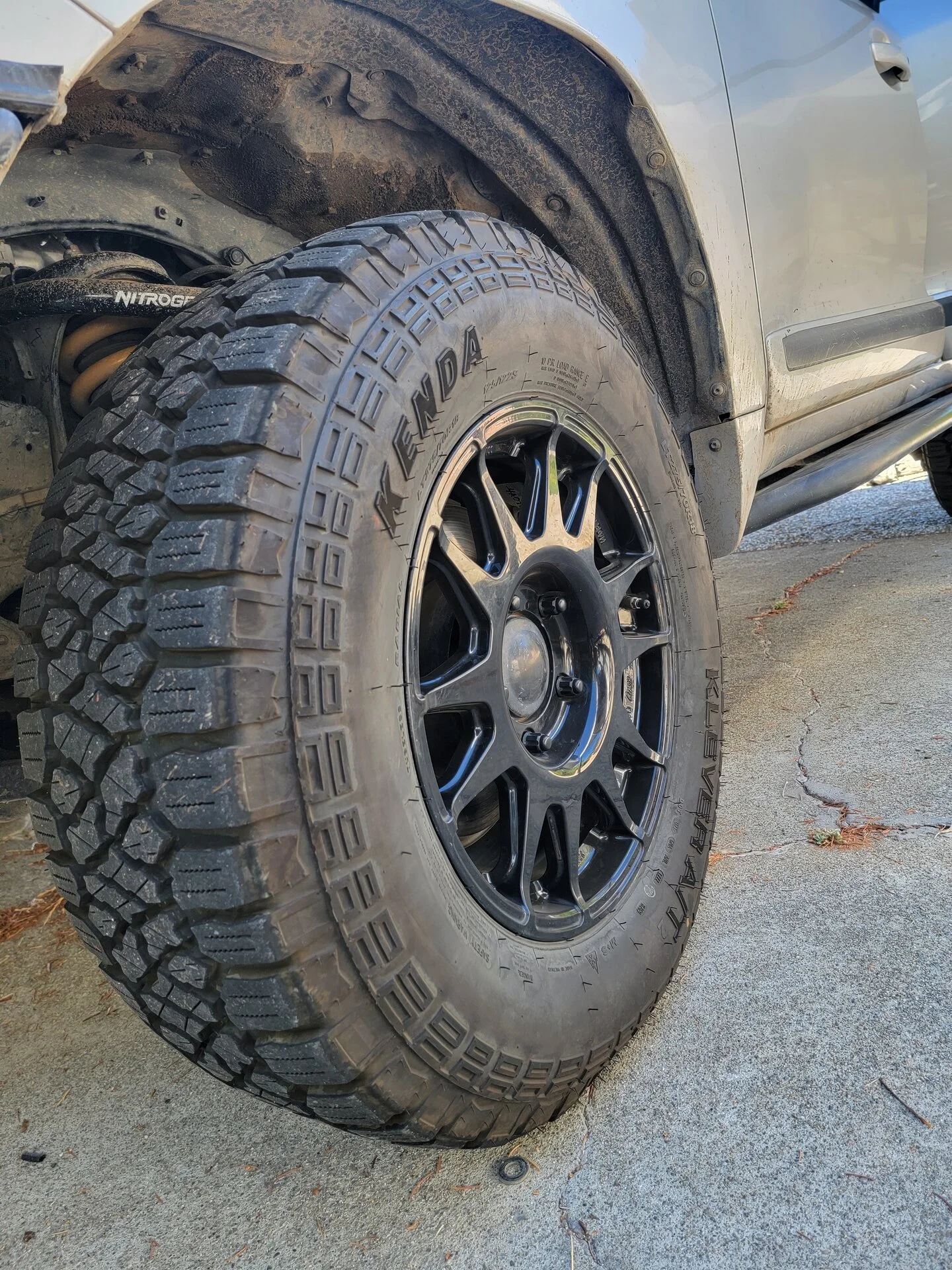

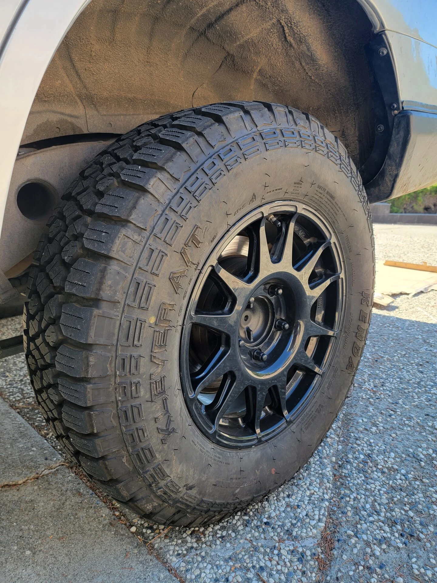

I have been running them for the last year. Very happy with them. During this last heavy winter in CA they did phenomenal. No issues in deep standing water or snow.
The tread pattern is similar to the Dutatracs but so far no intrusive road noise to report. Quieter then the Klever RTs
I have them in LT275/70r18. They are basically a less aggressive version of the Kenda Klever RT that I was using before. The AT2 has a 2ply sidewall and is a little smoother/softer then the 3 ply RTs. The main reason I went with them is that i was really impressed with the RT and for my next set I wanted a light 3 PMSF rated tire. These 33" tire/ wheel combo weight 80.5 lbs.

that is awesome!! really wanted those wheels for a while but 6 + month wait always

Right on, happy to assist. I was fortunate and ordered the wheels through Main Line Overland before the whole covid supply chain went to s&%t. Prices now are more then I'd pay for the wheels. Have you checked out Tire Rack? They have Alpha Equipt wheels on closeout. Can find different wheel options from $125-$200 a piece. Their search function is garbage though and you have to use different years of the tundra with the 5x150 bolt pattern to filter the wheel options.
I am up in Northern CA, not familiar with those areas. I mainly explore the Tahoe, El Dorable National Forest areas and the Mendocino NF. I have family in Southern CA but haven't had the chance to make it out when I am visiting.
I bought mine through Walmart.com. However if i had to do it again I'd use Simple Tire or Priority Tire. Or at least make sure the seller is an approved distributor for Kenda. You can buy through Walmart.com and the tires may be from a seller who is not an actual approved distributor for them which then voids their warranty. Something to keep in mind as walmart often has the best prices but you may be out of luck with the tire warranty.
