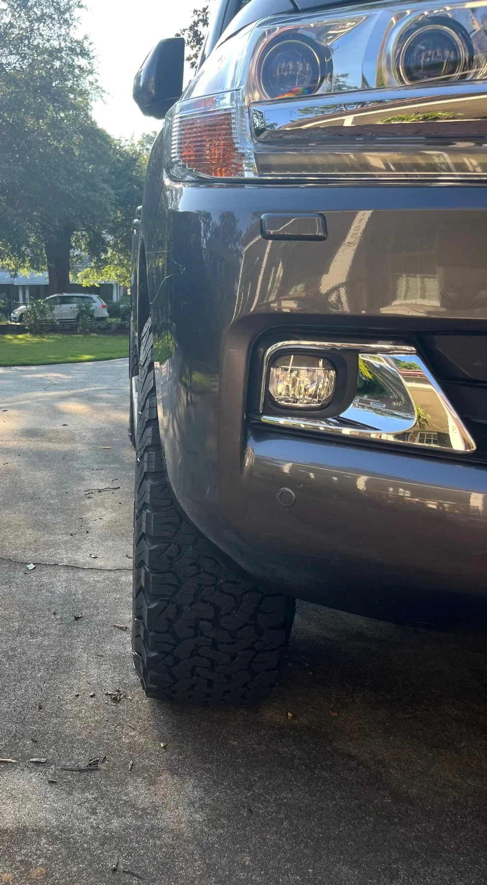

Post pictures and fitment needs if you wouldn’t mind.

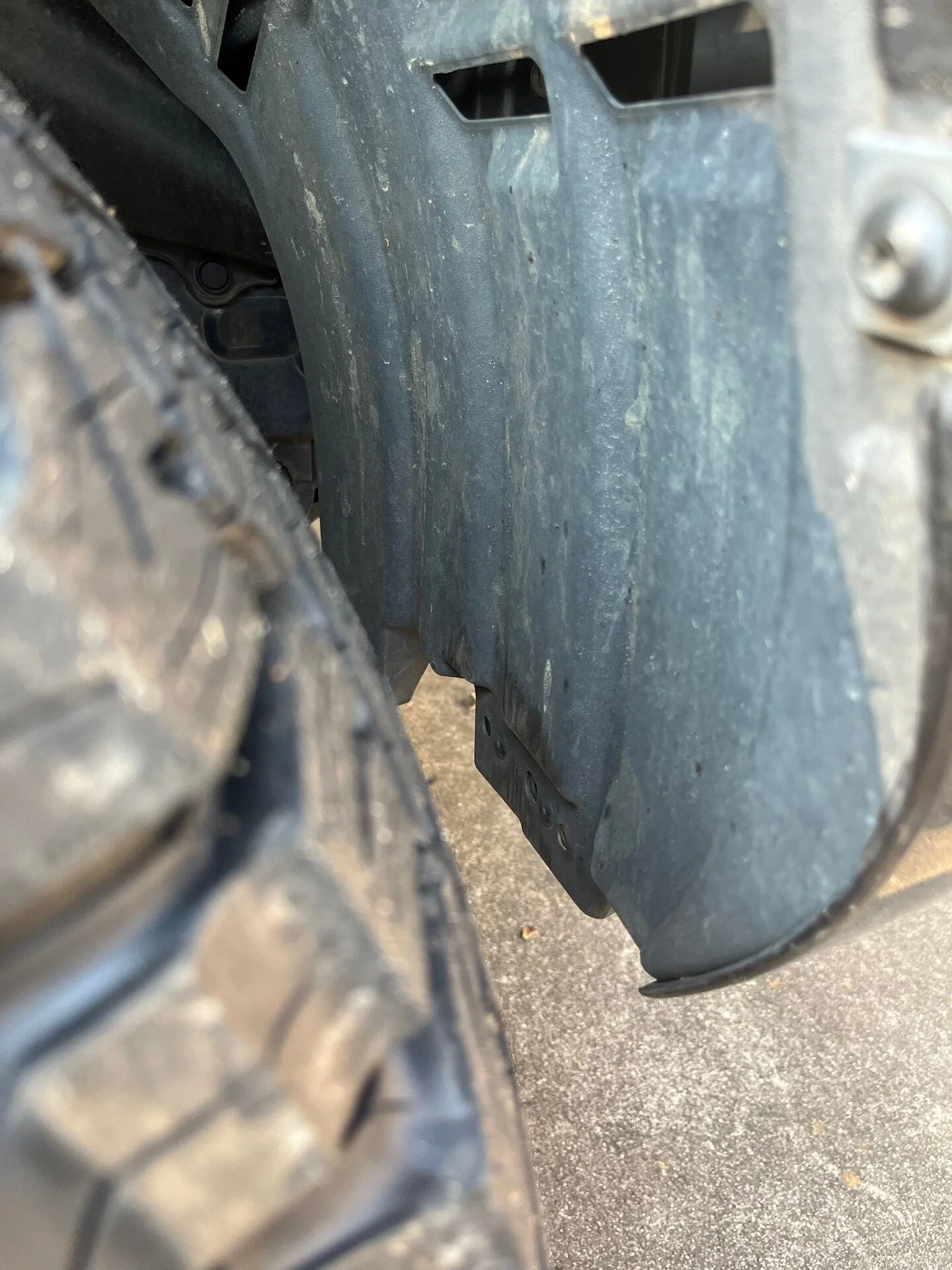

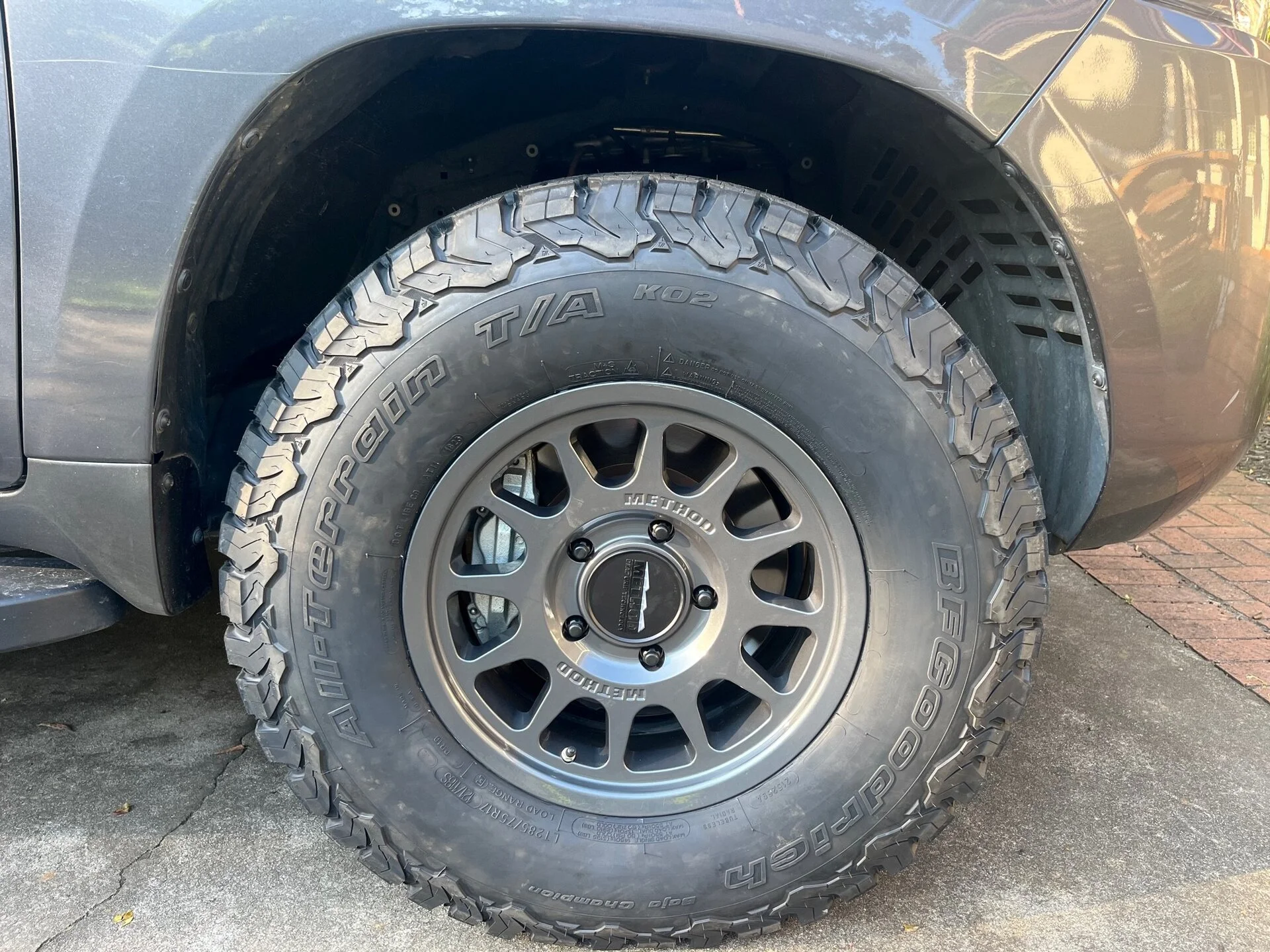

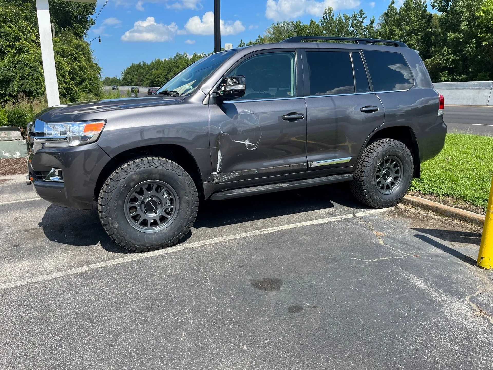

The 285/75r17 (33.9"x11") tires fit well with a 2" lift and the -35mm backspacing of the method wheels (17x8.5"). Only a slight rub on the plastic fender liner at full lock (pictured). Extremely happy with the look, and the fit. Unfortunately there was a mishap at the tire shop though, and the cruiser took a pretty big hit to the drivers door. Drivers side rubs like a sonofabitch, but only because of the accident.

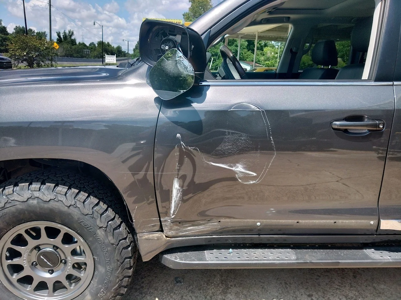

Holy f'n eff. Man oh man, I'd be livid. That's gonna be a $5K+ fix, easy.
I believe the initial quote was 8K. Tire shop owner is a friend, felt awful obviously and is handling the repair through his insurance. s*** happens, thankfully no one was hurt.
Sounds about right, there's $1500 just in the side skirt and chrome trim part alone and then you've got the mirror and body work on both the fender and door and a multi-stage repaint. Glad to hear it's being handled, you're a better sport than myself lol.
I ususally stay pretty level headed. I am in the service business and understand how many problems come into play when you have multiple employees handling other peoples property :/
Yes. the biggest thing that worries me about the repair is the door fitment. Right now it does not seal properly (sounds like the window is down). I do have a lot of other scratches and dents that will be repaired while this work is being done... somewhat of a silver lining.
I had similar damage to the driver side door of a F-250 a few years back and the body shop just ended up reskinning the door for the repair. Unfortunately it never sat quite right after the repair and there was a faint rattle that got worse in the weeks after it was repaired. Ultimately it drove me insane, I couldn't handle having an $80K truck that was only a year old rattle like that so I ended up trading it in on another Super Duty haha.
That big push in the door likely lifted the door frame off the body - been there. I was able to pop a trashcan lid sized dent out and have the door relax and re-seal, but that was on a 60...less rigid than a 200 door. I'd push pretty hard for a new door.

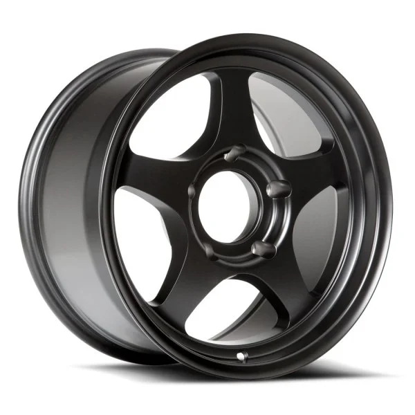

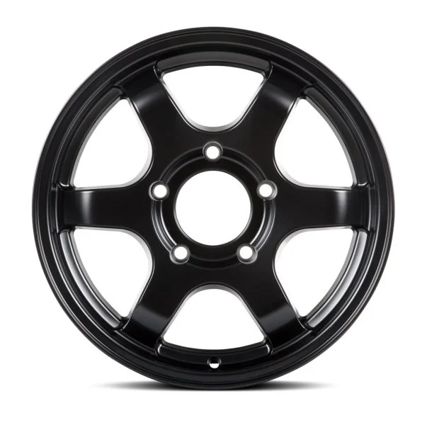

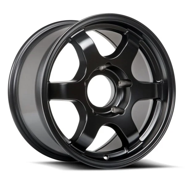

Hi IH8MUD LC-200 owners,
I'd like to share with you all that we just released updated versions of for the FN Five Star and Six Shooter wheels for the Landcruiser 200 / LX 570 (as well as the Sequoia and Tundra).
More information is available on our website (or feel free to contact me directly), but some of the key features are:

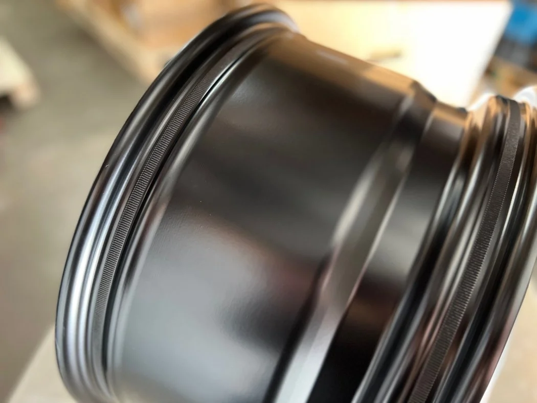

-Advanced flow formed construction method using premium (virgin) A356-T6 aluminum alloy resulting in an excellent strength to weight ratio for these wheels.
-Proprietary high clearance barrel designed to fit properly over the Landcruiser brakes provides ample room for stick on wheel weights, allowing for the wheels/tires to be dynamically (dual plane) balanced without any brake caliper interference.
-Both wheels were tested to JWL-T/VIA, DOT-T and the most current SAE J-2530 standards (SAE J-2530 is the most stringent testing standard, tougher than JWL-T or TUV)*.
-2,500lbs per wheel load rating**.
-Reinforced flanges / lips for increased strength and rigidity at these critical points.
-Knurled bead seats to enhance bead retention at low tire pressures and to prevent bead slippage from high torque applications.
-Extremely durable finish / clear coat.
-Strong, simple, easy to clean designs that compliment the body lines of the Landcruiser.
*If these wheels were tested to JWL-T (Japanese governmental standard), then the published load rating would be significantly higher. Most OEM and aftermarket wheel manufacturers test to JWL-T and not SAE J-2530. JWL-T is a very high standard, but SAE J-2530 has even tougher requirements for radial fatigue, cornering fatigue and impact.
**These Five Stars and Six Shooters were tested and certified to a minimum 2,500lbs load rating per wheel with a 37" tire diameter per SAE J2530 testing standards. This means that the load rating is higher than our published load rating should you install smaller diameter tires (i.e. 34" or 35" OD). While we know that 37" diameter tires are not commonly installed on Landcruisers, we wanted everyone to be very comfortable knowing that these two wheels achieved a 2,500lbs load rating with up to a 37" diameter tire.
Please click here for more information on our website.
I would be more than happy to respond to any comments, questions or inquiries. We're very proud to be able to offer these wheels, and we hope you guys will like them.
Thank you,
Dustin
FN Wheels
(855)WHEEL-00 (855-943-3500) - Toll Free in the U.S. and Canada
(951)735-1100 - Office
(714)390-9387 - Cell
fnwheels@gmail.com
FN Wheels Five Star – Flow Formed
Diameter:
17″
Width: 9″
Offset: +25
Backspacing: 6″
Bolt Pattern (PCD): 5x150mm
Center Bore: 110.2mm hub centric
Load Rating: 2,500lbs w/ 37″ tire diameter as tested to SAE J-2530 testing standards
Wheel Weight: 24lbs (approximate)
Colors: Matte black
FN Wheels / Konig Six Shooter – Flow Formed
Diameter:
17″
Width: 9″
Offset: +25
Backspacing: 6″
Wheel Weight: 26.7lbs (approximate)
Colors: Matte black
Knurled bead seats:
Confirmed today the entire drivers door will be replaced.

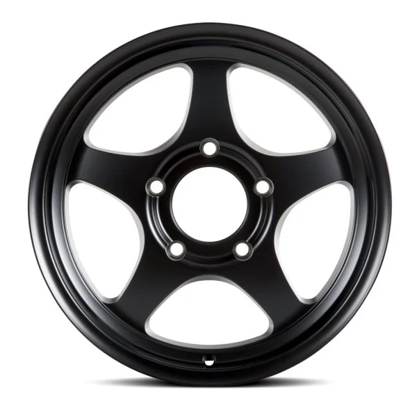

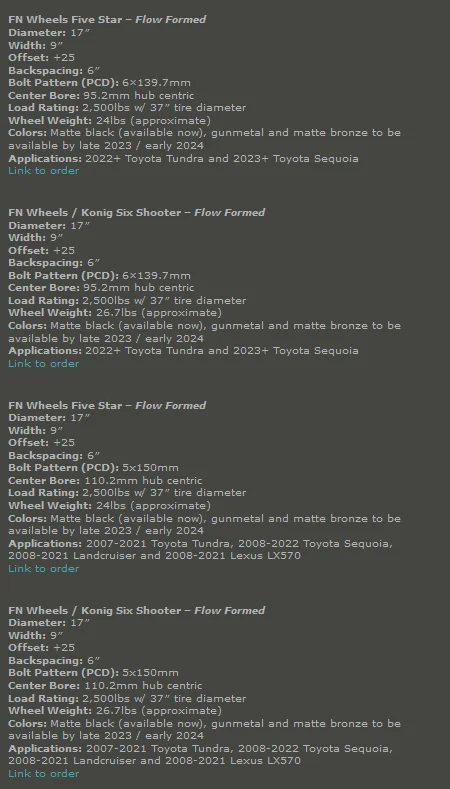

Oh boy, that's a helluva post. We need more 17" options for these rigs that aren't 0 offset brodozers meant for a Tundra :cool:
:edit: BTW, the first to links to order link to 6-lug wheels. The last link is correct.
Thank you. Glad you like the wheels. :)👍
I believe you're referring to the link to our website? The first two wheels listed on the update page on our website take you to the 6x139.7 wheels for the third generation Sequoia/Tundra, and the next two links are for the 5x150 wheels for LC-200 and second generation Sequoia / Tundra. The design, testing, engineering, certification, etc. applies to both the 5x150 version and the 6x139.7 versions of these new wheels. 👍
Screenshot :
