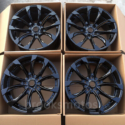

Hey guys, quick question on fit, i believe these will work but just want to verify before i drop the cash.
2018 White LX, currently undergoing chrome delete. Goal is to mount 275/65/20's duratecs on these. What do you think? Not style but fitment.
Specs:
Wheel Diameter: 20inch
Wheel Size: 20X8.5
Finish: GLOSS BLACK FULL
Wheel Offset: +40mm
Bolt Pattern: 5x150
Wheel Bore: 110
Condition: New 100% aftermarket products
Quantity: 4 x 20x8.5
That's a 34" tire, so it may require some re-arranging of the plastics behind the bumper, but I imagine it will fit with no more effort that than.
Yeah I’ve seen posts of people running 275 65 r20 on even stock wheels. 40 offset should make fitment about as smooth as it’ll get.
Probably will have to push the front fender liner forward and address the front mudflap area.
Awesome, thanks guys! I dont mind a little trimming, just was curious about the offset which i dont totally understand. I originally was going to go with a stock 20 inch wheel and i have a set of 1 inch spacers on order from BORA. Sounds like i wont need these anymore with this wheel. Appreciate the feedback.

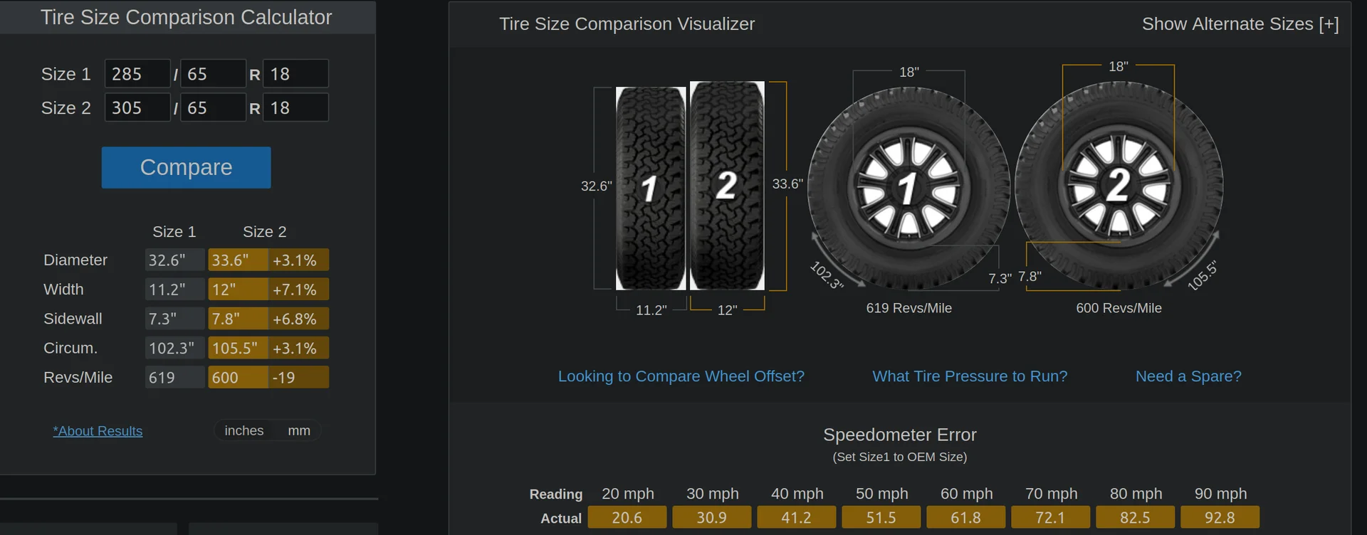

Can you guys Help me narrow things down for my LX?
I tow pretty often, 15-20 trips a year. There are a lot small elevation changes on the roads around here. The transmission gets a work out. With tongue weight I am easily at or over 1000 pounds of cargo and the trailer weight can be figured at 3.5k.
Last summer I watched a gentleman in a a brand new GMC 4x4 learn where his jack was on his truck because his Michelin tore a hole in the side wall. We were on the river, there is gravel and sharp rocks and it is busy at times. I prefer to avoid that kind of stress so I am happy to sacrifice some on road comfort for a tough tire. For the past couple years KO2s did that job. Falken, toyo and nitto are all on the short list.
I plan to run a set of Tundra 18s.
The tire I want to run is the 305/65/18 or maybe a 285/70/18. Maybe the more logical choice would be a 285/65/18. I would like to hear from you guys who are towing in particular.
Is a 1 inch wheel spacer a good fit for this setup? Is there a mud vendor that you guys would recommend I order from?
I am happy to to do some fender liner heat gun work, but I would like to keep the mudflaps.

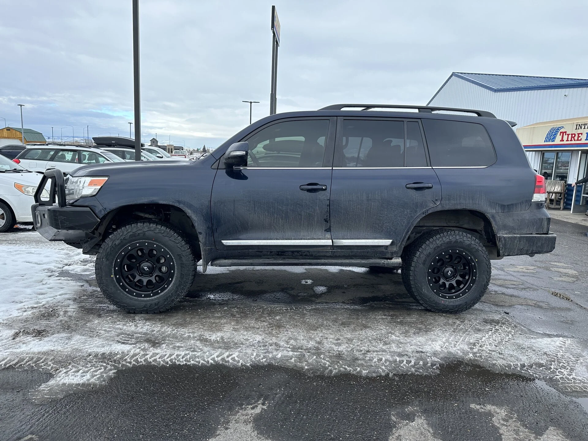

17" rim w/25 or 35mm offset, on an 18 LC, with 2" ome lift, is kdss something I'm gonna need to address?
OME 2" with 285/75/17 on 0mm offset wheel and I don't touch KDSS. I did have to do some trimming up front on the inner fender liner.
Awesome. I've already trimmed some with the current setup, so I may already have that handled.
I just barely clear the body mount. Your tire selection will impact this on a case by case basis. For reference I am running a 285/75/17 BFG KO2.

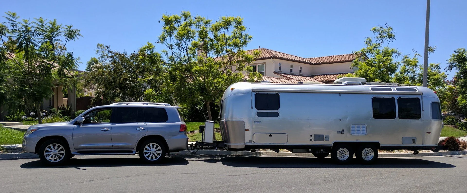

I ran a 305/60R20 for years towing an 8k lbs 28' Airstream with my LX. That tire size is a hair smaller but pretty close to a 305/65R18. Doable and can be a pretty awesome setup if you're paying attention to the details. You may likely need a BMC. With towing, offset becomes more important as you'll be putting a lot of torque down in the driveline and that can cause the steering to pull and push. The 1" spacer (+35 net offset) should be just about right in this size.
The larger tire size makes gearing and engine braking less effective but at your weight should be fine with the torque of the 5.7L. Would be good to go with more aggressive brake pads and/or Tundra brakes (I'm assuming you have a pre-'16 LX?)
Checkout my tow report here for more details:

Oh well that is a bit disappointing. I don't intend to do a body mount chop with the first set of tires.
So that leaves 285/70/18 or 285/65/18.
Is a spacer required for a 285?
