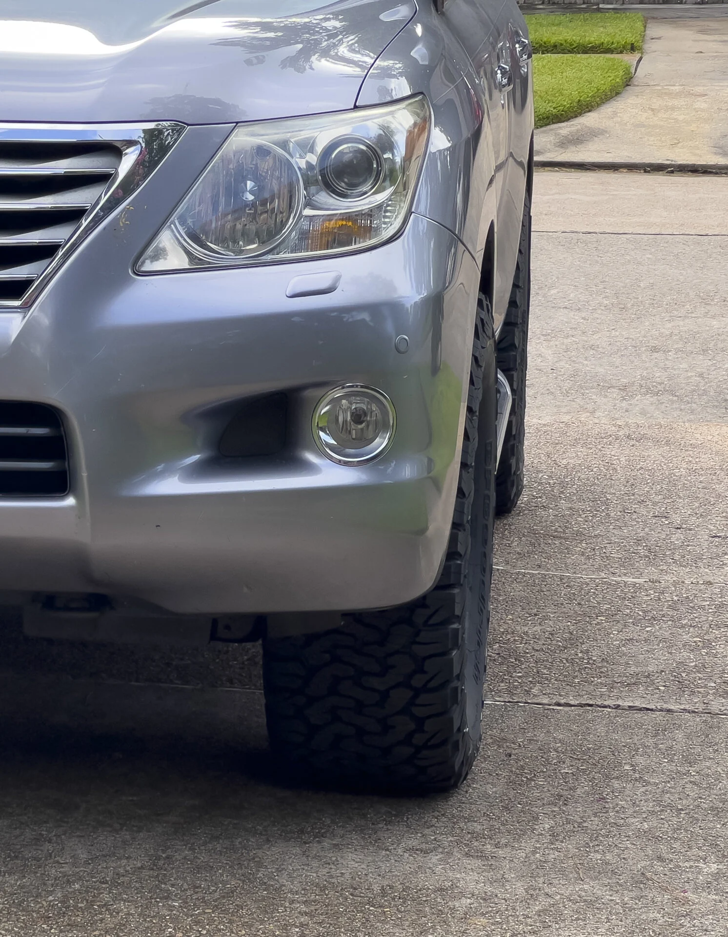

So after a few thousand miles on my 275/70r18 KO2’s (with the heritage wheels) I find that they do rub slightly when in reverse.
I think it’s against the upper control arm.
Otherwise I very much like these tires.
I haven’t done anything more than mild off-roading, but I haven’t noticed any other rubbing.
Do you guys think spacers would cure this?
And does anybody make a 0.5” spacer or a 0.75” spacer?
I’m trying to find a middle ground that clears the UCA but doesn’t require any heat-gunning.

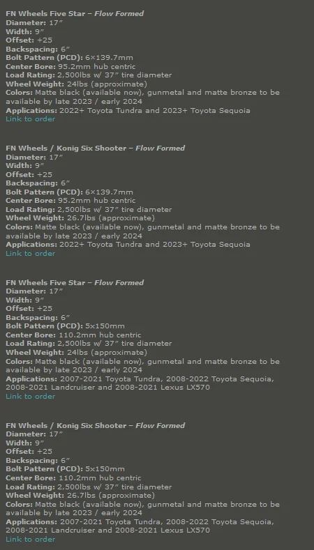

I believe you're referring to the link to our website? The first two wheels listed on the update page on our website take you to the 6x139.7 wheels for the third generation Sequoia/Tundra, and the next two links are for the 5x150 wheels for LC-200 and second generation Sequoia / Tundra. The design, testing, engineering, certification, etc. applies to both the 5x150 version and the 6x139.7 versions of these new wheels. 👍
Screenshot :

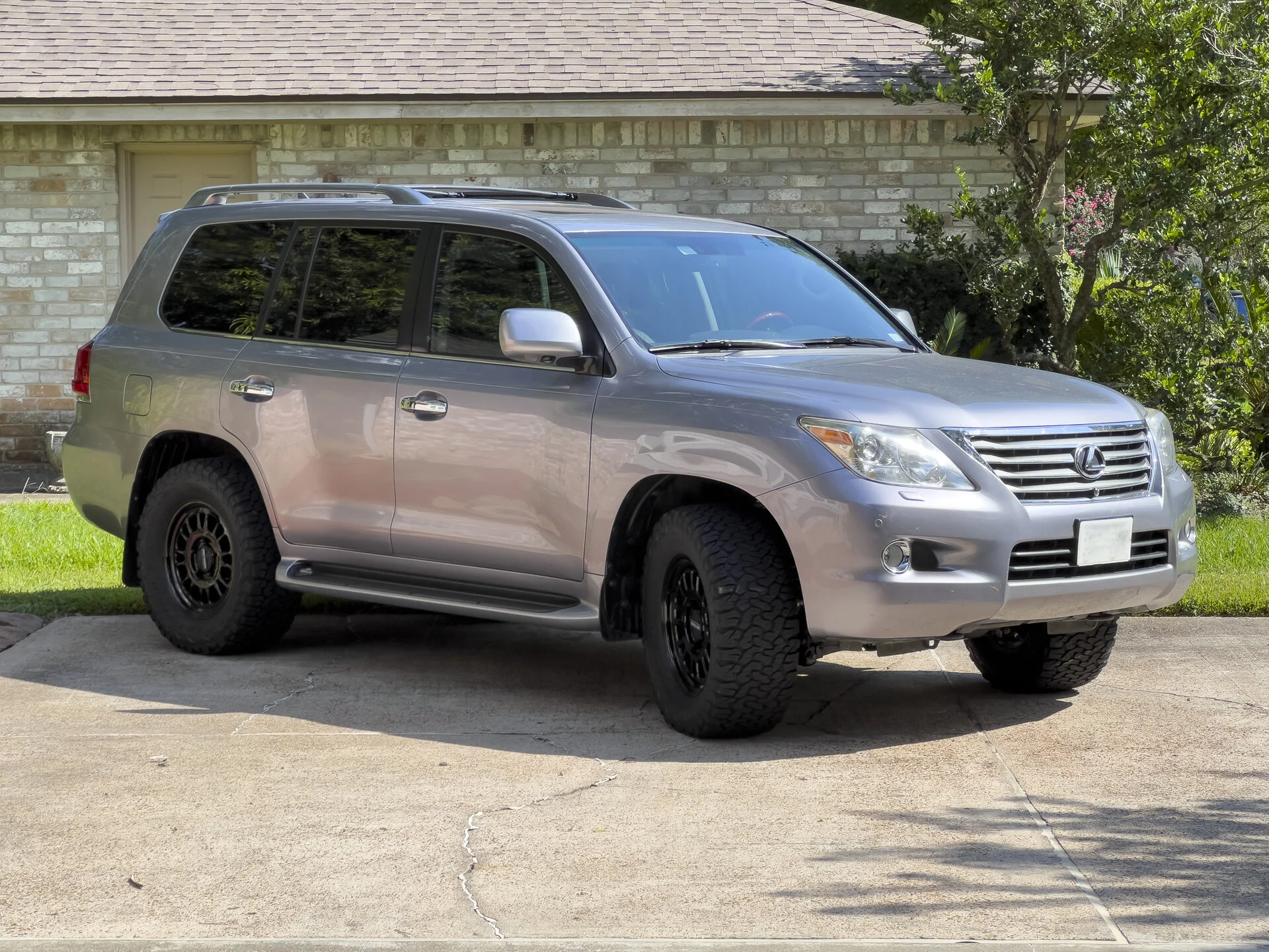

Pretty sure I read every fitment example on here before finally deciding on a set up for my new-to-me LX. Tried out a set of 0.75" Bora spacers with the stock wheels for a couple weeks and decided I wanted a full set of wheels instead.
Method MR318 18x8.5 +40mm
BFG KO2 33x12.50R18 (32.5 actual)
Pic is at normal AHC height. Had to move the front fender liner forward 1" and massage the front mudflap with a heat gun. No rubbing currently. Suspension is fully stock.

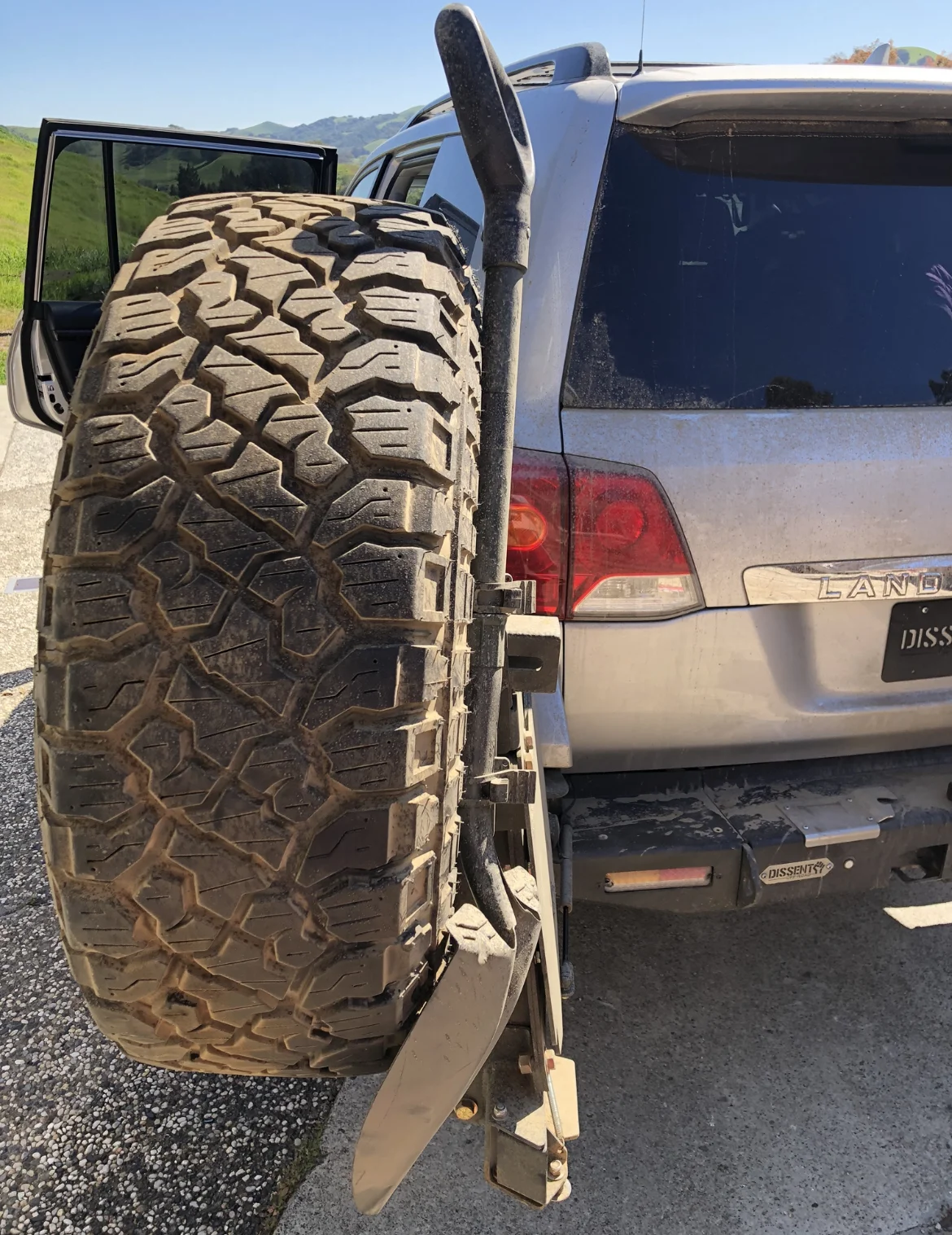

Swapped out my general grabber ATXs for the Kenda Klever RT in LT275/70r18. Haven't had a chance yet to test their offroad ability, on pavement the road noise is slightly more present (whoosh sound) then the grabbers which were barely louder then the Michelin defender ltxs that came on it when I purchased it last year. The ride feels softer with the kendas. The grabbers were a LT285/65r18.
Have a slight kdss rub at full lock while moving on the passenger side sway bar. These kendas run tall and wide for LT275/70r18. They are Listed as 33.43 for height and 11.22 for width. Top to bottom I measured their mounted height as roughly 32.5".

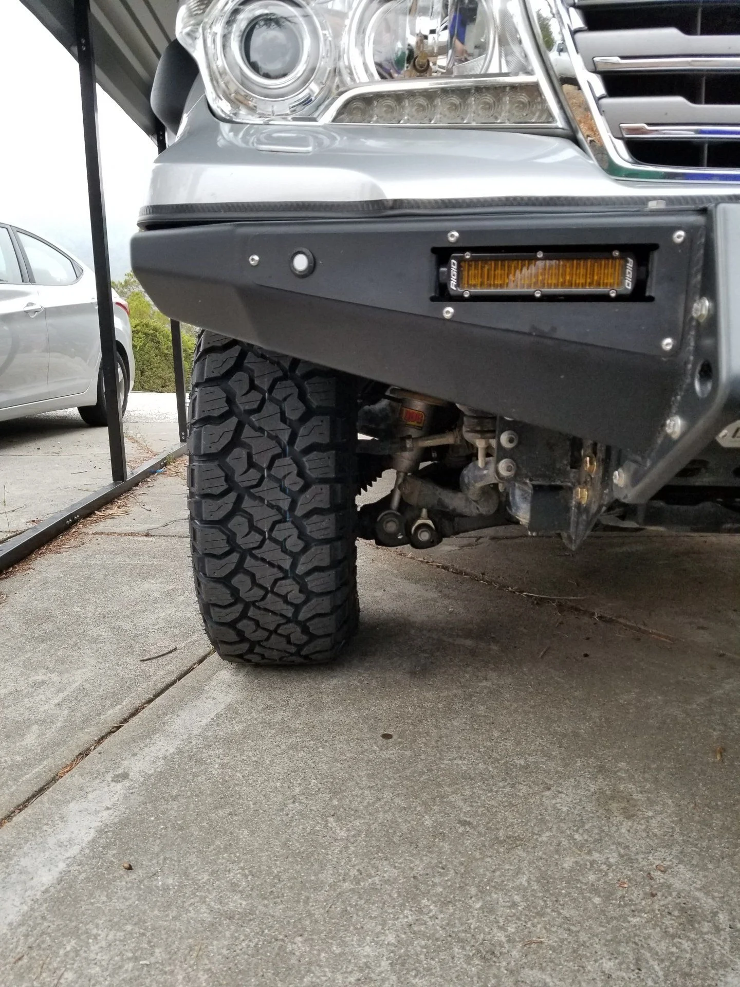

I do have dissent front and R bumpers how much does that affect the rub?
The high clearance front bumper will pretty much eliminate the possibility of rubbing with up to a 34" OD tire. You shouldn't rub the body mount / frame in the front with up to a 34" ~ 34.3" OD.
