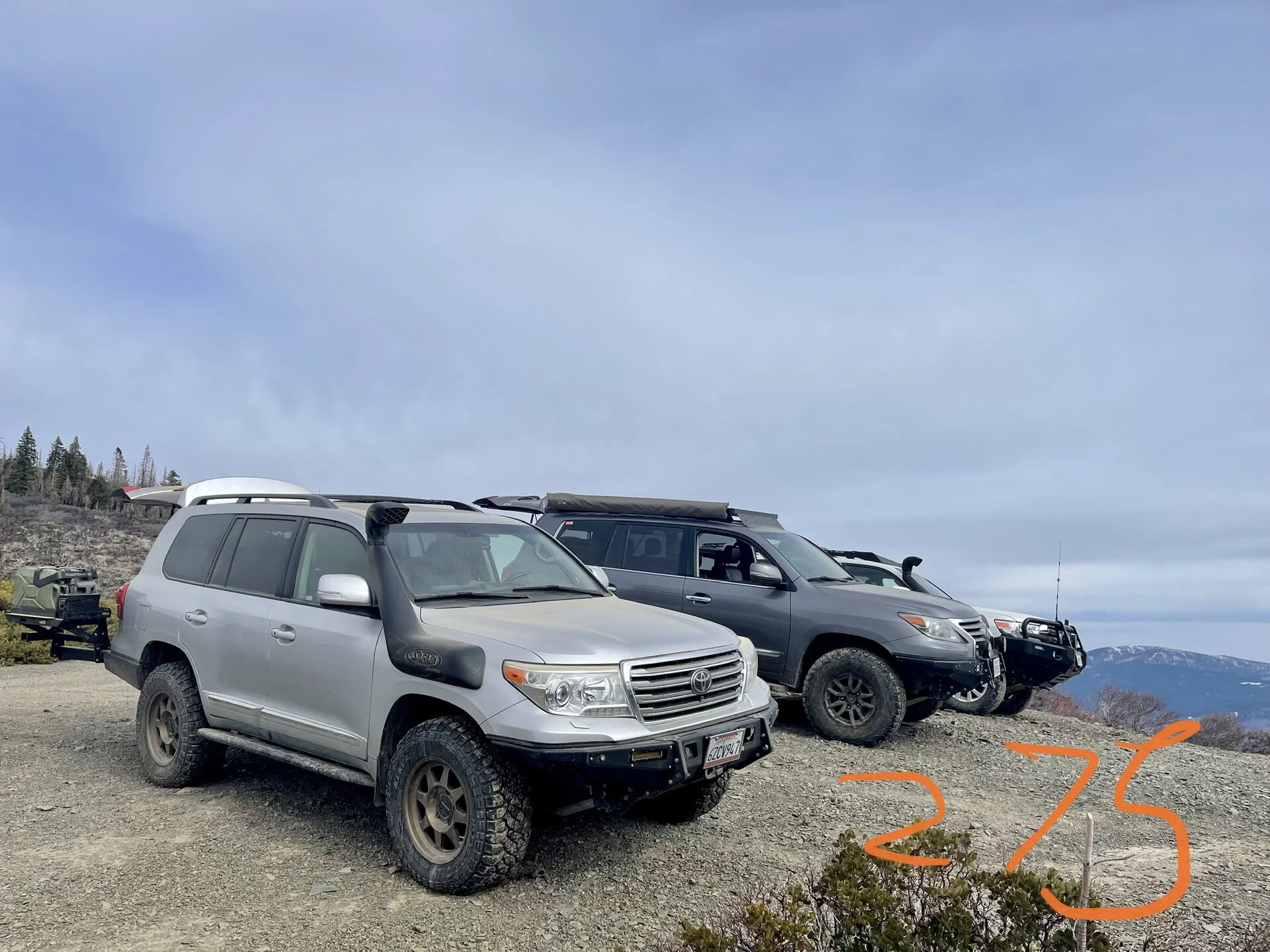

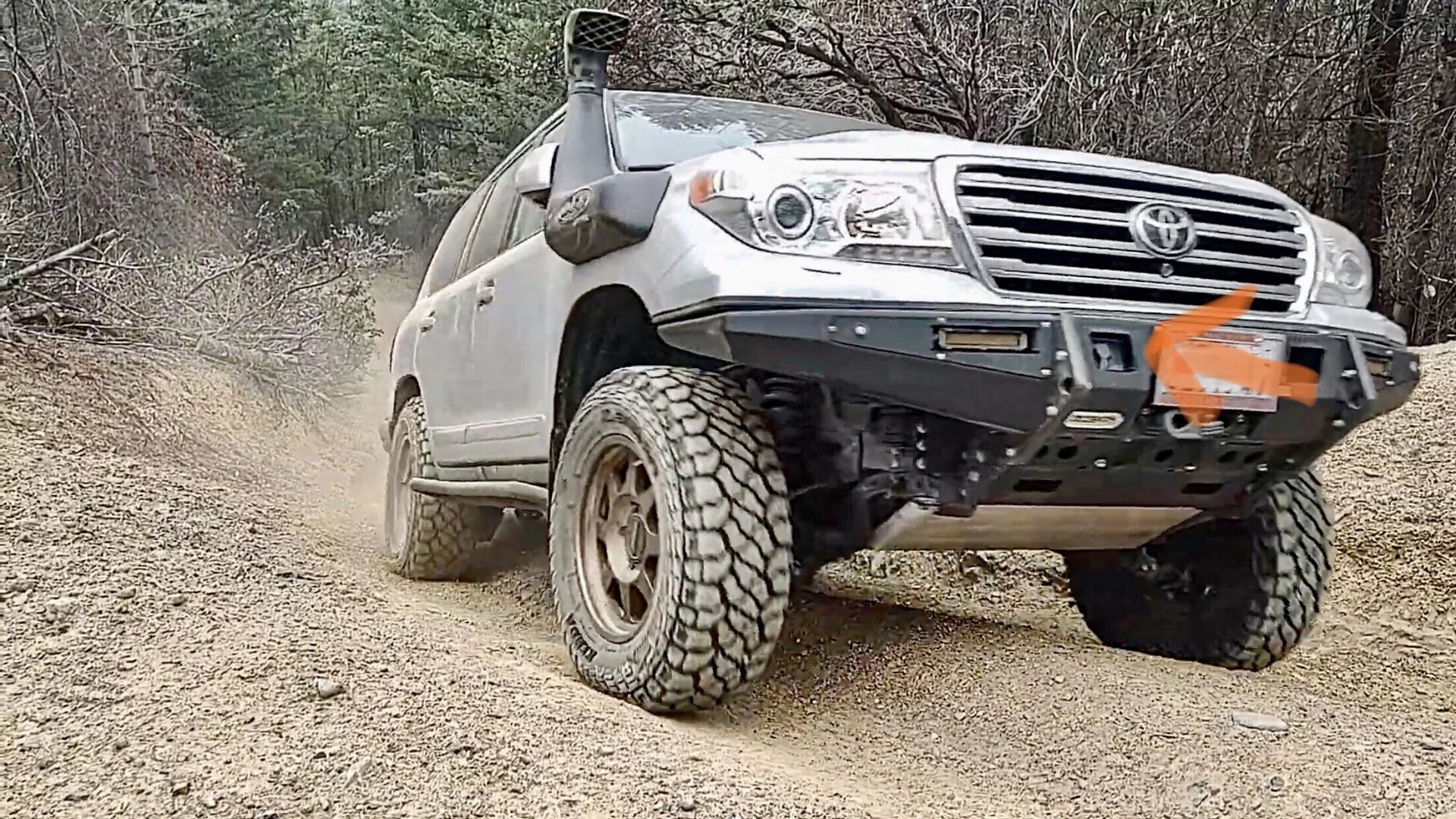

I have run a 9” wide 25mm offset Method bead grip wheel without issue with Lt275/70r18. Typically i would air down to 15 psi in the rocks and rough terrain. The method bead grip is legit. Haven’t lost a bead even after inadvertently running below 8 psi which eventually went to 0 psi after 2 miles into the trail. Valve core was not put all the way back in after airing down.
The Kenda Klever RT does measure 11.22” wide so it’s extremely wide for a 275 , even wider then alot of 285 width tires.
25mm offset looks great without too much tire extending beyond the fenders. I had to remove the mud flaps and trim / mold a lot of plastic compared to a more conservative offset say between 45mm 60mm.
The Kenda Klever RT does measure 11.43” wide so it’s extremely wide for a 275 , even wider then alot of 285 width tires.

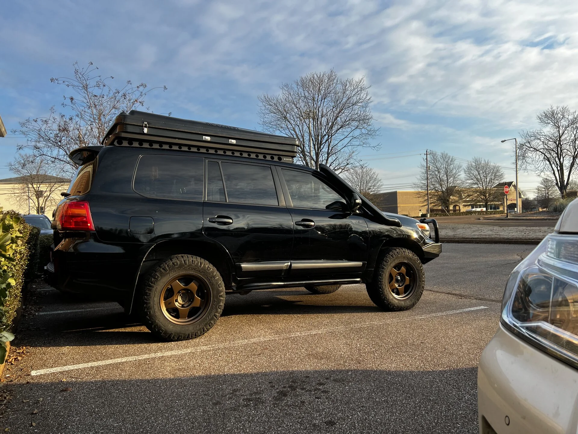

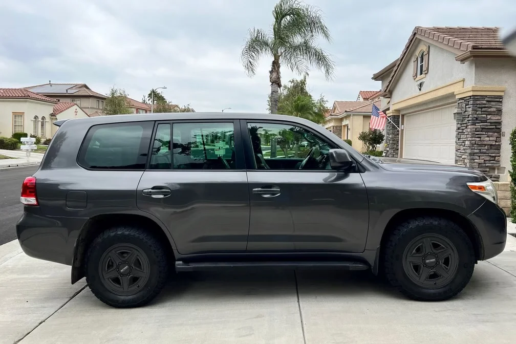

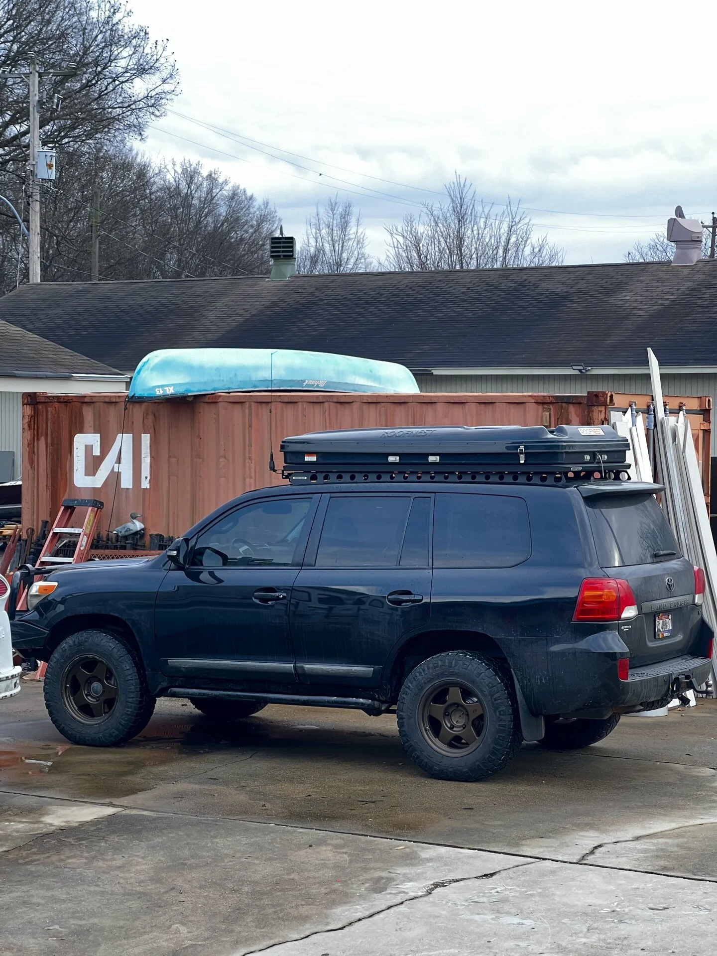

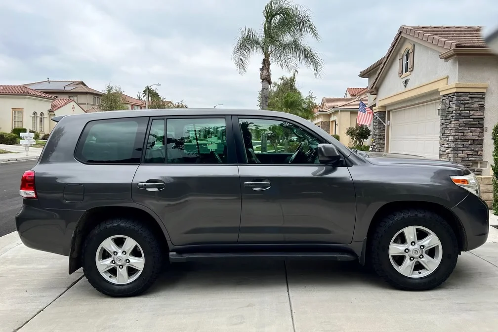

any standard side pics of the x9 + 25mm?
i photoshopped these two
8.5 + 40 mm

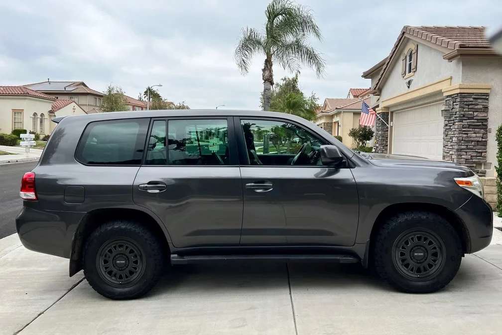

I've only seen pictures of one LC with my same wheels, the icon thrust. They have that truck/military look that I was going for. They also look different in pictures compared to real life.

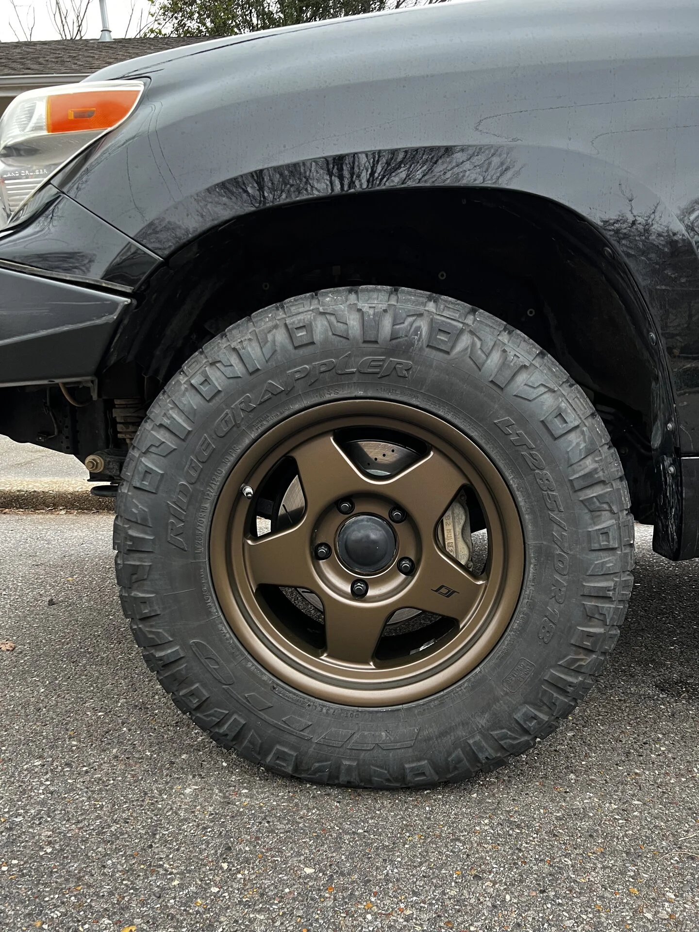

Vector 5s delivered today. Also rec’d the proper lug nuts. Tpms will or won’t need replacing as well? Probably all depends if still functional and don’t break on install? And if need, oem only, correct? Or aftermarket ok? Educate a rookie wheel buyer for those that have been through the process before w/ any other useful info. Thanks.
nice wheels. Re-use the same TPMs if they are still functional. Mine stopped communicating with the vehicle so I replaced them with the installer's aftermarket sensors

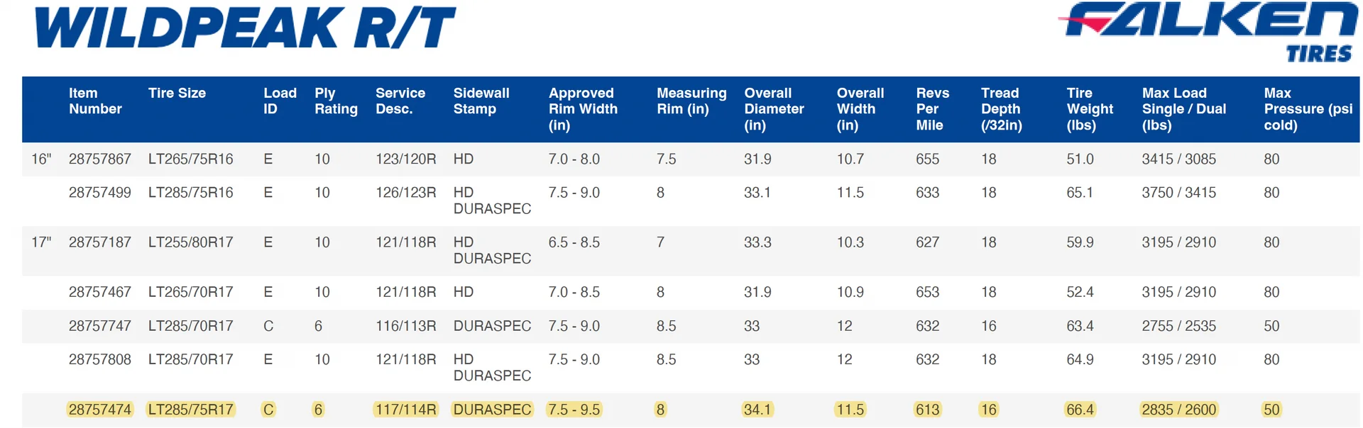

Paging @gaijin for the RCTIP for a 2013 Toyota Land Cruiser running the Falken Wildpeak R/T in LT 285/75R17 C load rating highlighted below. Thank you sir!
Thanks for providing all the info necessary - it's a pleasure, sir!
The RCTIP for those LT285/75R17 117/114R Load Range C tires on your LC200 is 37psi F/R.

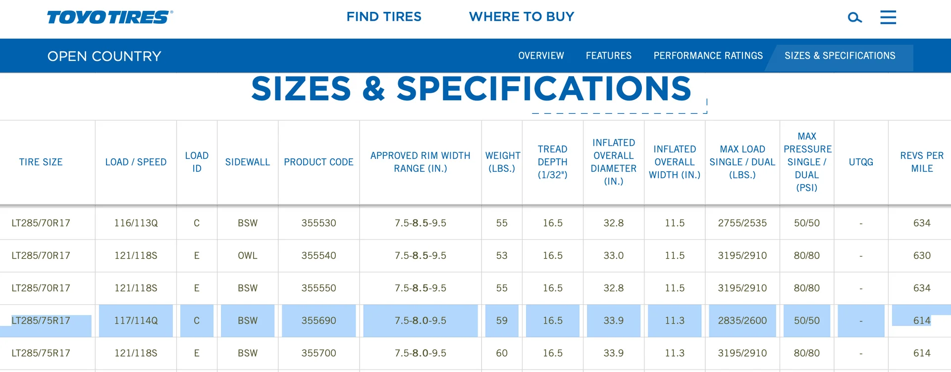

New shoe day tomorrow - similarly to above, paging @gaijin for RCTIP for 2013 LX570 for Toyo AT3 in LT 285/75R17 C load rating, highlighted in blue in the screenshot below. Placing chips on 37 and 35. Appreciate the help very much!
Can I piggyback on your request with same tire but E load rating? Since you posted the specs and all, thanks!
2011 LX570 if it makes any difference. Thanks @gaijin
